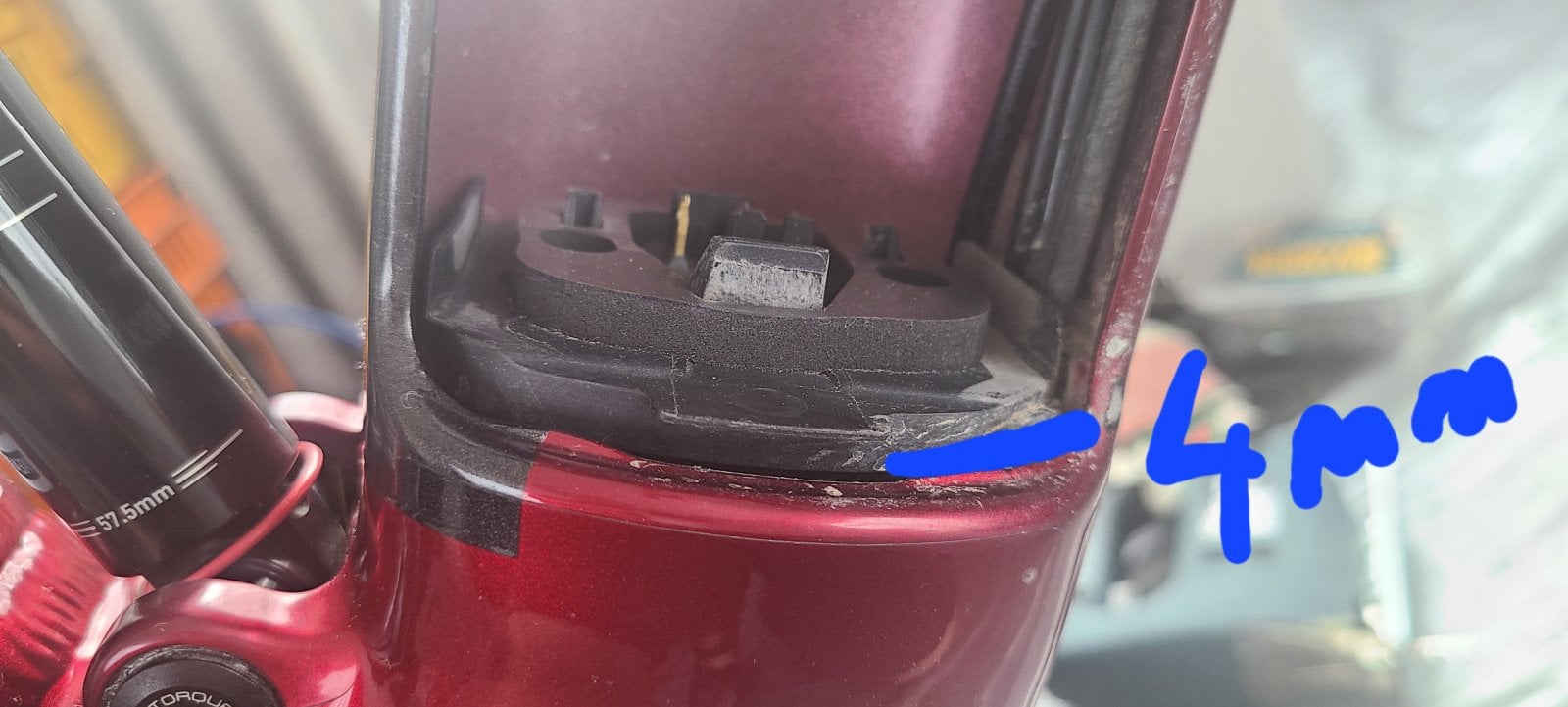

Just to update. Took motor bash guard off, and with the battery in place, loosened the security torx screws and pushed on the back of the battery mount. Gap between the tab and the frame was 2.5mm, now it's 4mm. Battery still goes in easily but slightly harder to remove, need to press down a little to compress the foam damper. This should stop the battery cut-out issue I've been having
