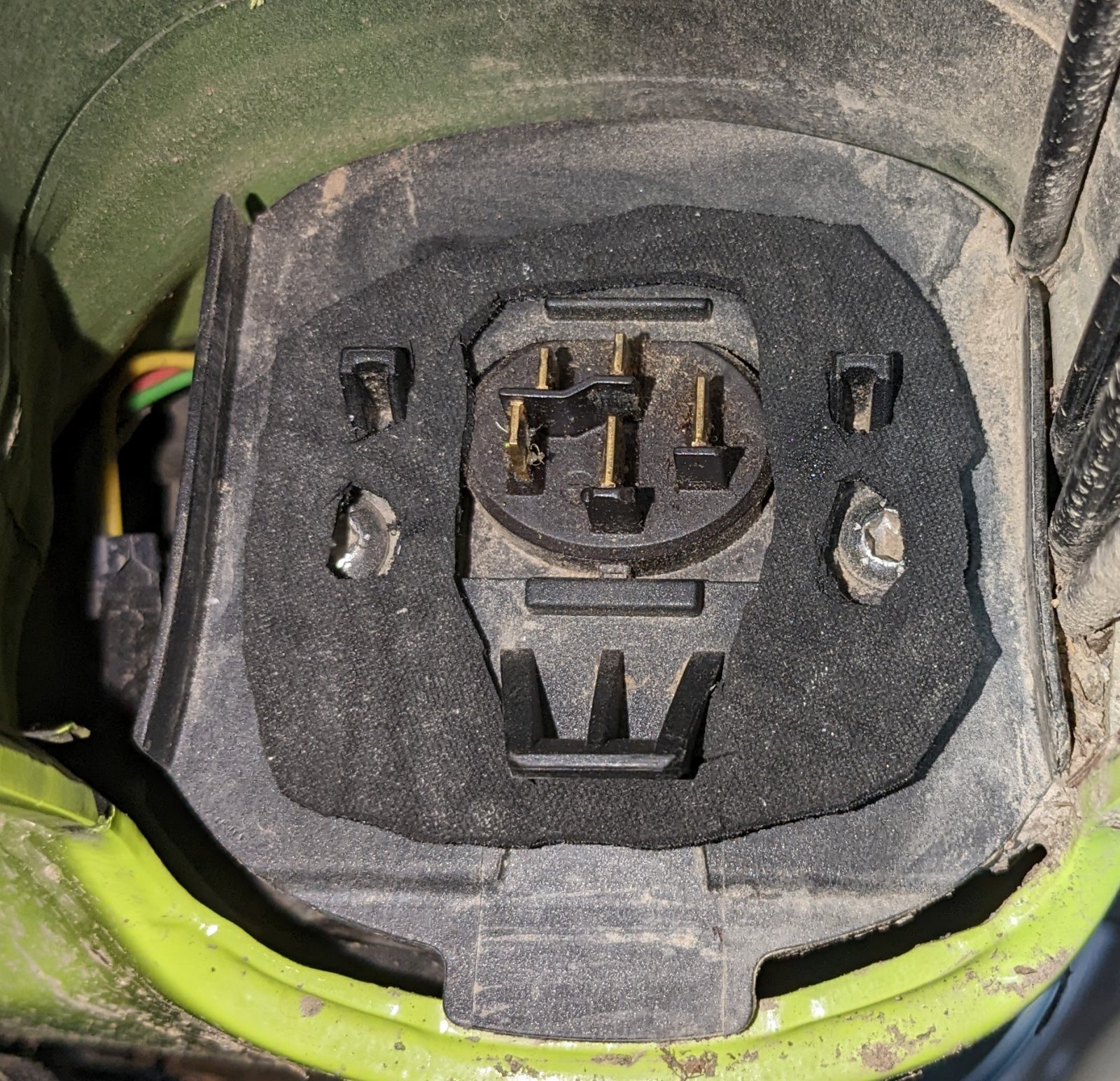

Should fit like this
Clean
Jul 1, 2022
86
88
West Yorkshire

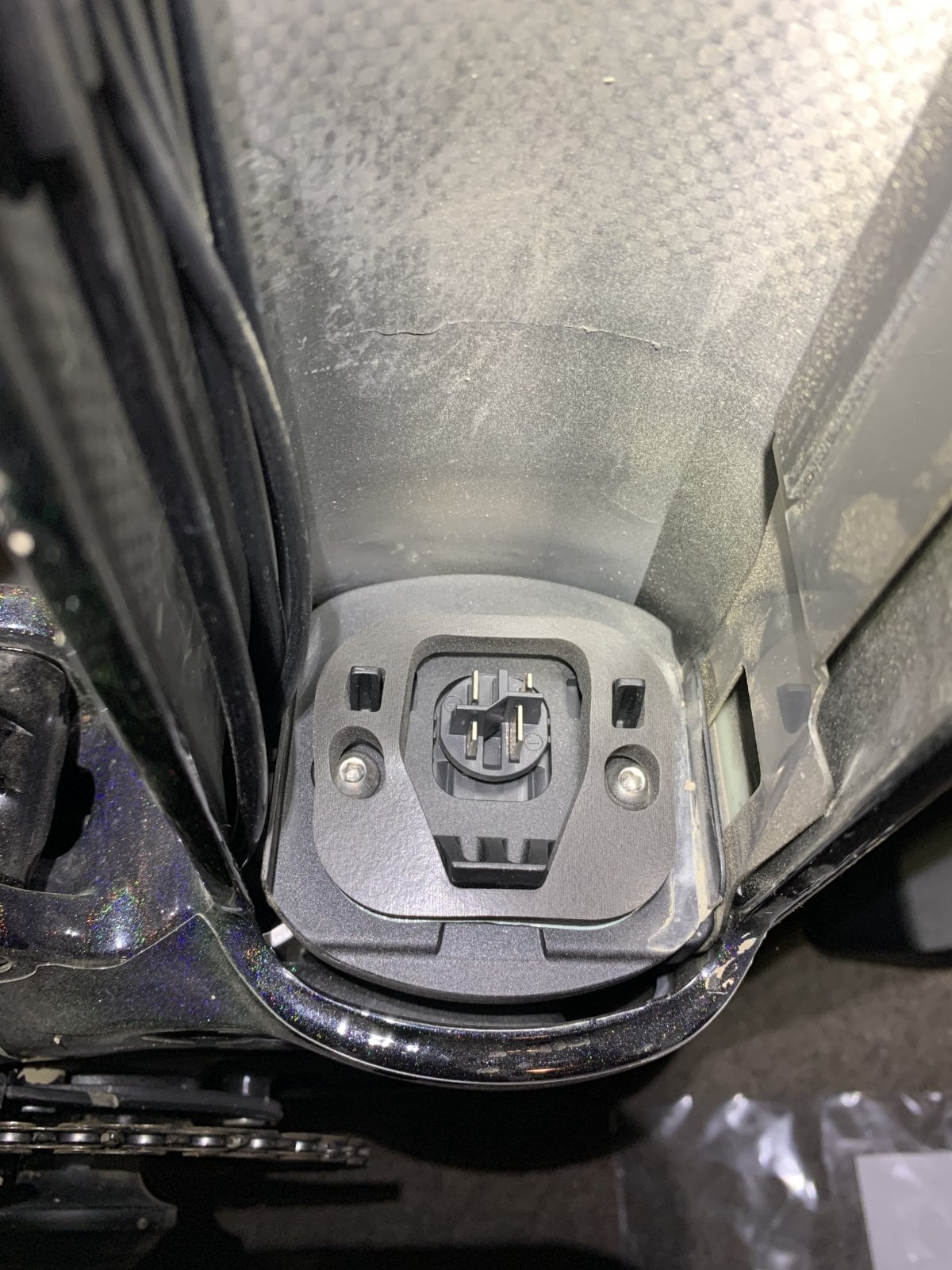

Looks quite different. No screws beneath the screw holes, and the whole thing gets pulled right out of shape once in place.

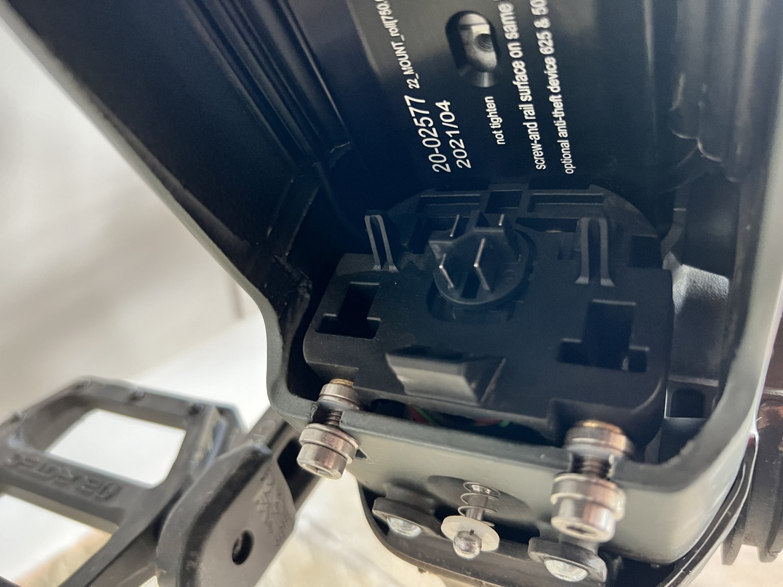

The issue - IMHO - is the difference in orientation and fixtures between vertical and horizontal mounting plates - Trek being one way and Cube being another.

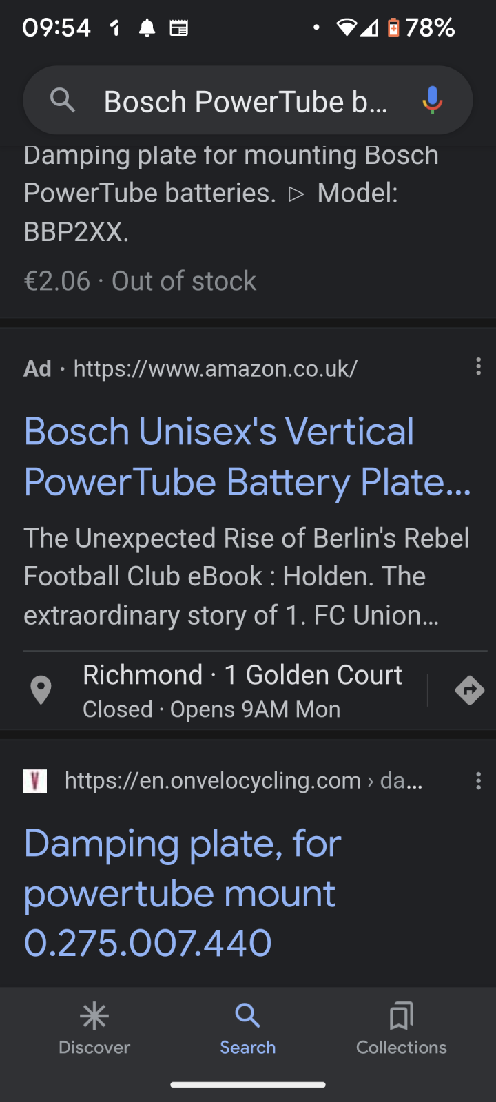

Whilst 'googling' the part and casually reading through the responses ( it's Sunday morning and leg still healing so no riding for me 😟 ) .... I came across the following -
.... So tempted to order, just to see what turns up....

Bought mine today from Hub Cycles, $5 plus $5 freight anywhere in NZ. I've been getting lots of rattle on chunky descents, hoping this will fix it. Never knew it existed till I read this thread. It's the last item at the bottom of the drop-down options menu. Few other places selling them too but this was the cheapest freight I could find
Bosch - PowerTube Battery Parts & Cables
I also wanted one in NZ, but it was sold out.

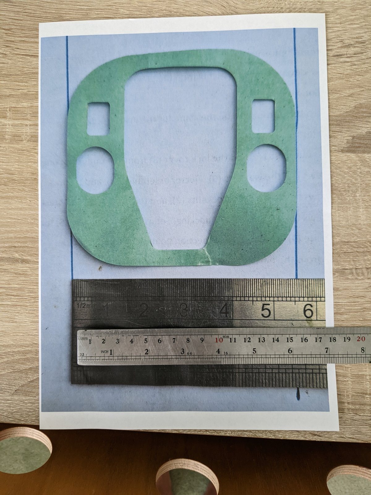

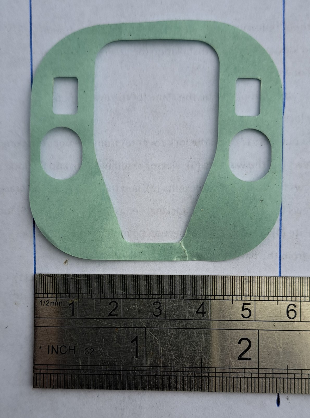

Having used it, it's really easy to make one then just glue it in using contact adhesive. You'll need some ~10mm closed cell foam, and a template is easy to make from the pic below.

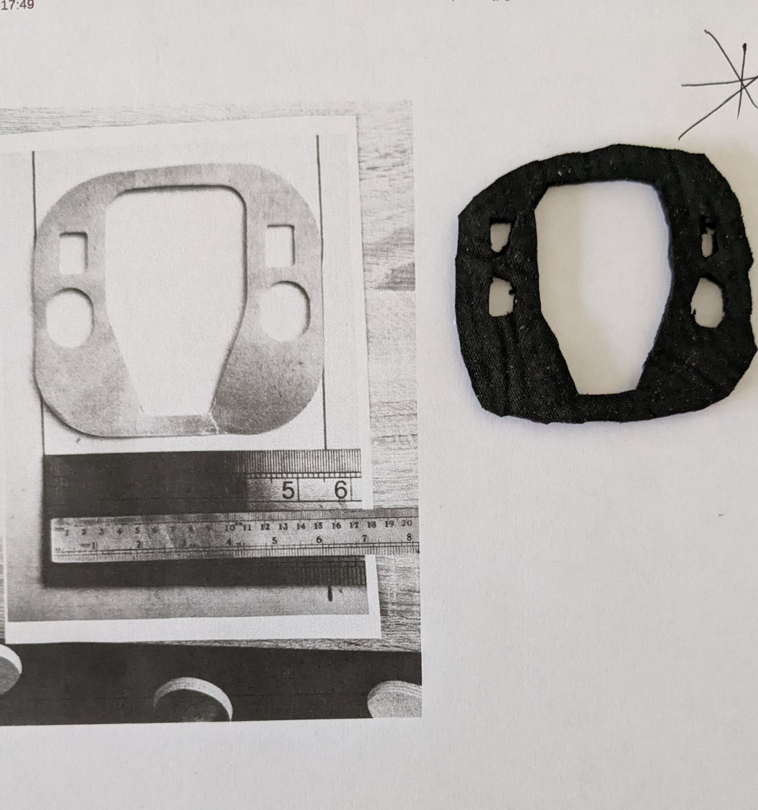

Having had a quick look around and finding them all sold out in the uk ( for some reason 🤔 ) I'll give this a go with a bit of old neoprene from a wetsuit I've got lying around - thanks 😁👍

Just to put it out there, on the two ebikes I've owned, I've cured battery rattle with a screwdriver. The electrical contacts end of the battery tube is usually fixed in place. The other end isn't but is in my experience, fixed in place by a couple of bolts on a movable bracket, so by loosening those bolts, shiftng the bracket towards the motor a couple of mm I have by a process of trial & error been able to fix my battery in place tightly & rattle free.
On my Focus, for example, the upper battery bracket is fixed by two bolts on the underside of the downtube that also secure the knock block & so are very easy to access.
There is a trade off between stopping rattles & having the battery locate in place to the point that it becomes hard to remove but I've always managed to find the sweet spot. A couple of quid is nothing in the scheme of things but there are options other than spending money.
Had a go.... To be perfectly honest, came out a little on the large side....
How do i make it fit daddy?? 🤔
( Could use a hammer - that always works 😉 )

Thanks but I'm "onamission" now, with the wetsuit - been wondering what to do with it. just got to get the template the right size first 🫣😂
Ah well, OCD was never my strong point.....
Fits though and seems to do the job ( on a unit i never noticed rattling anyway 😂 )

Just some feedback on this, I've had the damper pad fitted for about 3 rides on a 2022 Rail 9.8 and all seemed well. Then on the 4th ride all of a sudden the bike started turning itself off when going over choppy terrain (and mostly going uphill).
I removed the pad and have since had another ride with no issues. Could be a coincidence, but i think @Paul Mac also had a similar issue after some time using the pad.

I think the trick is to try and arrest the movement of the battery. The pad alone (for me) didn’t do this, the battery mounts needed moving closer together by a significant amount to arrest all the movement.
If your bike is switching off, the battery is still moving.

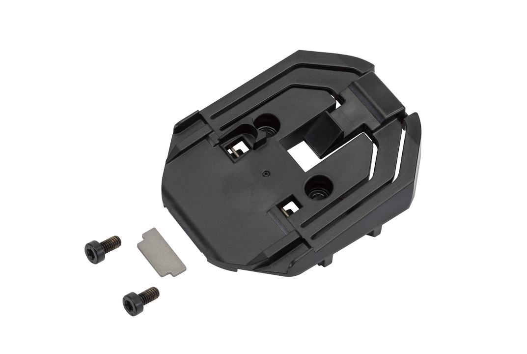

@Oupy does your bike have the alignment plate fitted? I have a 2020 alloy without the plate. Out on a ride a couple of days ago and the power cut out twice. I want to keep the damper though because it's made my bike so much quieter. I'm going to try adjusting the bottom mount closer in as @Dave.B suggests, I think this should fix the problem

@Philly G yes mine has the plate fitted as stock (2022 model). Did your power cut out going uphill or downhill?
Power cuts out at random times, on almost flat ground, strange...has never cut out while climbing and not going downhill over chunk either...happened twice again today. I thought the purpose of the plate was to get everything in perfect alignment and prevent movement? Is there any adjustment so you can move the battery mounts closer together?
