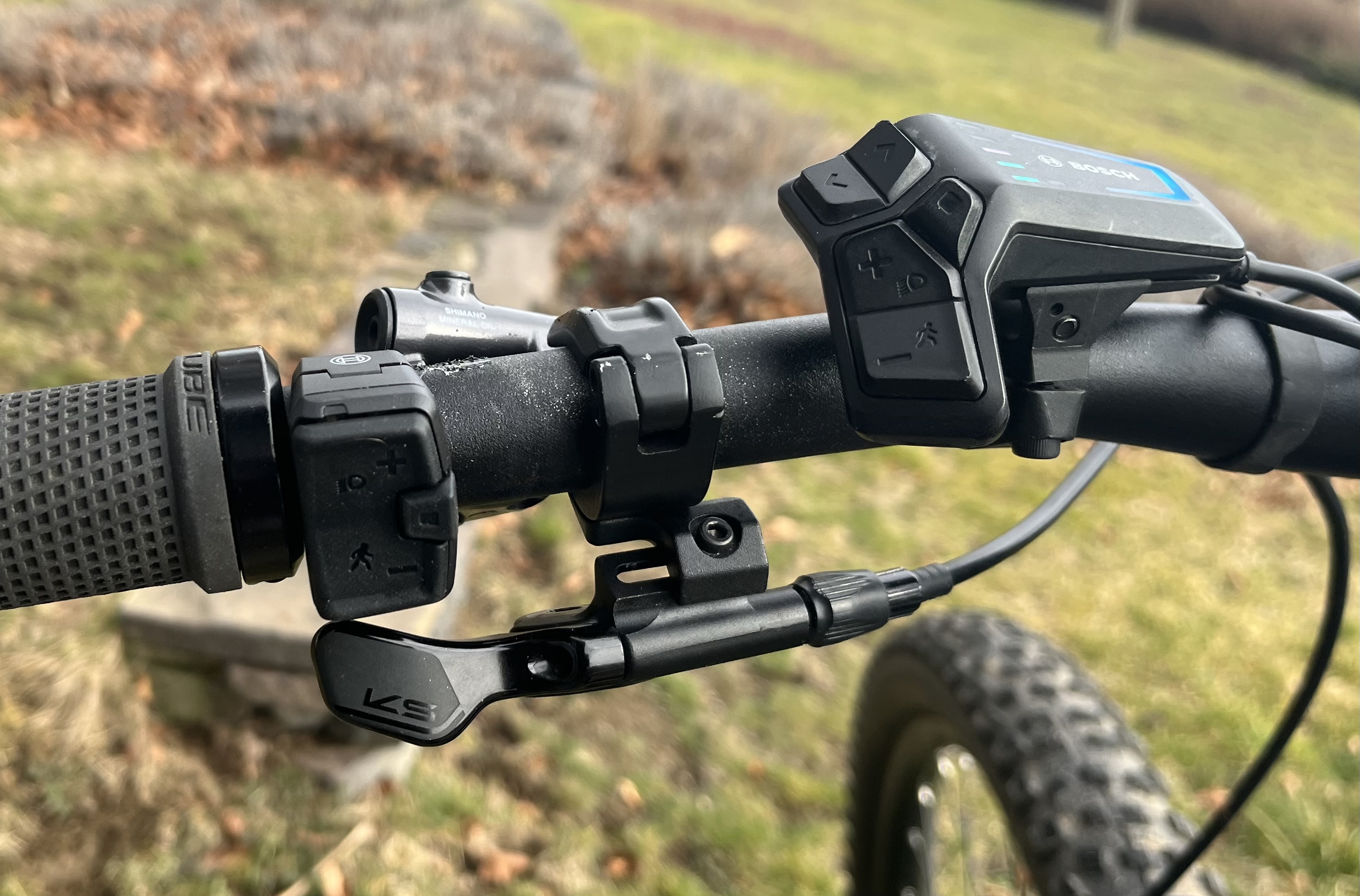

Hi mate , today i conected mini remote to LED Remote over Flow app , all is ok.I wonder if it is possible to replace the cumbersome LED Remote with the new Mini Remote? Or is it required to have the "System Controller" installed?
So do you still have the LED remote on the bars?Hi mate , today i conected mini remote to LED Remote over Flow app , all is ok.

my intention was to get ergonomic control, which the LED remote carried, the proximity of the brake and the seatpost control did not make it possible. in the future I want to change the control remote to a mini remote.If the Mini Remote is communicating with the LED Remote via blutooth that would likely not work with the LED Remote inside the frame ( and not sure how you would get it in there anyway!!!).
Not sure what has been gained here. The LED Remote is still needed as the system controller so has to be retained and there are few places it can be positioned other than on the bars.

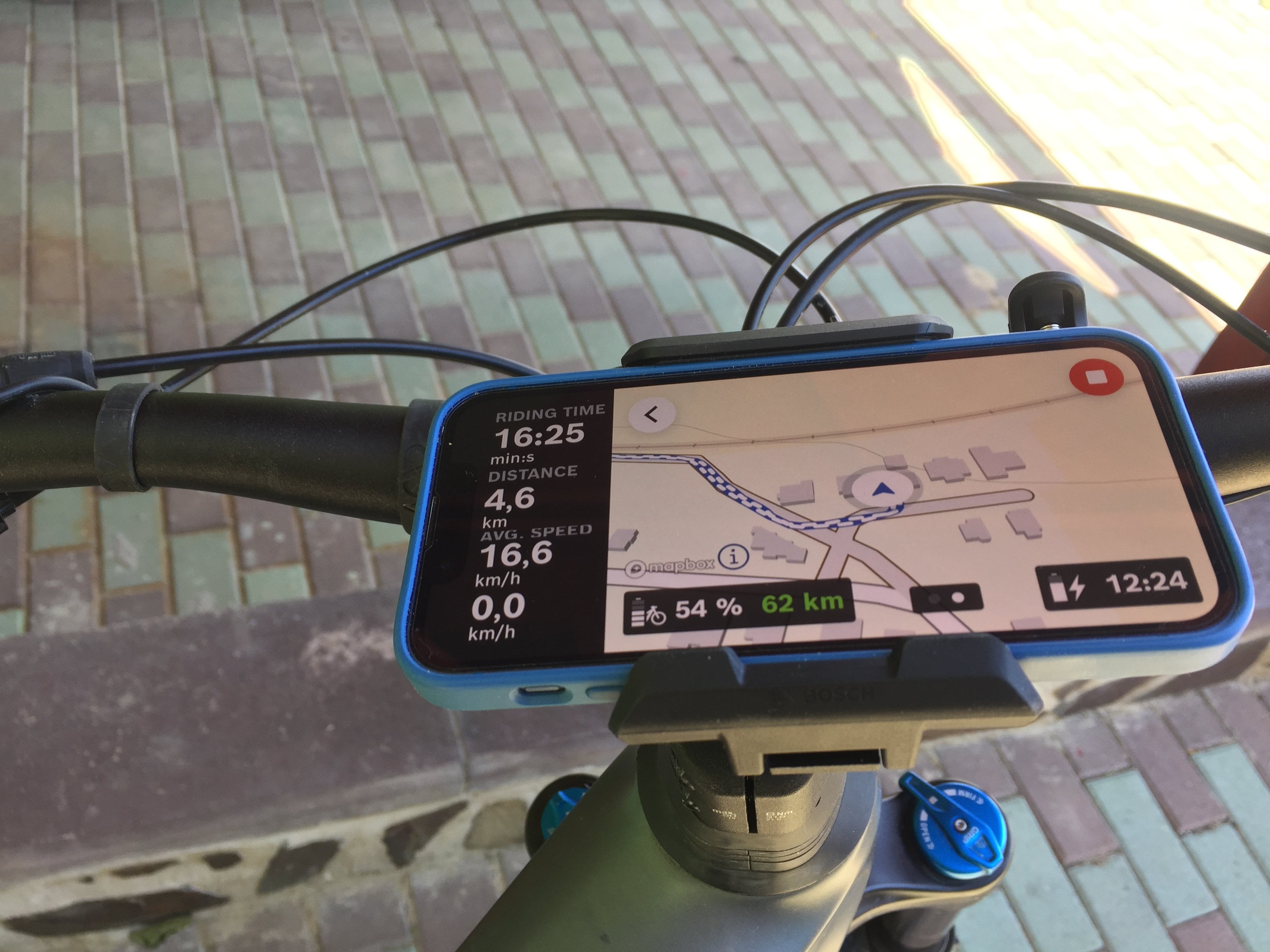

heer is solution
