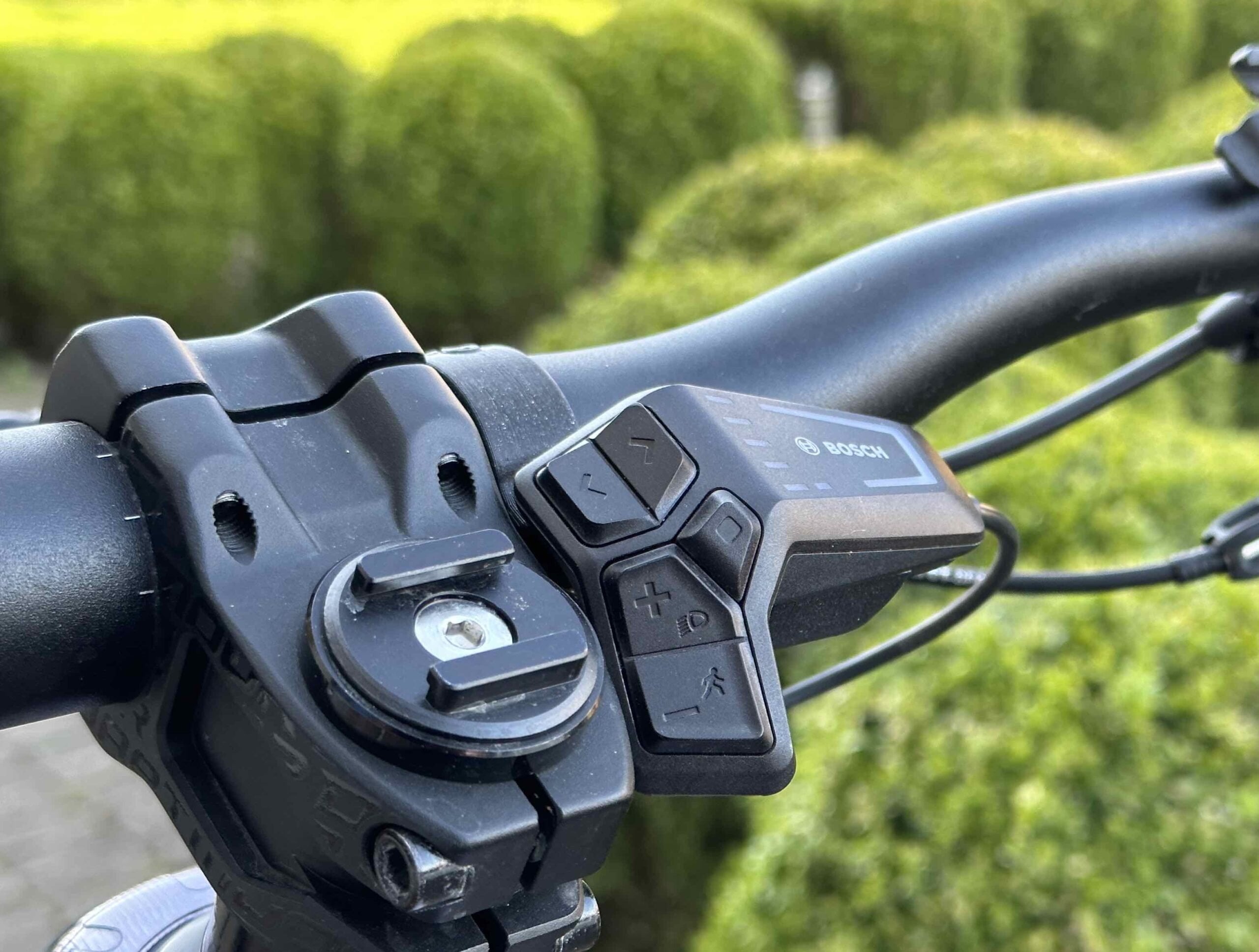

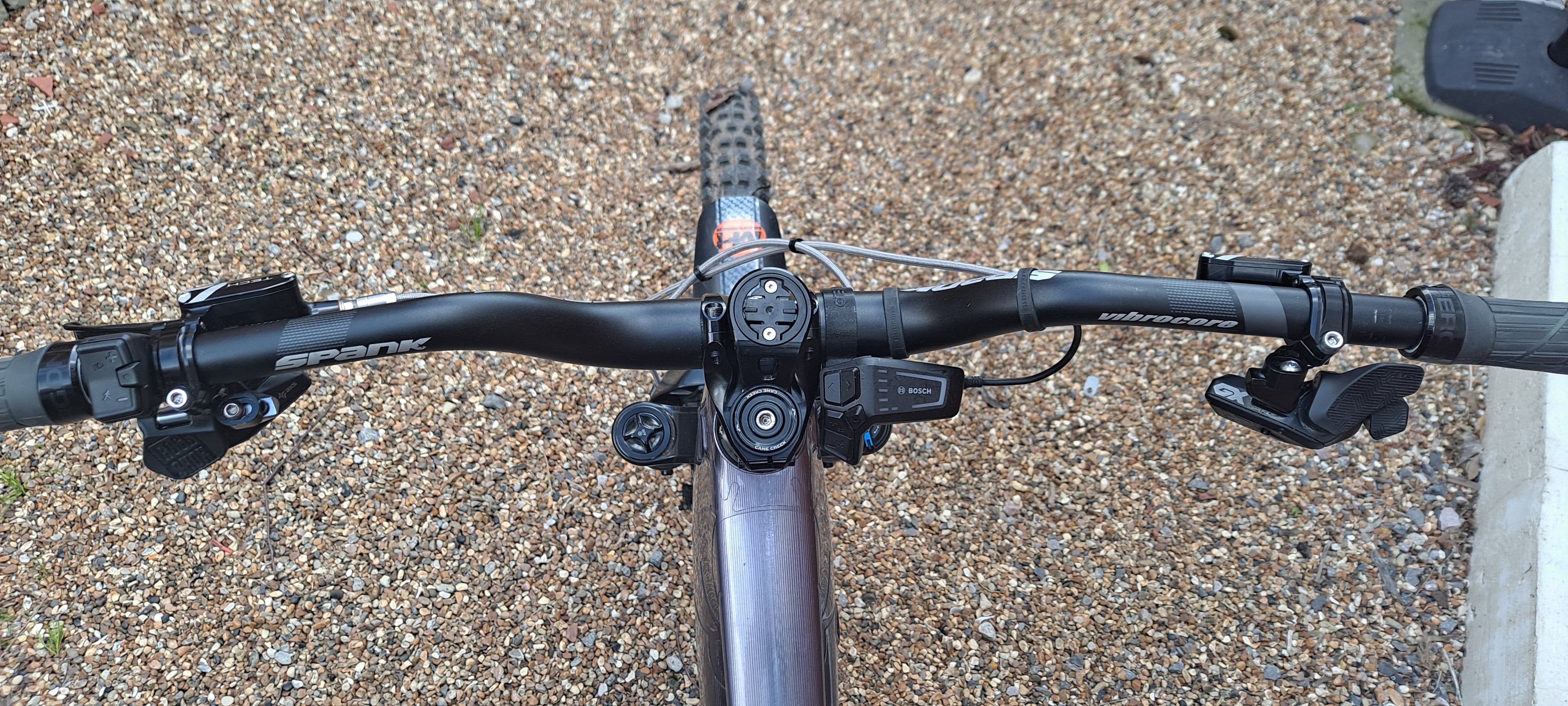

I have now seen it done on a new pole, with the smart led remote. So the led remote is placed by the stem to ‘protect’ it. Quite like the idea of it to be honest.
I've the bracket for that on order so it clamps to the right hand side of the stem, nicely out the way. There's a chap on the Pole facebook group 3d prints them (vision velo website). I bought his battery cover previously and the quality is spot on so hoping this should be good too. Paired with a couple of shimano cable tidies to run the cable back under the bar to the headset this should tidy things up nicely.
And the mini remote pairs to and controls the LED controller fine.
(Pic taken from the chaps website).

Ok. Recieved the new bracket for the LED Controller and had a chance to have a play with the mini remote today.
This is on the latest firmware update from Bosch (not sure of version but I downloaded it 2 days ago). Not that it should make any difference but I also have the Bosch connect module installed on the system. I tried with and without Kiox display (see below as this is where some changes come up).
Set-up: Mini Remote/LED controller/Connect Module -
The mini remote and LED controller work 100% together. Pair them via the flow app (which did take a couple of attempts) and they work flawlessly. Reconnection when you turn the bike on and off (which is still done via the LED controller) was pretty much instantaneous, no issues at all. I did a quick 5 mile ride and had no problems at all.
The mini remote switches through all the riding modes with the LED lights on the LED remote changing as per normal usage. Holding the down but on the mini remote will trigger walk mode and again it all works as if you were using the LED remote with the LED lights etc working as normal.
For me the mini remote buttons when changing ride mode just feel a lot nicer than the LED controller ones.
Set-up: Mini Remote/LED controller/Connect Module/Kiox Display -
The mini remote does work with the Kiox display but seems to have limited functionality. Change ride mode with the mini remote and the kiox/LED change in sync as per normal usage. As standard you can still get to the 2 screens per ride mode on the Kiox. I think mine is Speed on screen one, then a second page with some separate bits of ride mode data on them. You use a quick press of the select button on the mini remote to reach the second page.
I couldn't use the mini remote to get to any of the other non ride mode info on the Kiox. Most of the buttons on the mini are dual function but long press the select button just takes you to a reset ride mode data selection on the kiox. I couldn't get it to take me to the navigation screen for example. I couldn't find any details in the manual or online as to whether there's anyway to configure the mini remote to operate differently and I couldn't see how to change anything from the way it was operating. However, as I still had the LED controller attached I could still use the left/right buttons to change through to the other kiox screens that way. I don't use the Kiox anymore so not an issue for me but thought I'd test it to see what worked.
On a separate note, the new bracket for the LED controller appears to be well made and is solid once fitted to the bike. No issues with knees being anywhere near the controller when I was out riding and it should be pretty well protected and out the way in it's new location.
