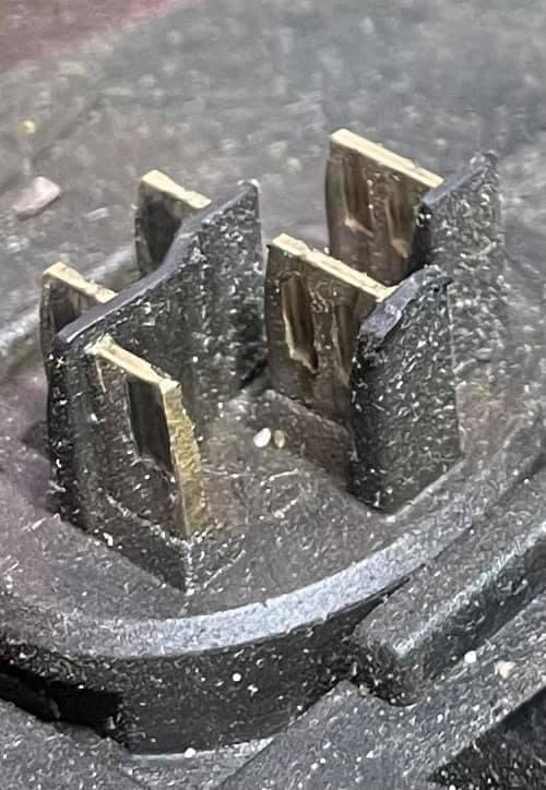

If your plug looks like this , replace it

............and it should not get like that!! The design that has the battery sitting on the connector plug.......and easilly removed because it sits in a cutaway down tube does concern me for 3 reasons. Firstly the weight of the battery if not locked down against that connector plug very tightly will put a huge strain on both the connections of the plug and the female connections of the battery. Secondly most of the designs seem incapable of keeping that connection clean and dry. Thirdly every type of male/female connector has a limited number of times the connection can be made before the surface metal of the pins become worn and that leads to higher resistance, which leads to heat, to leads ultimately to an unreliable connection.

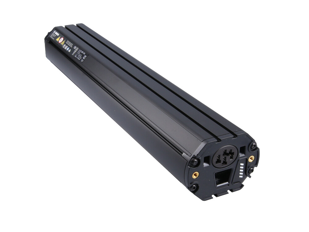

That photo of the electrical connector doesn't show the locator lug that is designed to take the strain of the battery sitting on it,so the connector doesn't have to do anything structural or load bearing.
Here an image of a Bosch battery, the end of the battery that the plug above plugs into, you can see it has a large cut out below the electric socket that a large plastic lug slots into that locates the battery in the correct place and takes all the force of holding the battery there,so all the connector is doing is making an electrical connection.
Mikerb
May 16, 2019
6,143
4,675
Weymouth
I know that is what it is supposed to do but in reality it only acts as a guide to allow the male/female connections to match up...... no way a short spigit into that hole can stop a 2.8kg battery c500mm long from moving.
