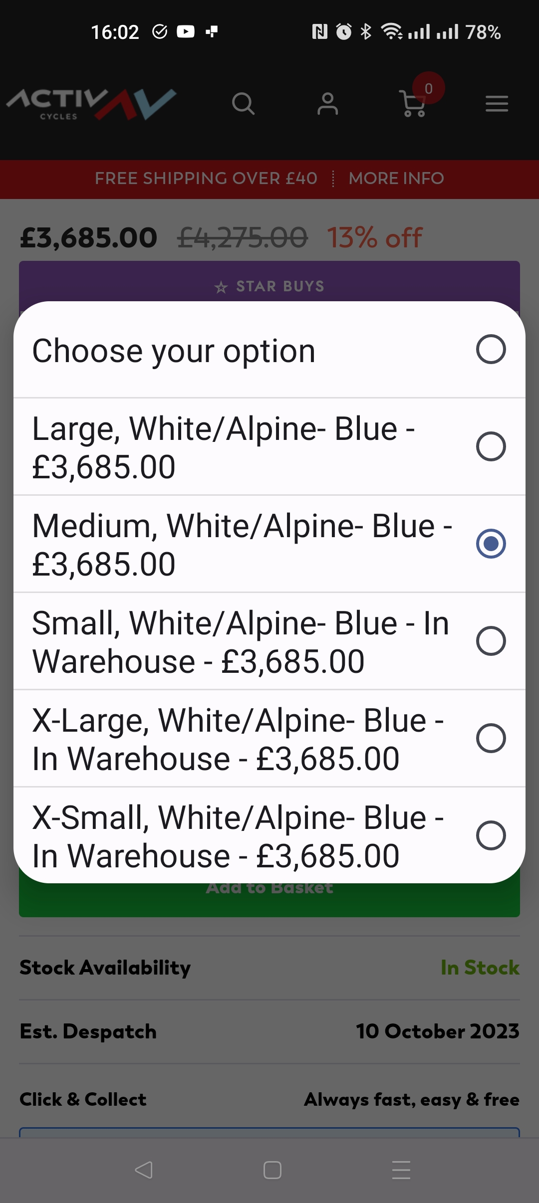

YT Decoys are very affordable with various specs depending on your budget. They tend to run a little smaller then most brands. Had my 1st Decoy for 3 years with absolutely no issues. Just got another one and it's a blast to ride. Have 3 emtbs and the Decoy is the bike I ride the most.
