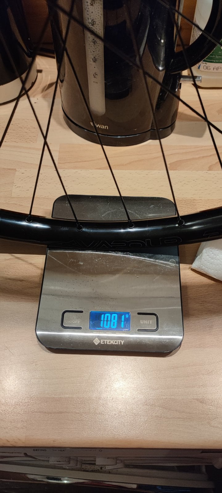

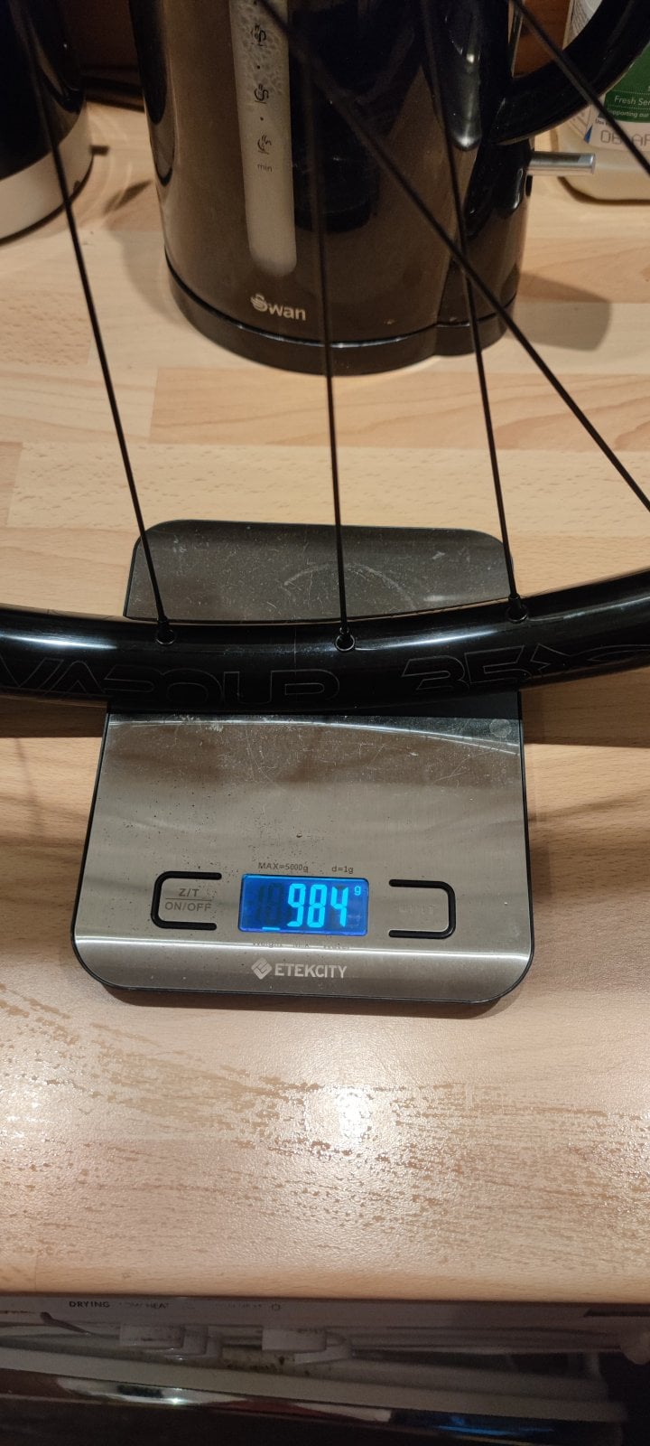

Do you have a weight for them?.
Hi weights are just bare wheels , XD driver , obviously heavier weight is the rear 🤟
