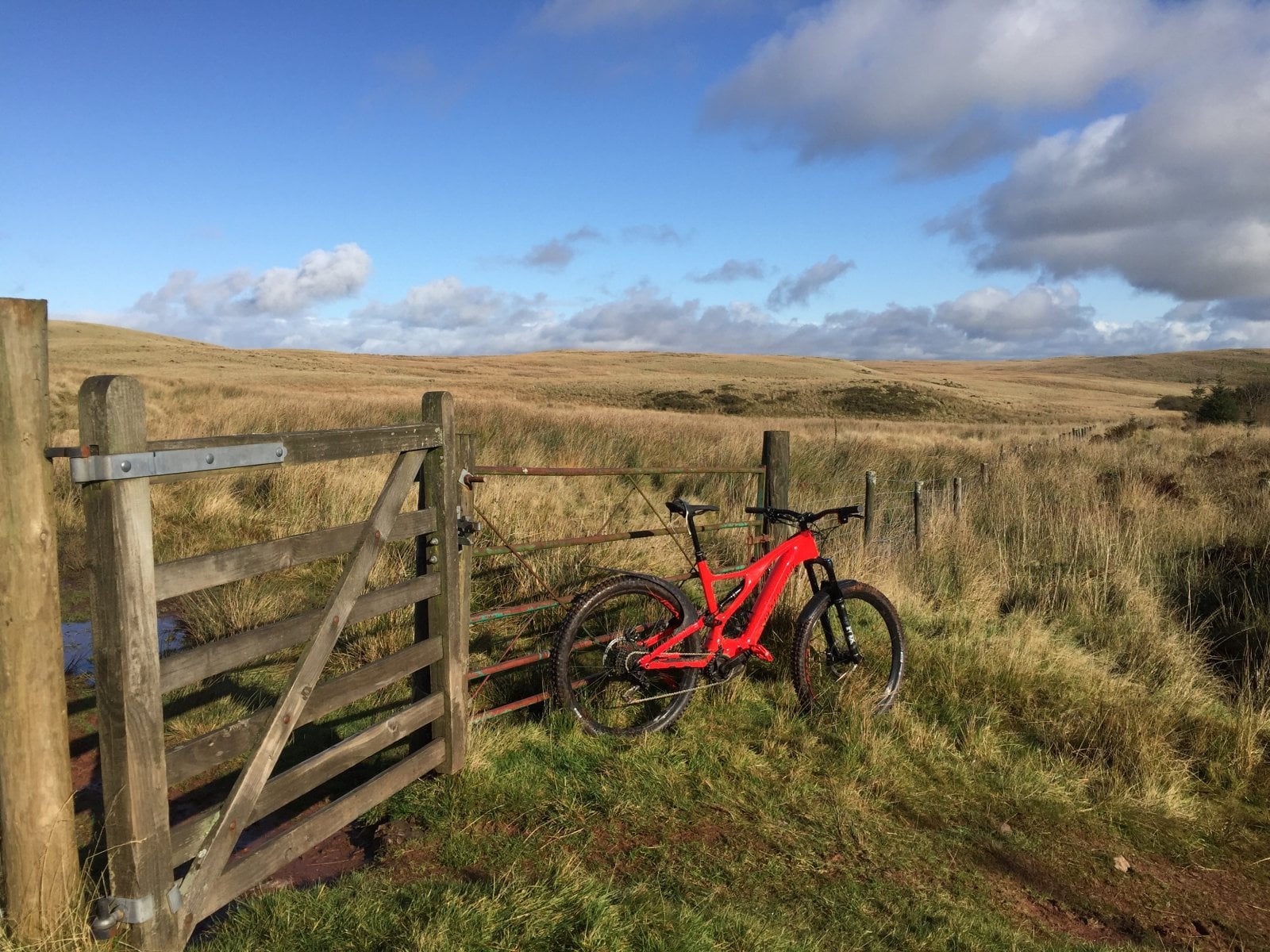

picked up my Levo yesterday and took it out today, its a 2019 carbon comp (500wh)
done 24 miles and 800m of climbing, used eco and trail only with a few road sections with the motor off.
the battery was completely gone when I got back. The beacons is quite rough though, lots of it was baby head long grass..
is this normal range? I was expecting more..
are my settings to blame?
all that aside, what an amazing bike ! I was still riding my old enduro until today but thats probably the last time it gets a turn of the wheel..
If its a new battery will take a few charges discharges to get up to full power

went out again today, conditions were terrible. loads of sandy mudplugging, loads of bogtrotting and the rest was very steep techy climbs over rock.. also loads of river crossings without problems.
From strava
Distance: 20.31 miles
Elev Gain: 4143 ft
ran out of battery about 3 miles before the end of the ride, did the last huge climb with a dead bike which wasnt nice at all
bloody gear change/rear cassette is awful.. there is no place where the adjustment allows smooth shifting across the cassette. you can adjust so that 2/3 of the cassette is ok and the remaining third will just jump and smash its way through the ride. the only thing you get to choose is which third of the cassette doesnt work properly..
