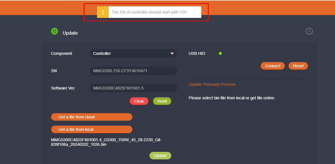

Keep getting "The SN of controller should start with 'CR'" when trying to update firmware on M560.
Anyone here encountered similar problems?
Ok, so then controller is dead. It is not communicating with Besst. :(

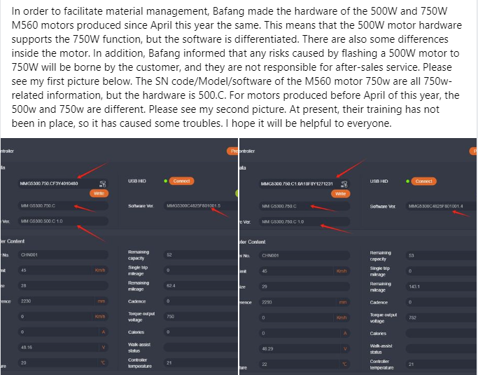

Chilli posted this today
I'm having hard time understanding what all that means... are you able to explain it a little bit?
Bafang is going to use same hardware for both motors = they try to save costs and make things easier this way for them? This means both motors will have metal gear I assume?
I wonder what "some differences inside the motor" mean... how can they be different if they use the same hardware?
If customers deside to flash the motor themselves the warranty expires?
Motors produced before april this year the 500w and 750w versions will be different. After april all motors will have same hardware but different inside somehow?
At present their training has not been in place and they have had some problems with production and/or assembly I assume?

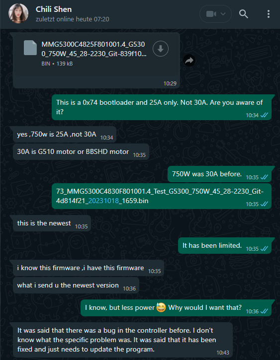

It got even worse... Last time Chili provided me with "new firmware", the max power reduced from 30A to 25A. Bafang can't be taken as serious manufacturer.. They try to but never get anywhere. I'm glad I can at least source my parts from Greenbikekit.

Well that's a bit different story than what you said earlier. Dropped to 25A not 19A.
Oh it was typo. Edited.
Based on the chat seems like Bafang made the change. Not Chili. They just provided you with the latest software they got from Bafang? Maybe it was done to prevent overheating problem they had earlier?
Has all the later softwares been 25A also? Wondering if this is permanent change from Bafang.

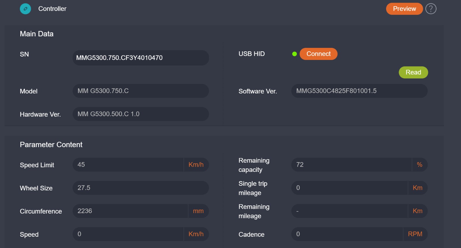

Do you have a besst tool? Apparently the new versions have the hardware version marked as 500.C 1.0 and older models have it marked 750.C.
I received sound test video of the new motor. It really hard to tell a difference. The video shows the motor running on the desk without being attached to a bike. It's different, maybe the sound is little deeper but the overall volume is the same I would say. Will have to see how much the sound lowers after the motor is on a bike and has some kilometers in it. I received the video on whatsapp in HD. Too big to attach here.
