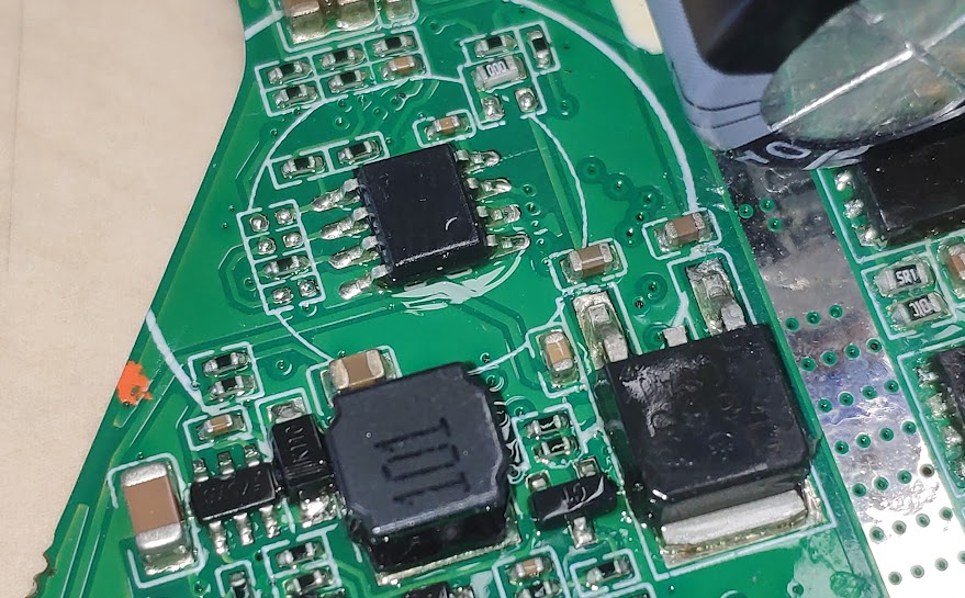

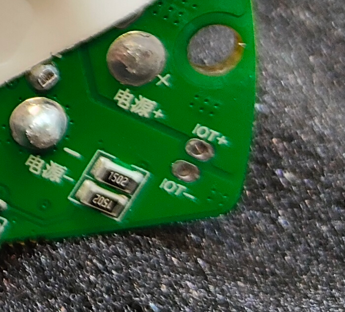

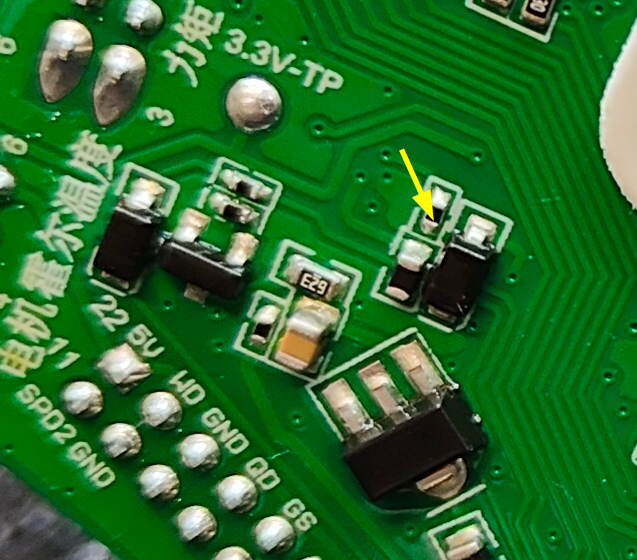

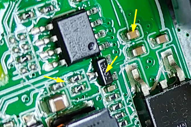

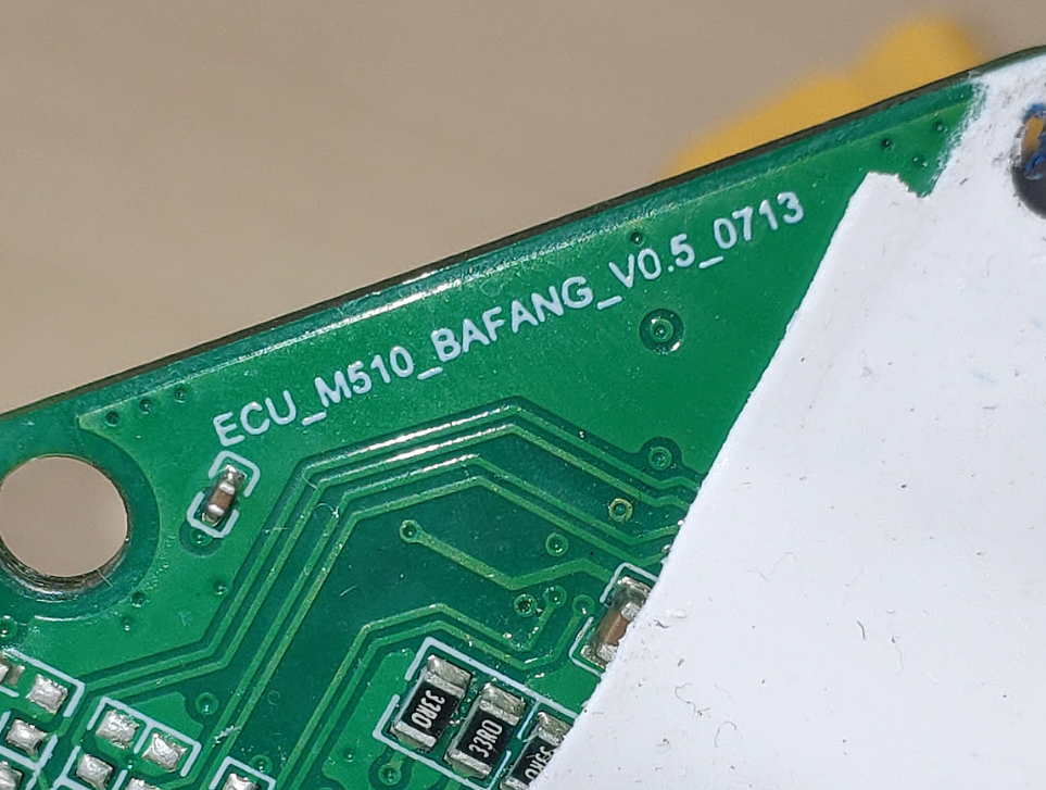

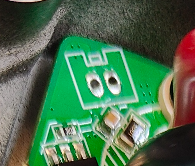

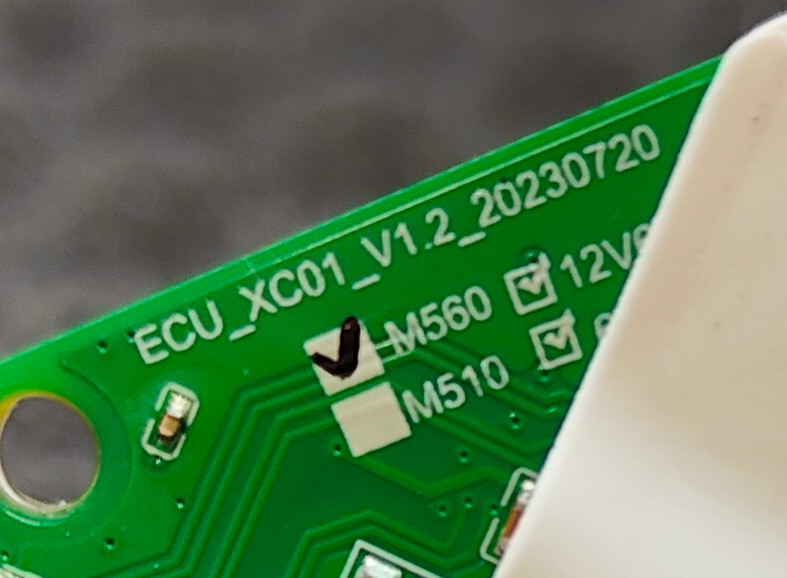

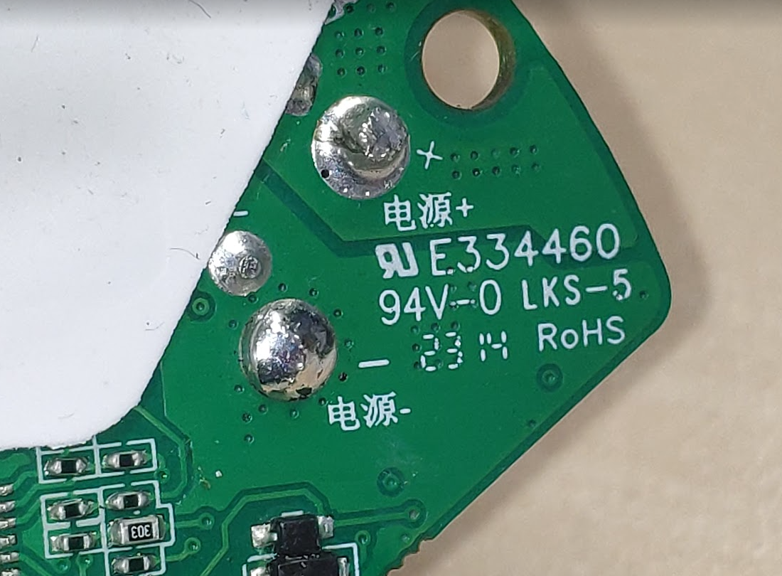

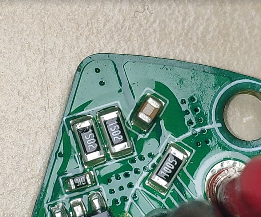

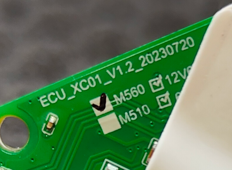

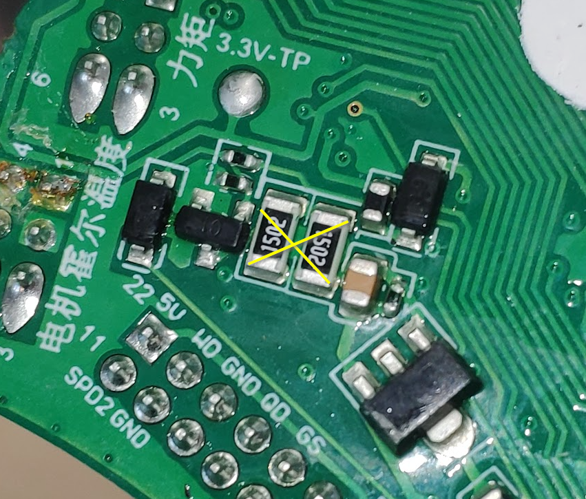

IOT+ / IOT- pins are new.
And they certainly changed a few other things, like moving components and adding filtering capacitors for voltage stablization. (left is M560 january, right is M560 before that)
And obviously they corrected the naming:
View attachment 138878 View attachment 138884
View attachment 138883 View attachment 138885
View attachment 138881 View attachment 138886
View attachment 138888 View attachment 138887
View attachment 138889 View attachment 138890
I have no knowledge about these electronics. What do you think they tried to achieve or have succeeded with these changes?

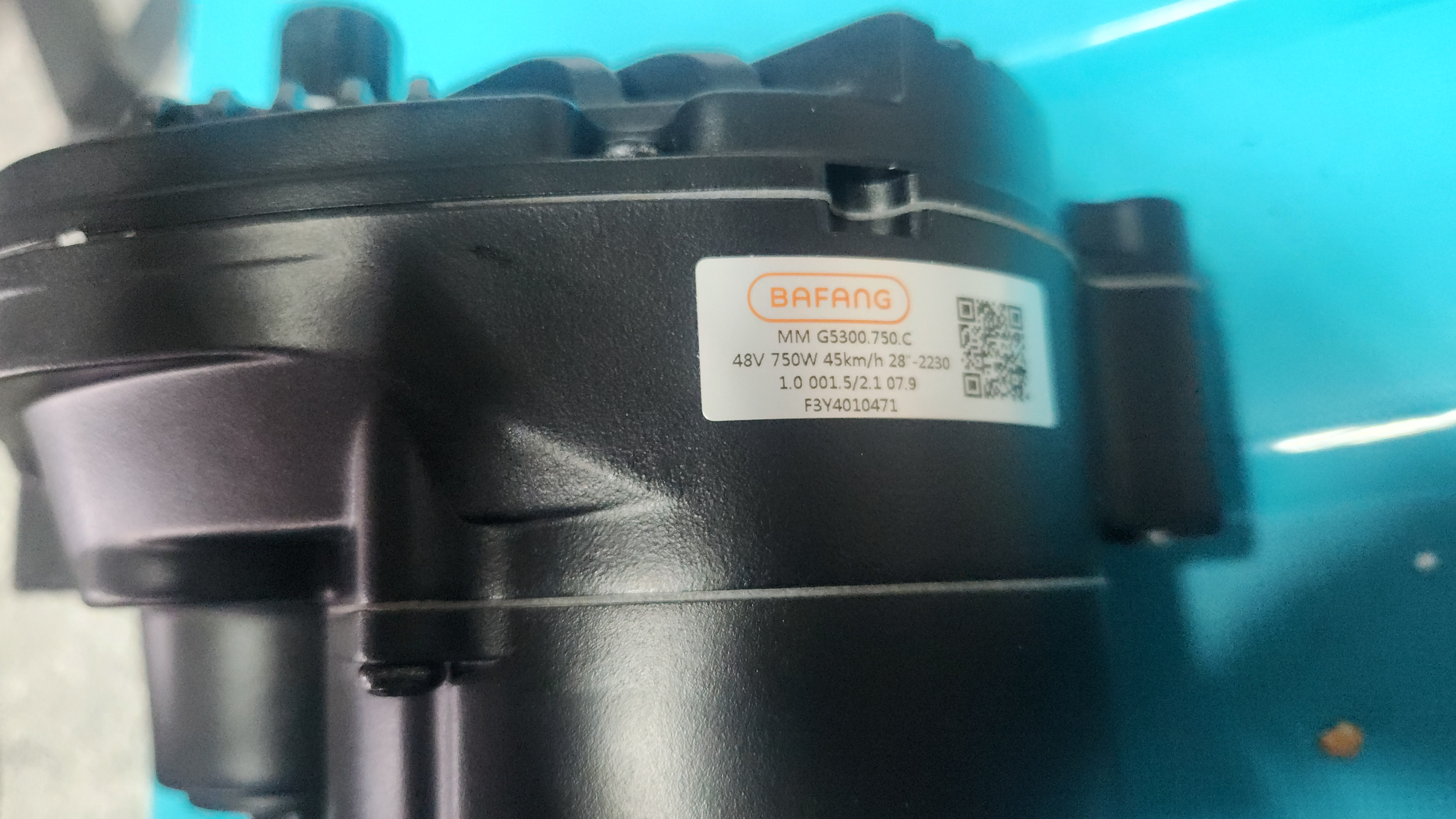

Got the latest April 2024 version of M560 and will report back on how it performs. I had M600 Ludicrous v1 before and immediate difference is weight. Missed on that it uses M16 crank bolts so not tested it yet until they arrive.
Hello. That left and right bolts does not play a big role. You can ride without. Just hit peddals with a hammer :) and tighten 4 bolts.
Oh well, it didn't go as planned, M560 starts for 30 seconds and then automatically turning off the whole display and motor and everything. Has to be problem with M560 as i haven't seen that with M600. Just to make sure its not batter i connected back M600 and it works perfectly fine. So contacting Bafang as to what's the issue is with M560. Not sure if anyone on forum had similar issue.
This is a side effect of the volume reduction :-) it is total silent now !
Bravo Bafang ;-)
No kidding perhaps it is a driver-panel issue? Do you use panel from M560 or some else, older?
Right, u made it total silent now. ;)) Dont know what is driver panel....
Haha :) for those eternal 30 seconds, I was able to ride it and it does seems to be very quite and has good amount of power... Drill is to reach for power button every 30 seconds 😄
I tried different display as well but nothing worked. Going to update firmware today to see if that fixes the issue.
Are you sure that the battery is supposed to work with that motor? Maybe they are not compatible with each other.

Why would it be different? It works fine with M600 motor and ultimately pushing same amps as it requires.
