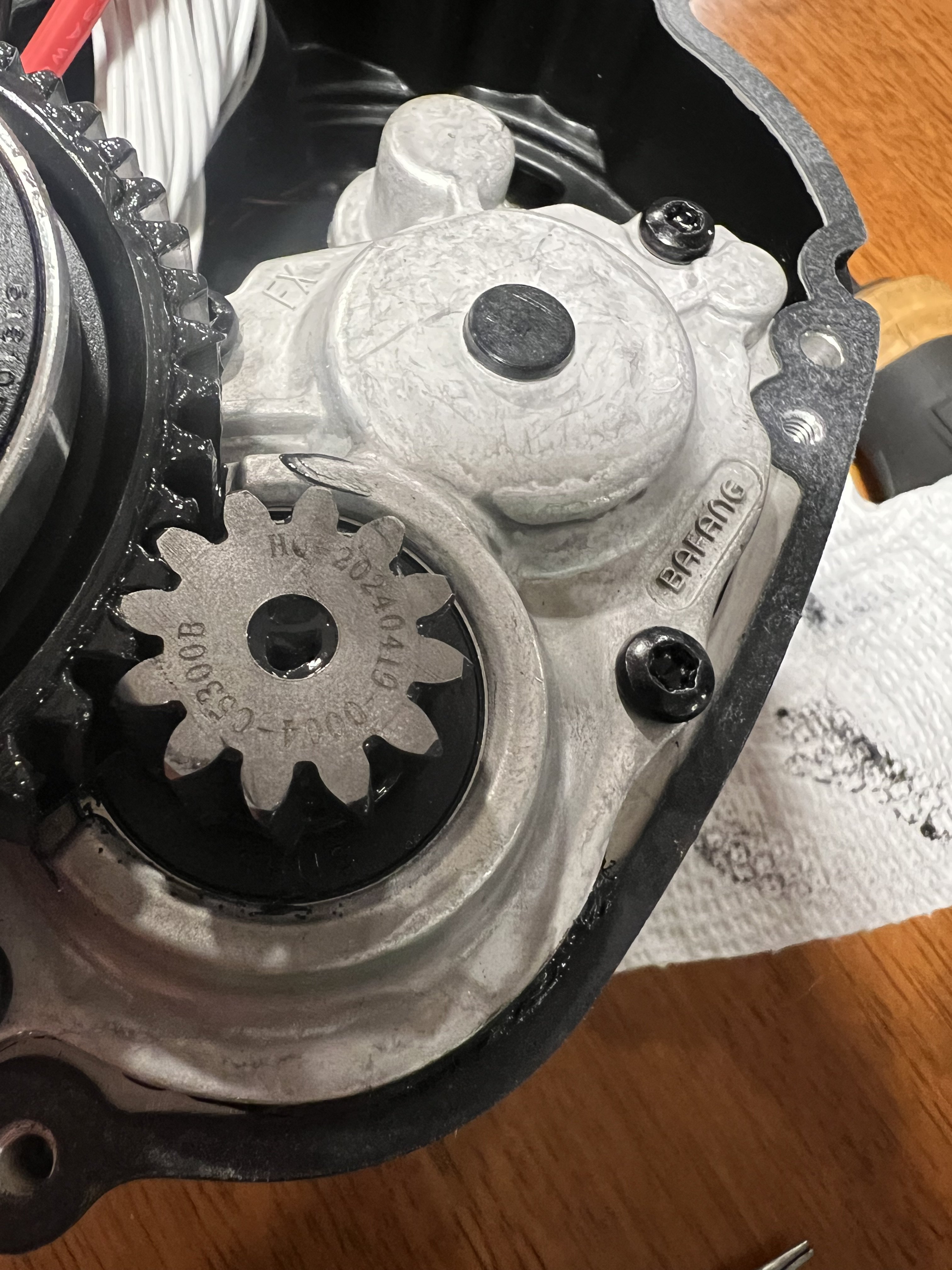

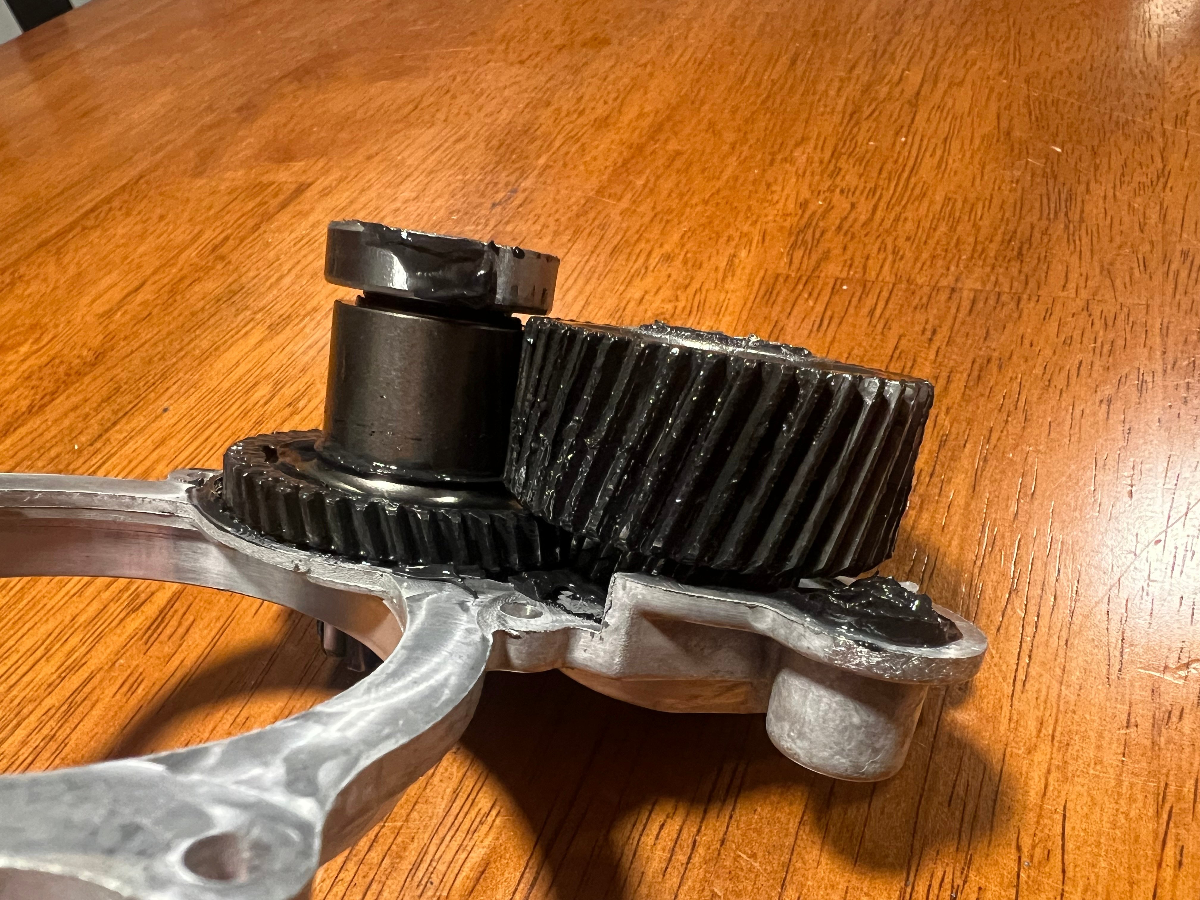

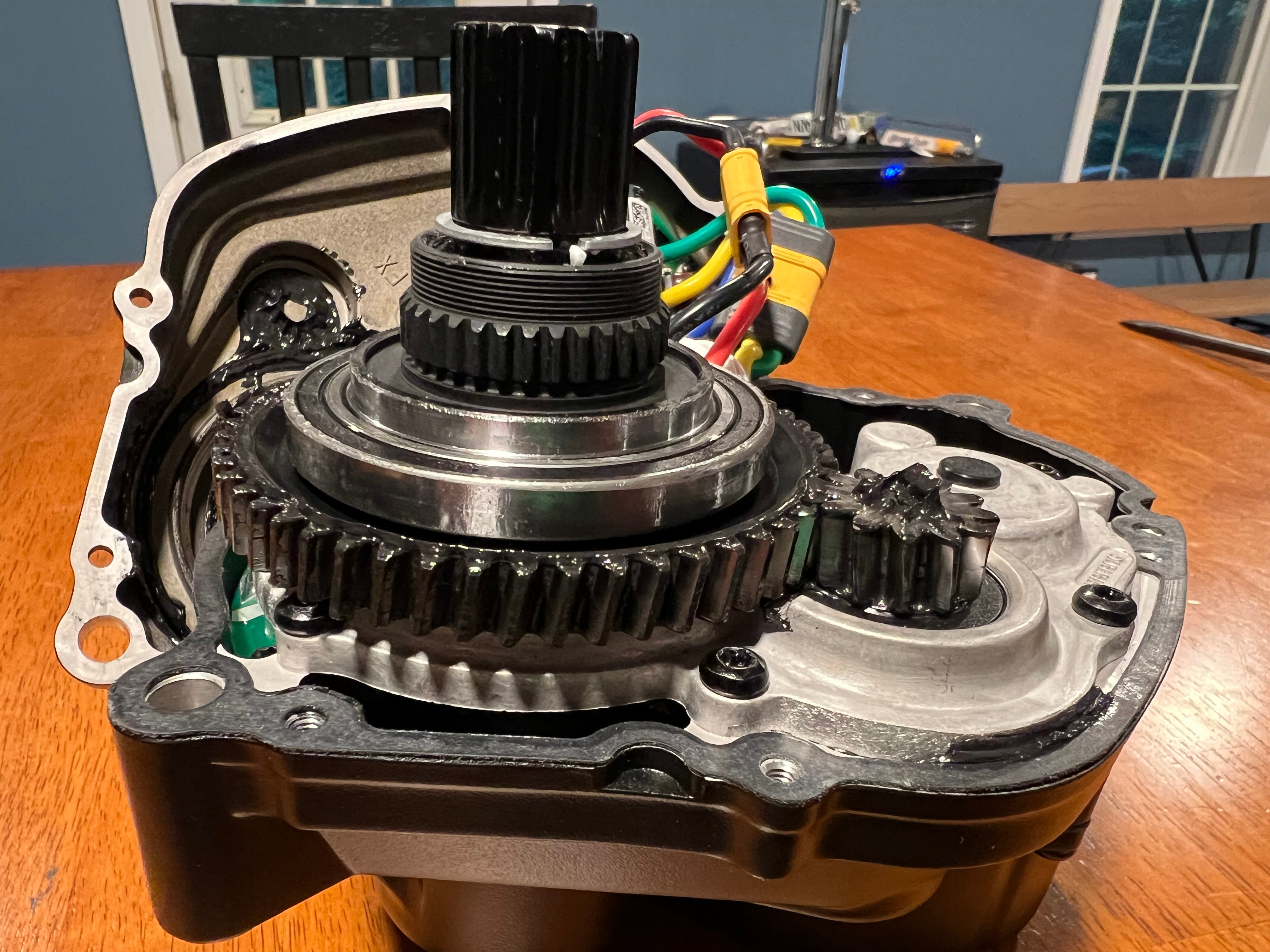

I just got my “new” 750w M560 in yesterday.
This was as far as I went for now, how do you get the large gear off of the main driveshaft to come up so you can get to the gearbox? I tried removing the snap ring but everything still seemed really tight.
I don’t have my battery yet so I can’t do any sound tests. If nothing else it’s at least pretty new stock, the manufacture date on that small gear was April 19th.

Just the circlip and use 2 levers so it comes up evenly.
Watch on YouTube M600 tear down

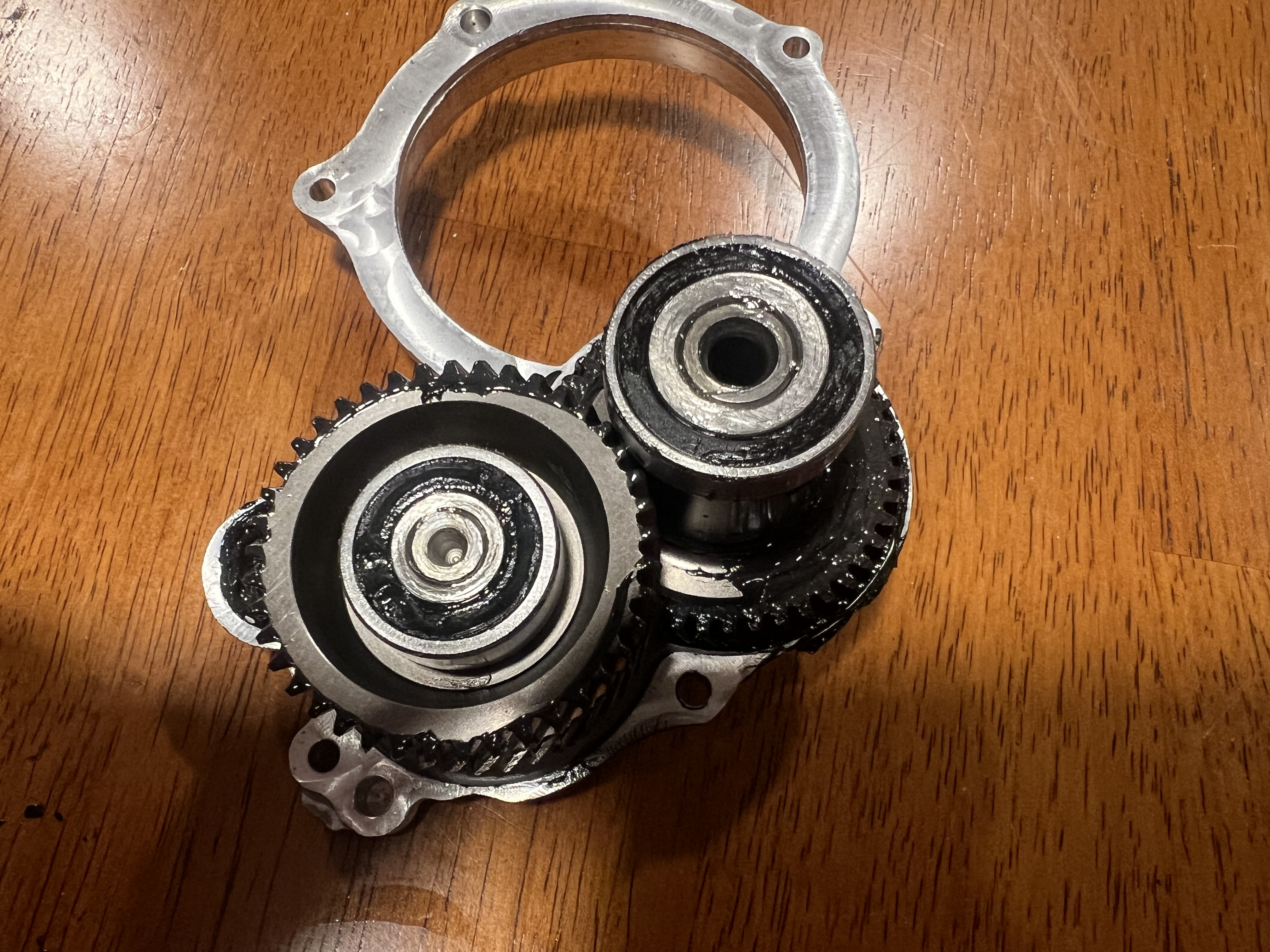

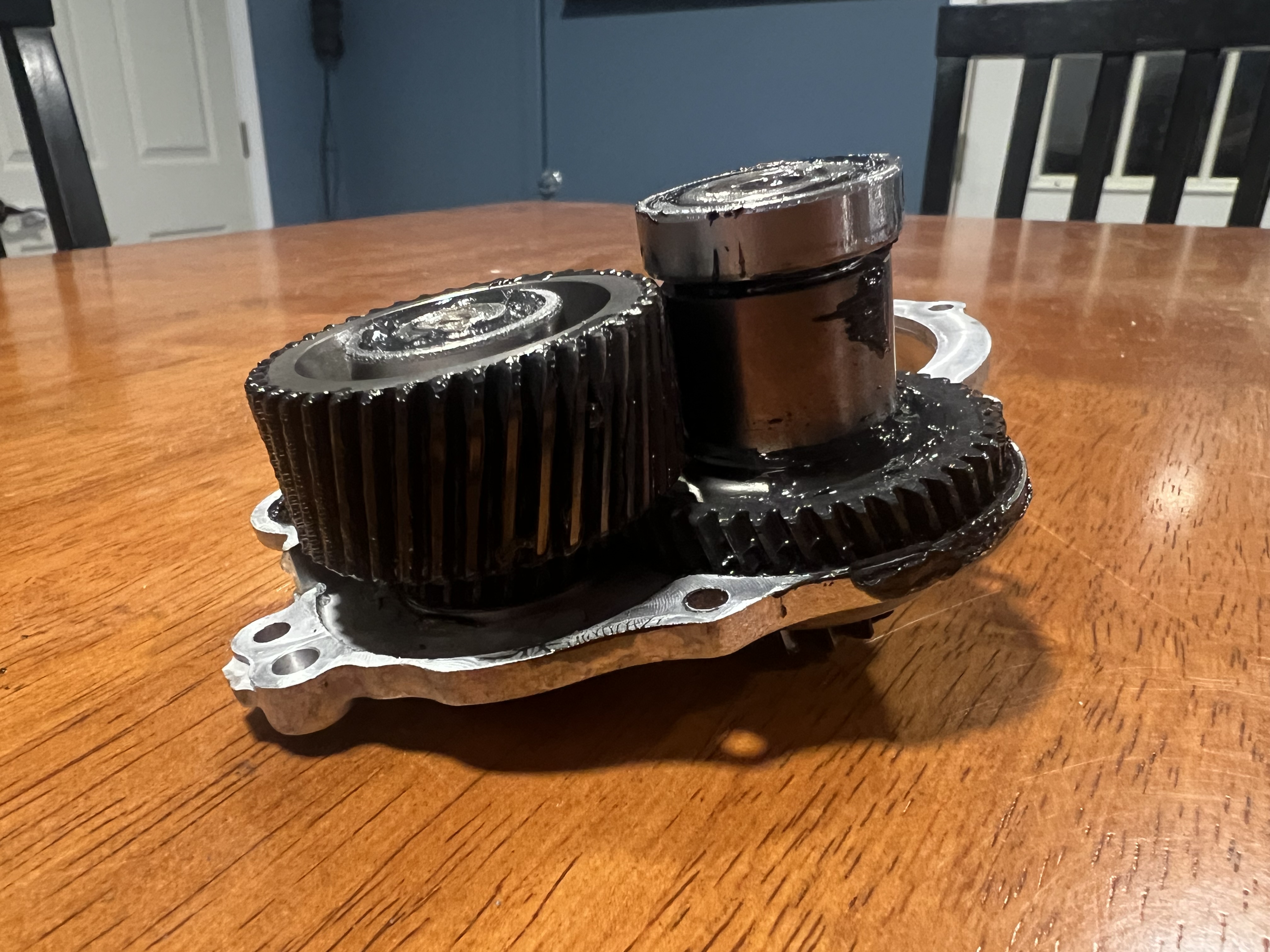

Here are the rest of the gears. I didn’t bother cleaning and re-greasing them because I didn’t have time and wasn’t sure what grease would be best to use anyway (I’m sure I don’t have any).
Can’t say anything catches my eye as being different from the earlier pics, but any small change, even changing how the gears were machined by a few thousandths wouldn’t be noticeable to the naked eye but could make a difference. Itching to get the rest of my parts to build my bike so I can see if it actually sounds any better.

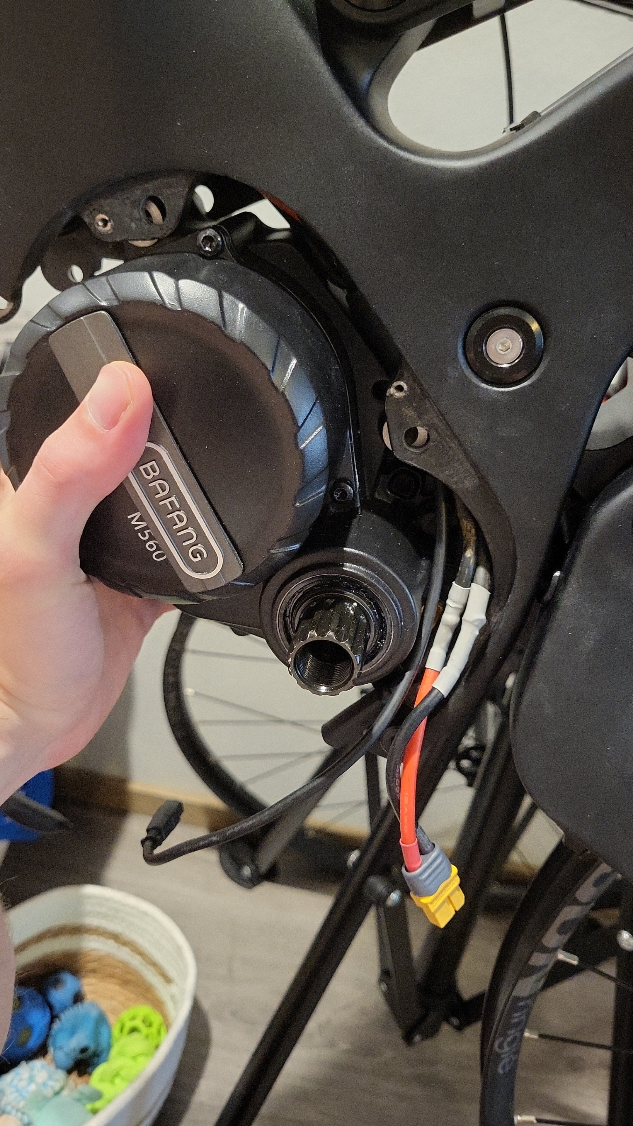

I wonder why no one has brought this up before. The design is quite bad with these connector ports. You have to force your wires to go in a really sharp angle.
What do you mean? All the connectors are in same place. All of them will have to do really hard bend upwards and then either left or right.
Display and speed/shift sensor cable goes to left and then up in my case, there's some space, not that bad. Battery cable needs to be bent quite strong.
Oh. You were able to get them go below the top mounting bolt? I will try that later. Thanks.
Although this way they also have to bend quite hard but only once.

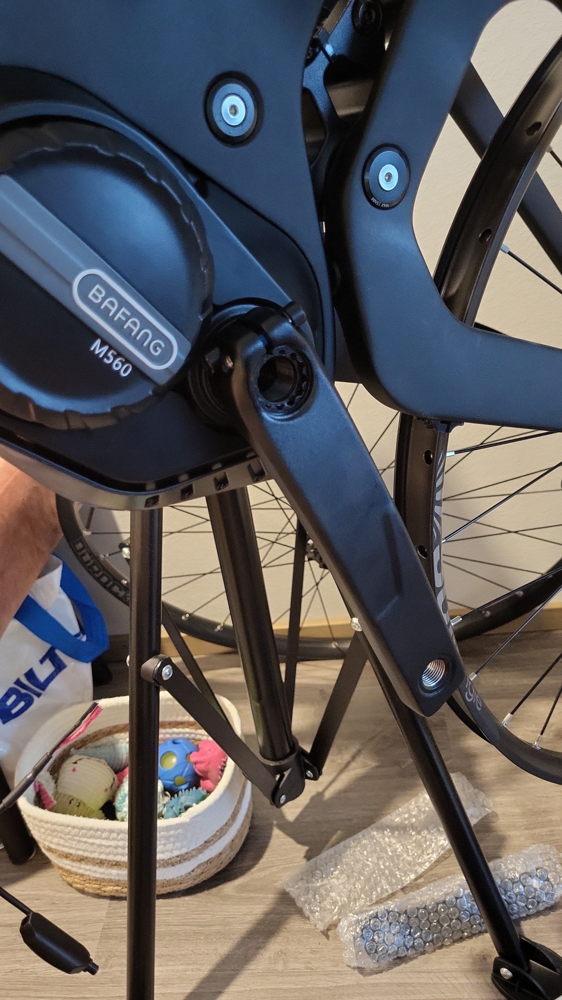

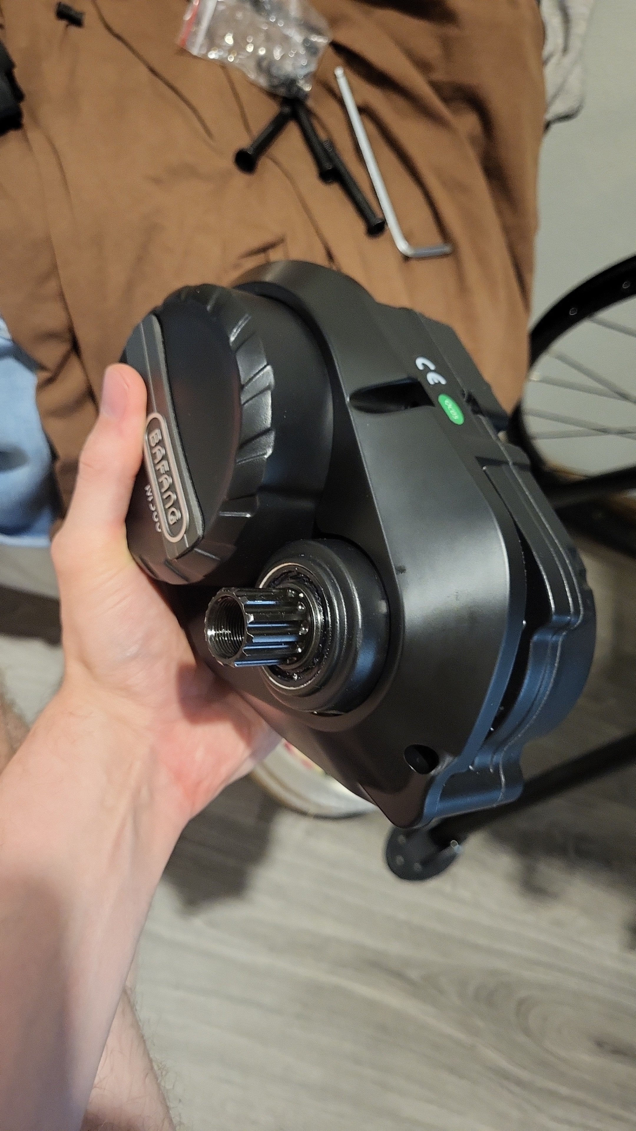

When I spin the crank there is some resistance at one point. Only one place in the whole rotation. Is this normal or is something wrong?
There is a clear point where there is a "small bump" during the rotation. Is there a maybe some magnetic thing at one spot inside the motor or is there something wrong with the motor?
Don’t think I feel that on mine. Haven’t tried putting cranks on yet but I have spun it from the chainring and I don’t remember feeling that.
No, there should not be any "bump".
Do u have the screws of pedal tighten? Seems unscrewed, then it can bump into stator part.
No. They were loose. I thightened the crank bolts and it fixed it. Thank you! 😁

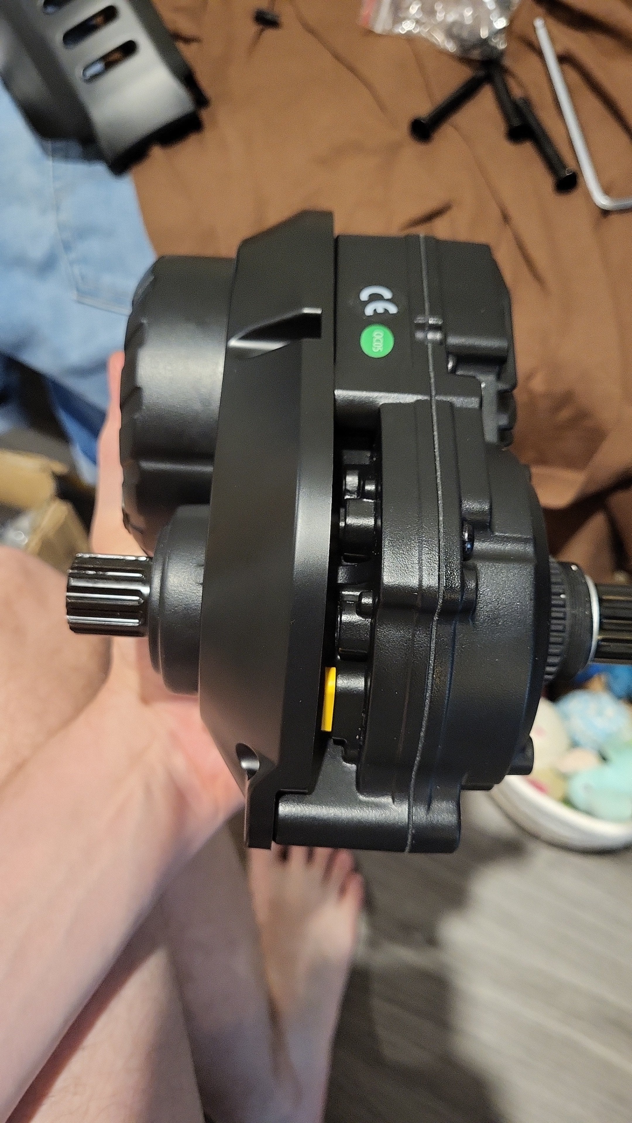

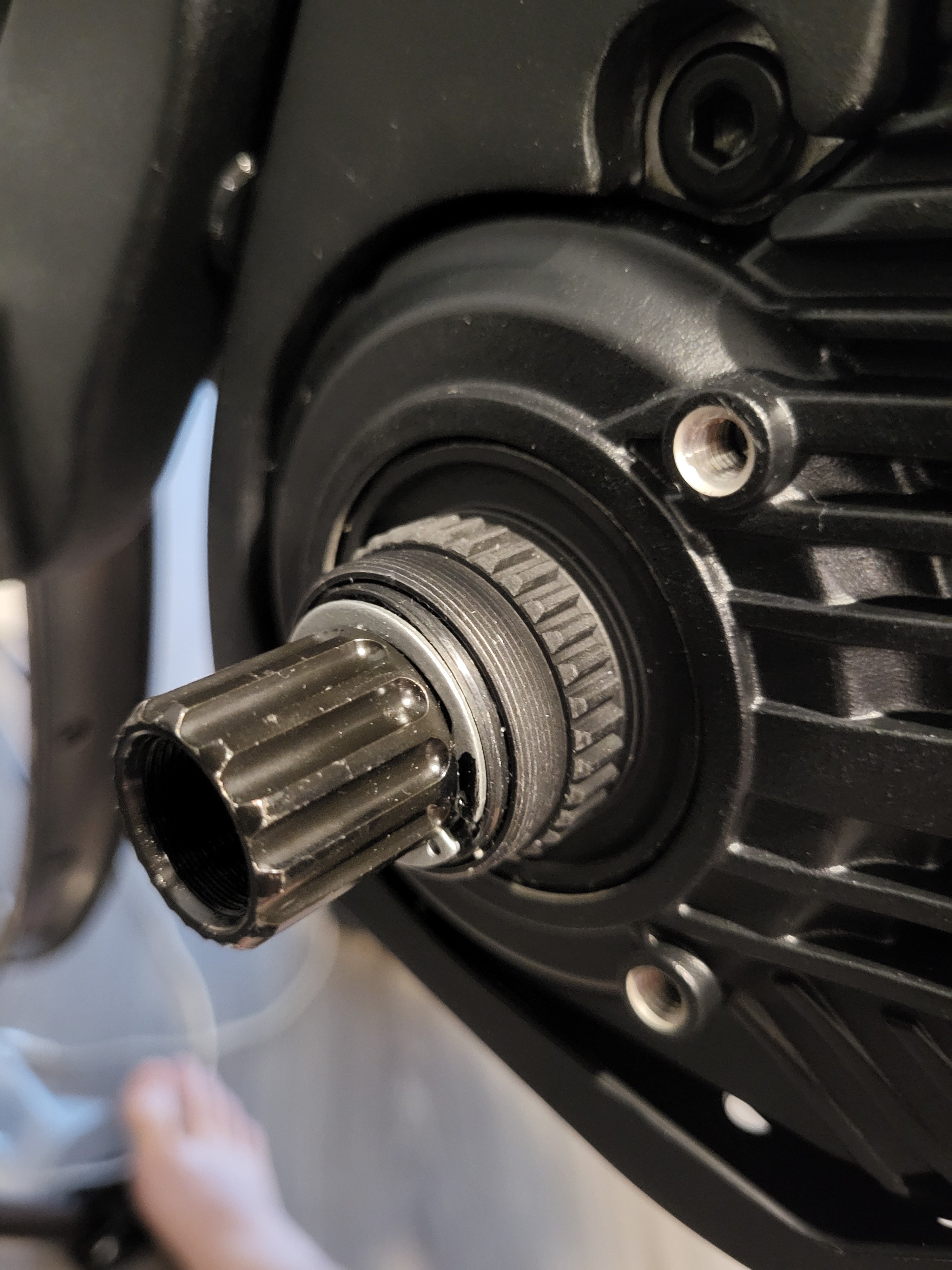

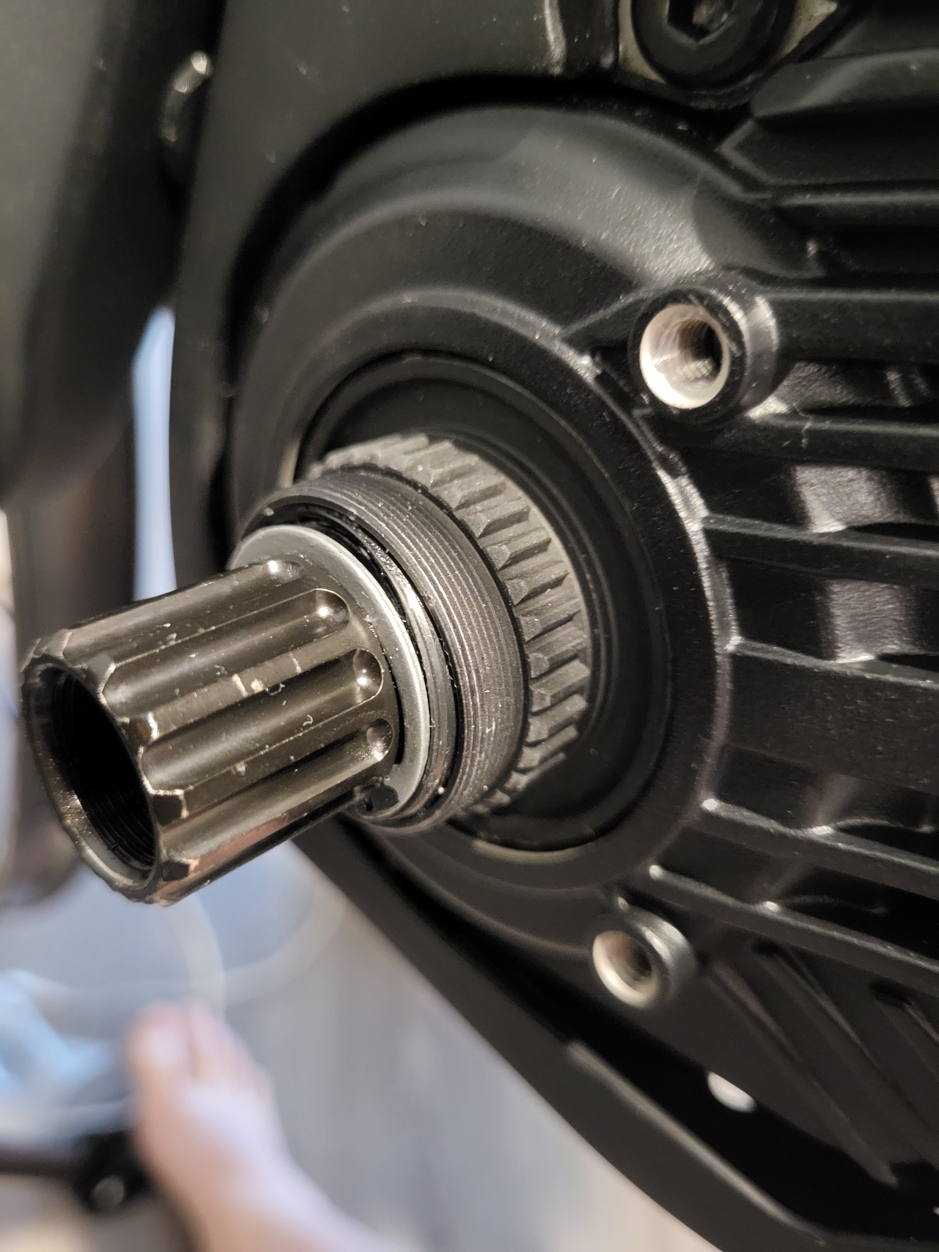

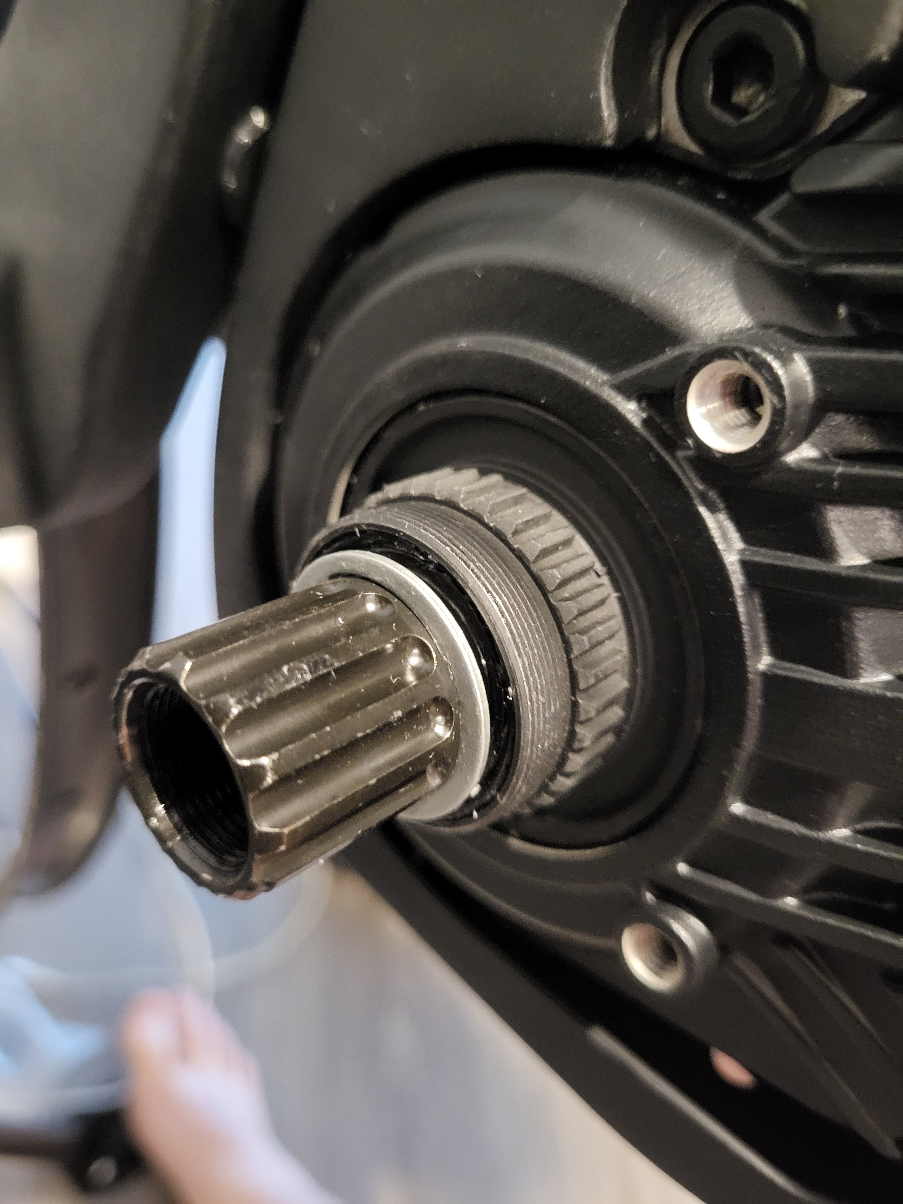

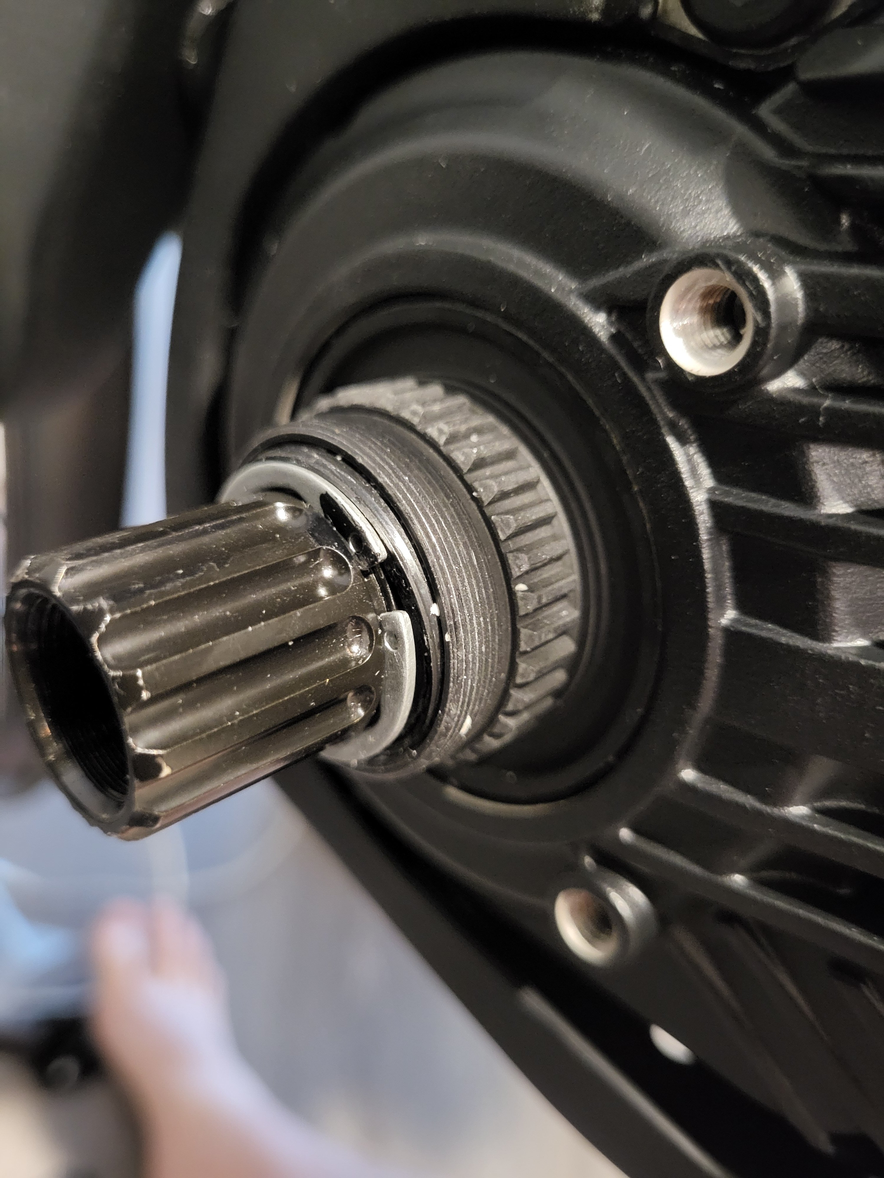

Okey. Next question. Is this part supposed to be like this? Feels like some kind of seal. It's unevenly in.
20240628_173419.jpg 20240628_173415.jpg 20240628_173411.jpg 20240628_173359.jpg
Just take the circlip off remove the seal behind it, check that’s not damaged, grease the inner lips, out outer and push it on using a socket, make sure it stays straight.
you should be able to get a replacement seal from any good local bearing supplier.
