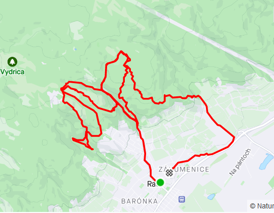

My buddy rides trails in the suburbs of Bratislava (great trails, he gains 1000m of elevation in one ride). Do you ride down trails also on max assist? It's very difficult to go on full throttle on loose slopes uphill.
Ou really? Yes, we have few good trails around. Some legal, some illegal. ;)
Yes, also pushing throttle down the hill, especially on races, but it is dangerous. You get speed over 60kmh very quickly.
He uses an acoustic bike. 1000 meters in 2 hours ride looks like nice hills all around
Yes, thats my favourite gravity trails - Called BK trails and Slalomka. Been riding it and training a lot on these trails.
I know it is not belonging here, sorry for spam, guys. :) If you show up in Bratislava, you would know where to go ride. On top of BK is also nice food shop where all bikers are meeting up, so in a nice day you can find there even 100 bikers.
