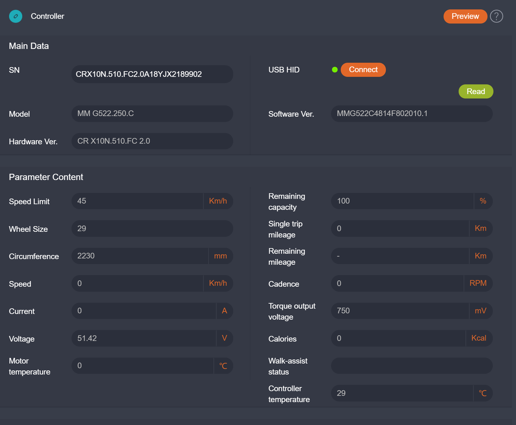

Guys, just got Error 7 - overvoltage protection out of nowhere. Motor sits only on my bench, newer run.
And Besst is reading it and showing normal voltage. Also possible to re-flash firmware. Seeing it is showing 0C motor temperature and 100% battery.
Getting sick of these bafang issues. Anybody has experience or what could have happened?
Edit: Reflash to same 48V firmware did not help. But flash to 43V then back to 48V did help, now works. What the hell?
Getting sick of these bafang issues. Anybody has experience or what could happen?
Dado's son, the ch7 also jumped, but on the m500. .I deleted it and told him to charge the battery in the fable. Since then it has been shown that it could start when inserting a charged battery.

Here I had battery at cca 51V for weeks with no charging (it is 48V battery).
Yes, can give you Err7 when u using 52V battery on 48V firmware. But should disappear once you get to allowed voltage range.
