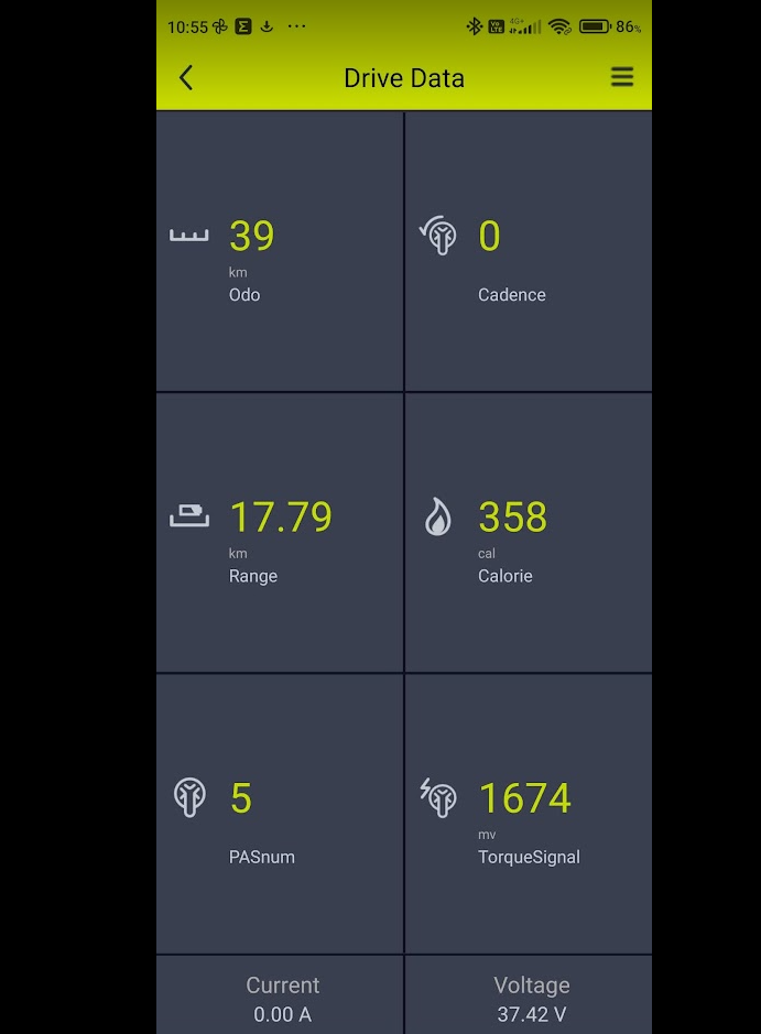

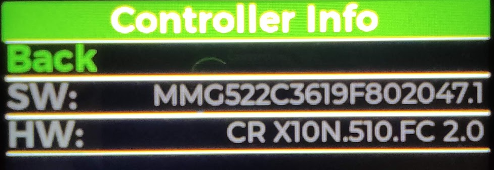

So I got my FC2.0 controller fitted and finally manged to upload a 48V firmware (MMG522C4814F802010.1).
Quick test ride revealed that the power seems to be 'smoother' and no 'on-off' feeling that the FC1.0 controller had 😁 (y)
Interestingly the motor is now more 'whiny' which I really don't understand, as I haven't touched anything 'mechanical' in the motor?
Problem is that I can ride for a few minutes and then the power just stops :confused: No error codes and no loose wires.
If I switch the display off then immediately back on again the power is back, but then 2 minutes later, no power again....
If I put heavy pressure on the cranks (when pedals level i.e. in a horizontal position), the power returns (no need to switch the display off and on) :unsure:
So I'm wondering if:-
a) I need to recalibrated the controller / torque sensor? or
b) the FC2.0 controller is indeed not compatible with the FC1.0 torque sensor?
Is anyone successfully running an M510 with an FC2.0 controller and FC1.0 (SRxxxxx serial number) torque sensor?

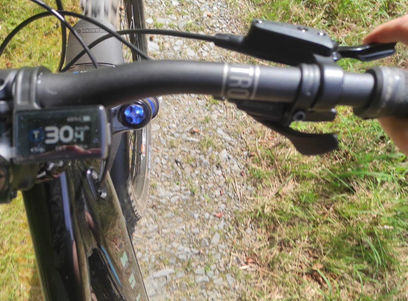

I have to say, I'm really impressed and surprised with the M510 FC2.0 !
Noise wise, it's slightly louder/higher pitched than a Bosch Gen4 for example, but not in any unpleasant way.
Also on the noise front, it has the Gen4/EP8 rattle from the clutch on rough ground when you don't pedal.
Mine has E,E+,T (Tour), B (Boost) and R (Race). E-Mythique.
Support is consistent with the other motors except if anything the M510 has more lower and mid range support. Even if you ride awfully/Granny Style and find yourself in the wrong gear, it still pulls you through really strongly. Top end support, it feels similar to the Brose/Bosch Gen4 - I've not ridden it enough to really give an exact back to back on that. It certainly gives you as much as you need.
Assistance for effort, it gives more. Slightly too much really compared to what I'm used to but it just means using a lower assistance mode if you want a work out or more distance/altitude - otherwise you'll flatten the battery quicker than you intended to !
Start up, the way mine's set you have to rotate the cranks more on a steep start than the other motors (Startup Angle) - but this could be adjusted with Best Pro as it's not that easy to get going as it is by default.
Walk mode seems to work fine.
As it gives more assistance for effort and has a longer over run than a Bosch or a Brose, it takes a moment to re-adjust so you get nice gear changes ! You have to back off slightly more and slightly earlier, once you've got used to it, it's very natural and easy to ride smoothly.
The motor certainly is the "smoothest" of any motor I've tried with the transition from assisted to unassisted (25kph for me). It feels like it limits power slightly before 25kph but then ramps down after 25kph. The gen4 does something similar and ramps down between an indicated 25kph until an indicated 26.5 ish (GPS real 25). The M510 feels like it ramps down over a pre-set time period combined with a speed range - 2 seconds for example (I'm not sure exactly what it is). If you're absolutely gunning it as you hit the limit, you're still getting a reduced level of assistance afterwards, in my case upto 28kph at times as it smooths the transition rather than just dropping off. It's a really nice way to do it and makes it far easier to push on and ride without assistance than with the other motors :
Its a bit early to say for sure, but I think it reduces power slightly as you near the limit - so if you're the kind of person who rides close to the limit a lot, I suspect de-restricting could have a more significant impact on existing range than it would on some other motors.
The DPC245 is a really nice clear display with all the information you would want. The extra screens with additional data are fantastic with lots of extra battery information you don't get with other systems.
The mode switch is also nice, small and works well.
Bluetooth is easy to setup/connect with "Go" and as that seems to have been re-vamped it works well with lots of useful information and theoretically the options to update firmwares over the air or from a local file (don't know if it works).
Great motor !

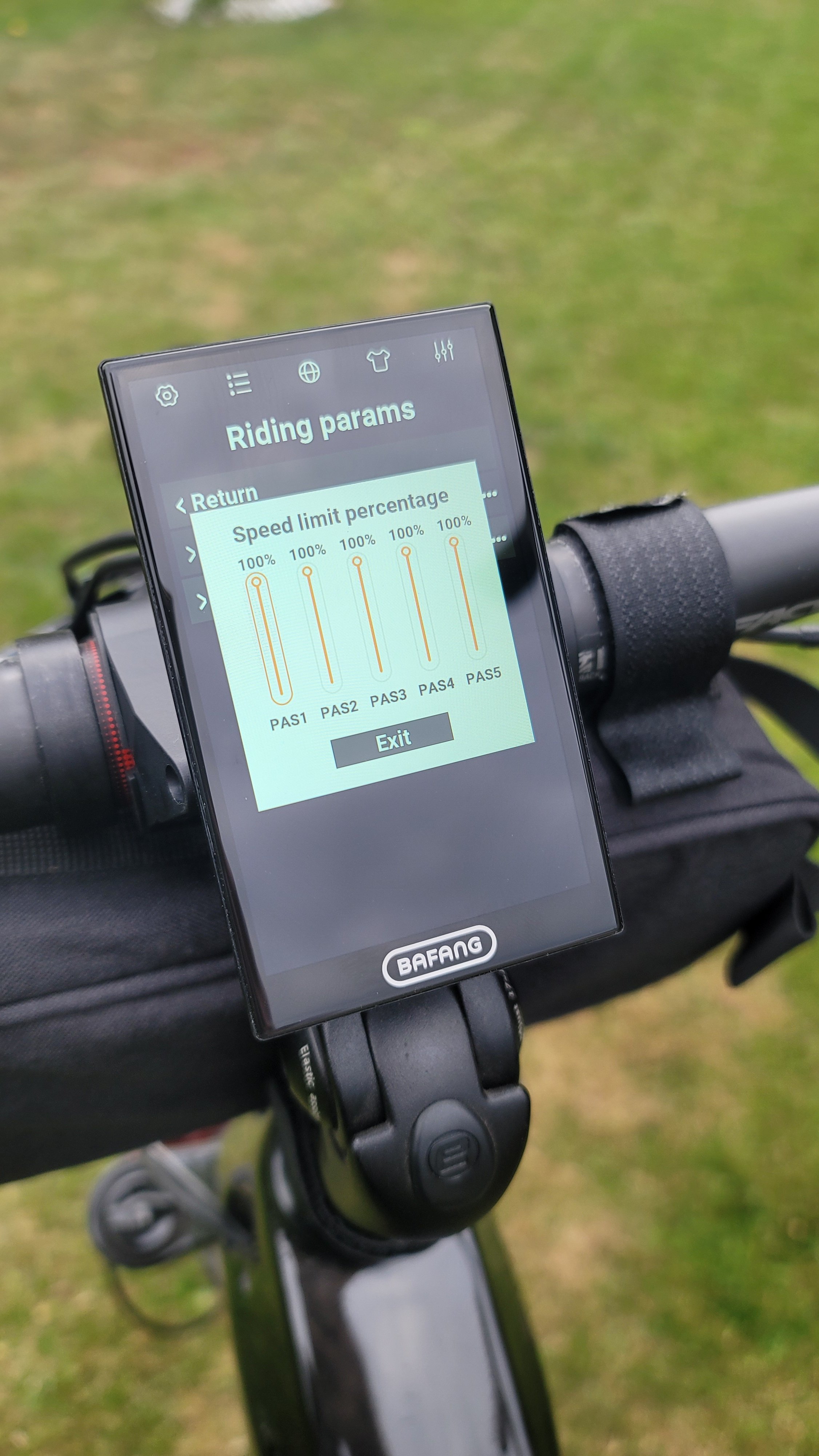

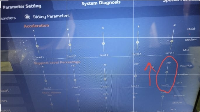

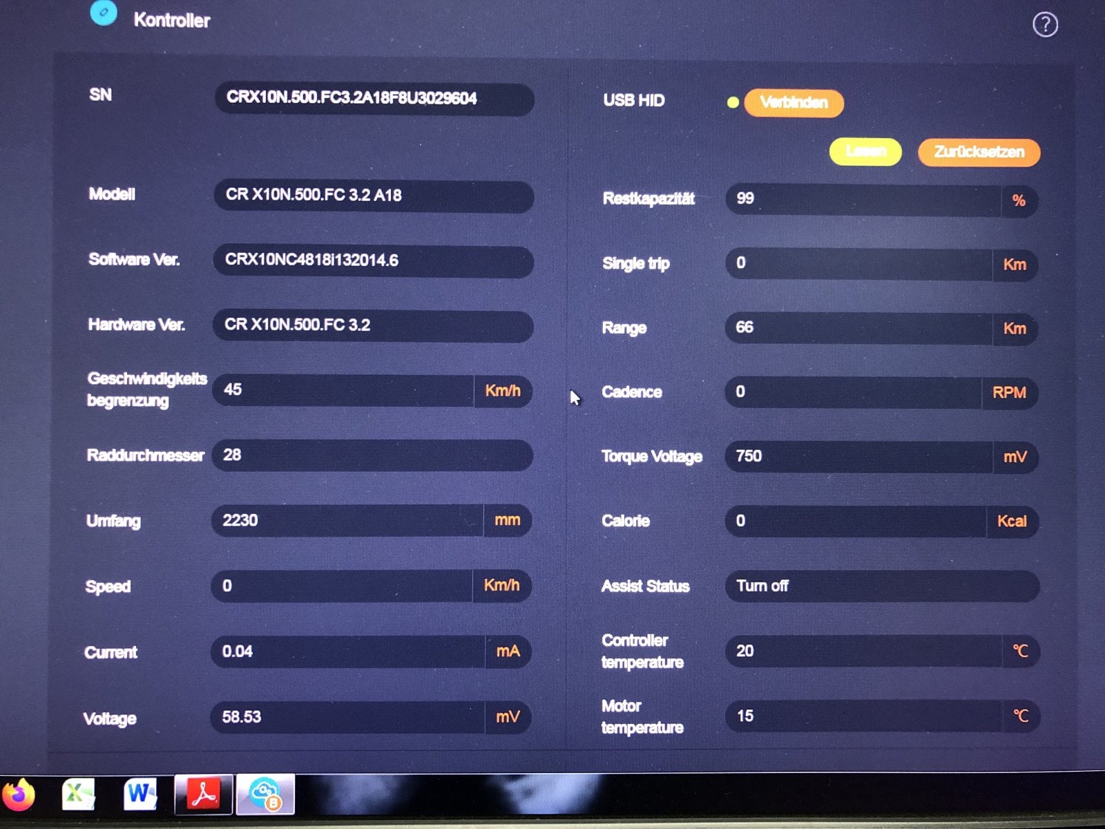

The Motor is factory set with only two-thirds of its power. The last third is still not open.
Use Besst pro to adjust the settings to the highest level.
Use Besst pro to set Level 5 support to 500 percent, instead of 340 percent.
Set the acceleration to 8 instead of 4 at least for levels 4 and 5. You'll reach 25 km/h in half the time that the motor is set to now.
Try the motor, then you will be surprised more and more.
You can also set the Startup Angel to Small.
Bafang does not set the start-up angel to small, Because once you touch the pedal a little, the motor will start.
Therefore, the bike may slip out of your hands if you are walking alongside the bike and touching the pedal or spinning it forward a bit.

I use the new bigger display with bluetooth too. it is impressive.
I can control the current support and the speed for each PAS.
Bafang GO + works with the Display via Bluetooth without problems.
It is also theoretically possible to receive an air update.
I set the motor speed to 25 km/h to comply with EU law, but the motor keeps running up to 26,5 km/h.
What do you think is the reason?
You need to adjust the wheel length via BESST tool, the default parameters set for 26" , 27.5" and 29" do not always present to be 100% correct, tires do play a factor in this, causing this little deviation.

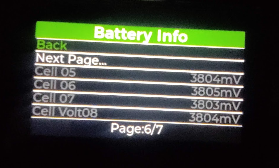

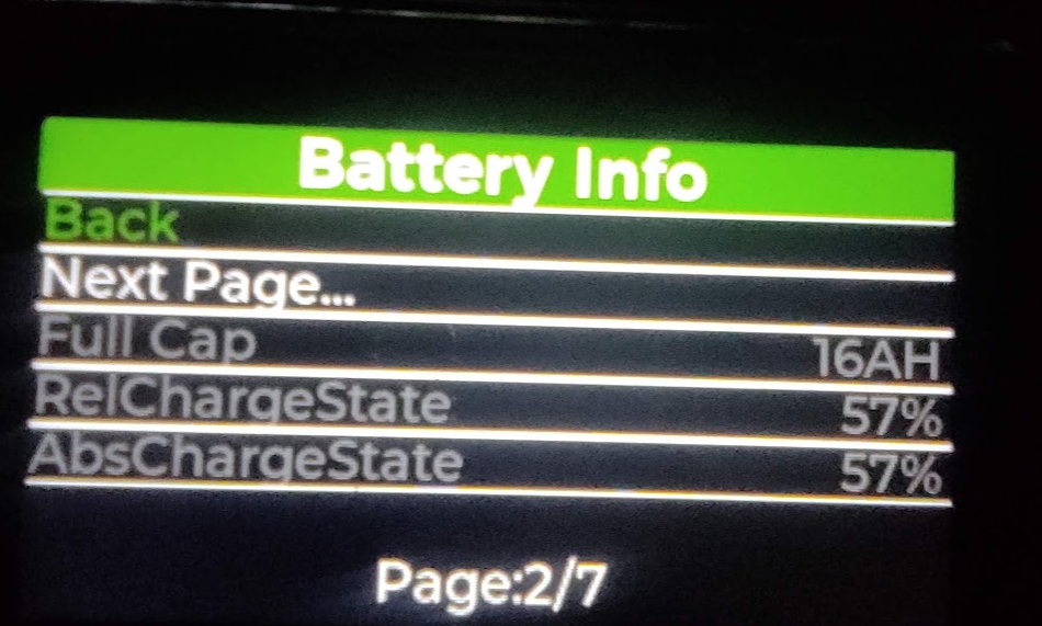

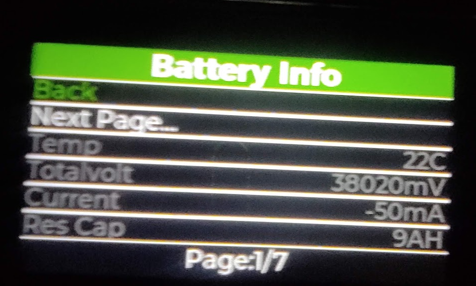

The DPC245 is really nice .. Try and get the v3.0 if you can then you have bluetooth 5.1 (works with Go+) v2.0 has 5.0 so only works with Go (it will connect with GO+, but says its not compatible).
It auto adjusts to different light levels, which you can override and also set the sensitivity levels.
And yes, plus you can also see the cell (bank) voltages - so far the battery % shown is accurate to the charge state, haven't run it flat yet to confirm if zero is zero though !

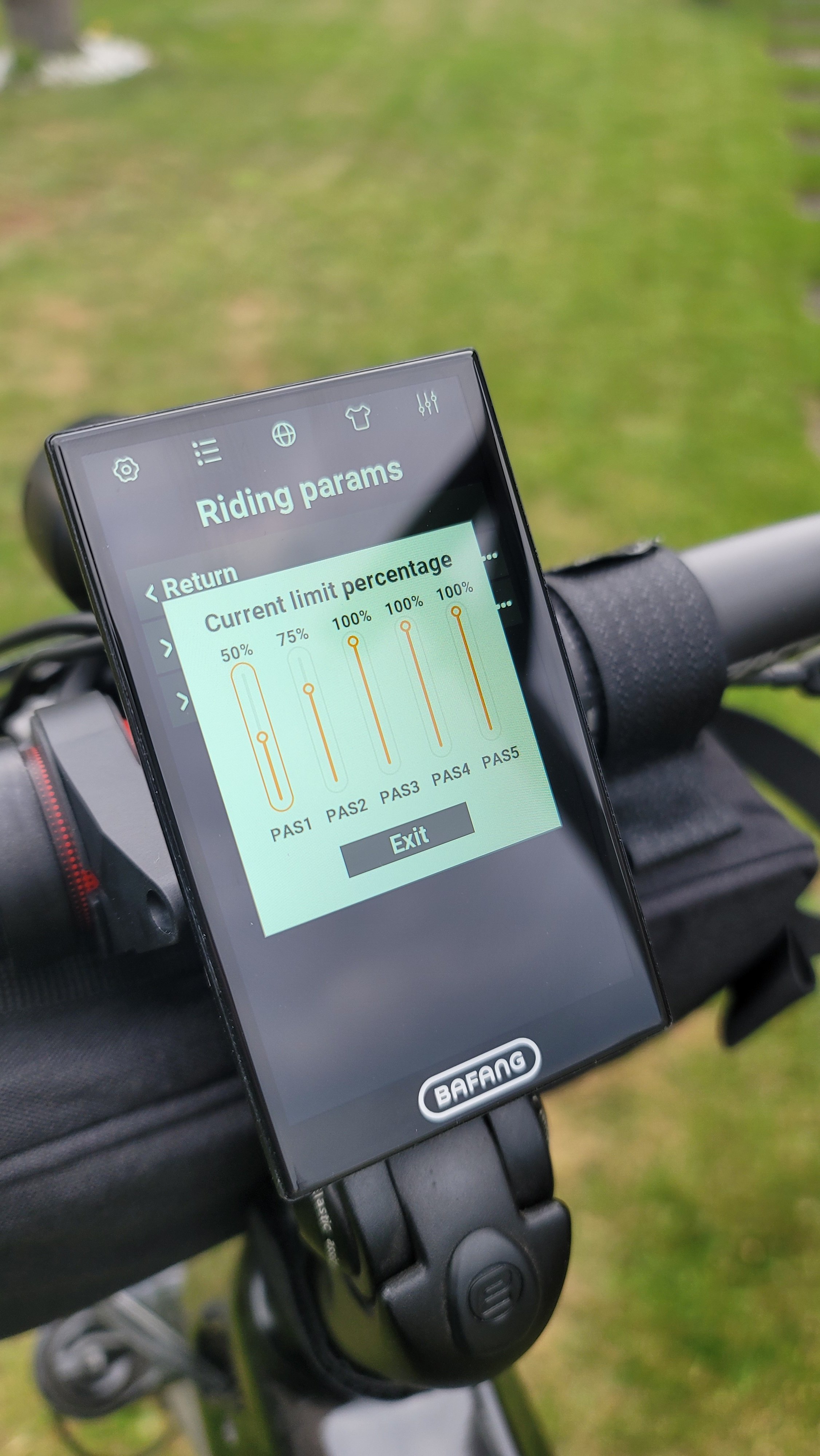

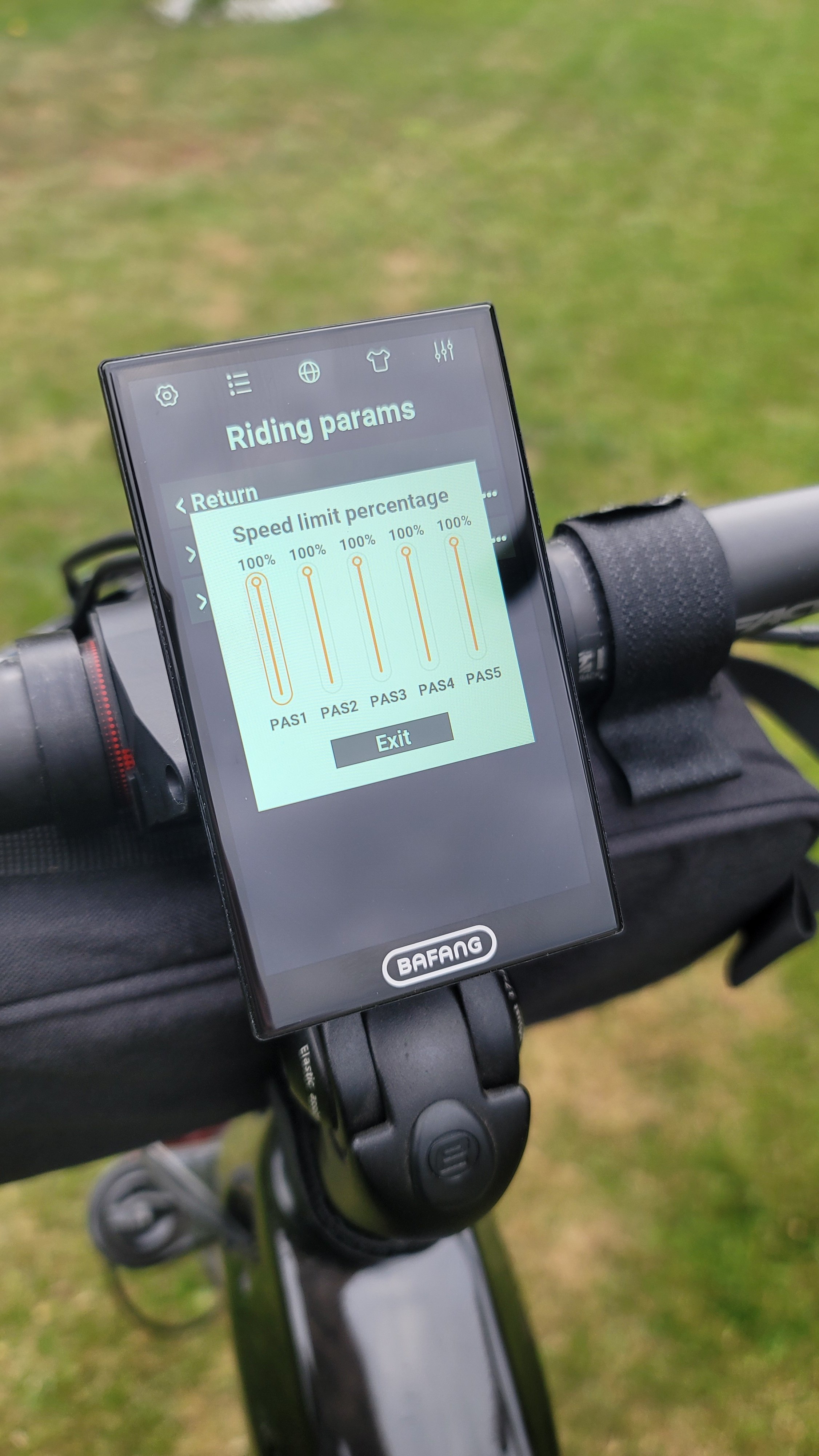

Thanks for the quick answer, i wanted to know if there is a possibility to show battery voltage at main screen, during ride, like for example with C18 display. Also those E, E+,T, B, R stands for old 1,2,3,4,5 power levels, correct?
Yes, the power levels correspond, but I'm guessing Vitus picked their own labels with the E,E+,T,B,R - That's not the standard labels. They're normally :
I don't think you can show Voltage on the main screen. There is a page to configure styles, but mine's all greyed out.

Are you sure that battery infos work with all battery or only with bafang battery ? it seem you have the VITUS ? does trail mode work alike bosch EMTB ? It's seem in their power graph that it work between 140% and 300% of assist.

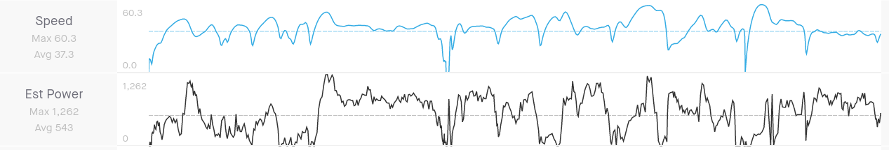

Thanks for that ! I hope to play with the settings more once I've spent some more time with it. For the moment I just want to compare it in it's stock form with the other motors to get an idea what it's like.
I did tune my e8000 a few years ago with more torque, power and the support. It felt faster, but it was also not as refined and when testing back to back, wasn't actually really any quicker.
The Brose does feel slightly more powerful than the Bosch. Mine's pulling 20amps, so peaks at about 820-840w on a full charge. Performance wise, it's slightly faster on climbs.
I'm not sure the Bosch doesn't perform on flat ground though ? On the default settings, it gives a lot less support in Eco than the Brose (but you can dial the Brose down to match). I find the distance/altitude I can get from the Bosch with a 625wh to be massive compared to anything else. Just ride in Eco and try to "surf" in the transition point between assisted and unassisted where it gives you just a tiny amount of support. I can't imagine the M510 with it's present settings will give anything like that, it assists too much - which is obviously great when you want assisting more ! :)
No idea, sorry. Yes, I have the vitus, so that's the BT F16 630. Don't have anything else to try it with.

Just went out for a quick mode test to watch the power.
E+ is certainly the most like EMTB. You have to put slightly more effort in for power out and max power is slightly less, but it's the mode which feels most similar. Peaked at about 480w.
Trail mode is really nice, but it gives power too easily. If it was steep, I was receiving 500-550w for virtually zero effort. At lower speeds there were lower Watts, but it still ramps up too easily. It peaked at about 600w.
Boost and Race both peaked at 725w - so about the same as a Brose 2.1/2.2 with any firmware after 7.4.2 when voltage compensation was introduced and the peak power was dropped slightly to accomodate.
Edit : I forgot .. I also tried really hammering upto the assist cut off and the highest speed I was still getting assist was 35kph (25kph limit) .. really does ramp off smoothly !!
I suspect more and more M510 owners will have displays with bluetooth capability, so can use Go/Go+. Go+ certainly offers a lot more than Go and it's a shame they've limited that to Bluetooth 5.1 and not the 5.0 displays.
As there doesn't seem to be any security, I wonder if @Dado @vadII or @PaoloBLEvo have thought about doing an app for the Bafang's ? There's various additional functionality available in Besst Pro which isn't presented in Go or Go+. There's then all the additional data gathering, mapping, tracking, on the fly adjustments they could possibly offer in an app.

The speed limit is set at 25 km/h.
However when I put on a low gear I need to rotate the pedals more than usual to get the bike to move.
(I'm doing this for experimentation because it doesn't make sense to go into low gear on flat ground).
Only in this case, and when I exceed the 25 km/h speed, the motor does not turn off, and there is still a watt consumption of about 20w.

36V is 19A. And it measure the current really well.
But you can try 43V 16A with 48V battery. ;) Soon will try with setup:
Will set pass 0-5 to 0-700W. Expecting throttle would still work on 800w, so throttle will be a boost. Would know I shouldnt hold full throttle for long.

I can assure you that there is no voltage compensation for M510, well so far. I'm using mainly first power level, and it pulls around 3.6-4A here according to HMI. When your battery is below 25% it enters the "limp mode", cutting the power output by basically a half. I measured at first level something around 1.8A. Bike is considerable slower but still rideable.
