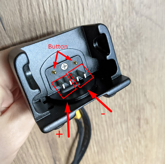

About "err 27", on mine bike. dengfu E10 with dengfu battery, i have one switch on button for the battery on frame, this button is connected to the battery throug the 2 little pins on the lower battery suport. Several other guys had problem with this switch. To solve it, we have canceled this switch, by welding togetherer the 2 thin cables from this switch inside the battery
For M510 FC1.0 you have 2 firmware whithout delay between crank armq stop and motor stop: 3.2 and 3.1-CS
If you have the latest revision of FC1 (my motor was with preinstall 3.6), you will not be able to flash 3.2 and 3.1-cs. Also in 3.2 there is a useless walkmode.

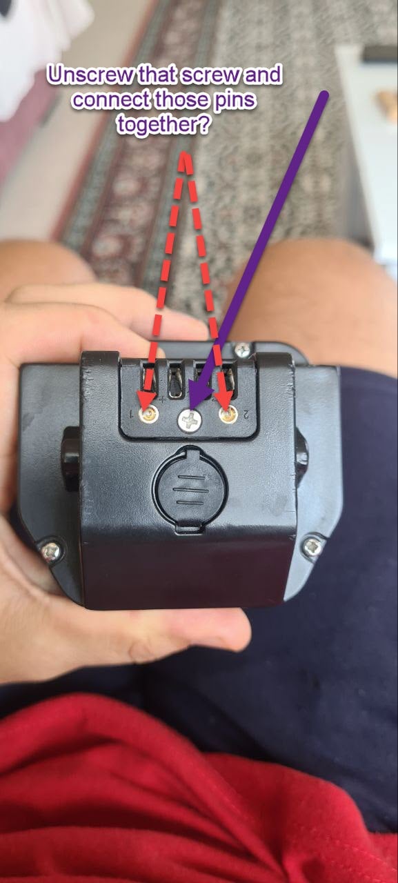

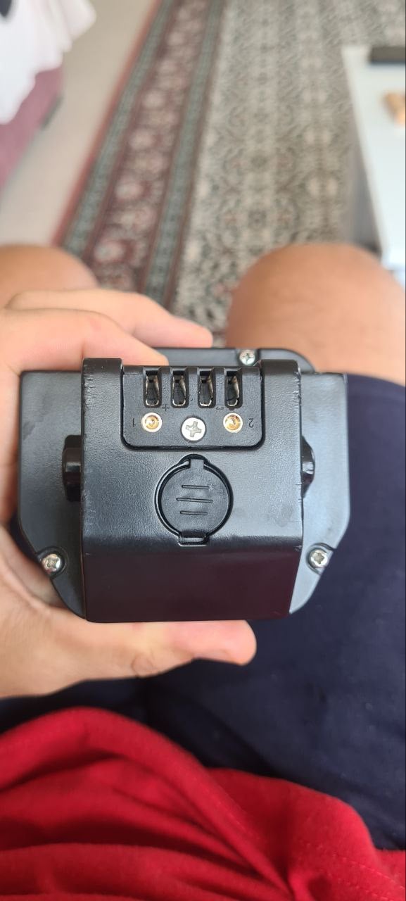

I don't speak about the battery connector to the motor (yellow) , i speak about the little switch on the side of the frame. it is wired to the battery through the 2 contacts flaged "button" on the pic, and with vibrating on mine the contacts from battery side was damaged. the solution will be canceling on.off battery switch by perform pemanent contact inside the battery

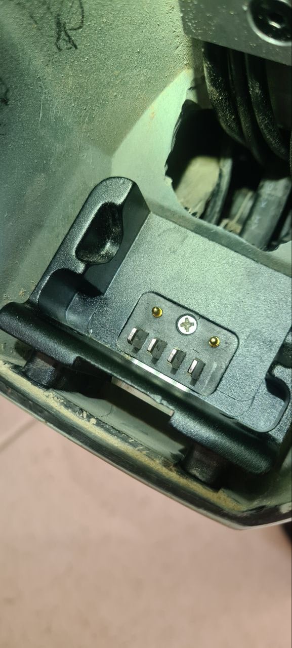

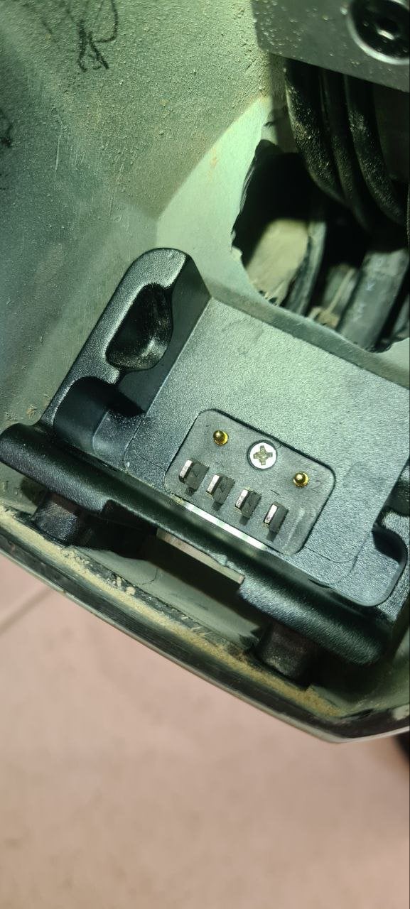

HM. Mine look good. What are those buttons for? What is the treatment? Sorry for the silly questions.
Yes, yours look good, mine haved black color. May be you have another problem ? for me the shunt of switch have solved the problem for my second ride
View attachment 120945 View attachment 120946
No, useless to remove this screw. necessary to remove the four other visible screws (one under your finger) who scel the battery lower end. And weld together the 2 thin cables behind the pins

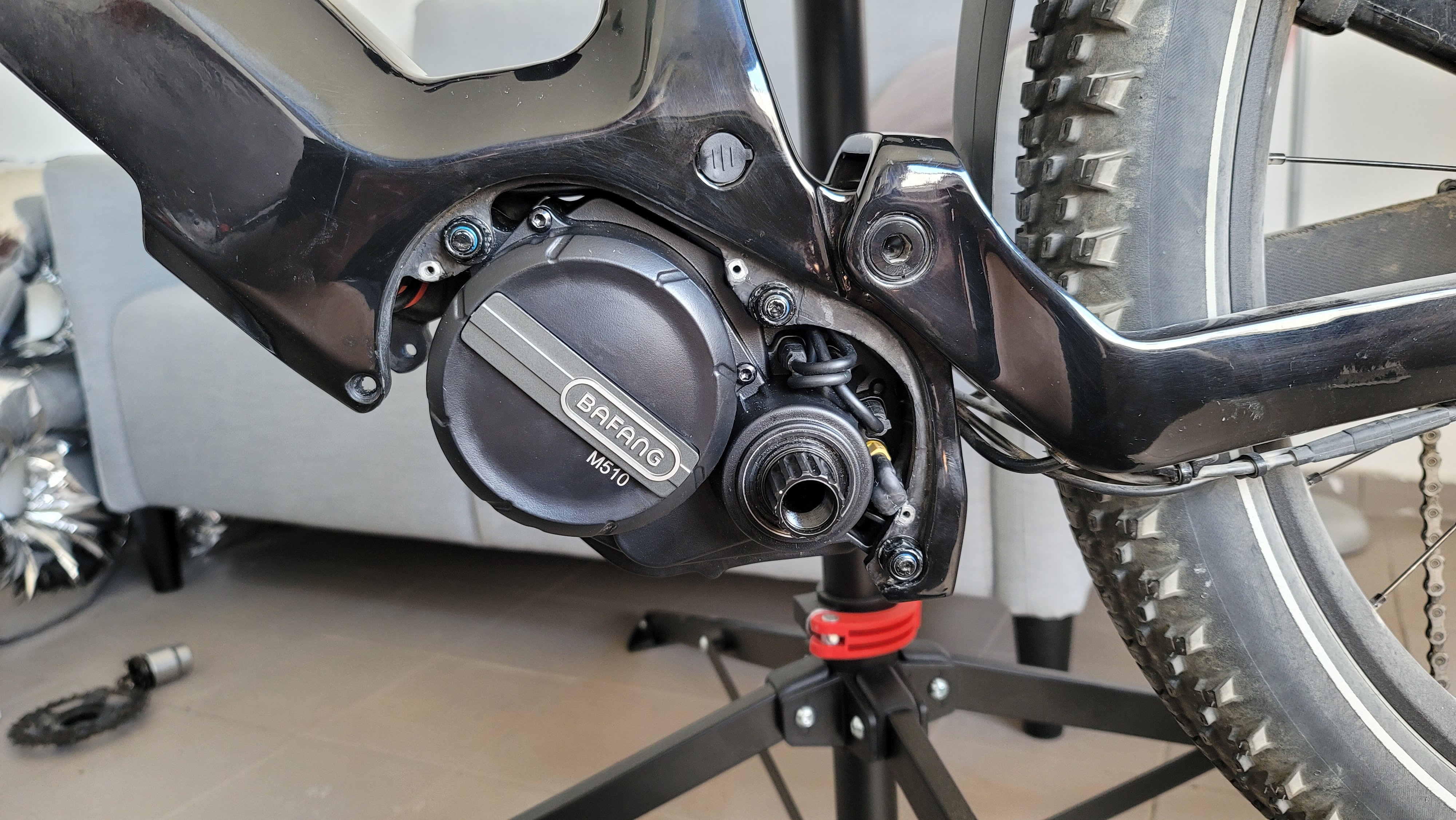

I have lost my M510 cranckbolt also one time on the left side, even when it was secured with bleu locktite. the new one I lost almost again.
Now I secure the left side with green locktite, and it holds. still can screw it loose when needed.
Is it not a problem if the battery is always "on", if you connect the wires inside?
Have you checked the torque of the two crank bolts? The bolt in your picture is only needed to properly position the crank on the shaft. The general rule when using locktite is that all surfaces must be degreased, cleaned and dried before application.
Yess, at first I used the good torque . but they came loose. and the cranckarm was shifting to the outside even when it was good secured.and it was degreased ...My M500 motor had the same issue, but less than the M510.
