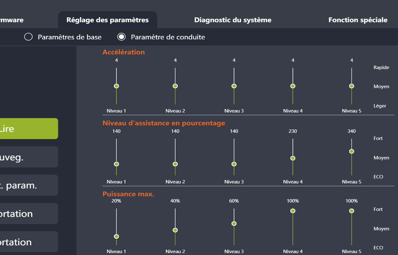

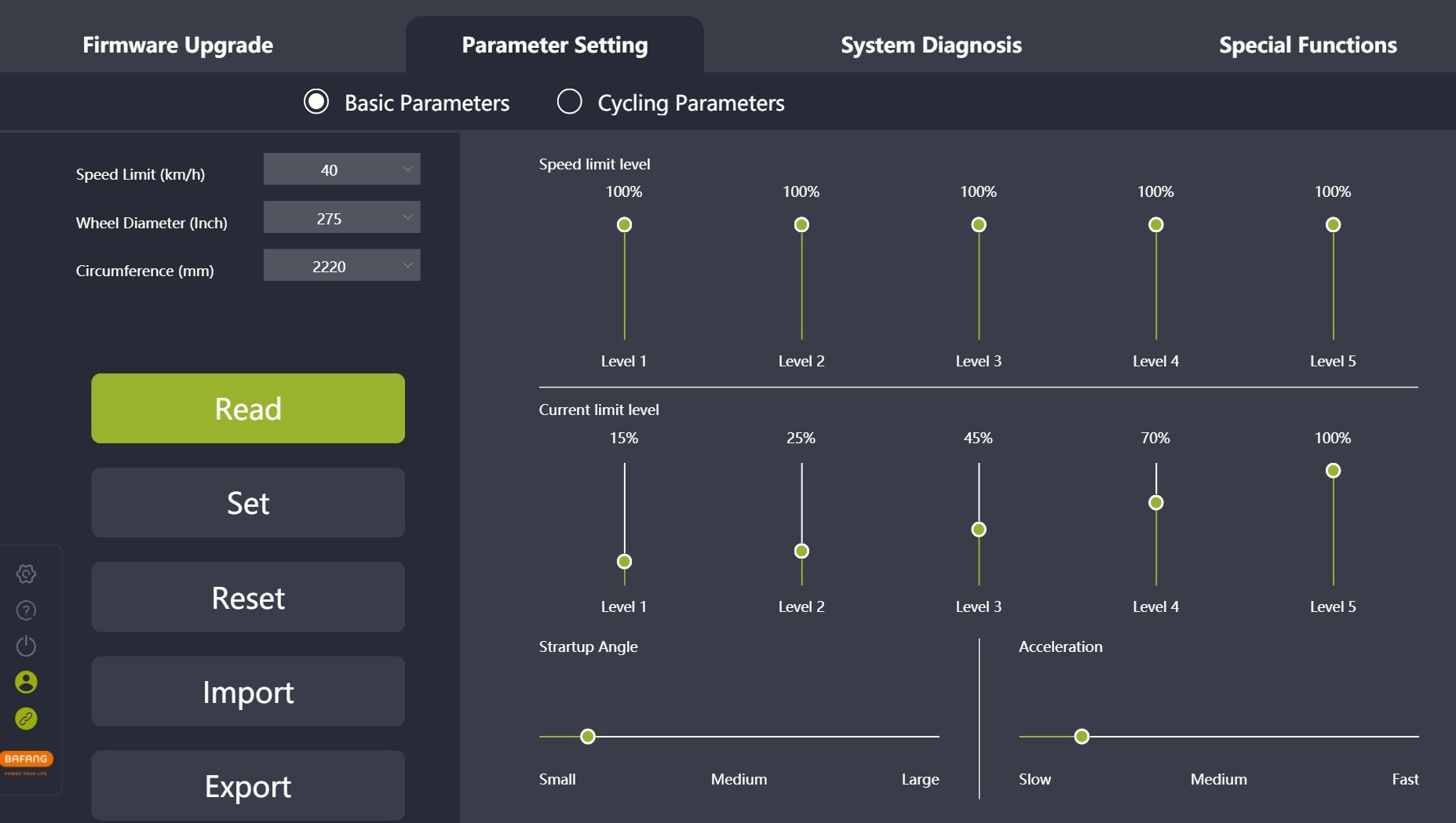

First ride with the FC2.0. Too powerful for me(350W at level 1) and heavy consumtion. Very good upgrade with the dpc245, i can read now the power assist and the cranks arms rpm.
Other improvement now, i can recover in line soft update with the BEEST pro tool. i have updated the controller with 2010.1 rev (bugs correction mentioned).
After soft update, for reading new upgrade and the parameters (custom seeting losed) i needed to remove the BESST tool wire, plug HMI to motor, switch on motor. Before replug the BEEST tool
I ill test these parameters:
acceleration: 1 - 2- 3 - 4 - 4
% of assist: 27-140-140-230-340
power max (%)24-50-100-100-100
any recomendations from experimented users ?

980 m D+ with 61 % consumed (I'm 96 kg) with my custom seeting. 760 m D+ with 76% consumed with original seeting. level 3 is enough for me to climb as i want (if more than 20%, i prefer to use walk mode), i will try
acceleration: 1 - 1- 2 - 2 - 2
% of assist: 25-100-140-140-300
power max (%)25-40-60-100-100

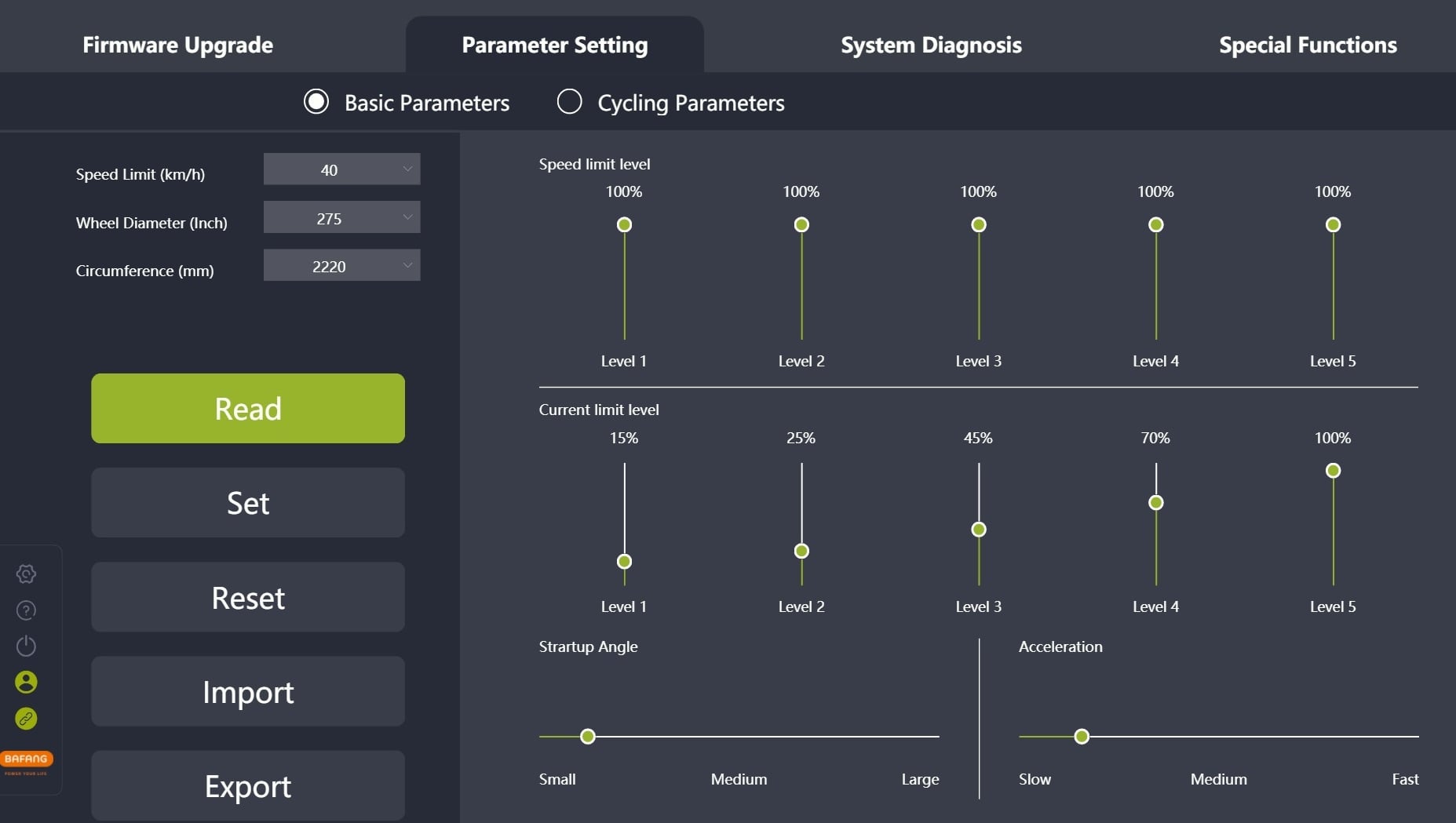

Factory default setting is too powerful, we must set with our need.
This is my setting, level 1 for flat, level 2 for light climb. It will save a lot battery consumption. (I use first version of Besst Pro)

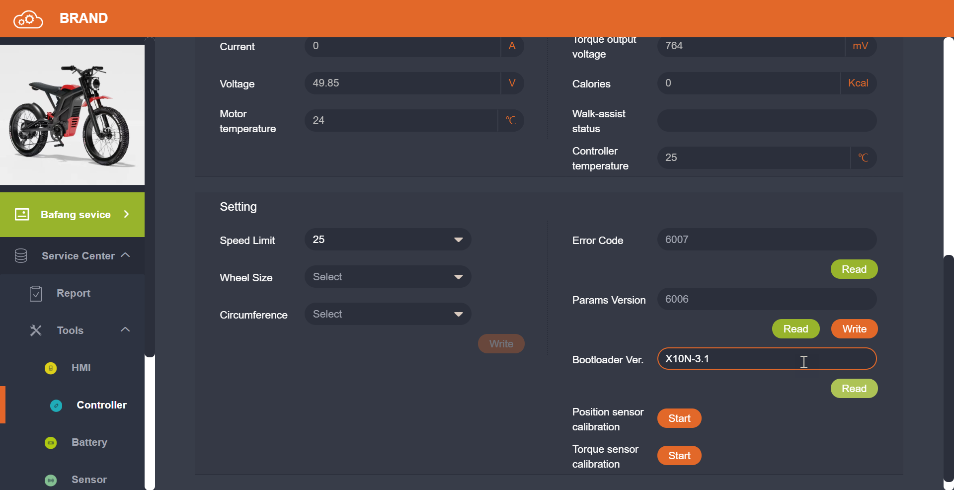

It's not only the rev of BEEST, it's also function of the controller. I have the same screen than you when i read 510 FC1.0 (and only local update available).
When i read FC2.0 it's different (and online update available)

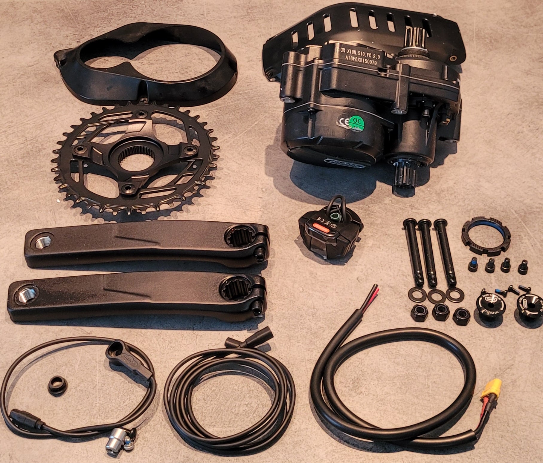

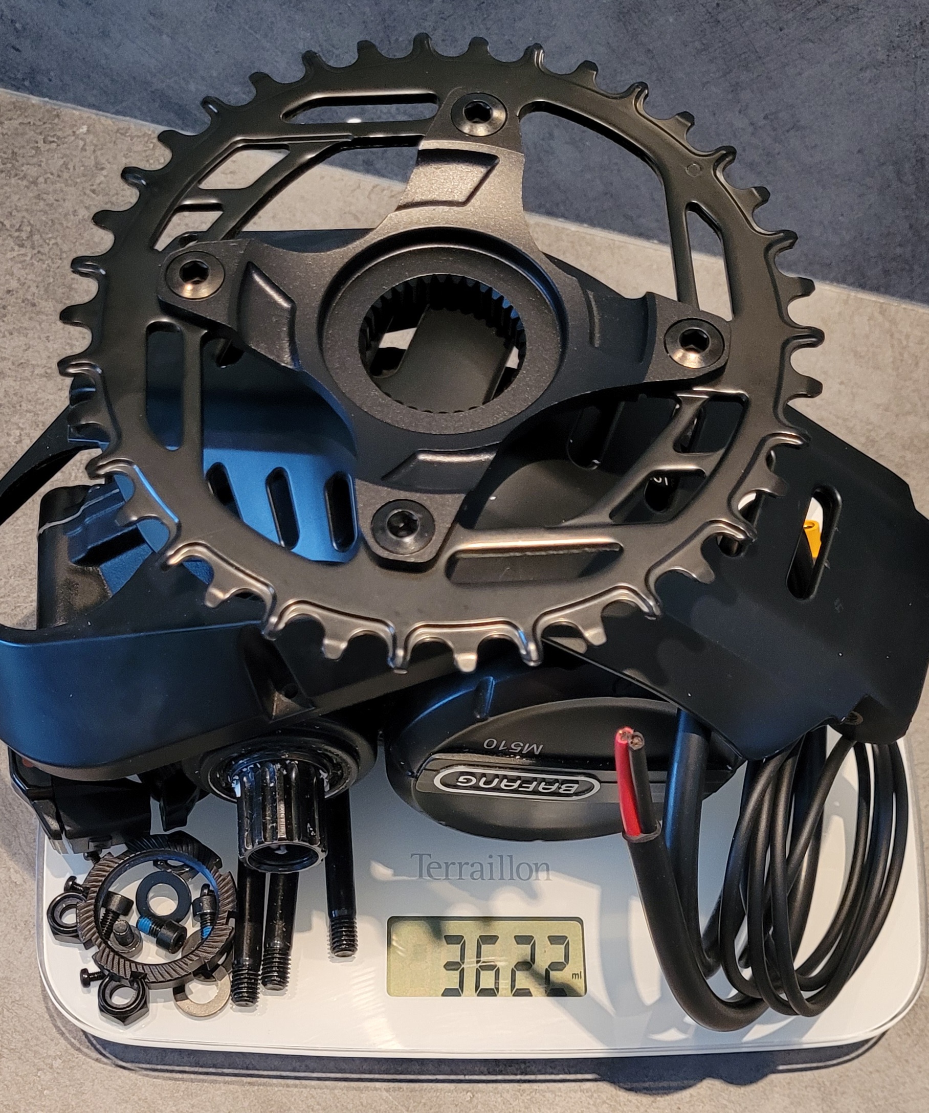

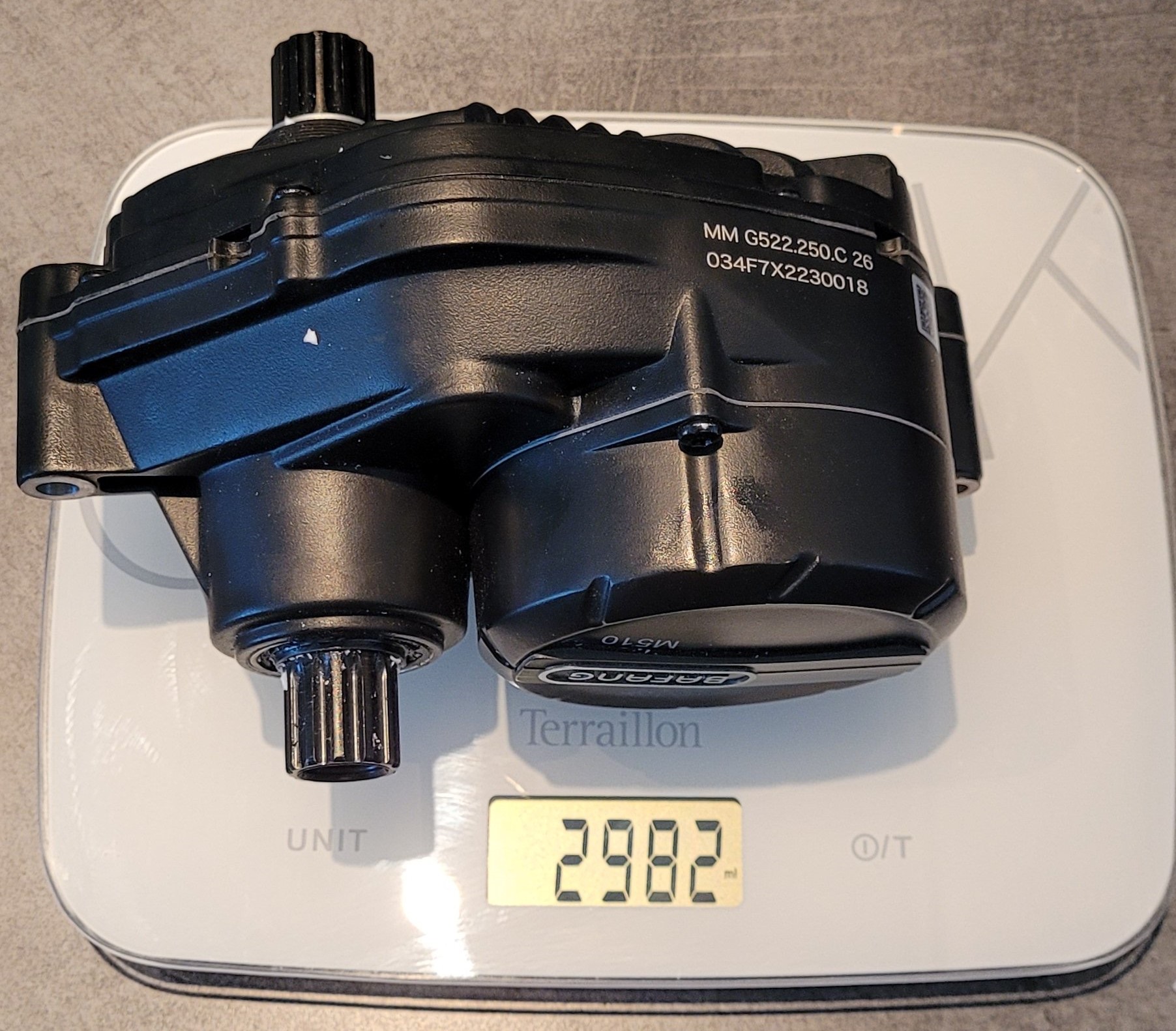

Ordered the 8th recieved today :cool:(y) delivered via UPS not requesting more taxes.
636,49 € Motor cost all included (Delivery, taxes, etc.)
Thanks to « Chili Shen », who's « Anna Shen » on Alibaba > Changzhou Fieldebikes Co., Ltd
Now, waiting for the frame, ordered the 23rd with custom paint @Ben Rides ;) > Dengfu Sports Equipments Co., Ltd

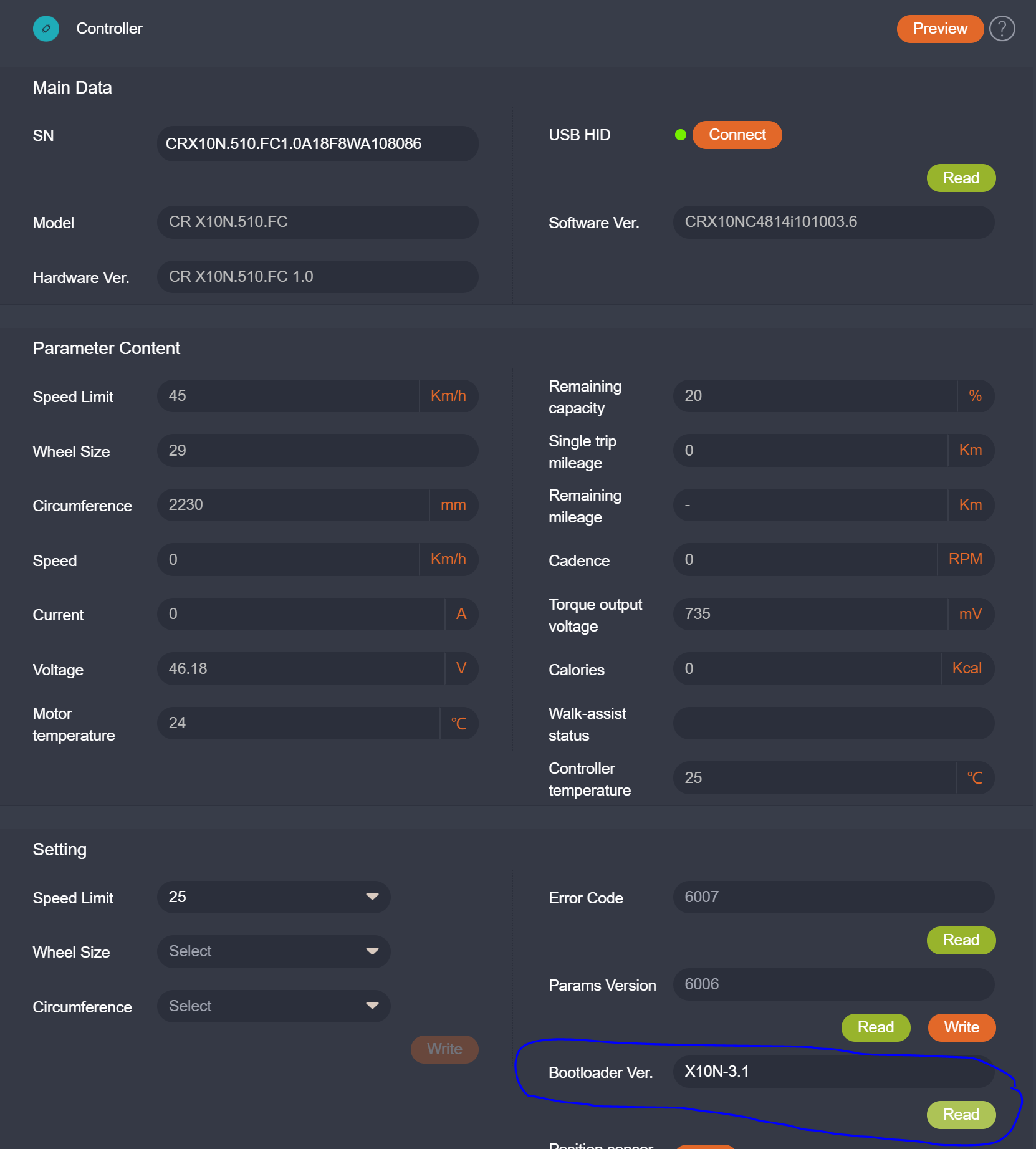

Hello Gents.
I received my warranty motor
HW CRX10N.510.FC1.0
SW CRX10NC4814i101003.6.

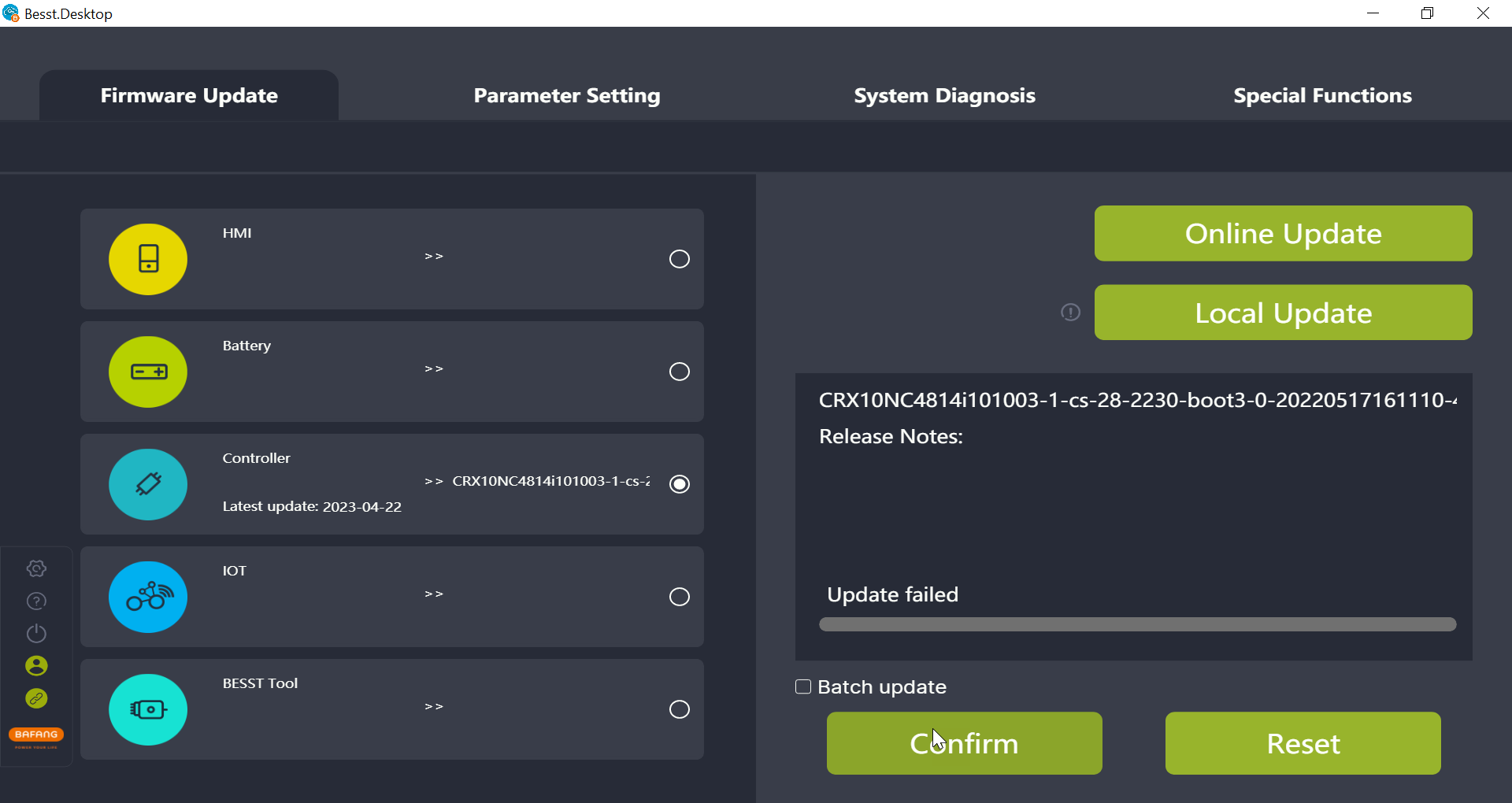

Tried to change SW to CRX10NC4814i101003-1-cs-28-2230-boot3-0-20220517161110-48v-M510 because I like this release more than others, and 3.6 is unrideable and dangerous for me (do not want to stop motor with brakes on a technical rock descent).
Besst and Besst pro told me "Update failed" On my previous motor I had no problem trying to change SW.
Do you know how to fix this? Thanks in advance
Mate, was told here many times, there are 4 versions of motor and firmwares are not compatible each other.
Dado sorry for that stupid question.
But I still can't find the differences between the motor versions. How did you recognize this? The default SW that was installed by Bafang? Is there any other software for my case? On github I see Rev_I and Rev_E.
Thank you.
From label hard to recognize fc1.0 versions each other. It is done according boot loader version.
Hello Theaber. This one is with boot code 0x91 - so latest, third revision of FC1.0 controller. Now I dont remember if your M510 is second or third revision. You can flash into your motor firmwares version 3.1 3.1cs 3.2 3.6? If so you have second revision of FC1.0.
Yes, there is big mess and non logical things in Bafang labeling as you wont find out, which FC1.0 you have just by looking at motor. From controller label or motor label not possible to find out. You need to send bootloader version request over BESST and motor will reply with bootloader version. It is the following one in Besst. "X10N-3.1" is latest FC1.0 controller with boot code 0x91
Dado, you're right. I have the latest motor revision, like yours. Do you know if there are SW alternatives for this motor? Thank you.
Latest is FC2.0 ;)
With your revision I have only 3.5 and 3.6, I guess you have there one of these. And 36V version 1.6
