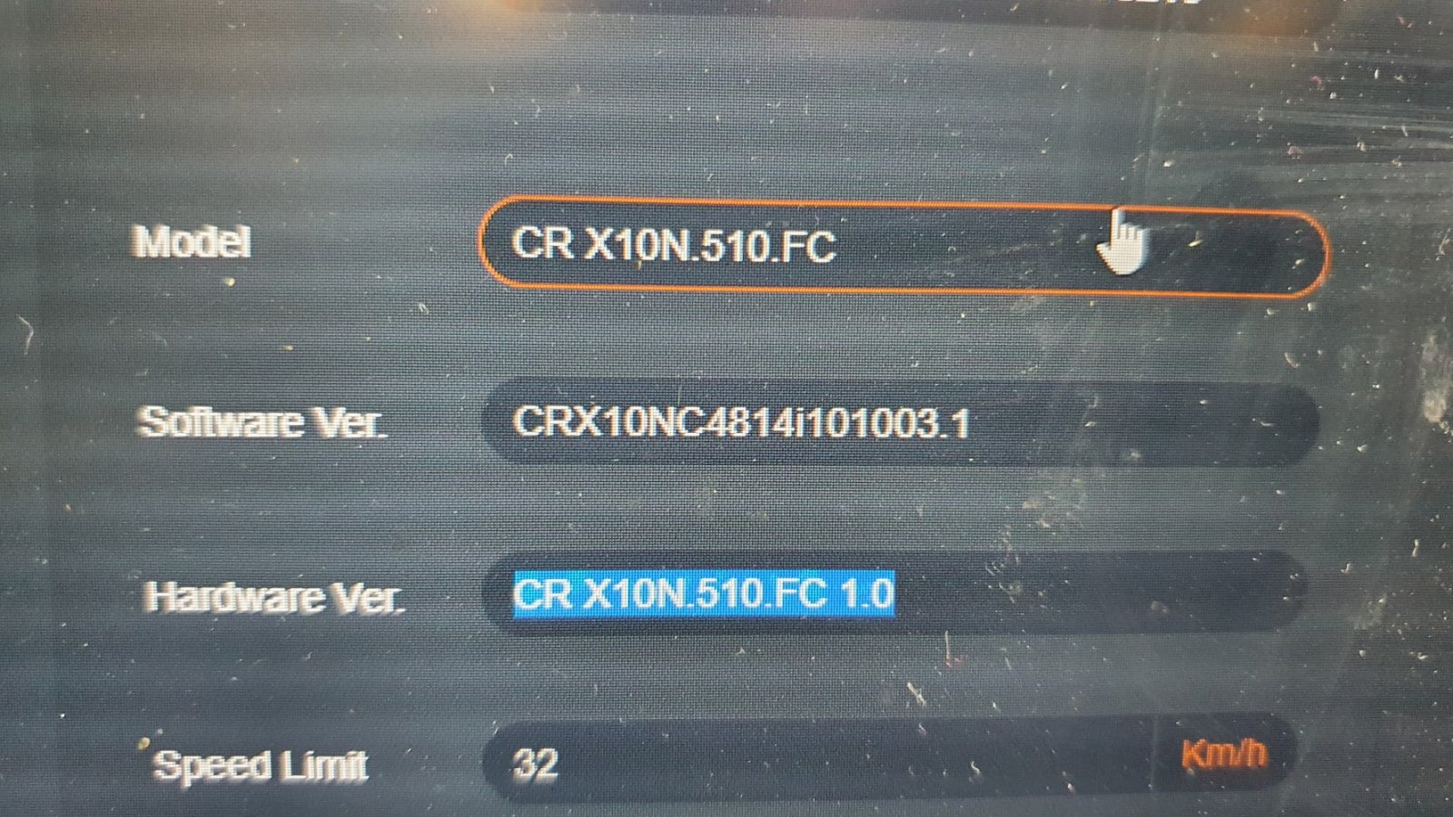

I read that there are 2 different subversions of controller, E and I and based on screenshot taken before flashing FC.510.FC 1.0
i was in thinking, this is version E

From the software version on the screenshot you have the version that we're calling "I".
Version names are not baffang official and they comes from the ASCII of letter in 1st byte of firmware file.
Thats strange you were able to flash this firmware. People tried to do it but besst not allowed them.
CRX10NC4814i101003.2-28-2230-boot3.0-20220523131321.bin is for version I

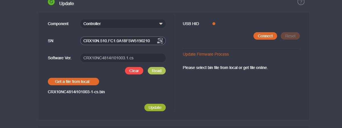

I go to update-> select controller -> I enter value CR into serial number. Then upload is running at best tool beep. When i disconnect/reconnect bus- i got only ERROR 30, but no upload to controller. Any idea here?

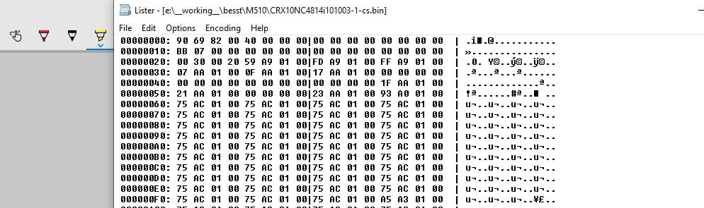

2) verify the firmware is for your platform
notepad-> open-> Options (hex)
First byte 90 (88 M500,89 M600, 90 M510), second byte 67(revI). RevE use bytes89,45 (means the fw is based on M600 and 3.2 controller? Just theory).

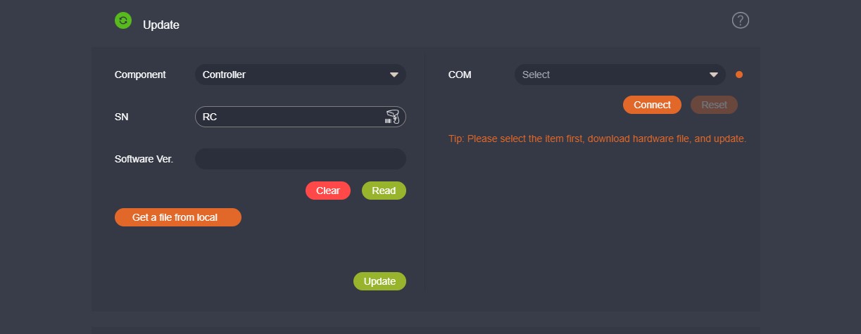

4) bike-> disconnect battery, reconnect batery, turn key ON. connect with BEST HMI turn on. connect USB to PC
5) in BESST login (use python hack), go to Update. BEST is connected (green), but no serial key.
Be sure, you put into SN value "RC" otherwise you cannot flash. This SN cannot be empty!
Click Get file from local, enter fw name (short preferred, but above #1 works).
6. click Update. FW is transferred to BEST TOOL. then it beep.
7. disconnect BEST from bike, reconnect (or press reset on BEST- does not work for me). Upload from BEST to bike must start. If you get error 30, repeat steps 6-7 multiple times (for me 3-4 times).
when upload to bike is finished, long press RESET on BEST and you are back on track.
