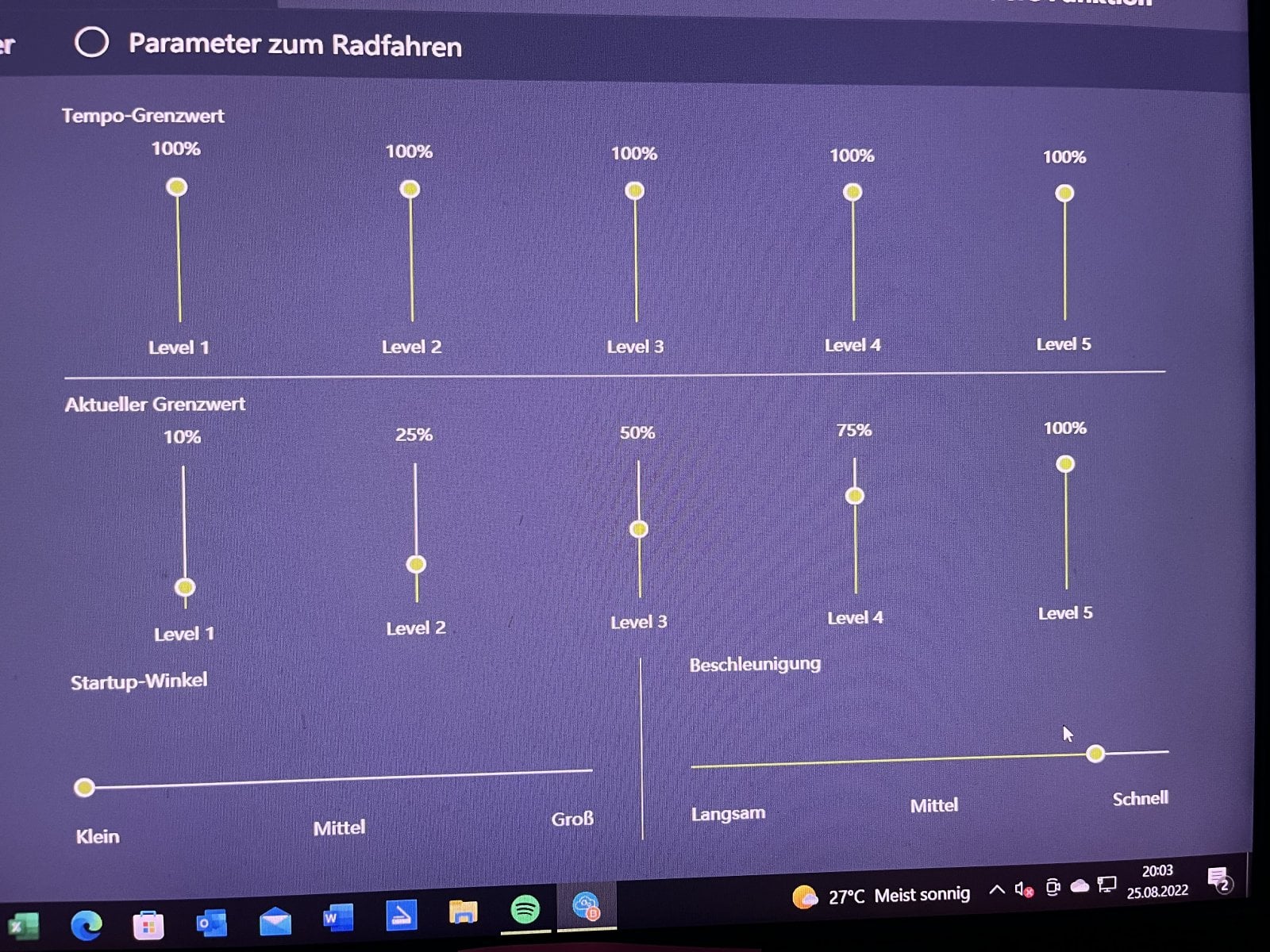

Besst pro worked on the M510, changed the 5 support levels to 10/25/50/75 and 100% and am very satisfied. In level 1 max 80 W power, good for saving battery or training your own fitness. In the 2nd level max 240 watts, in level 3 max 450 watts, ideal to annoy the Shimano EP 8 riders in trail mode 😉, and 670 or 840 watts in levels 4 and 5
Great news on the BESST Pro working on the M510. Will have another go on mine tomorrow, although last time I tried I couldn't make any changes to the speed / power %, only the wheel diameter and top speed.

Good review of configuration. I was able to use this feature of best pro with my rev1 engine that I bought of @ficorama. I am still trying to figure out which level of acceleration I want on the motor. Currently I have it set to 5/8 but I find the motor is a bit too jerky in the higher(=>3) levels which makes turning in tight corners and technical climbs a bit too tricky. I can see you have it set to 7/8. How do you find it in the situations described above? And which version/fw are you currently using?

Today I have reprogrammed the motor and set the acceleration parameter to minimum. I tested the bike briefly and tbh the motor still feels jerky, especially at level 4 and 5. Not sure if there is a difference with my previous setting (5/8). Maybe this parameter cannot be overridden on my fw. Any thoughts on this? Also tried the torque sensor calibration function in besst pro, but that doesn't work. Did somebody have any luck with that?

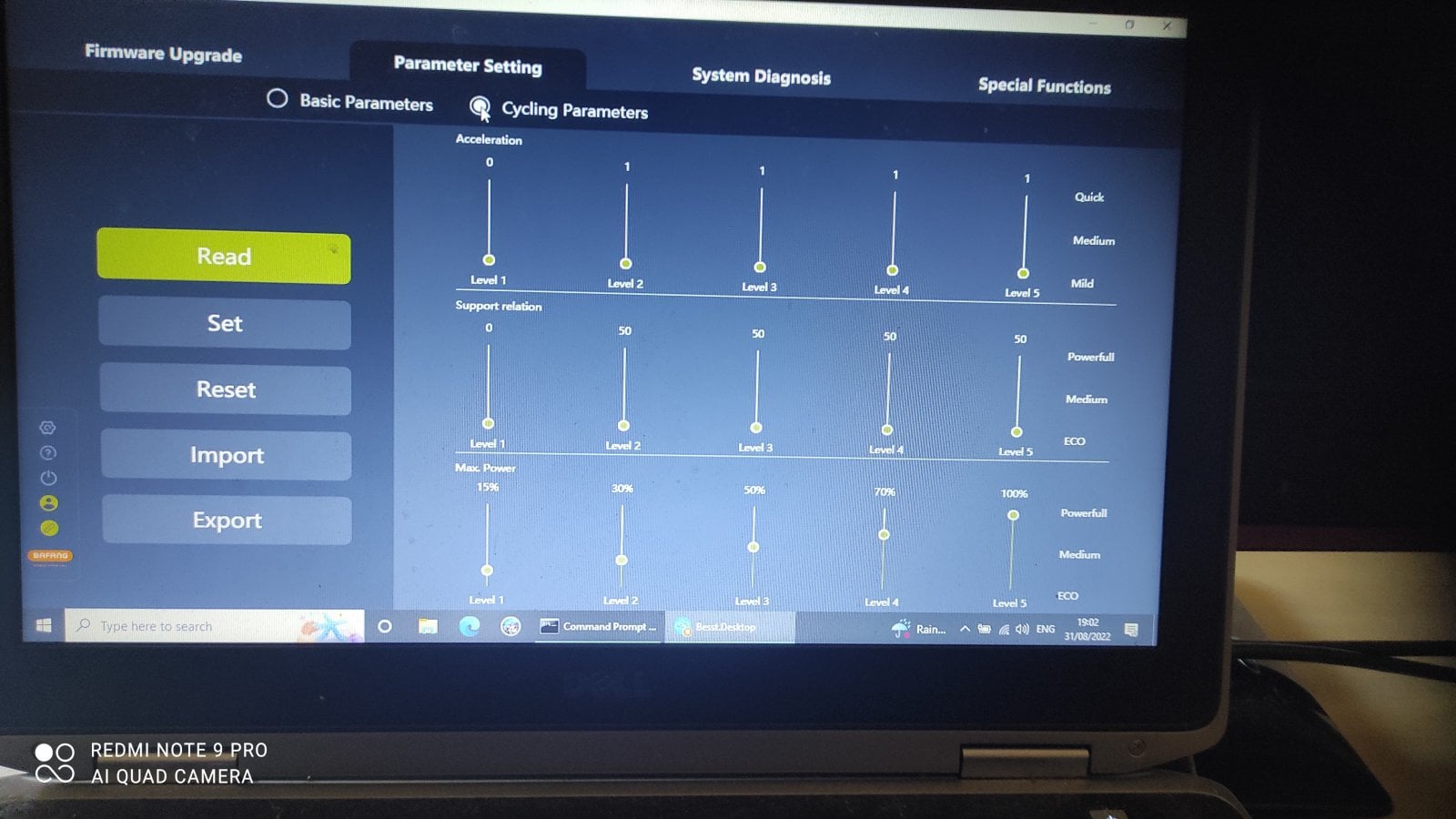

Hey guys, let's stick to m510 in this thread so that nobody gets confused.. And in regards to that, did anybody manage to use successfully the individual level adjustment function in the new(1.30) besst pro?

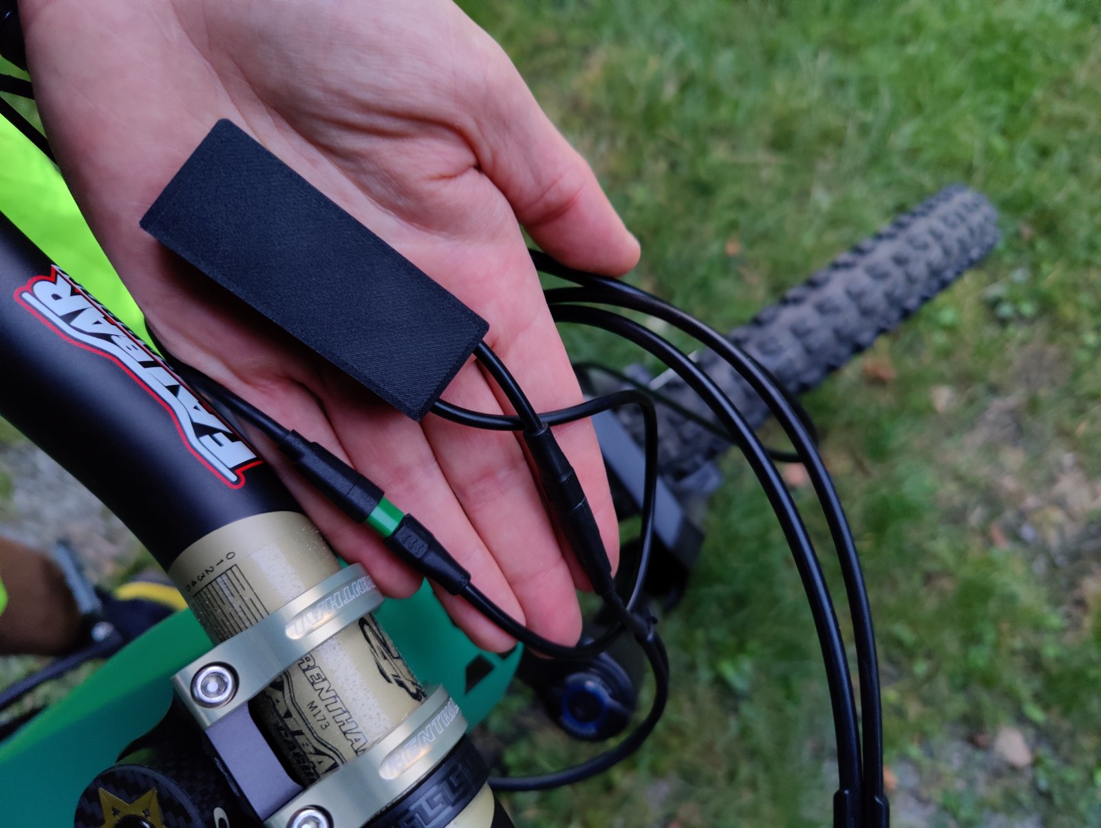

But first I need to design and put into production custom PCB. So still lot of work. But proof of concept sucesfull. And Bafang is allowing also to switch during ride. ;)
Any ideas where to discretely and securely attach the black box?
Into head space and also cabling will be here, so only one cable will go out of the frame, as it was without BB. Dengfu has there plenty of room, and just to glue it on left side of frame (theoretically, other ebike frames, where not possible to get here from battery space, could be inserted over bottom hole after removing fork ). Then you put some small sticker on the frame, where is located magnet sensor (will be in the middle if device).
On order, customer will specify length of cables, plus initial Low/High speed. But anytime you can open it and change speeds with rotary switches.
