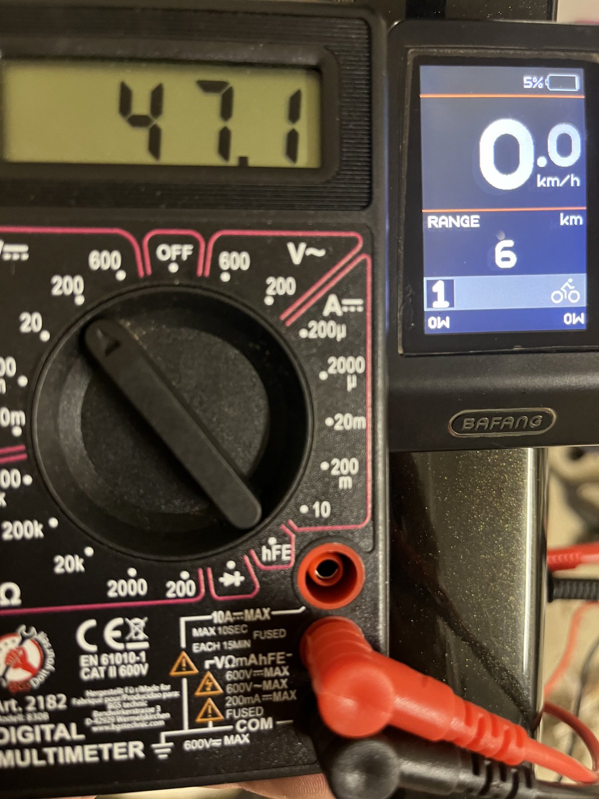

The 52V firmware reduces the power at 10% to max 400W and 200W at 5%, but the voltage is still 47V at 5%. Not optimal but better then nothing.🤷‍♂️
Remember that you are measuring that voltage at rest, under operating conditons of say 400W's I would expect that to be below that level somewhat.

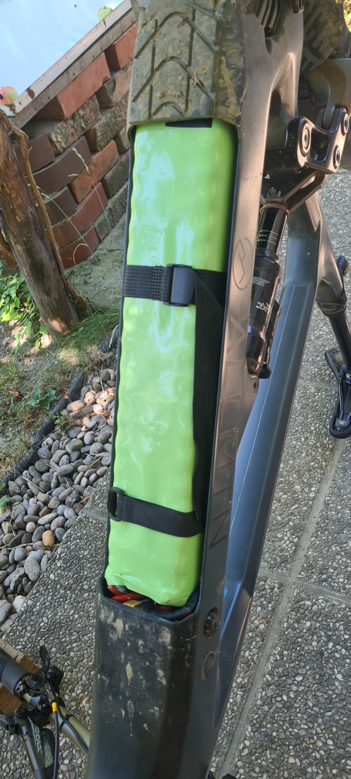

52V 14S3P with Samsung 21700 cells
I've now been using that setup for over a year now on my M600 ( and for several years before that on the TSDZ2 engine ) and think 52 volts suits these motors extremely well. There's a real different feel to the engine from 48 volt to 52 volts and wonder if Bafang had intended all along to go to 52 volts, after all it was a voltage that the BB engine users had been using for some years.
