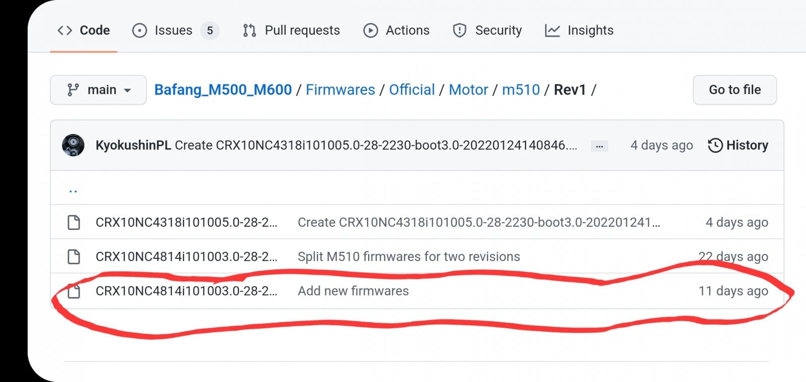

I installed a rev1 engine. at 38 °C 🥵 with the firmware shared by @Rob Rides EMTB . as far as I have seen it is 48v. I made a circle around the street, and tomorrow there is a long drive. comments after driving. and as for the "52v" firmware, disaster! there are power oscillations when pedaling, when you start it gives a lot of power and after a second it stabilizes to something "normal"! while driving, when you do not turn the pedals and start pedaling again, the same as at the start. @KaroKönig is the same thing happening to you? so does Bafang need 6 months to make a good firmware? it would be time for them to make a stable Firmware for both engine revisions!

greeting. I use a 14s4p 21700 cells 52v battery. engine m510, I have rev1 and rev2! firmware rev1 48v last shared by @Rob Rides EMTB works fine for me. firmware rev2 "52v" shared by @Rob Rides EMTB doesn't work well for me. @Puschtrale satisfied?
Today I tried the following new firmware, the last firmware posted by @Rob Rides EMTB
(CRX10NC4814i101003.0-28-2230-boot3.0-20220628153910.bin)
In fact, I did not notice any difference between it and the firmware we were using before:
(CRX10NC4814i101003-1-cs-28-2230-boot3-0-20220517161110-48v-M510.bin)
As if it was the same?!!
The sensitivity of the pedals themselves has not changed, you still need to put a fairly strong torque on the pedals for the engine to start supporting.

You can always reprogram the controller to change the voltage by installing a different firmware.
