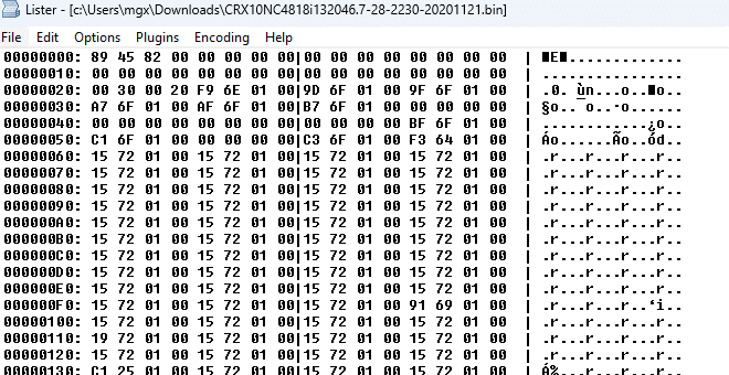

Sure, its this one
CRX10NC4818i132046.7-28-2230-20201121.bin
when downloading, click on RAW button on right to download bin file and not something wrong. Also confirm with checksum (if using Total commander -> menu Files->Verify checksums. Other confirmation is when editing bin file in HEX editor, must start with 89 45...
for this particular file this is valid checksum.
