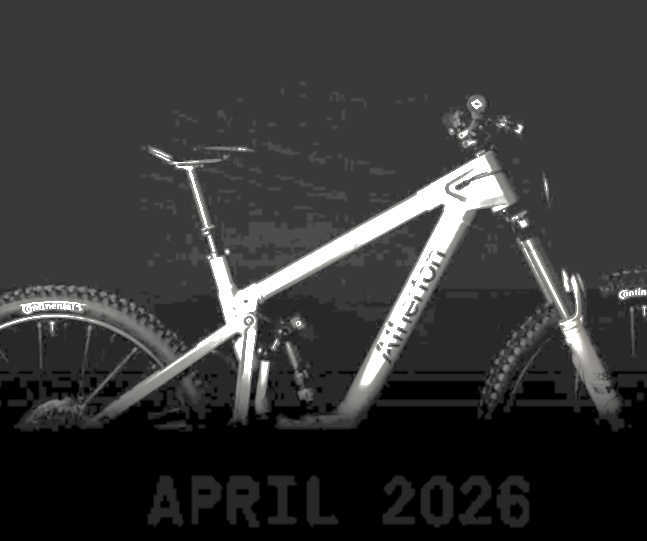

Fussed with the image to reveal the bottom of the downtube that's shadowed. Too skinny for Bosch.

Based on that it's either gonna be a DJI or maybe somewhat surprisingly a Bosch SX.
