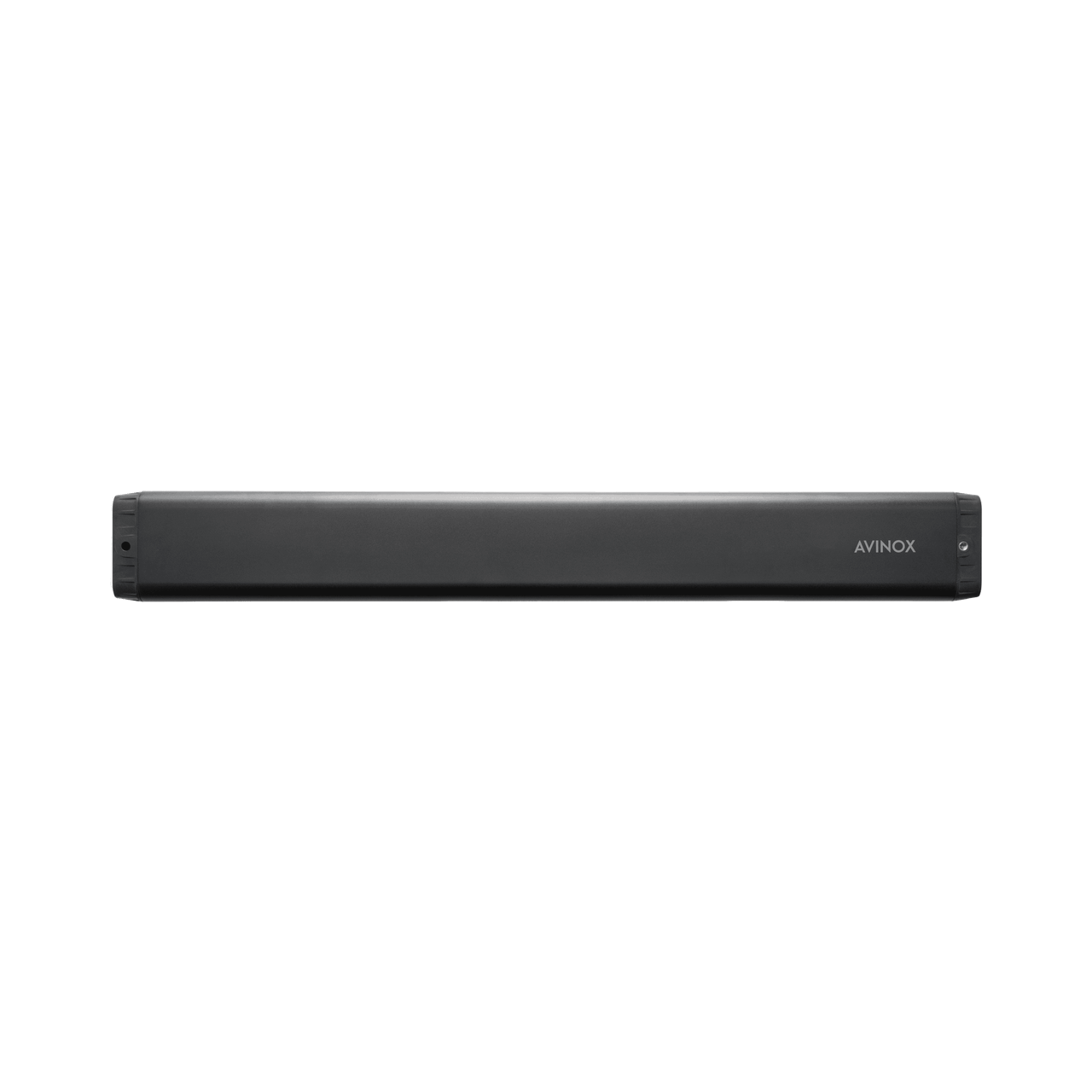

Avinox is 36v
Specifications
Battery Type: Li-ion
Capacity: 22.3 Ah
Energy: 800 Wh
Voltage: 35.9 V
Weight: 3.74 kg
Protection Rating: IP56

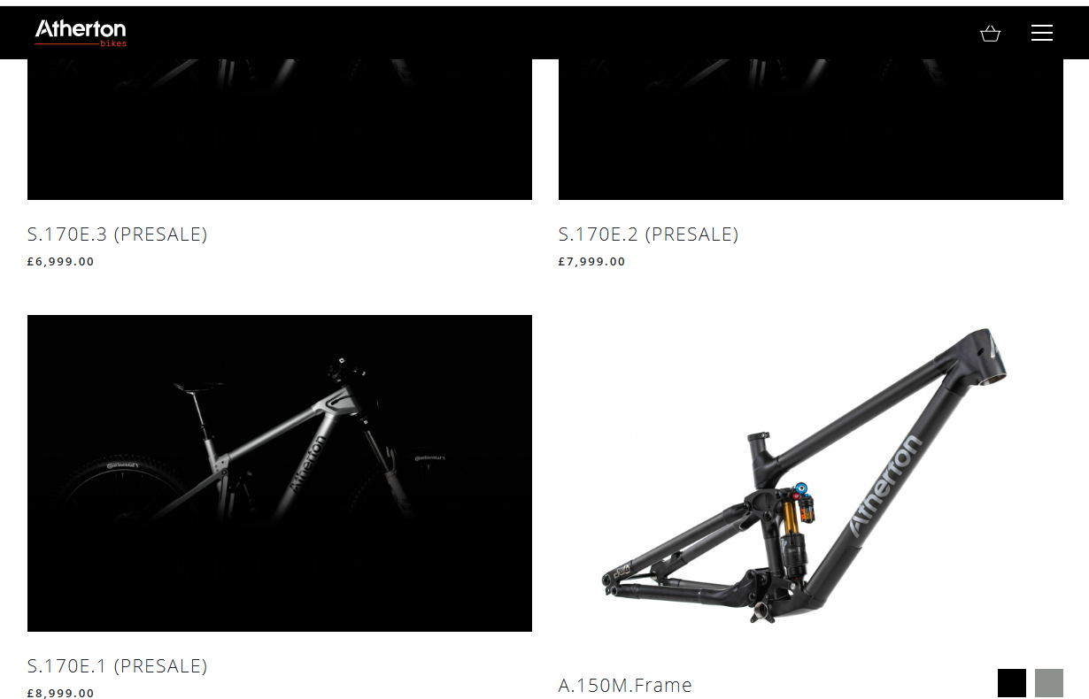

Alu frame, Avinox drive, 170mm travel. £7-9k complete, depending on model
Edit: the pricing is not half bad for a custom-geo full build. By my exchange rate calculation $9400-$12k, with the Rockshox ultimate build right in the middle (about $10,800)
Edit 2: lol, it got pulled again. I guess they are in the process of updating the site.

Not really. The avinox system is almost the same weight as the bosch cx and way heavier than an sl system.
If Avinox it's likely their own battery like Rotwild have done.
10s3p battery pack with a 6500mah 21700 cell will get them 700wh pack. This would fit in an roughly 60mm id round downtube. Length would be between the current 600wh and 800wh packs.

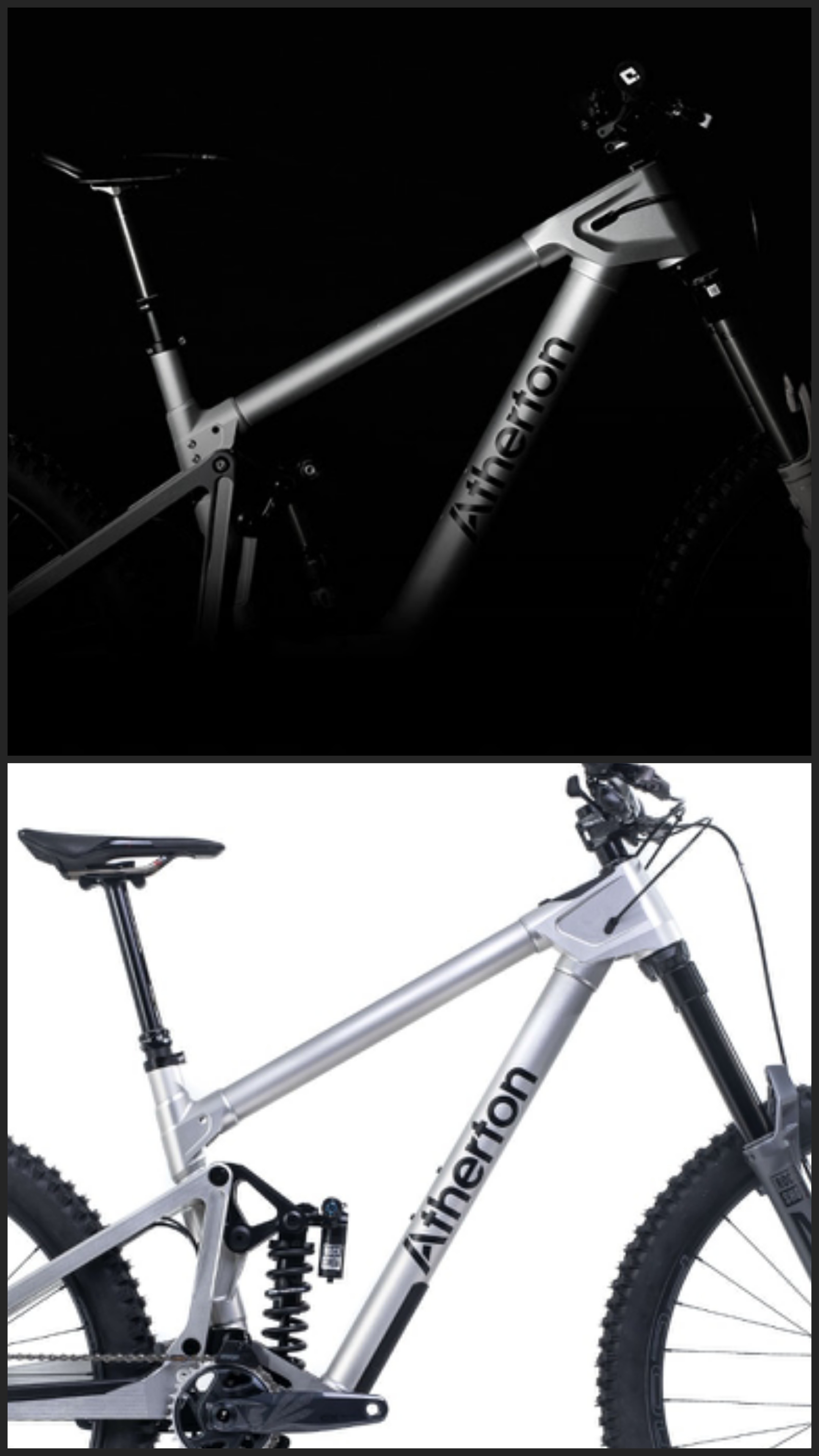

The top tube looks pretty tubular, so no display there. I made a comparison photo with an existing S.170 bike, and it looks like the top tube lug is a bit longer on the S.179.E. That must be where the display will sit.
Also, it seems like full bikes and no frame-only options are available. 😞

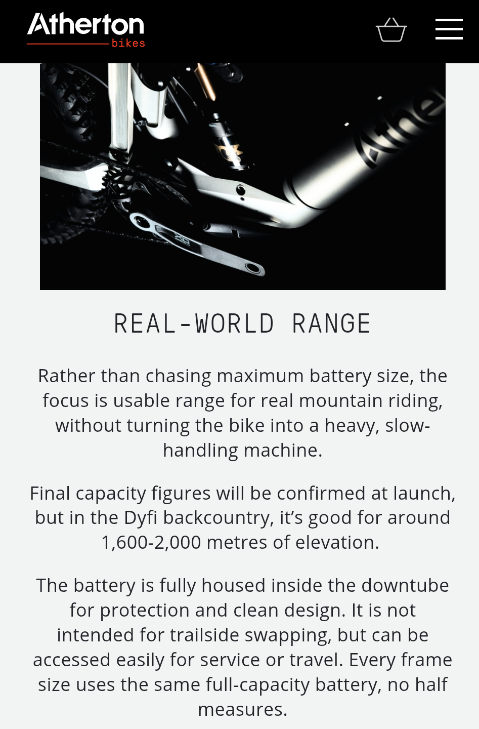

The E.170 is our full-power enduro EMTB, developed and tested in the same Dyfi terrain that shapes every Atherton bike. Build 1 gets the full dreambuild: Fox Factory suspension and SRAM X0 Eagle Transmission put this at the top of the tree in our EMTB line up.
Powered by the Avinox drive system and built on our S-Range 7075 aluminium chassis, the E.170 combines compact, high-power assistance with balanced handling and proven durability. Every decision is filtered through the same standards we apply to our race bikes and park bikes, not just what looks good on paper.
The Avinox drive unit was the obvious choice for the Atherton EMTB. The compact motor layout lets us keep geometry and weight distribution exactly where we want them. Power delivery is controlled and predictable, and when it comes to outright torque for tackling the steepest, gnarliest ascents- nothing else comes close.
Rather than chasing maximum battery size, the focus is usable range for real mountain riding, without turning the bike into a heavy, slow-handling machine.
Final capacity figures will be confirmed at launch, but in the Dyfi backcountry, it’s good for around 1,600-2,000 metres of elevation.
The battery is fully housed inside the downtube for protection and clean design. It is not intended for trailside swapping, but can be accessed easily for service or travel. Every frame size uses the same full-capacity battery, no half measures.
