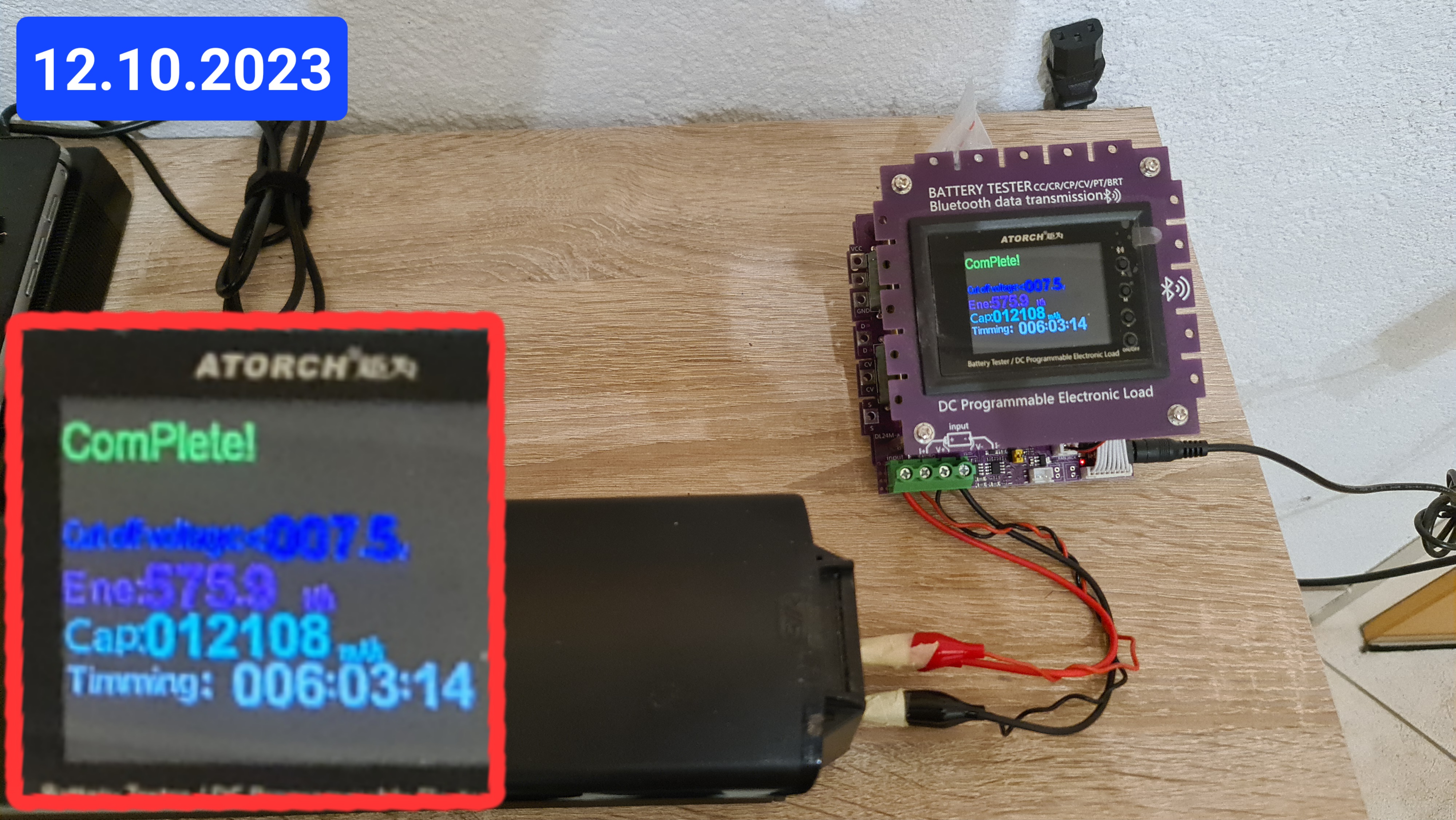

Indeed, batteries lose capacity as they age.

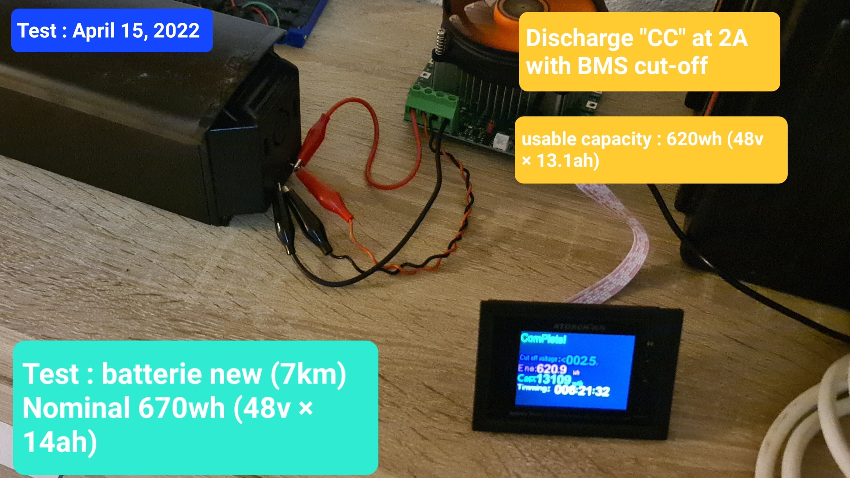

If you'd like an example, I can provide you with the capacity loss of the battery (670wh) in my Frey AM1000 EX.
Currently, the bike has reached 2478 km over 1.5 years.
The last capacity test I conducted showed 93% out of the 100% measured when the battery had 7km.
100% 620.9wh / 100 = 6.209
575.9wh /6.209 = 92.75% Capacity
I know that this loss has been moderate due to my usage and the conditioning of the battery when I wasn't using the bike. It's clear that if I had used the motor at its full power all the time, I would have experienced a capacity loss that I think would have exceeded 10%.
View attachment 138769View attachment 138770

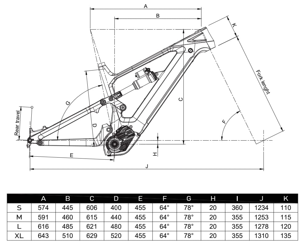

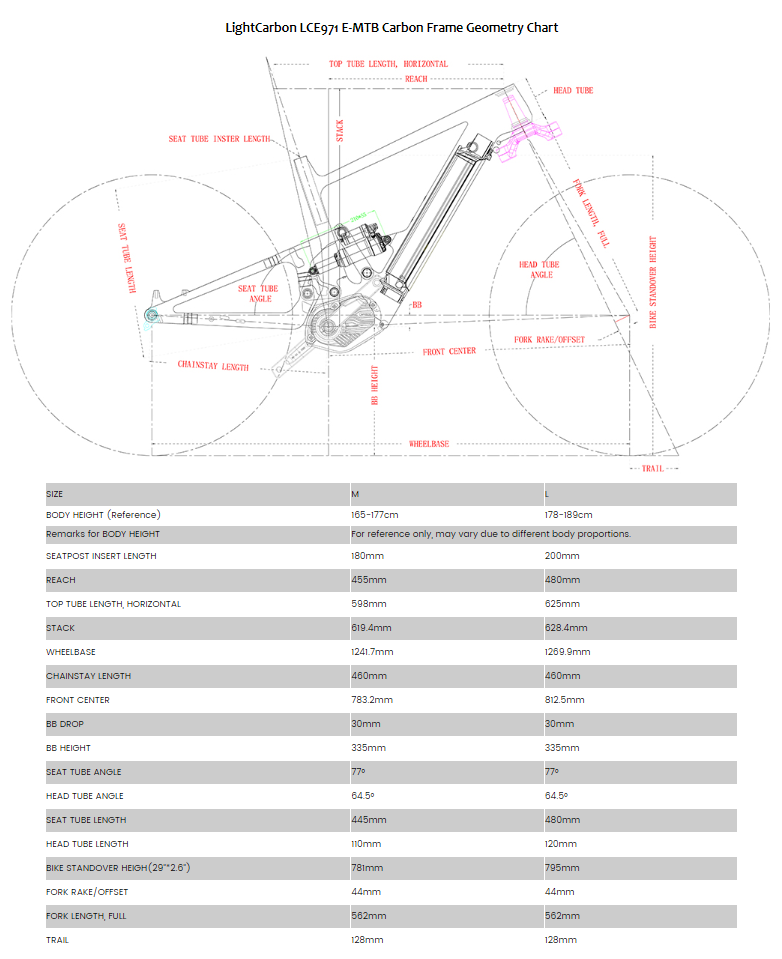

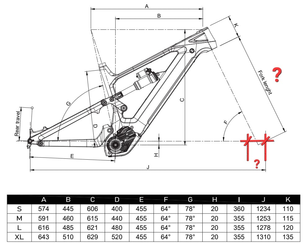

If we look at the E82's geometry in a general aspect and compare it to that of the LCE971, we can say that the E82's geometry is slightly more oriented towards enduro.
The rider's positioning is slightly more rearward, which can be an advantage for downhill riding.
The head angle is also more enduro-oriented, at 64° compared to 64.5° for the LCE971. But be careful ⚠️, just because the angle is 64° doesn't mean it's better than 64.5°. The entire geometry and rear suspension kinematics must be taken into account. The best way to determine how a frame behaves is through real-world testing.
The bottom bracket height relative to the ground is 10 mm higher than that of the LCE971. However, the motor position is different. Therefore, the rider's center of gravity is higher for the E82, resulting in less stability. On the other hand, this frame will be less prone to hitting obstacles at the motor level, so it will have better obstacle clearance. Is this a good compromise? Honestly, I'm not sure. The majority of frames currently available are more similar to the LCE971 than the E82.
As for the E82's rear chainstay length (455mm), it's 5 mm shorter than the LCE971's (460mm). This difference is minimal, and I'm not sure if it would be noticeable on the frame. Nevertheless, I do have a preference for shorter chainstays, and if it were up to me, I would opt for a chainstay length of 455mm/450mm (for size "M"). if I wanted a bit more playful feel, I would opt for a 450mm rear base. However, the 460mm offers a good stability experience and, in my opinion, a very good compromise for a light all-mountain/enduro setup. Personally, I wouldn't go below 445mm for an e-bike. The Scor 4060, for example, has a very short chainstay length (436mm), making it very playful but less stable and challenging on climbs as it tends to lift quickly. I think 436mm is too extreme for a chainstay length.

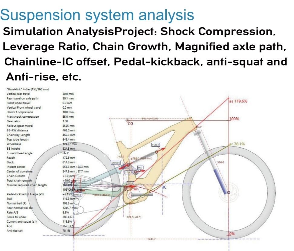

You might be wondering what I think about the frame's suspension kinematics. However, it's going to be difficult to answer that question, and I'll tell you why. This is also one of the reasons why I didn't choose Dengfu and opted for LightCarbon because their "Spirit" seems better to me.

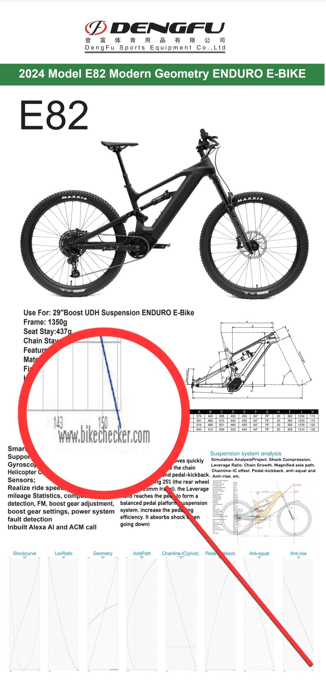

I did find the rear suspension simulation graphs (thank you Sayonara :)) , but I'm having trouble analyzing them.
There are several inconsistencies that prevent a proper understanding of these graphs.
Data such as fork length and offset are missing. Therefore, it's impossible to determine the fork's trail (which is interesting and important for understanding part of the bike's behavior).

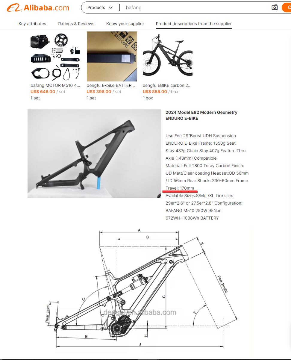

Typically, if a frame is designed with 150mm/150mm of travel, it's acceptable to increase the front travel by 10mm because it minimally affects the overall bike behavior and won't be negative; it will simply be different (more stable). However, going beyond 10mm more (e.g., 150mm/170mm), the geometry changes significantly, and the behavior changes too much, which can be counterproductive.

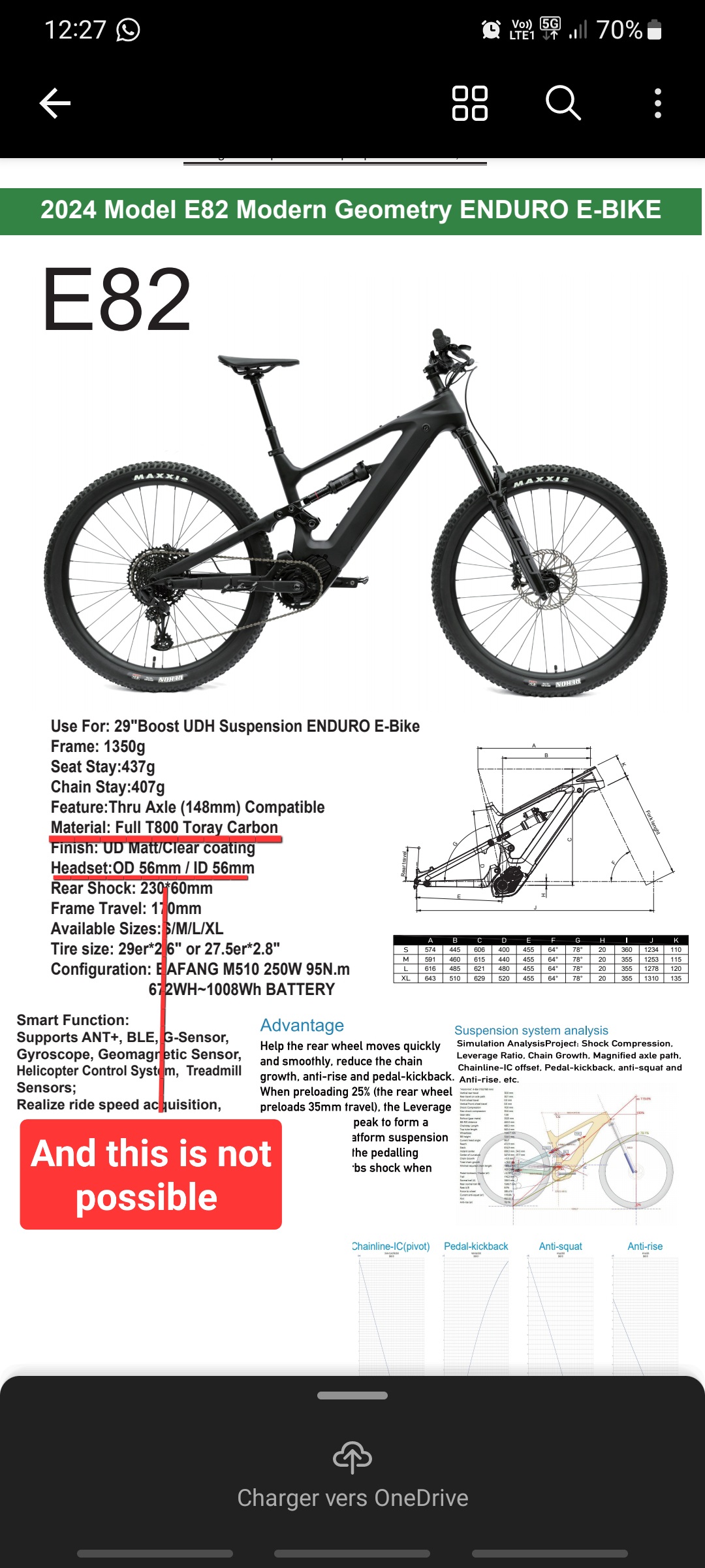

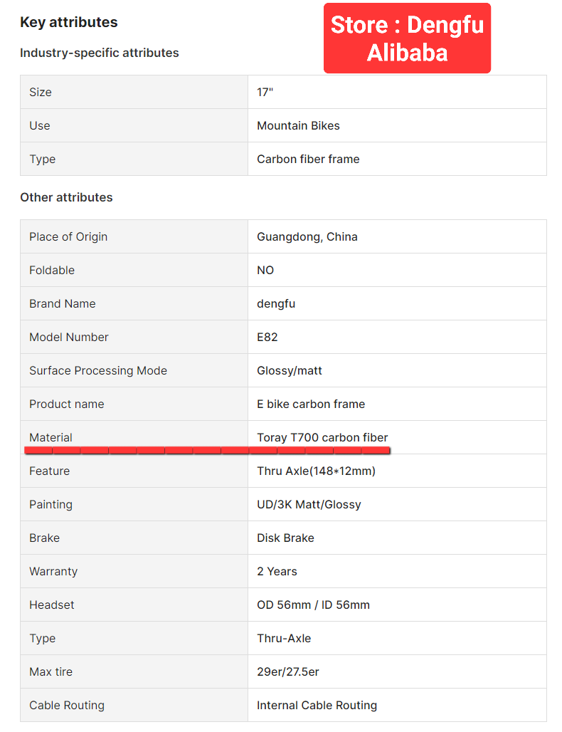

Additionally, they indicate 170mm of rear travel for sale.
However, the graphs were created with a 55mm shock, resulting in a total travel of 150mm (according to the graphs).

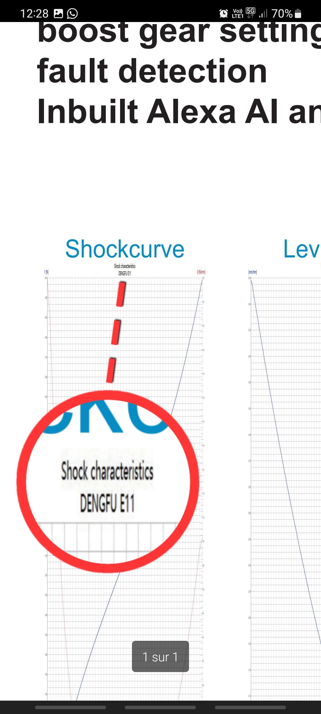

It's also worth noting the use of "E11" instead of "E82" in the graphs, which naturally raises the question of whether these graphs correspond to this frame.
If Dengfu is listening, I would appreciate it if they could provide detailed information on the graph below.
From my analysis, these are measurements taken with the bike at a 20% rear sag and 0% front sag. However, if the front fork sag is at 0%, we can infer that a 560mm fork length corresponds to a 29" fork with 150mm of travel. So, you might say that it's an "indicative" graph, but it's available in the "E82 pdf" document, and if this information is incorrect, it shouldn't be in that document.
So, to summarize: It's a frame oriented towards enduro (due to its geometry), sold with 170mm of rear travel, and therefore (logically) 170mm at the front too. But according to the graphs, it was designed and dimensioned for 150mm rear and 150mm front travel.
For my part, I'm not sure where I stand on this... What I mean is that if you buy this frame for its 170mm of travel, you won't be able to know exactly how the bike behaves and its exact geometry.
Additionally, although it's a detail, it seems odd to me to advertise an enduro bike with a trail shock (RockShox Deluxe) and "trail" tires (Maxxis Rekon). By the way, these tires are a disaster, so don't buy them.
At some point, you have to stand by your decisions, and if you're making an enduro bike, you need to equip it accordingly, even if the components are expensive... And if the company doesn't have the means to equip a frame with enduro components to take promotional photos, they should wait for a buyer to purchase the frame and take photos for them to use on the website.

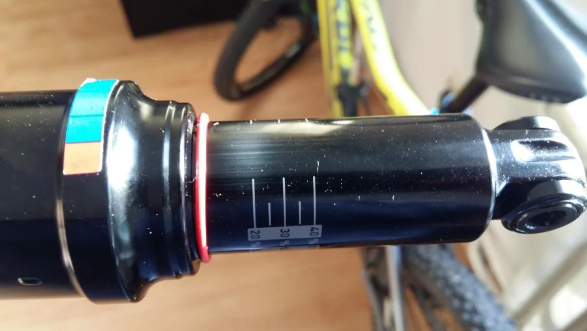

I'd also like to address the "Yoke."
The best way to have the most problems is: "Yoke" + "trunnion" shock. Here, there's no "trunnion", which is already a good point. However, there are three sizes of "yoke" (90mm, 70mm, 50mm), and the longer the "yoke", the greater the leverage on the shock stroke. If you're really using your bike for what it's meant for (enduro), I wouldn't bet on your shock's longevity... Especially if you're using a "trail" shock.
Here, the shock absorber shows scratches (probably due to lack of maintenance).
Having a yoke exacerbates this phenomenon if:
Of course, other problems arise from it. It's one among others...
So with a "yoke", you need to be diligent about maintenance intervals (even considering more frequent servicing) to try to limit this phenomenon.
So, as you can see, we can't rely on the graph because it doesn't accurately represent what's being sold. If you use a 45mm shock with a 90mm "yoke" (what is that, 140mm of travel?), you won't have the same kinematics as with a 50mm "yoke" and a 60mm shock.
Ultimately, if you buy this frame, you won't know (at the moment) what you're buying.
You may have noticed that I pay particular attention to what a manufacturer gives us as information, and it's not for nothing that I chose LightCarbon over Dengfu.
How do you expect to know what you're buying if they themselves don't even know what they're selling...
By the way, Toray T800 or T700?

You might not be wrong with your observation. It's true that it's not yet available on their own website, but what does that mean?
Do they have prototypes and want to liquidate them under a different name like E82 to avoid tarnishing the E11 when it's finalized?
As for the graphs, it's not the only model where data is missing. When I had a quick look at their official website, I already noticed that.
And maybe we should forget about the E82 and wait for the E11.

As for the frame size:
Even though there are guidelines, the choice of frame size remains somewhat personal. Some people prefer a slightly smaller frame for more maneuverability and a playful spirit, while others prioritize a frame that feels more secure and stable.
I'm 1.72m tall, and on the LCE971 (size "M"), I feel stable (so it's a size that feels secure for me).
Personally, I feel comfortable on a size "M," and I know a size "L" is too big for me. A size "S" would clearly be more playful.
Since the LCE971 has a contemporary geometry, you can easily compare it with other brands by visiting their websites (for example: Canyon, Specialized, Trek, Scott...) and see what frame sizes they recommend based on your height.
It's hard to give you the right size because you, like me, are between two sizes (me between "S" and "M" and you between "M" and "L"). The best solution if you don't want to make a mistake is to visit a bike shop and ask to try out a size "M" and a size "L" with a similar geometry to the LCE971.
Also, don't forget that leg and arm length can also play a role in choosing a frame size. On the Specialized website, you can enter all your measurements, and they will give you the most suitable frame based on your size.

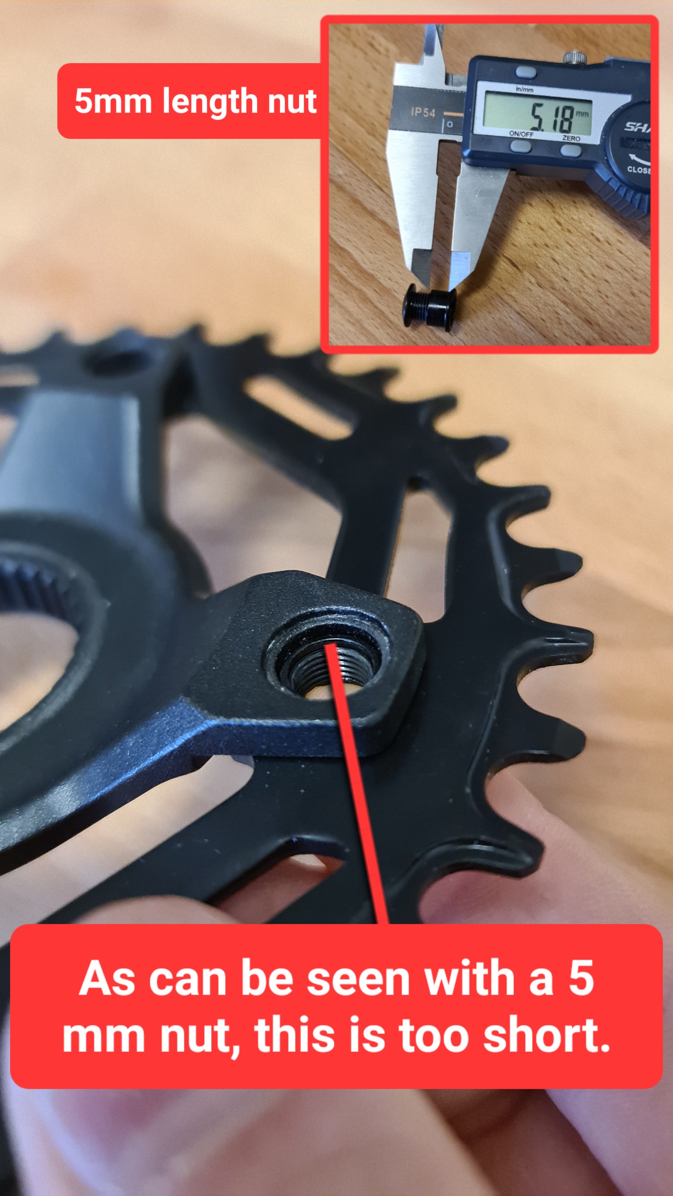

@Denver Are you able to check your chainring nuts? I found these that are supposed to be the bolts for the bafang. bafang central crank kit bbs01 and bbs02 chainring adapter black bolts-Greenbikekit.com BBS, ebike batteries, Bafang M620, Bafang M600, Bafang M500, Bafang M510, KT controller with display-GreenBikeKit.com
But when I search from aliexpress they typically list them with two options. 6,5mm and 8,5mm. Wondering which ones fit the bafang. Some pics from aliexpress.
Edit: Oh and I needed to ask.. do you think it is possible for me to get all my cables to fit those headset slots? After all I'm not going with axs derailer or dropper post. On top of that I will have a thumb throttle as well. 🤔 sounds like a thight fit..

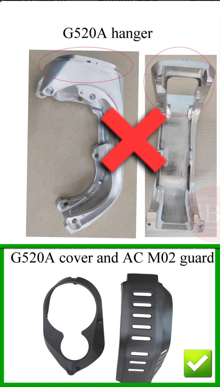

Oh and do I need the G520A motor hanger as well or does the frame take the motor without it? $70 from greenbikekit if it's needed.
Screenshot_20240426_172722_AliExpress.jpg Screenshot_20240426_183007_AliExpress.jpg

Oh, et ai-je également besoin du support de moteur G520A ou le cadre accepte-t-il le moteur sans lui ? 70 $ de greenbikekit si nécessaire.

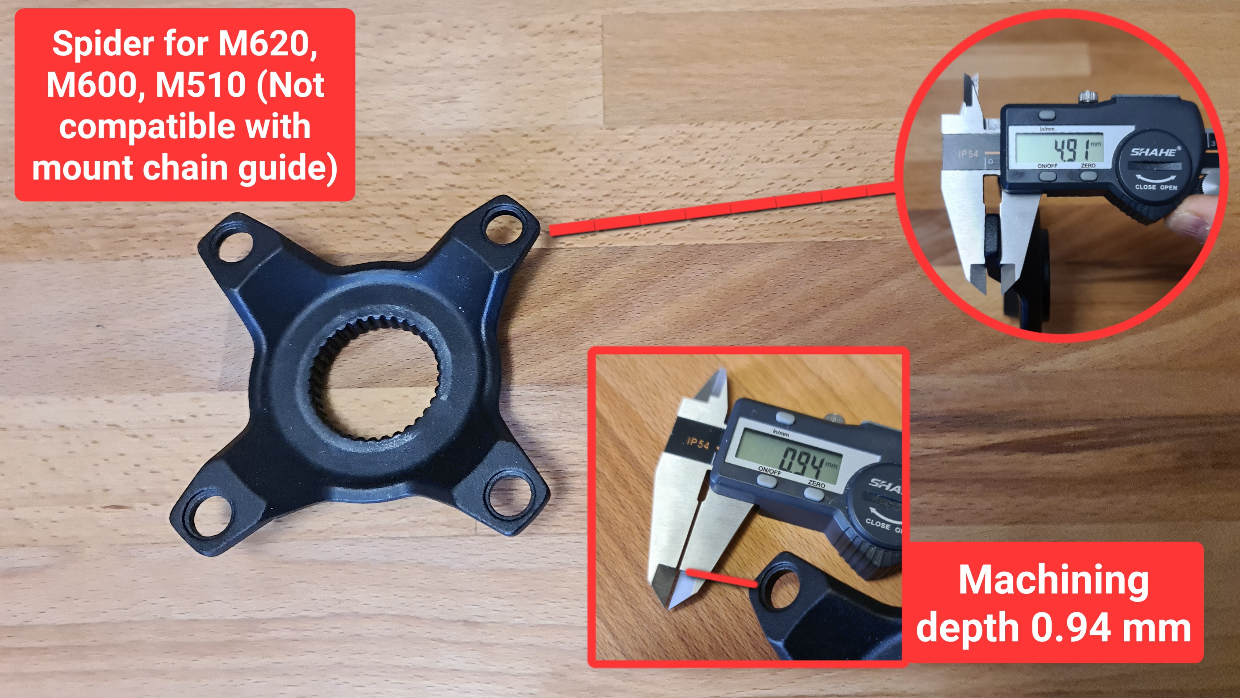

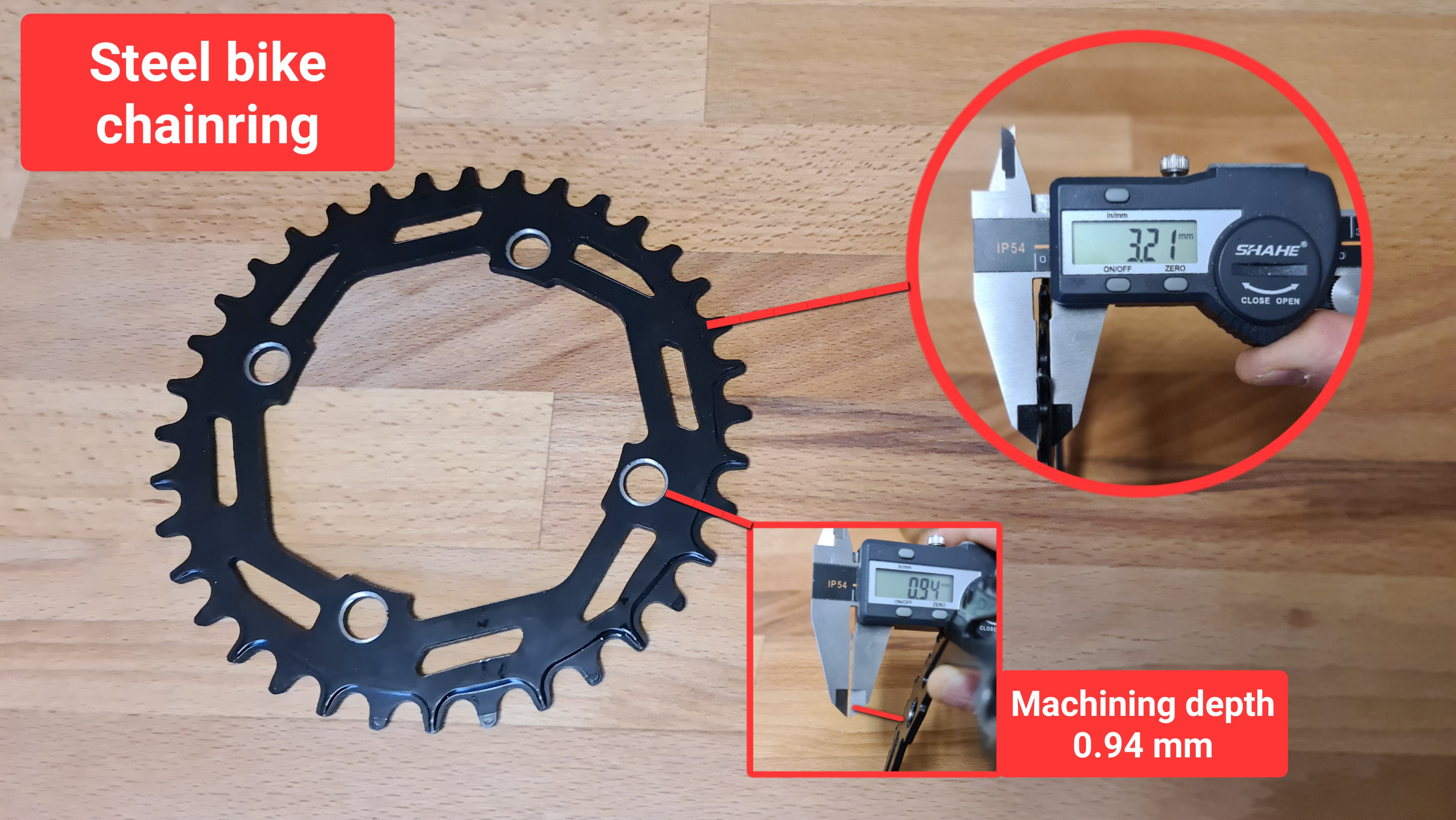

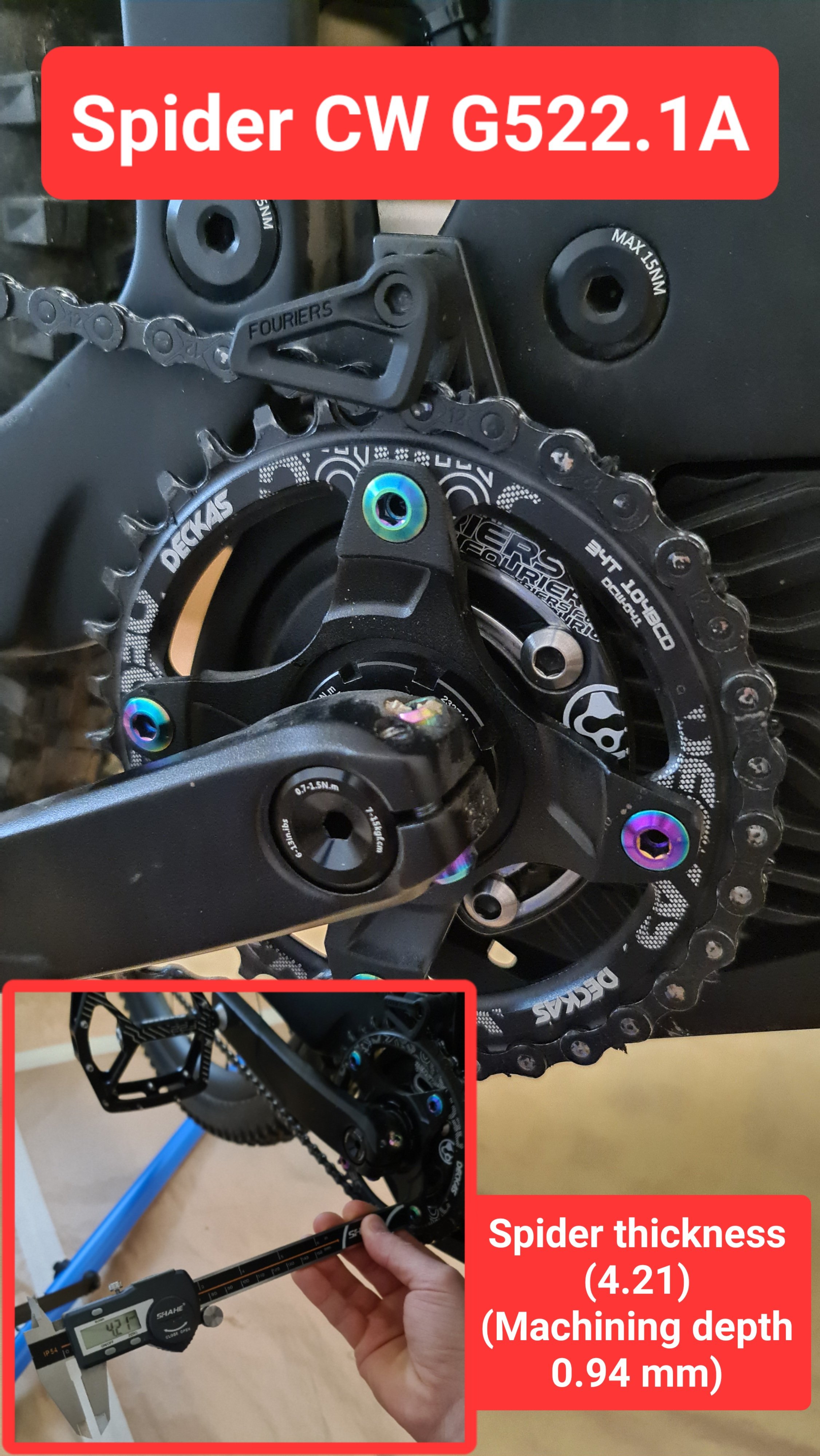

I can't give you an absolute truth because it depends on the equipment you've chosen beforehand.
However, I can provide you with some measurements, and based on that, you could determine which bolt length suits you best.

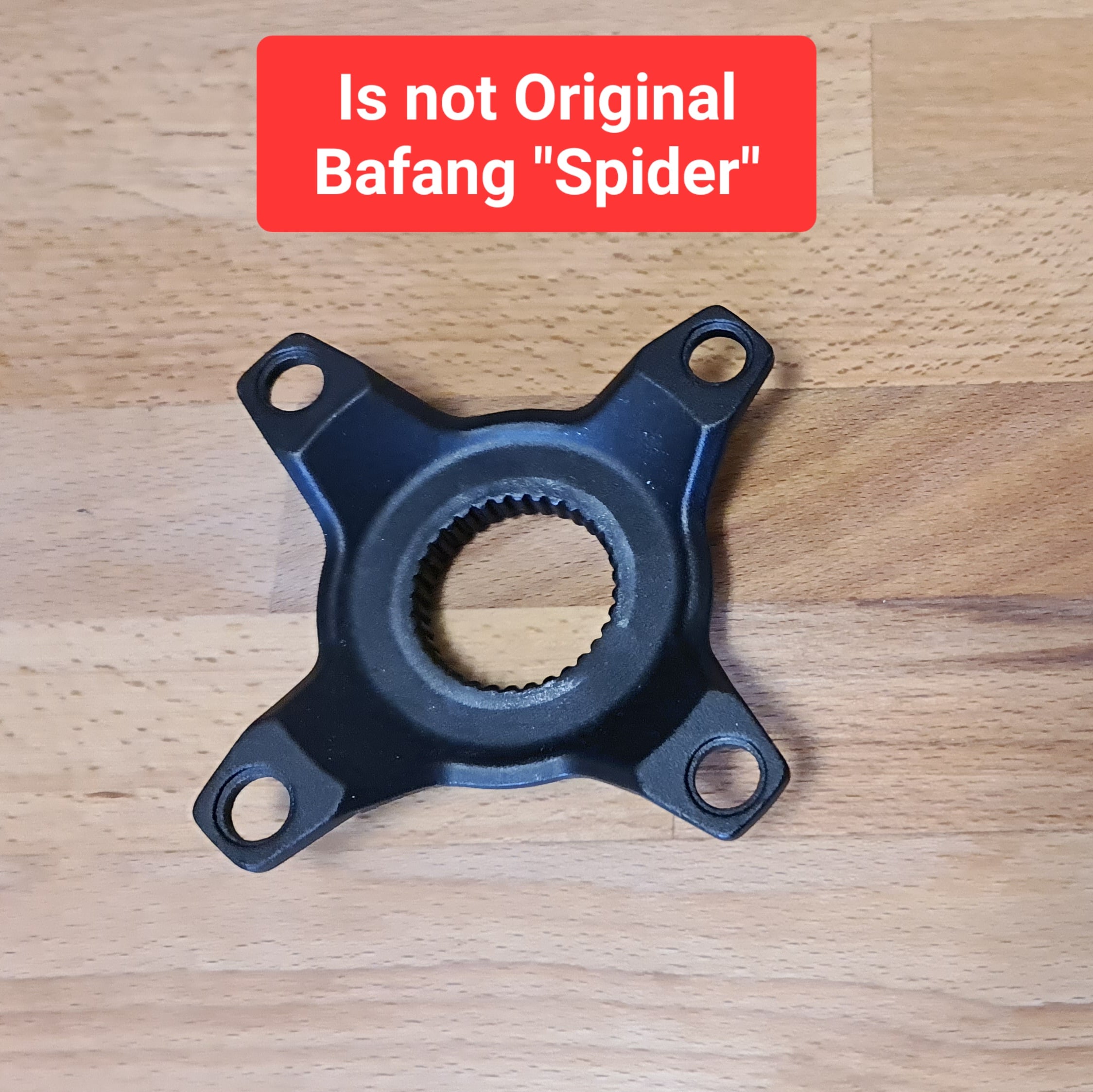

As shown in the photos, there are several versions of bike chainrings (aluminum or steel), resulting in one being thicker and the other thinner.
Additionally, depending on the "Spider" model, there could be a thickness variation, which you should consider when choosing the bolt length.
Taking the steel model as an example, we can determine the maximum bolt length as follows:
Spider = 4.91mm + chainring 3.21mm = 8.12mm - 0.94mm - 0.94mm (Machining depth 0.94 mm) = [6.24mm].
Personally, I received 5mm-length bolts, and in my opinion, it's better to buy 6.5mm bolts and shorten them by 0.5mm to get a snug fit.

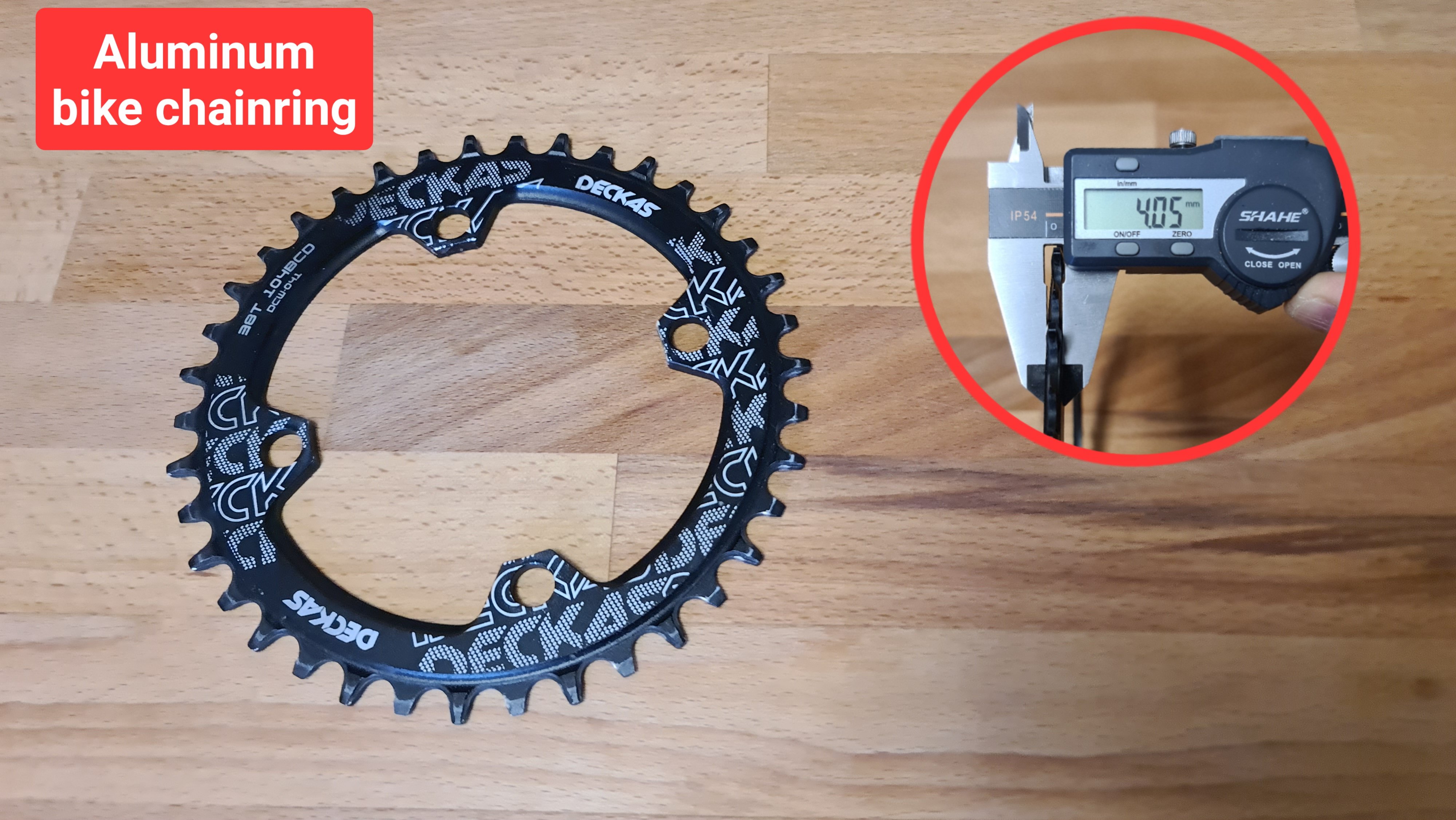

For the aluminum model:
(4.91+4.05)-0.94 = [8.02mm], so for this version, it's advisable to go for 8.5mm and shorten them by at least 0.7 mm.
I bought titanium bolts (length 8.5mm)
https://a.aliexpress.com/_EH8Vk2J
and shortened them myself, and I must admit that it's a bit tedious...
For the aluminum bolts you mentioned in your post, it's worth noting that aluminum is relatively soft, and even though these bolts are made of 7075 aluminum (which is more resistant than 6061 aluminum), I'm not sure if they can withstand a torque of 10/12Nm. Also, remember to use threadlocker (Loctite 242 or 243) during assembly to minimize the chances of loosening over time. (Personally, I use "Loctite 243" with a torque of 10Nm).
However, be careful. In my experience, I've had a bad experience with aluminum screws and Loctite. I've often damaged the screw head when trying to unscrew it. Since then, when I use an aluminum screw, I apply grease, and these screws are only intended for non-critical parts such as the bottle cage holder.
If you still choose to use aluminum models, I suggest you try with a single screw first, and if you can't unscrew it, you may need to drill it out.

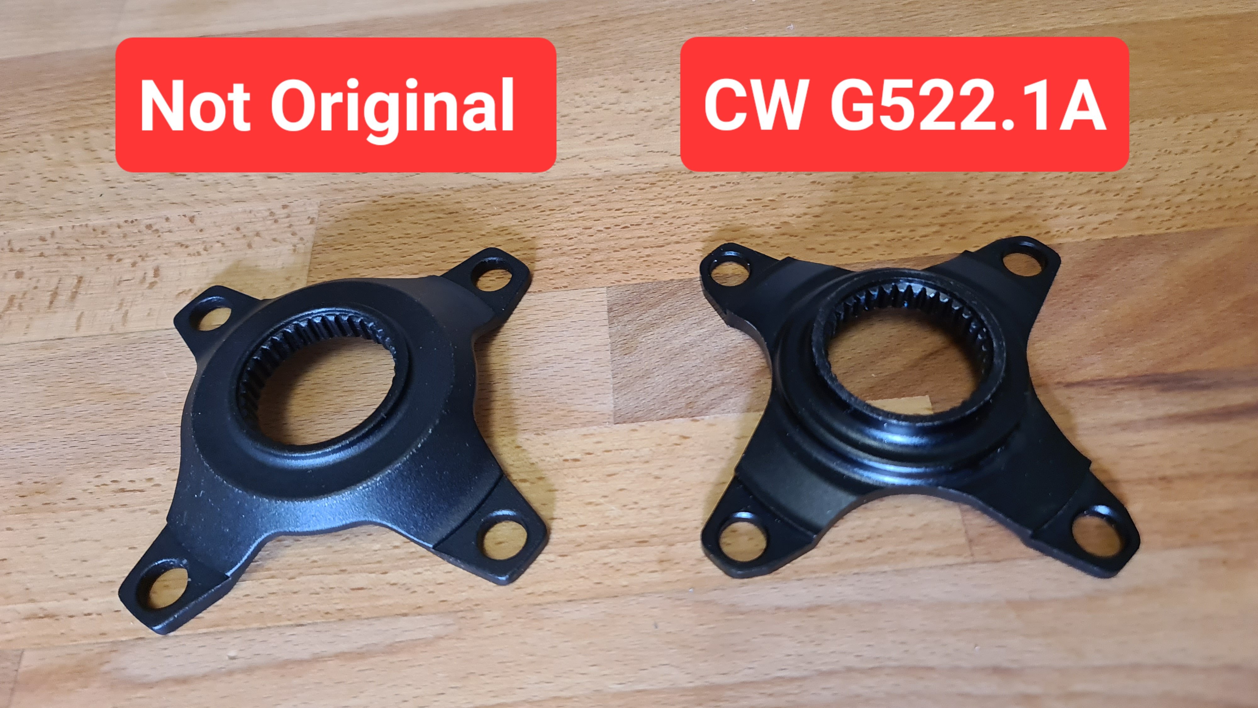

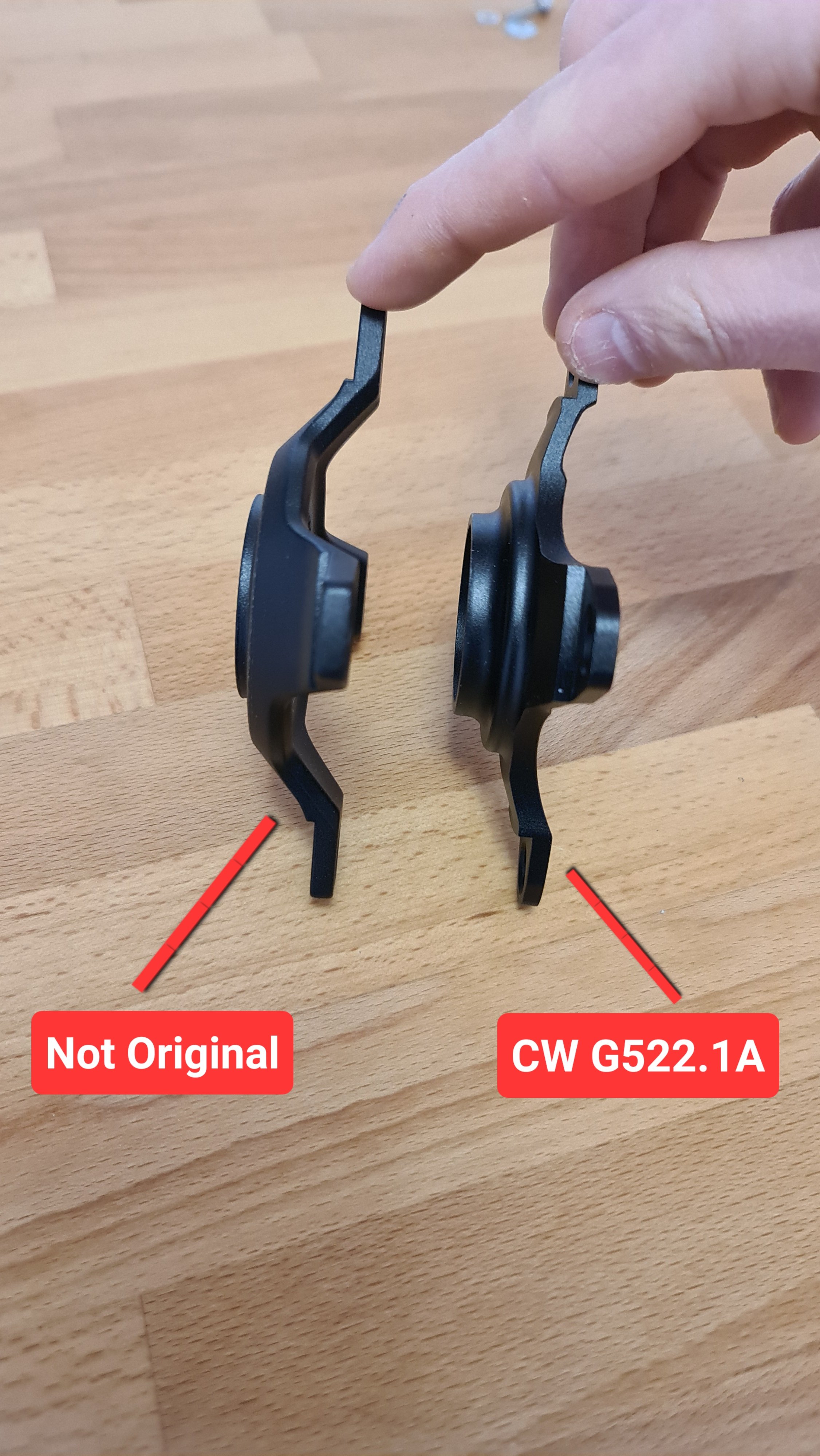

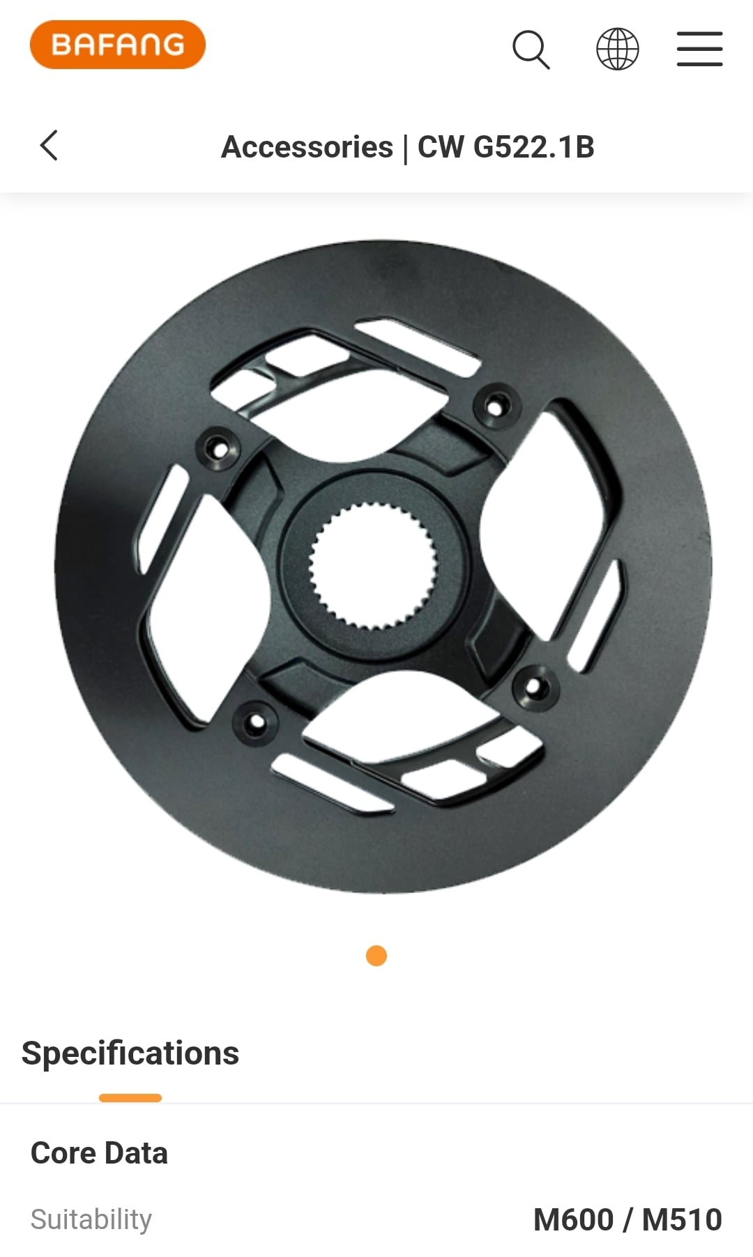

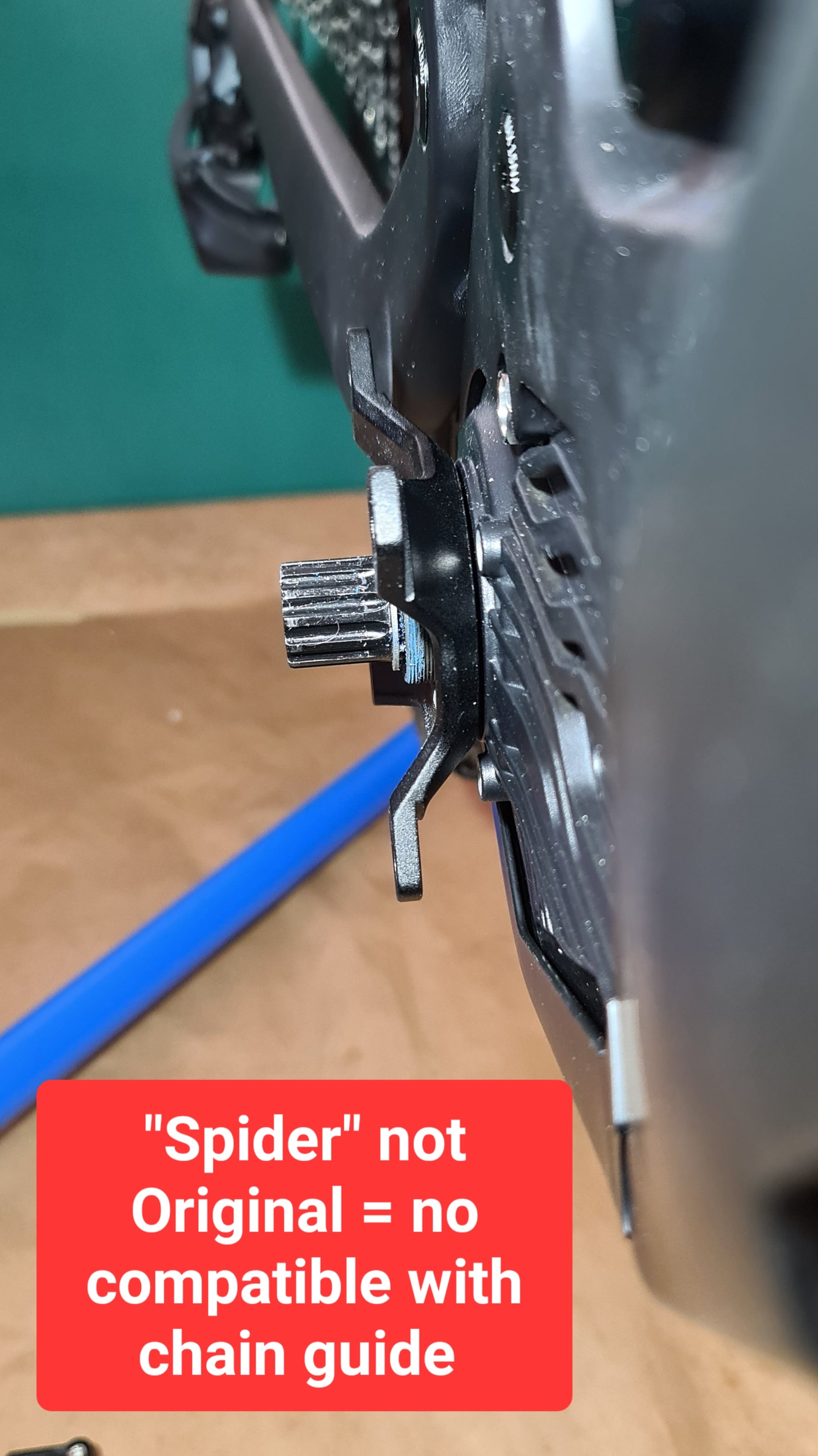

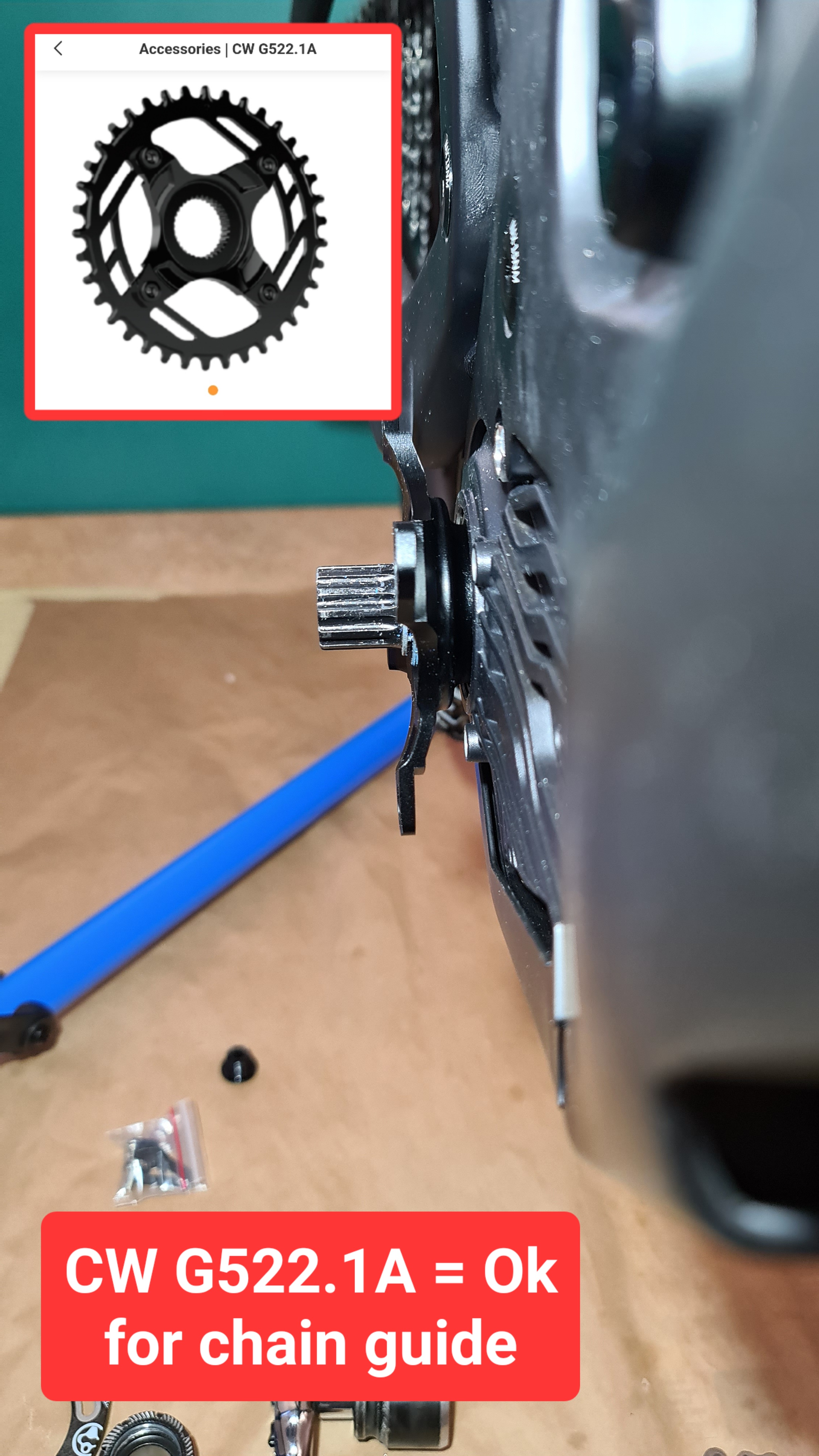

Remember in one of my previous posts I told you that the chain guide wasn't compatible. I have since found the problem and also a solution. There are several models of Spider that are more or less compatible depending on the motor models (M510, M560, M600...). Some motors come with a chain guide system (ISCG-05) like the Bafang M510. If, like me, you want to install a chain guide, you must have the right "Spider." There are two compatible models, here are the references: - CW G522.1A - CW G522.1B
The "CW G522.1A" model is a spider that can accommodate a single chainring without external protection, and if I understand correctly, the "CW G522.1B" model is a spider that can accommodate two chainrings or one chainring + protection. I personally recommend opting for the "CW G522.1A" model because I don't think the "CW G522.1B" model cant's easily accommodate a chain guide due to the external protection.
So, you must be careful when ordering your motor and accessories to ensure that the supplier provides you with the correct "Spider," and thus you won't make the same mistake as me. I also want to make you aware that if you choose the "DCP245" screen, opt for version V3.0, which is compatible with the "Bafango+" application, allowing you to customize your modes.
Indeed, for routing cables through the stem, it's a bit limited with the headset provided with the frame. I think if you want to add more options than me, as you mentioned; a cable-actuated derailleur and a thumb throttle, it will be more tedious, and you won't be able to use the silicone sealing gum because it has 4 holes, and you will have 5 cables. Moreover, the cable of the "DCP245" already doesn't pass through the headset provided with the frame... I doubt that the connector of the thumb throttle will be able to pass through the hole of the headset.
I think you should equip yourself with another headset similar to this one ;
However, if you decide to order this model, I cannot guarantee the manufacturing quality and the quality of the materials used. I have never had it in my hands. If this headset is entirely made of metal (aluminum, for example), and if the cable passages are large enough, I think it could be worth considering. However, it has the same drawback as the headset provided with the LCE971 frame. That is, it will not be 100% waterproof...
Of course, with some measurements and 3D printing, it is possible to overcome this slight flaw.
Regarding the aluminum motor support, you don't need it... You simply need the ABS plastic covers G520A.
To get this plastic cover kit, you have two options: the first is to buy a complete Bafang motor kit (motor, crankarms, cover, display, cable, bolts, screws, throttle...) and the other option is to buy everything separately. I recommend the first option and also recommend this store :
View attachment 139377View attachment 139378
View attachment 139381View attachment 139382
View attachment 139384View attachment 139385
View attachment 139386View attachment 139387View attachment 139388View attachment 139389View attachment 139390

Oh good to know! I'll ask which spider is included in the set. Thanks!
Does the ISCG-05 guard system bolt to the motor mount holes? The .1A spider has room to fit that system better?
Good remimber about the version 3.0 also. I found this out on my research already but had forgotten!

Ah that's what I thought (not needing motor support). Thank you.

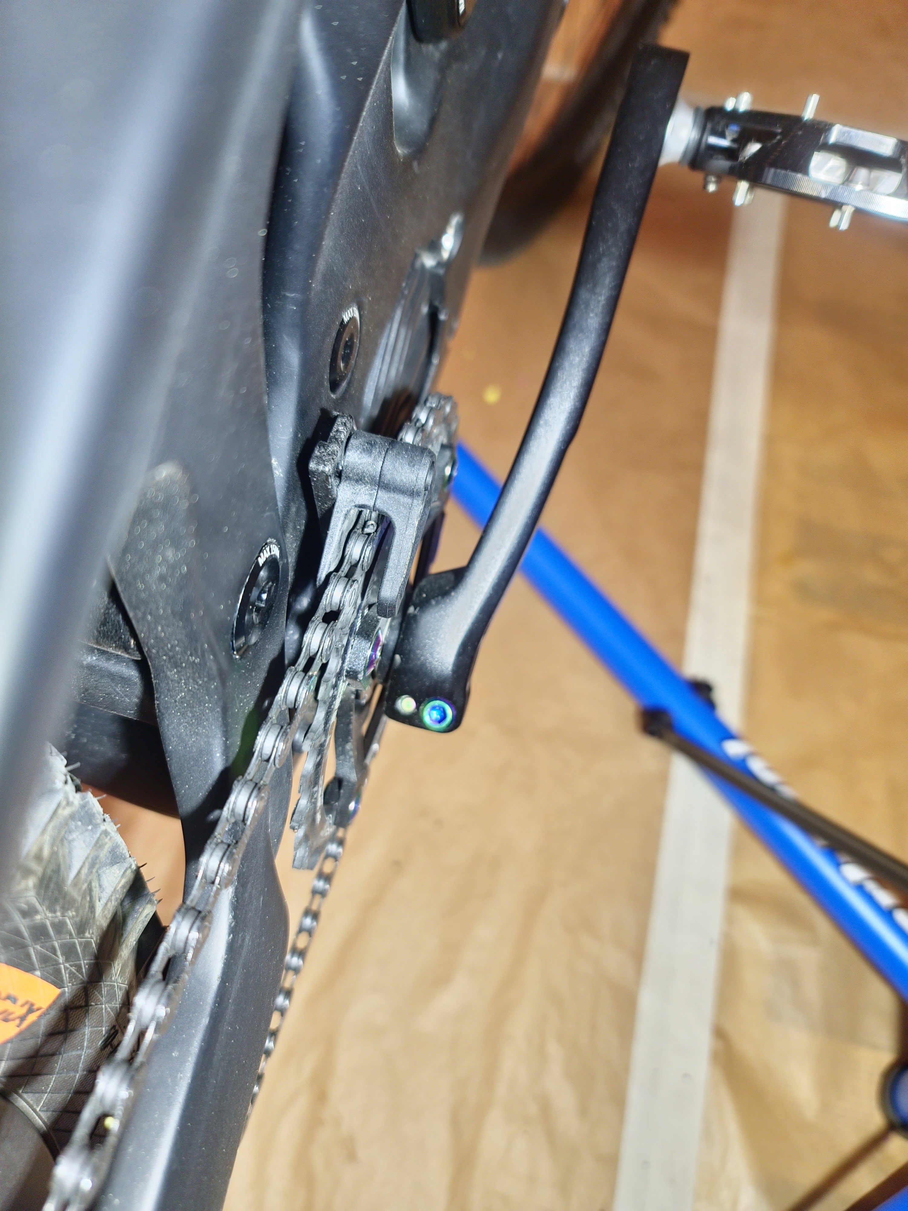

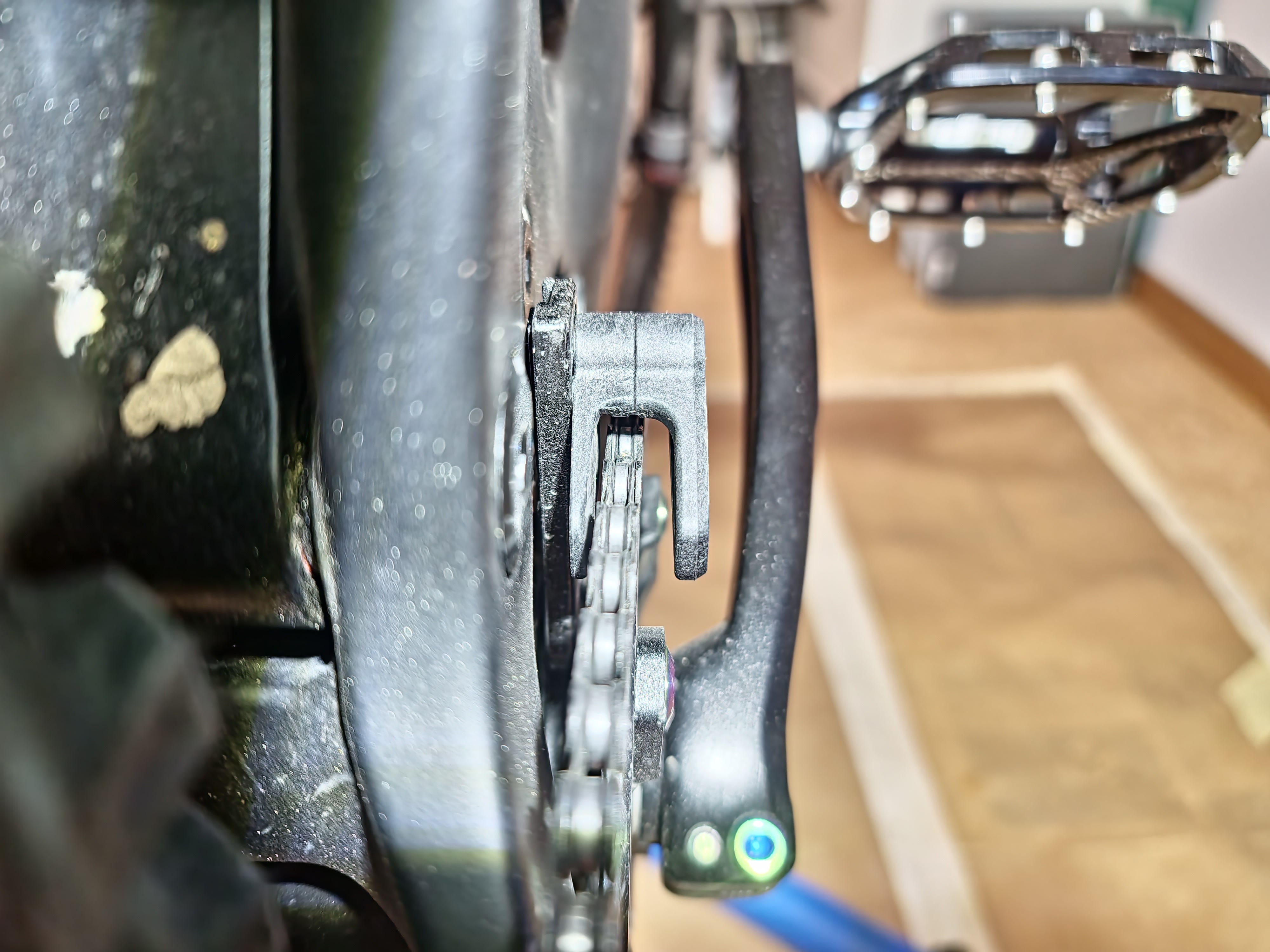

As for me, I will have to modify my chain guide because when the chain is positioned at the top of the cassette, it rubs against the chain guide.
For those wondering which model of chain guide it is :
View attachment 139728View attachment 139729

I think the m560 does even take the 1b. Only 1a fits.

I bought my battery here :
(For my Bafang M510 : 48v15a)
The store mentioned that the cells were Samsung. I haven't yet verified this, but I did a capacity test that was very accurate, reflecting the seller's claims.
I don't know if Dengfu uses SYR brand batteries in some of their frames. In any case, even within a bike frame brand, they might use different brands and models of batteries depending on the needs and the type of riding.
To address your "edit": No, this frame does not use Bafang OEM batteries.

I completely understand your concerns regarding battery safety, and it's clear that zero risk does not exist. It's also true that there's a higher risk when buying a battery from a third-party Chinese company compared to a well-known manufacturer like Bosch, to name one.
It's important to know that I have the equipment and skills needed to assemble a battery. I can therefore fairly estimate the cost of a battery. Even though a SYR battery costs around €300, this is realistic, although the profit margin isn't high.
An individual who orders a small quantity of cells will pay a high price. However, a company that uses thousands of cells daily gets them at drastically reduced prices.
As for the rest, such as the charge-discharge management part (the BMS), it only costs a few dollars. The nickel strips used to assemble the cells are not the most expensive part of a battery.
Here are some numbers to give you an idea of the total cost of this battery:
- SYR014 chassis: $35
- Samsung 21700 cells: 39 pieces = $117
- BMS: $10
- Nickel strip: $5
- Sleeving, insulation, cable, various: $10
Of course, these prices are for reference and not exact, as they depend on the company and the negotiation it does upfront. But generally speaking, this gives an price of $177 USD.
Add to this labor, sales margin, and shipping costs, and the €300+ price for a high-quality battery is realistic.
People often see Bosch batteries with a 750W capacity priced at $1000, making it seem inconceivable to get a quality battery for $300 USD. In reality, traditional manufacturers are making substantial profits.

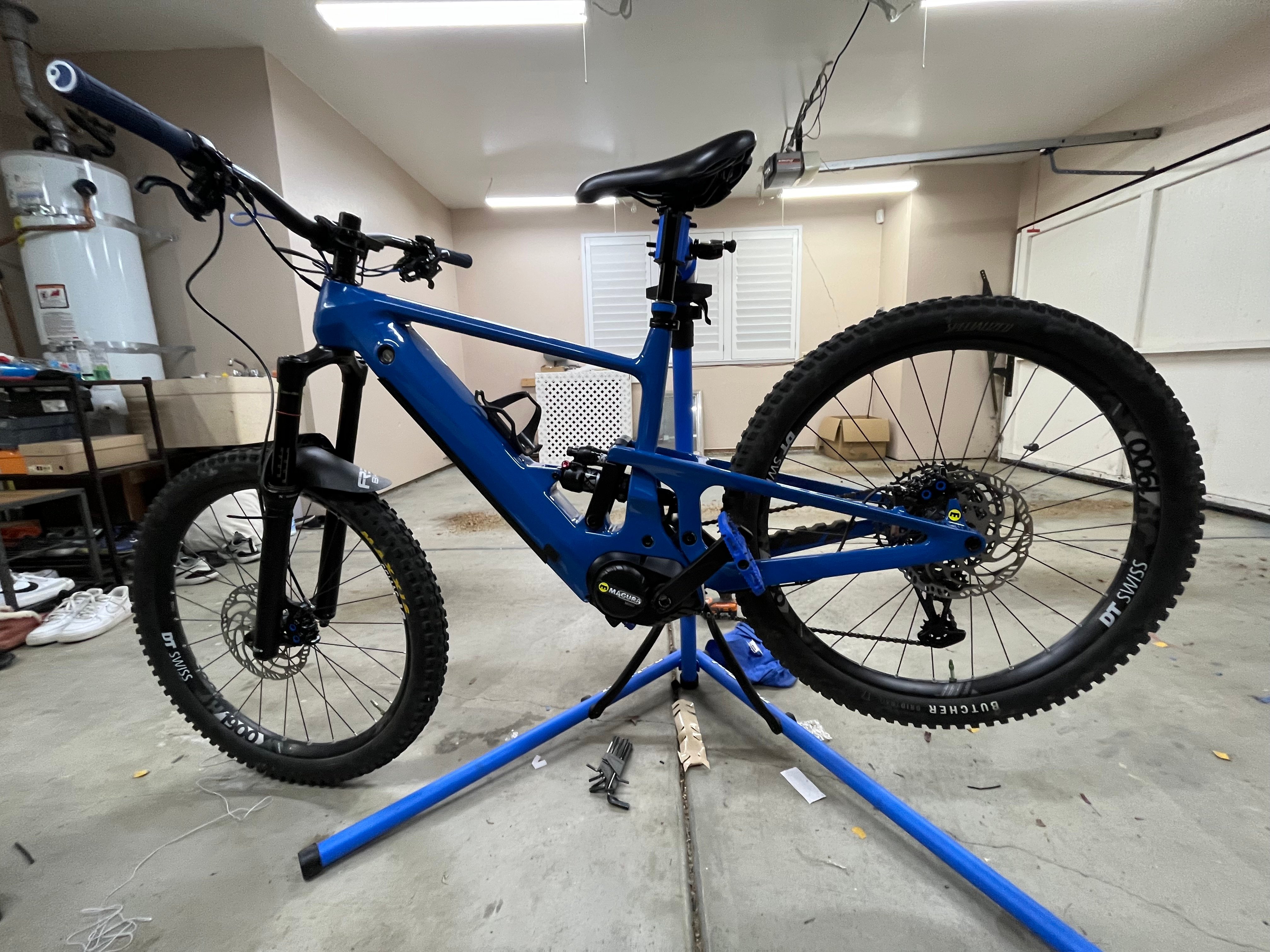

Well, seeing your build and the new M560s being available made me bite the bullet and dive into the fun.
Placed an order with Jim for a painted LCE971 and am configuring another order for the M560/battery/supporting components to hopefully be shipped together with the frame. Now I have a month or so to pick out all my other components. I'll try and make a build log like you did here (Although mine won't be nearly as detailed and though out as yours!).
I wanted to do a mullet setup, but am a little afraid of messing with the geometry of the frame at all by doing so. I'll have to make that decision soon. If not mullet, it would just be a 29" all around.
I am quite happy with the mullet. I built it as a 27.5 with a 180mm fork. It was doing ok but I wanted more BB clearance. I changed it to a mullet but it was terrible with climbing with the 180mm front. I changed the air spring to 160mm. It is great.
Great to hear on the mullet, I’ll probably give it a go then. I like the color there, I went for PT2995C to try and match the blue from Yeti bikes, I’m hoping it’ll come out good.
I plan on doing a 160mm fork up front, most likely either the e-optimized Fox 36 or a RockShox Lyrik.
The lyrik is what I have.

The LCE971 frame is not originally designed for a mullet setup, which is the first thing to keep in mind. However, if you are still tempted to try riding it as a mullet, I would advise limiting the front travel to 150mm to minimize alterations to the original geometry. And don't make the foolish mistake of increasing the travel to 180mm it's not just shooting yourself in the foot but practically in the head.
Switching to a mullet setup will result in a steeper head angle, a longer trail, and a lower bottom bracket height.
Personally, I see no real benefit in switching to a mullet setup. If you primarily engage in aggressive downhill riding, it might make sense. However, in that case, it's better to opt for a pure enduro e-bike rather than a heavily modified all-mountain bike.
This is the sort of response I expected to just throwing a mullet setup on a bike not necessarily designed for it. Seems like a surprising number of bikes do come in both options. I was planning on 160mm of front travel on whatever I do. Still haven’t purchased any of my other components yet, got plenty of time before my frame and motor will get here to decide.
One question I’ve been trying to find an answer on: Is the crank spline on the 510/600/620/560 etc compatible with any of the other big brands? I wanted to use something a little shorter than the stock 170mm and would just get them included with my SRAM group set I’ve been eyeing if they’d work. They seem to offer different options for Brose or Bosch, would either of those work on the Bafang? They all seem to say ISIS compatible but I don’t know exactly what that specifies.
