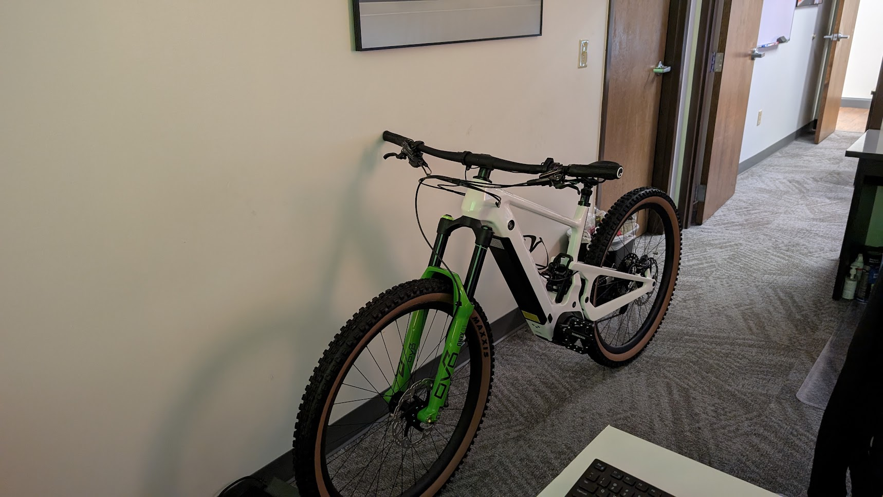

Assembly frame LightCarbon LCE971 bafang M510 (By Denver)

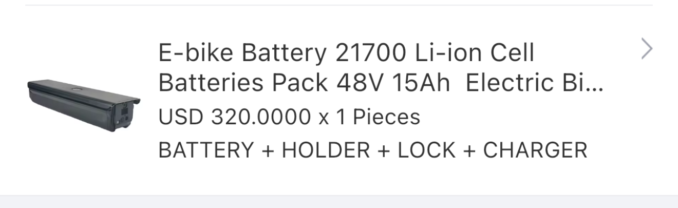

Thats the exact battery i have and asked them they're claming they don't have it.
Well I guess they are technically correct. They got it for me from somewhere else and charged me for it. I do not know where they got it though :/
I got mine from Changzhou Fieldebikes on Alibaba. They sold me the battery and the mount/lock hardware. They sell LightCarbon frames so they’re familiar with what’s needed.
Just need to do the chat thing with them on Alibaba.

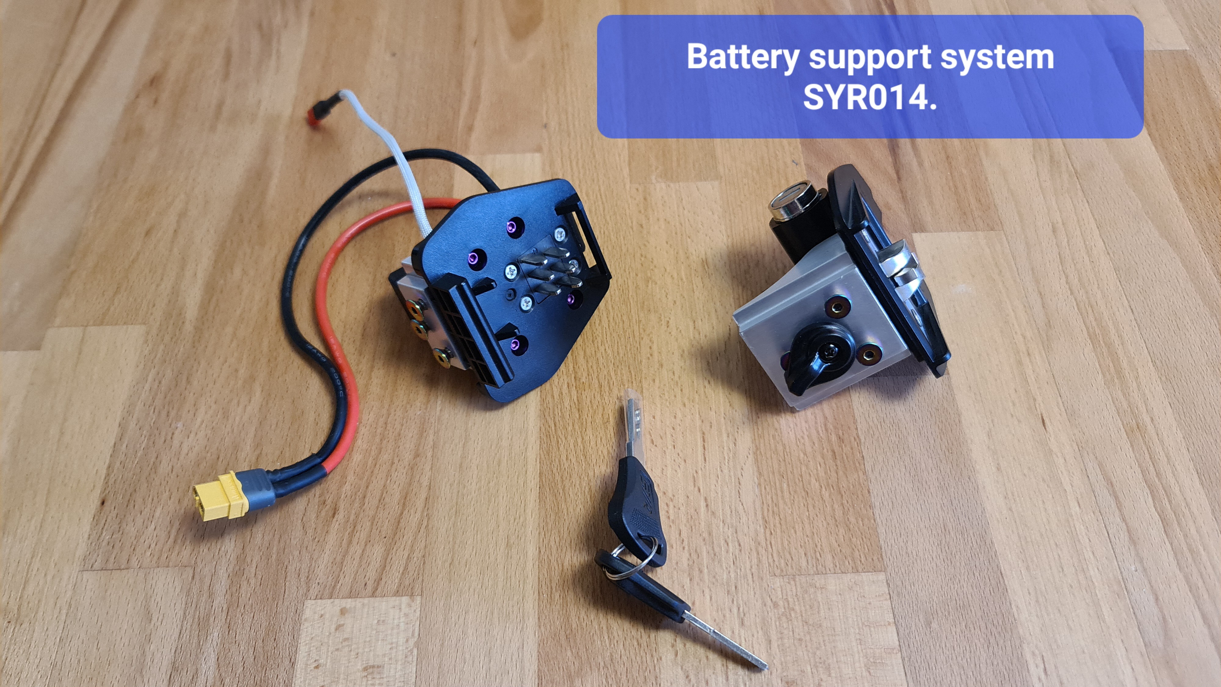

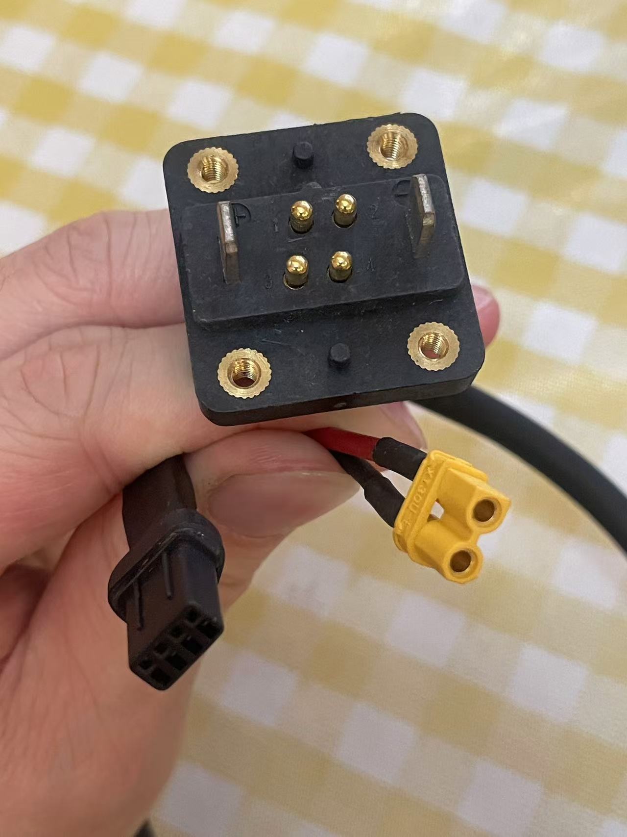

Do you know the pin out or wiring for this? Now they are saying they can sell me the base but without the wires. Did yours have wires?
Mine did. But they were too short and I had to have them extended.. If I recall the base has positive and negative markers as well as the xt60 connector or whatever it was called 😅 but if you do the wire yourself or have to extend it make sure you use a proper wire suitable for this use. Otherwise the wire can melt and short or cause a fire.
If you don't get an answer I can check up the wiring on my parts.
If you don't mind could you check yours and let me know. I'm also assuming I need some type of connector to power the m560
It might take few days but I can do it then if no one else has done it before that.
The yellow connector is named something like xt60 like I tried to remember it. It might have been named in this thread on earlier posts. You can find the name for it if you google the motor and check from the information given.

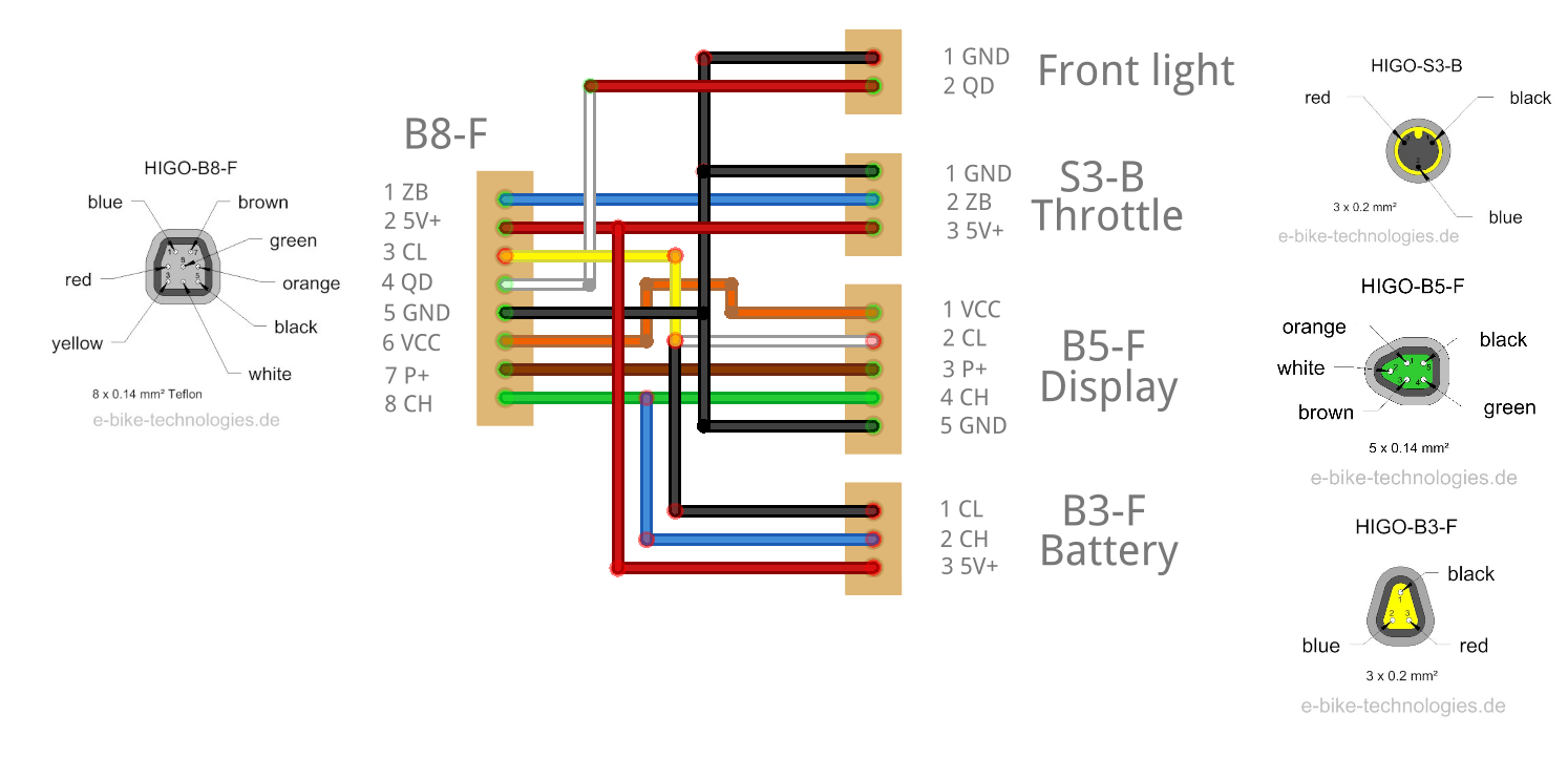

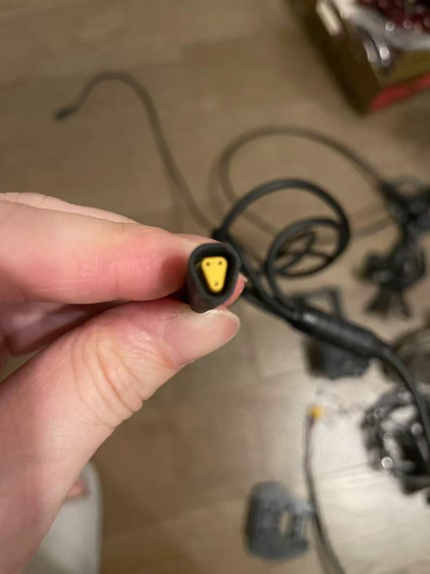

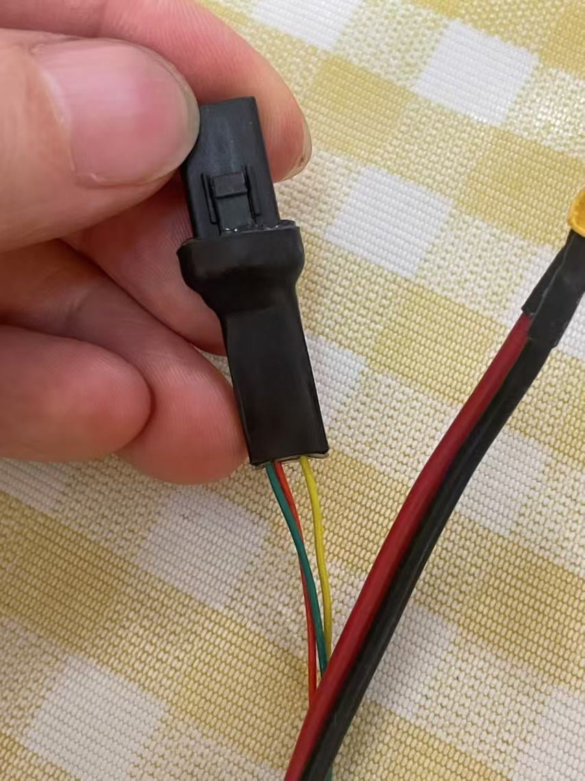

Does anybody know how to match my battery 3 communication wires with 3 pin connector?
or are there some issues if I leave this communication wire and just connect power wire.

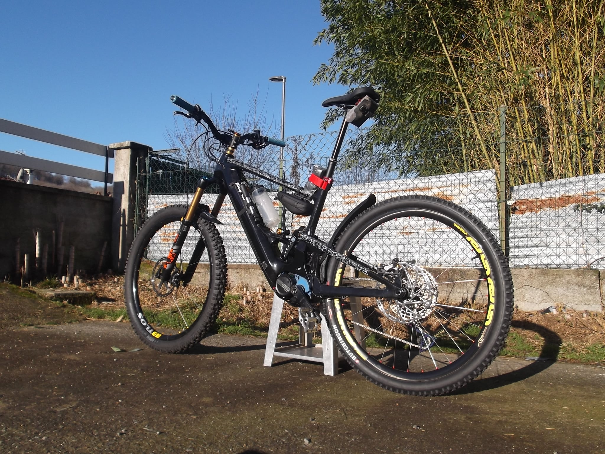

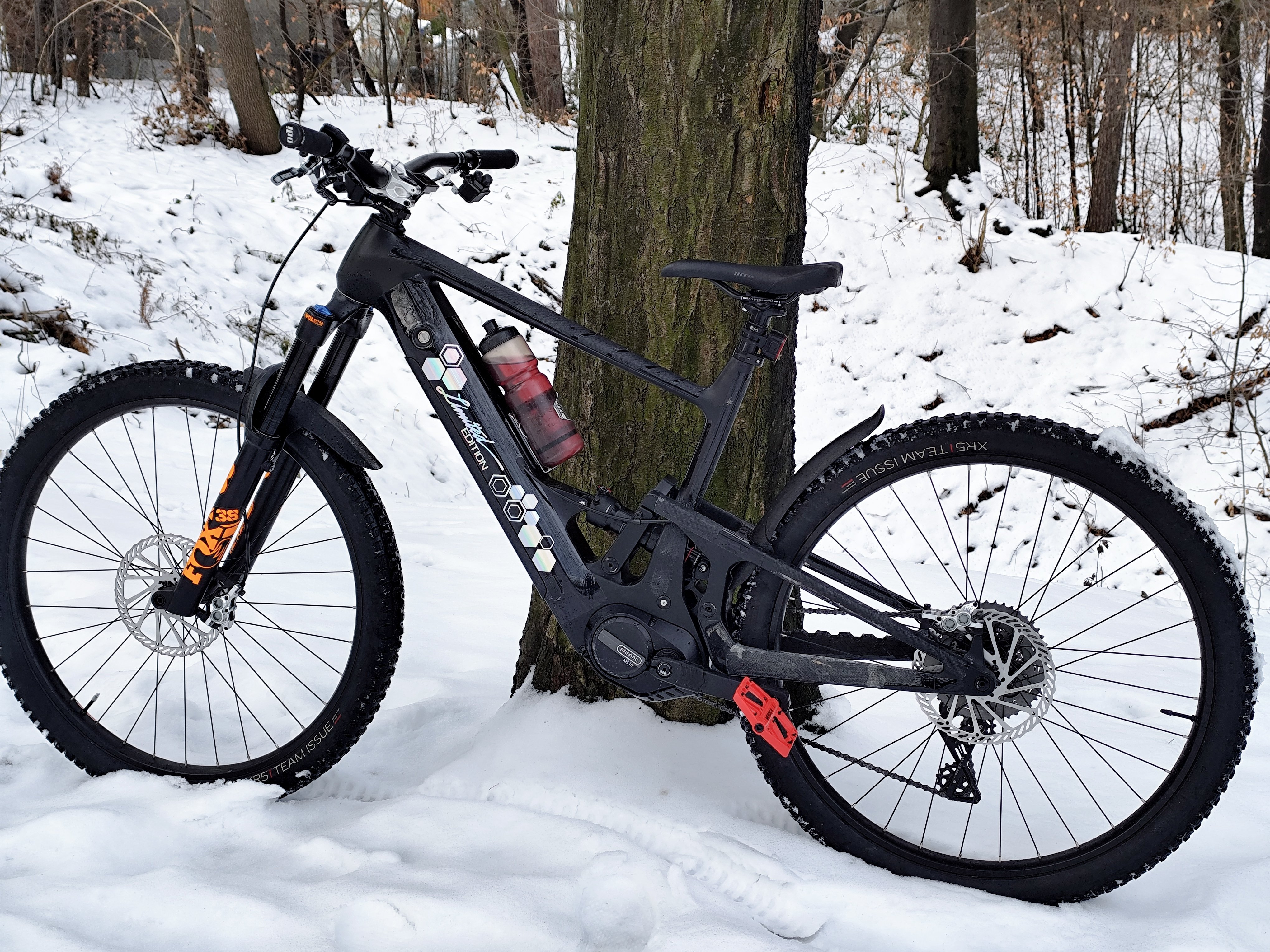

Assembly finished, i wait ground dry to test now.

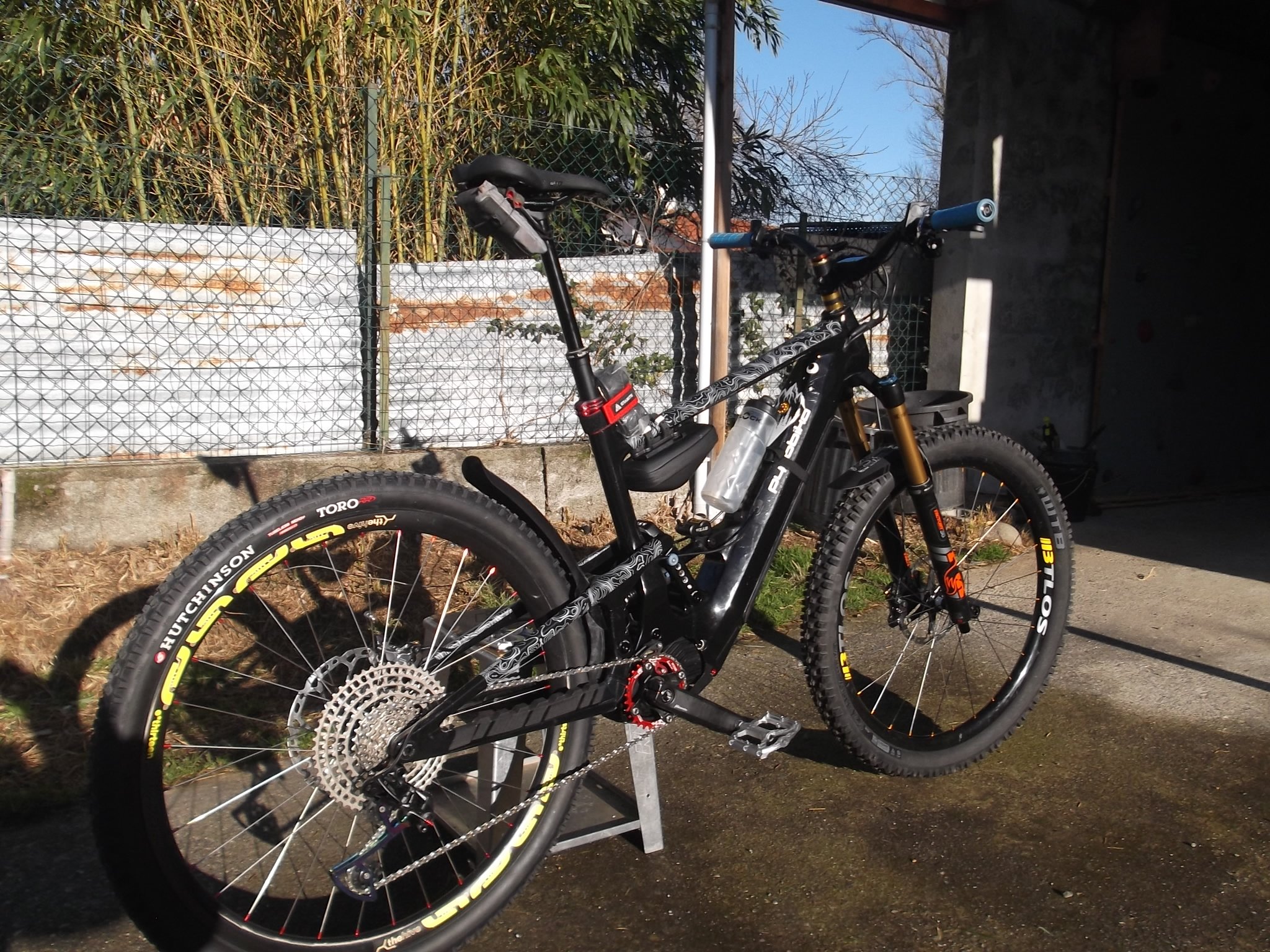

light carbon frame always seem great finsh and quality. Easy assembly, always fit perfectely. I have recover and adapted my unused CEF50 15Ah battery to instal in. Too low reach for my tall (light carbon don't produce XL), compensated by 60mm stem and 60 rised handelbar, 200 seat travel post fit. 30 teeths plate fiting with spacer 1.5mm behind spider.

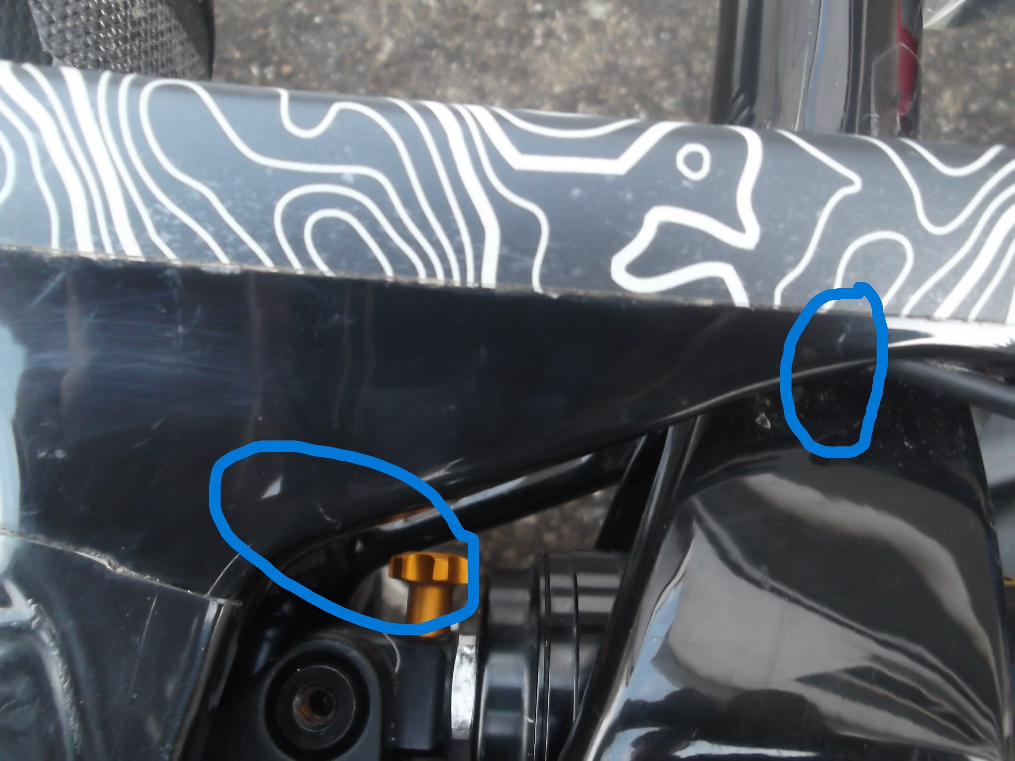

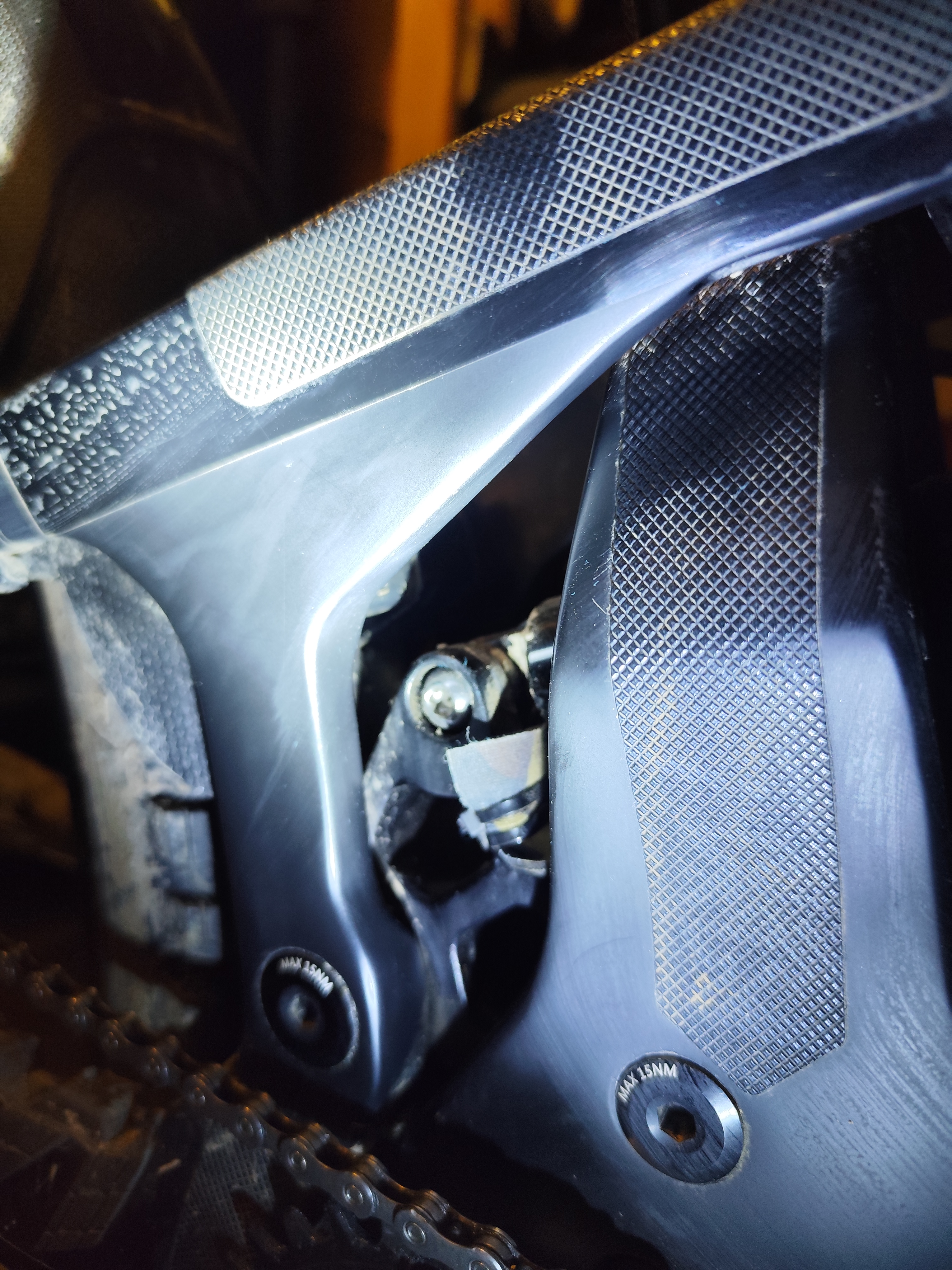

After 2 exit and the 1st on moutain, craks appairs on my swingarm :eek:. It's the lasr revision (the 3rd) after that previous have failed with other customers. This one don't seem more reliable. I think that's the designthe problem with this long ovehang (compare with SCOR or SANTA CRUZ). Pity, bike weel fuctioning.

Please do and post more photos!
I know, bad quality pics. But hard for me to do better. t's not breaked for the moment, only cracks on paint (and noise when i ride). May be i will ride it near the home and i will share pics when it breaking. In any cas i will never go to moutain with it now.
May be i'm unlucky ? or as said lightcarbon it's because i make holes ? or i reversed the link position ?
Personally i think that the cantilever don't matching with my weight. Pity i appreciate the functioning but i will not trusted in and i will not paid more, as requsted by lightcarbon
About lightcarbon answer, i have open a dedicated tread
I really think it's because you reversed the link orientation. What made you choose to do that?
Because for my point of view it's the best way to have the axis max free space in any position. see the pics of the 2 assembly fully compressed.
Of course i don't taking account of the "stress direction" 😂 of this molded alloy link symetrical. who explain that it move or not following is direction ? That overpass my competencies (40 years of industry). If somebody have the competency to explain that, i ear
For your opinion what is the raison of the other customers break of the switcharms ?
