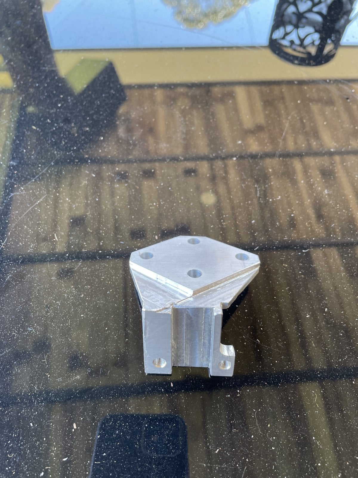

I want the lock gone to reduce the risk of battery departure, reduce rattles, to improve fitment and reduce complexity. If it saves weight then that’s a bonus, but frankly I couldn’t careless if it added 500g

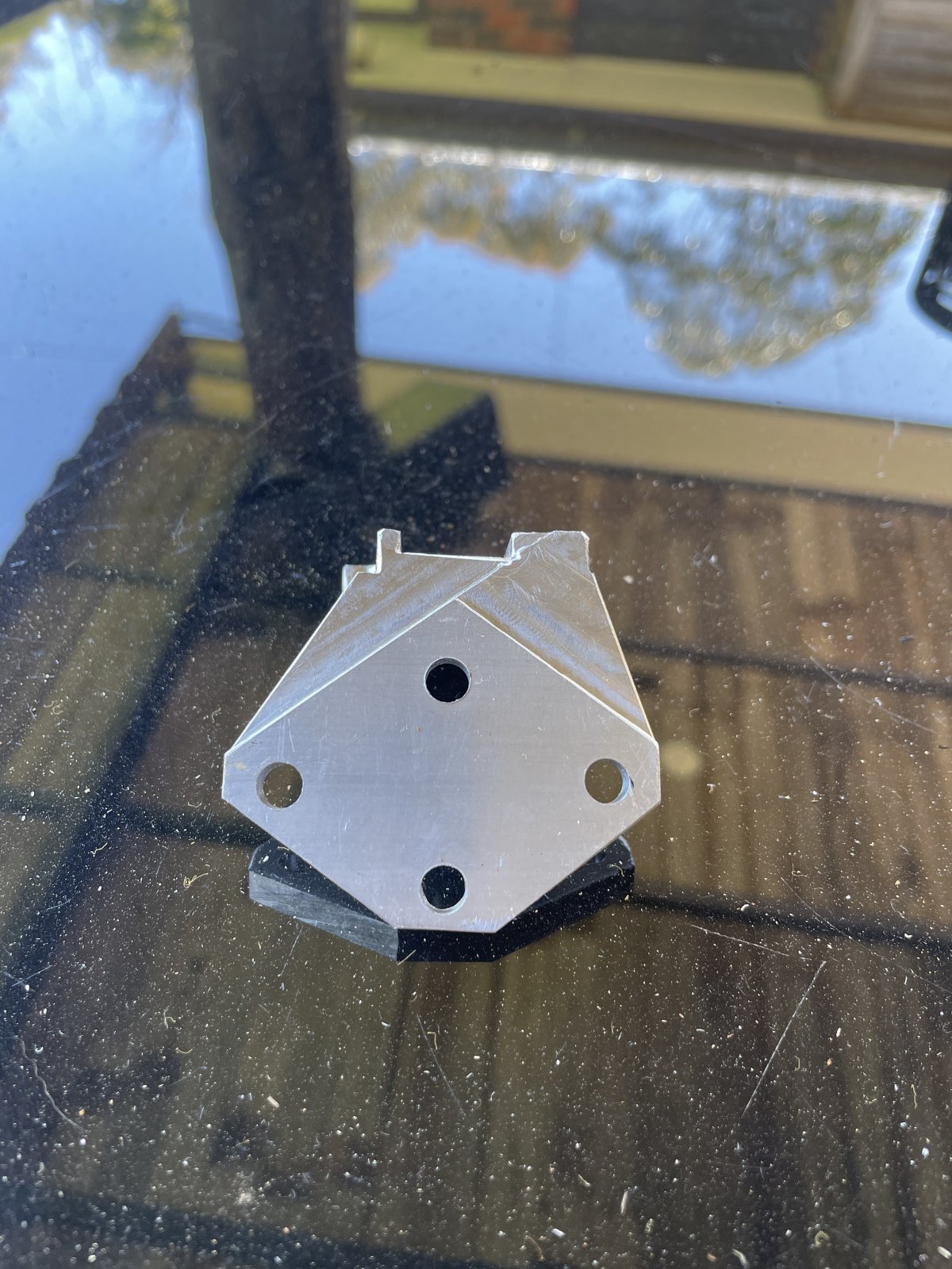

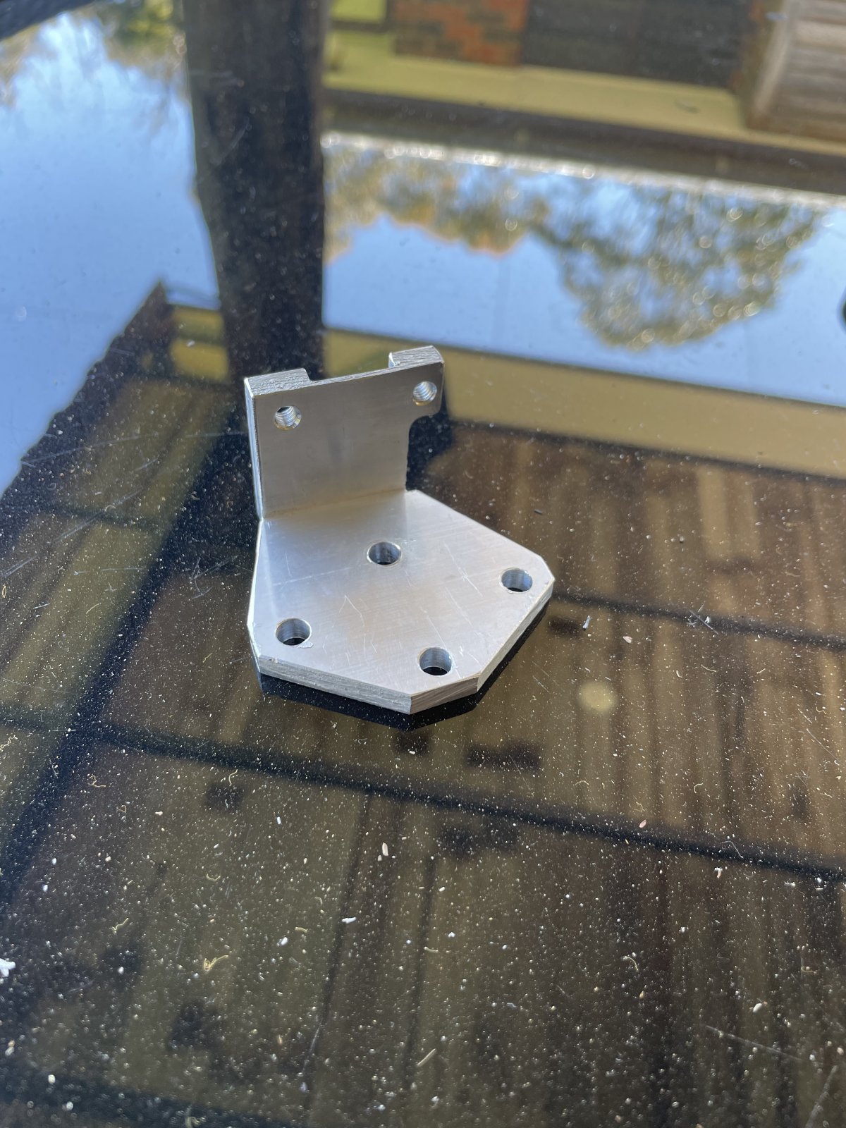

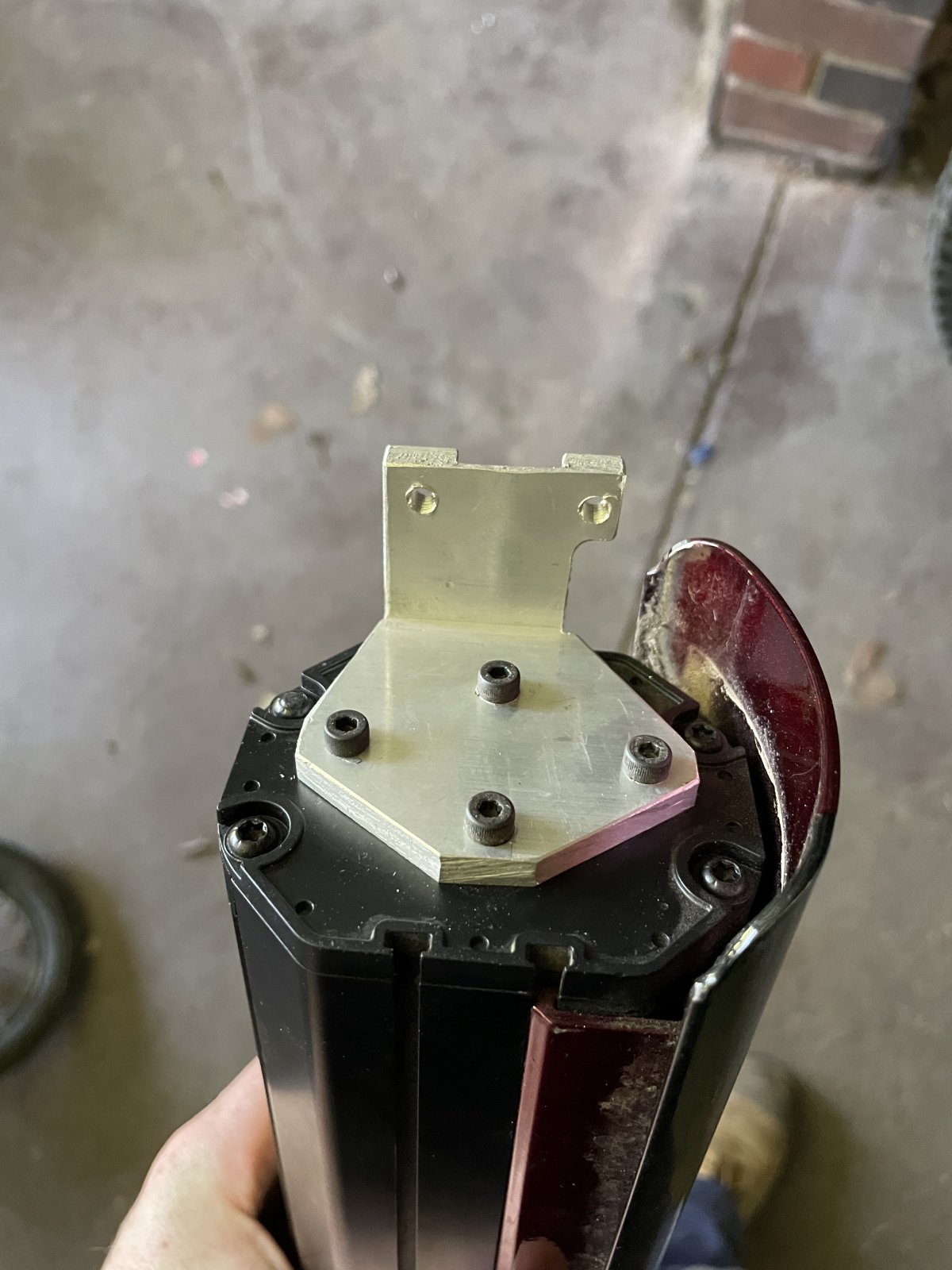

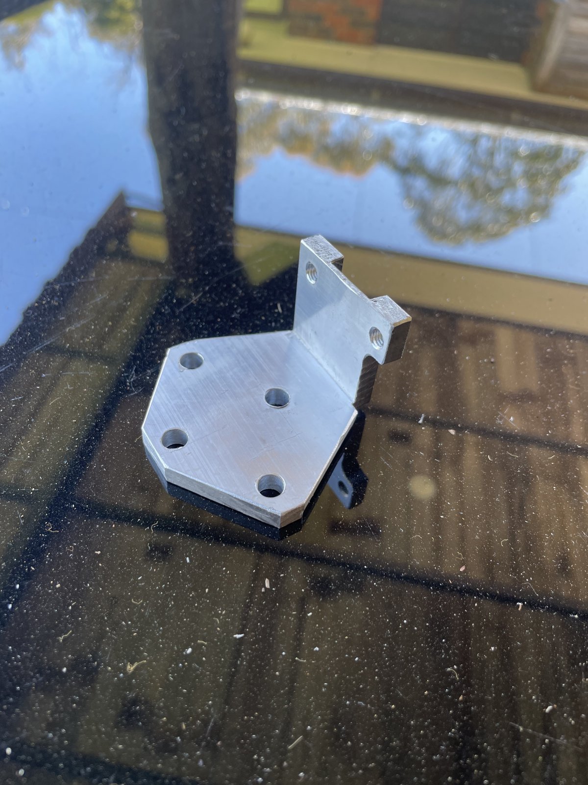

Ok here’s version 2.
I decided using 6mm angle and relieving some material was the way forward.
Battery interface holes are 6.0mm to allow for some adjustment, but fits perfectly on my bike with it located centrally, using CS screws.
The bottom battery mount is adjustable up and down the down tube around 2mm. So I set mine right in the middle which should allow for variations between individual bikes.

Ok so I’ve made a jig and can now replicate these little guys. Are we able to confirm that all 13 interested parties are happy with the product?
I will make this initial run for £30 each plus postage (or the equivalent from where you are) but after this lot I’d say the price would go up as there is some time in the fabrication.
Or obviously if you prefer to wait for the cnc product?
I can have them done in a week.

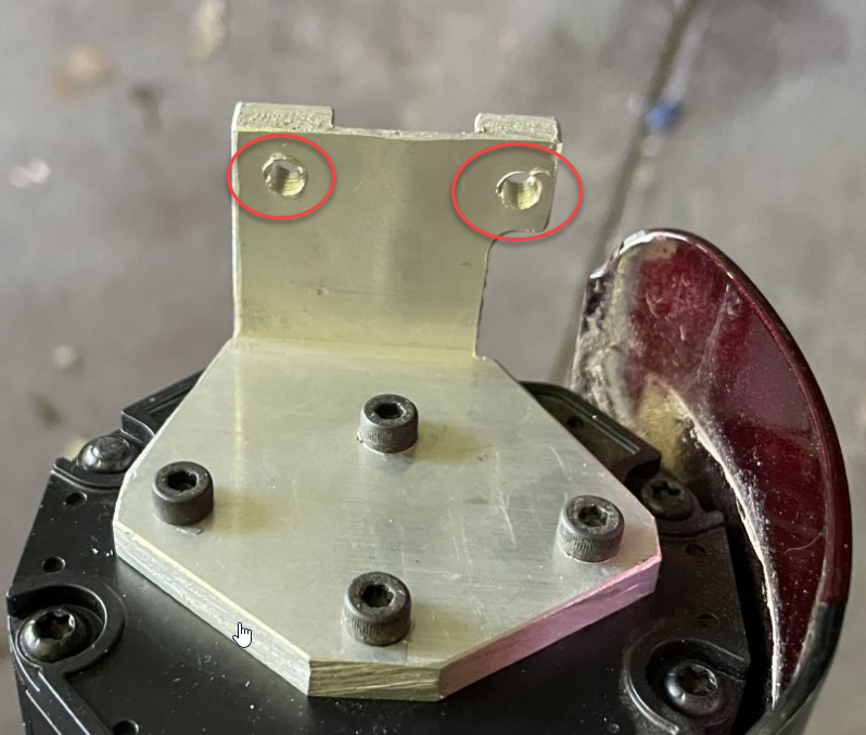

are you going to drill and tap these two holes?
previous conversations were suggesting that tolerance levels on the bike may require each user to drill and tap their own holes?
My plan is to drill and tap these holes as not everyone has the tools to do so.
Since there is adjustment in the bottom battery mount to move the battery assembly up and down the down tube and I have built adjustment into the bracket itself I believe there is enough flexibility to cater for small manufacturing variations in the bike, I’d be surprised if tolerances in this area were over 1.0mm.

Could you machine out 'pockets' or cut outs on the flat parts. You know save a few grams more but not sacrifice strength. I mean that the flat part with the 4 screws doesnt look like its under any strain, so maybe less metal there wont matter.
Just a thought..
the 750wh battery is 5Kg, so I would rather have too much metal for the strength in favor of losing only a few grams.
