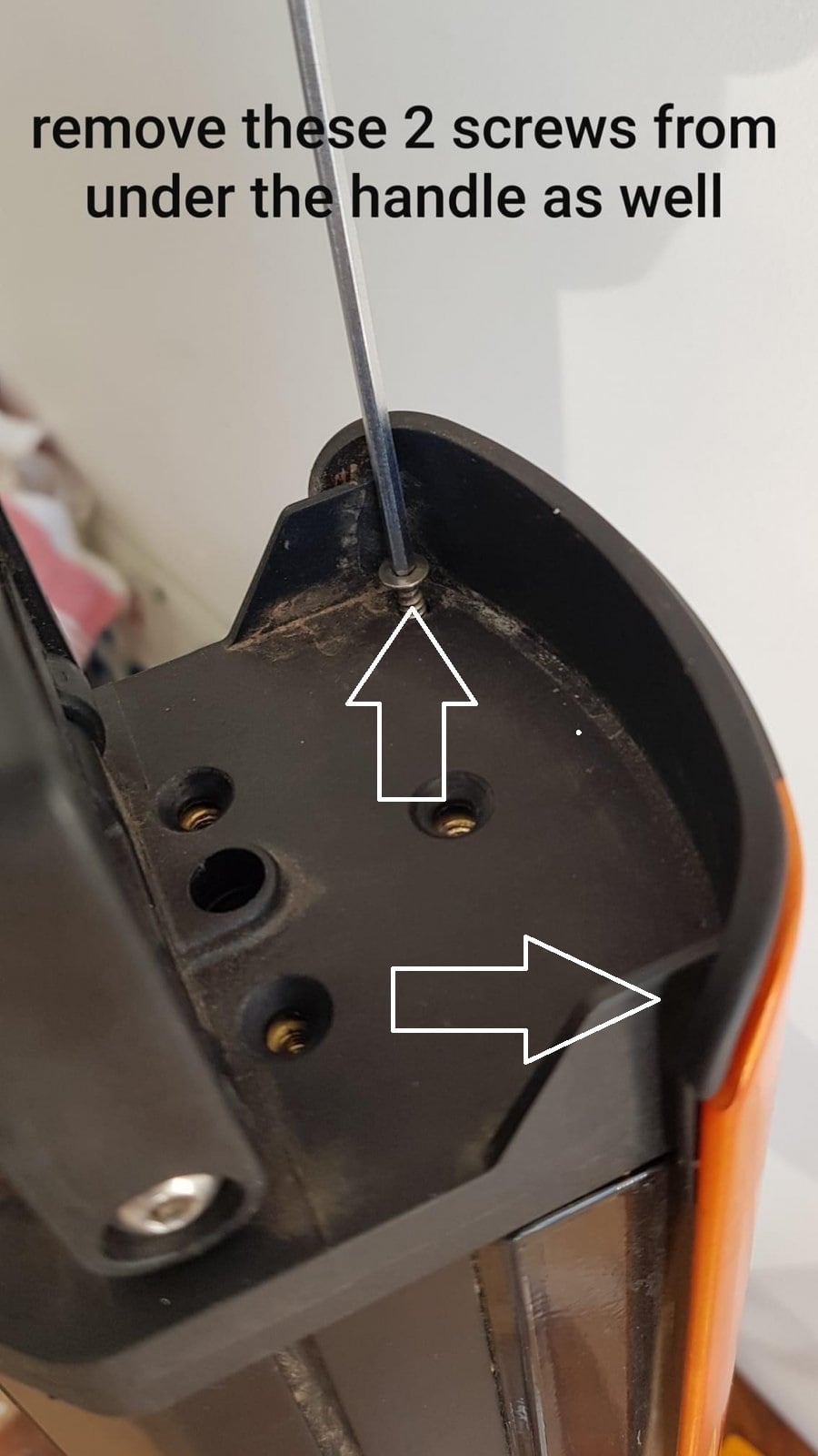

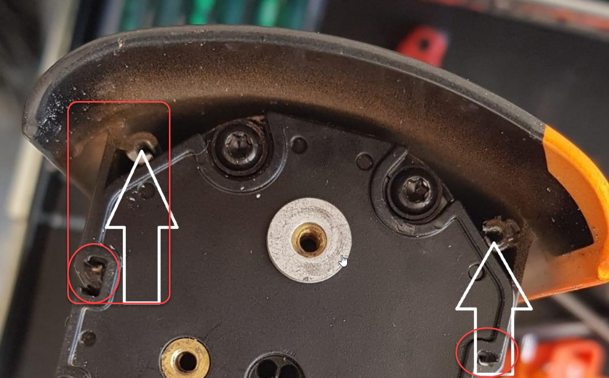

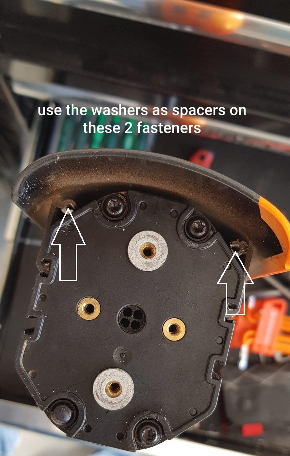

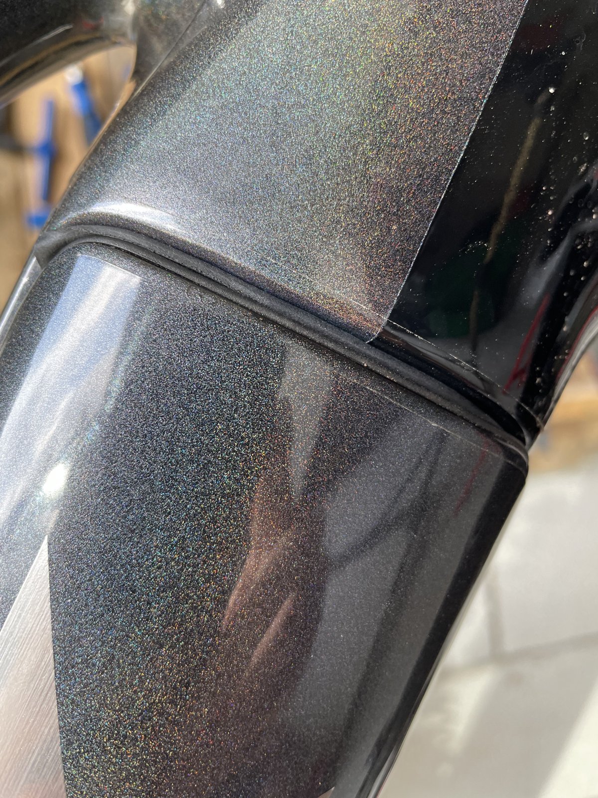

I have been looking at this plate and knocked myself one up pretty much the same design except i have incorporated the two smaller screws into my design, these two screws hold the front cover to the battery and without them the top half of the battery will just rattle and eventually break.
is the battery cover not held securely by this clip? (on both sides)
@Arron M can you also do this in your design?
Not without a great deal of extra work, let’s be clear though, there is no chance the battery will break as stated above, I’m sure Turricann meant to say battery cover though.
Even still if you look at the way the battery cover is mounted I would completely disagree that it would break.
If you wanted to incorporate those screws then you should also add material down to level of the channel where the screw holes are, if you don’t then any movement between the parts will like cause thread damage.
It’s possible, I’ll have a think about how to make it work.
is its not necessary, then don't worry about it. (see my pics above)
This channel does all of the heavy lifting as far as mounting the cover goes, the top and bottom battery mounts prevent it from sliding in its channel. It’s not a perfect fit so if left open there is a chance of a rattle, but I’m not convinced it would rattle given the direction of the travel cause by its non perfect fit - side to side.

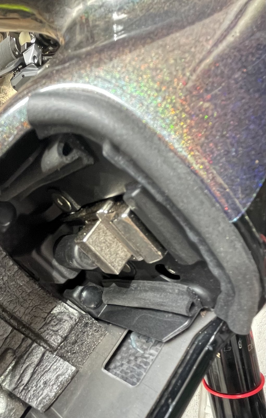

a small amount of rubber p seal on the battery hole cutout on the frame would stop any potential plate rattle.
