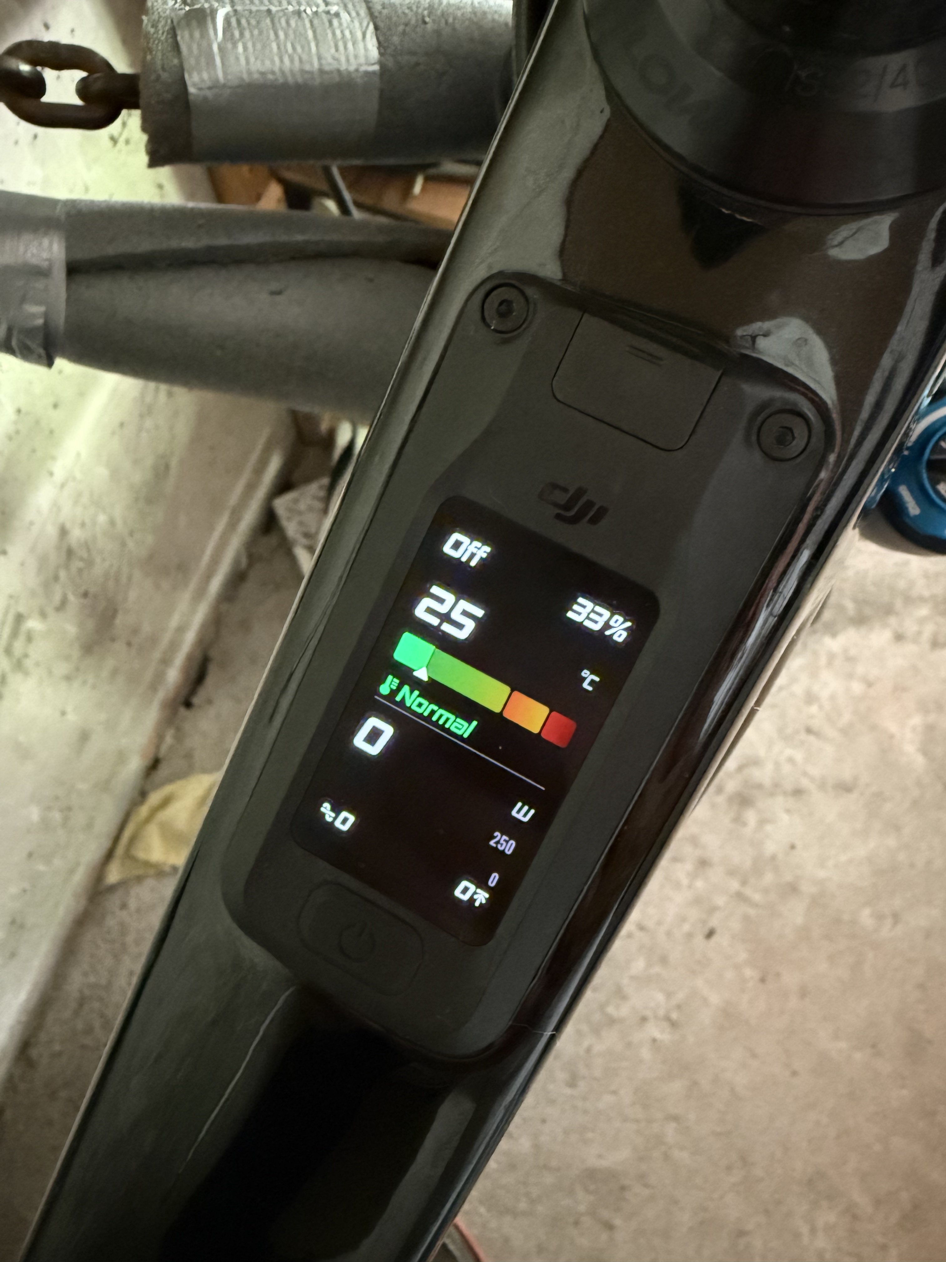

Did you check motor temperature 🌡️ on the AVINOX screen❓
For now the maximum motor temperature I reached is 70° in Boost mode, +1000W… and the Graph📊 stay green 🟩
Been using the graph and the motor has not got hot yet.
Battery did overheat and kicked the red triangle on and went into limp mode after 30 miles and a steep 500' climb.

Were you riding in Turbo mode? How long did you have to wait for the battery to recover?
Yes turned up to 1000w
That was weird, it let me ride home 1/2 mile in trail like power.
But it would shut off and on, then power on by itself, it cycled like that 10 times and after 10 min it was fine
Last night it did it again after setting records on hill climbs and up n down trails. But only after a 7 mile paved hill climb, last time it did it only on pavement getting from trail to the house.
Weird I shut it down to reboot it, and that was a mistake, it started and shut down on its own, but it would peddle and give power then shut off and give power, and after a mile of that it stayed on and got me home.
Says its the battery getting to hot
