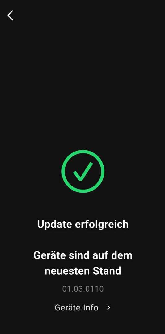

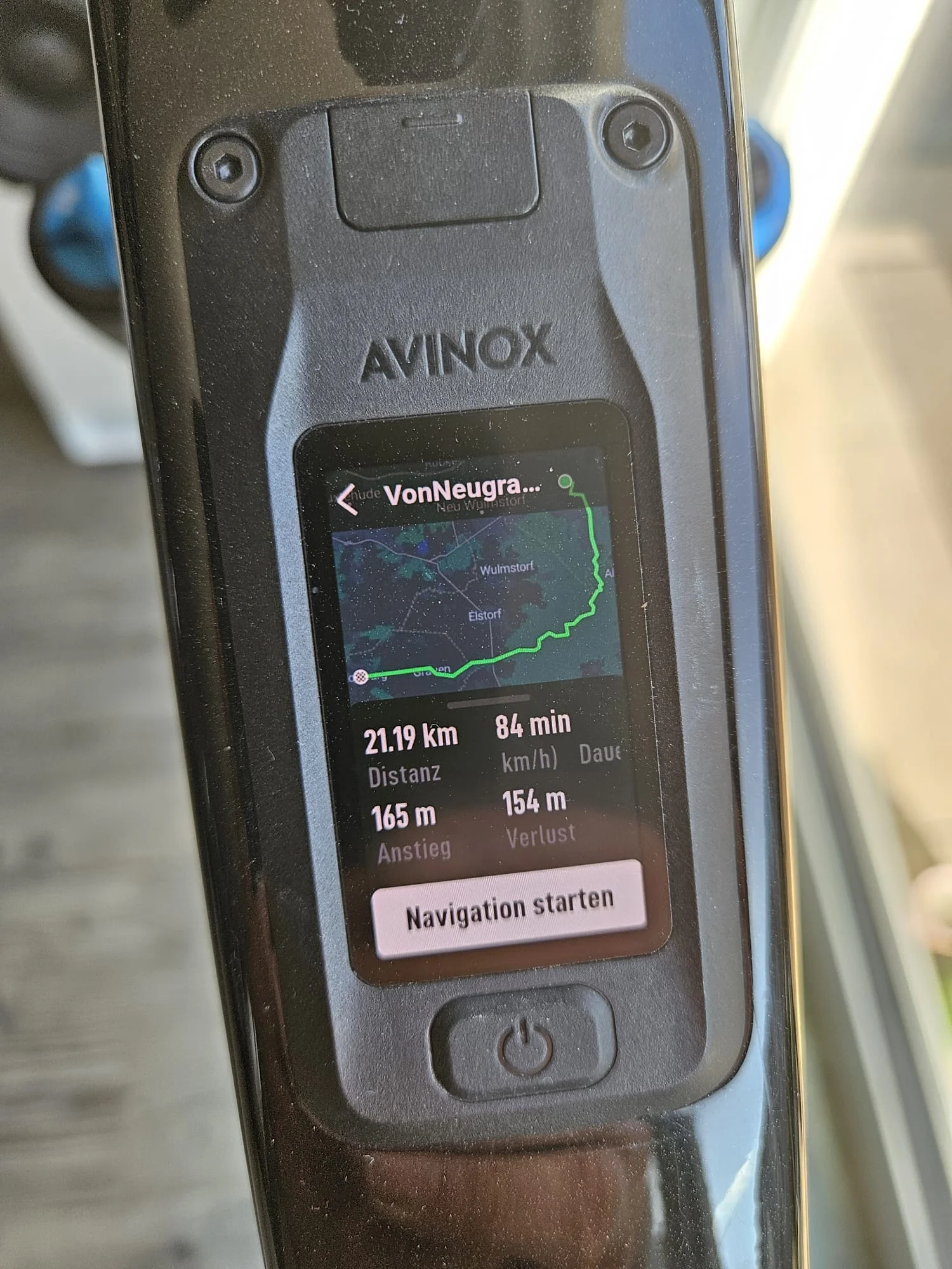

About an hour later, I received another update, specifically for connected devices, whatever those may be. Now it also works with Komoot. However, I can't start the tour directly from Komoot; instead, I have to click the compass arrow in the Avinox app's taskbar, then select the Komoot tab at the top, and then I can send the desired, previously saved tour to the bike.
It's certainly not the most elegant solution, but it's something at least.
