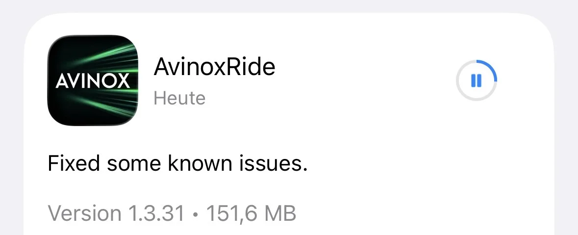

Me too. Since the main firmware update recently I have had to update about 6 times for an “inserted device”. I don’t have a SIM card, camera, watch or anything else. I have been doing the updates but it just happened again today. Hopefully someone from Amflow can chime in. Is something really being updated or is this a bug?
Yep, same for me, I contacted support and apparently they fixed it and it should not request the update for the same software version now, however I have just seen a update for a new version - 01.03.120 - but cannot find any release notes on this version - has anyone installed this update ?

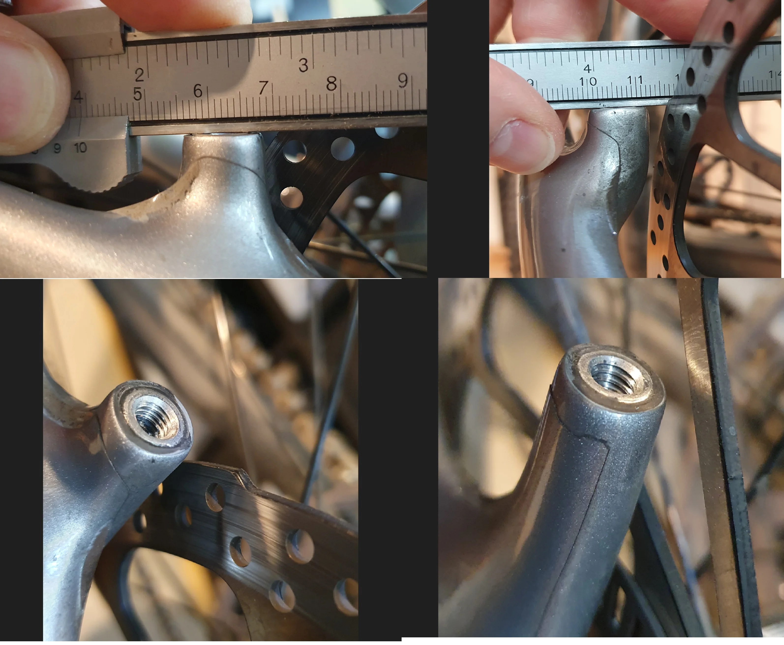

Since I've owned this bike, I've had problems with the rear brake. It repeatedly starts vibrating intensely – so much so that the vibrations are clearly noticeable throughout the frame, all the way to the handlebars.I've already tried different brake pads and rotors, unfortunately without success. The vibrations and the associated noises continue to occur regularly. I've owned many mountain bikes, but I've never encountered a problem like this before.
I took a closer look at the brake mount. I noticed (see photos) that the carbon part and the metal threaded part aren't flush. As a result, the +23 brake adapter has a very small contact area, which likely reduces its stability and contributes to the vibrations.For comparison, I checked other bikes, including my Santa Cruz Hightower. On that bike, the carbon part and the metal threaded part are perfectly flush, giving the brake adapter a significantly larger contact area and preventing comparable vibrations.
Does anyone have photos of this area on their bike so I can compare mine? Is the condition of my bike normal, or is it actually a manufacturing defect?

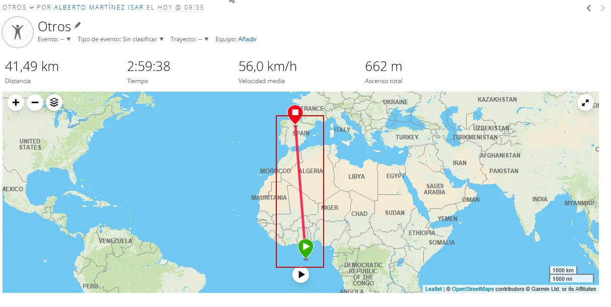

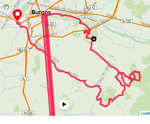

Hi, If i download the the .fit file from Strava generated from the bike and tried to upload to Garmin Connect the maps shows an erratic drawing always in the same direction, the rest of the data seems correct except the max speed but the track don't,

The problem seems to be that your Fit file contains invalid GPS coordinates of 0/0. The images show “trips” at longitude=0 and latitude=0.
So: poor GPS reception and an incorrect recording: Instead of null/null (nil/nil), 0/0 was recorded.

I just saw your post. Sorry for the late reply.
I think the fix for this it's that, wait a bit for the lock of the gps and started the track being stopped not moving.

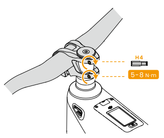

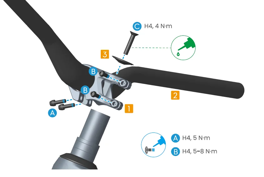

Dear customer, the torque value for tightening the stem should be between 5-8 Nm. Could you please confirm if you have used 5 Nm? We recommend trying 8 Nm to see if that resolves the issue. If you still experience problems with tightening at 8 Nm, please contact the store where you purchased the bike for further assistance. View attachment 152764
Does anyone know if 8nm is still the correct advice?
My stem has started to slip after 1 year of riding fine. My stem says on the rear 5-6nm, but here I see Amflow suggesting 8nm.
Thanks!
Thanks! That’s super interesting. My manual (and stem) both say 5-6nm. I’ll add a photo if I remember tomorrow.
I’ll try it up at 8nm, though. I’m fed up of it slipping mid ride!
If that doesn't hold it, try anti slip carbon paste.
After 9 months and easily 10-12 slips, I bought a new stem.
Not sure why the Amflow stem has a tendency to slip as the mating surface is not massively different to other stems.
A small tweak to the left or right was annoying but no big deal. The deal breaker was a nearly 45° bar twist on a steep DH track, which could easily have resulted in a crash.
A good bike shop with the Park Took DT-5.2 or similar disk mount facing tool should be able to sort those and get them flush/aligned for you.
Maybe even the shop you purchased it from could do it?
Doh, I just realized it’s offering to update an “inserted accessory”. I wonder what that could be? The AXS stuff is up to date.
