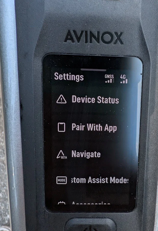

Good news, I was just tinkering around with the brakes and turned the PL on to take it for a spin... and 4G is working!

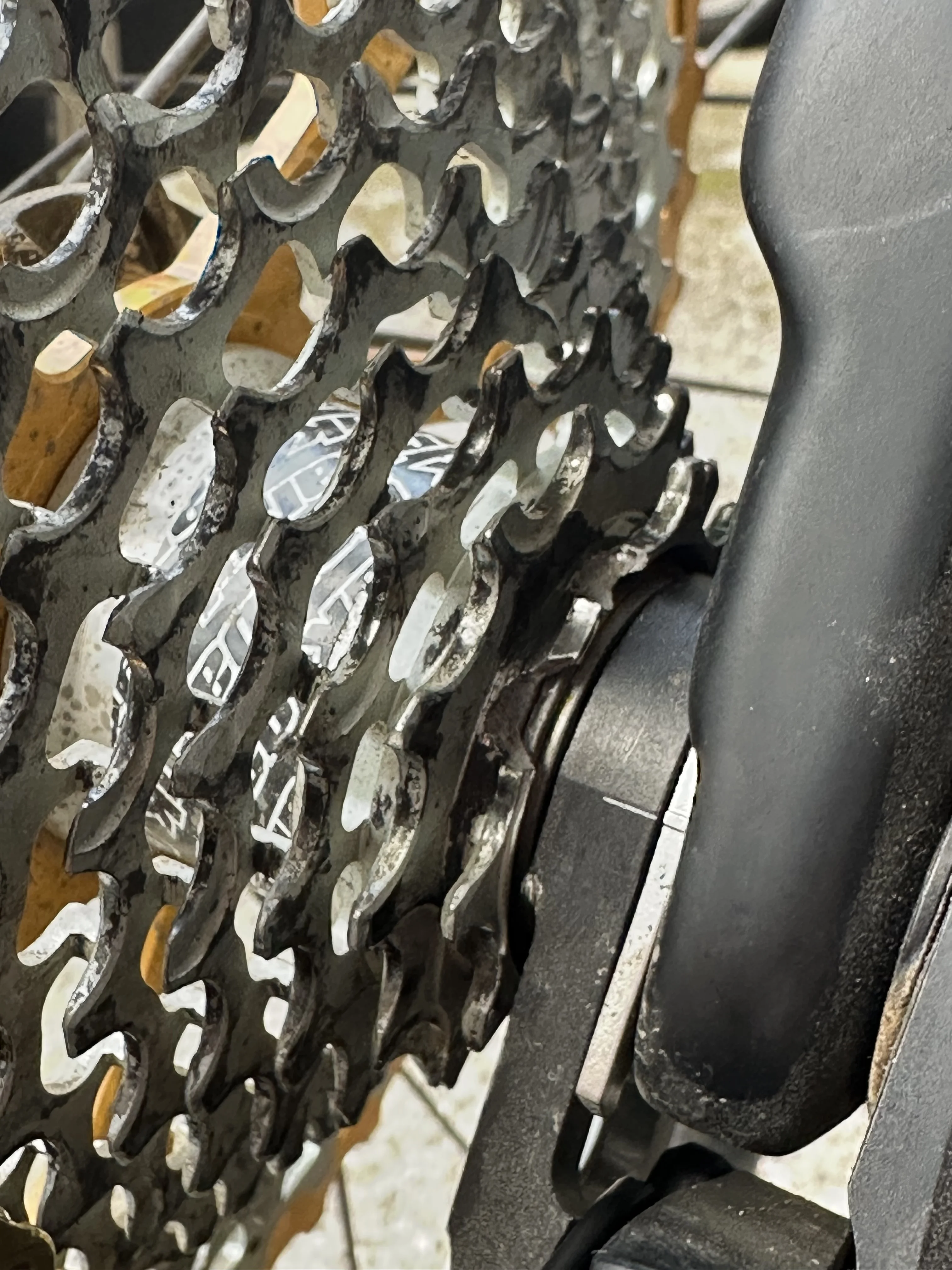

10 rides into garbaruk t-type cassette & m2s be like…View attachment 186771
The smaller the cogs the less distributed the load between the adjacent chain links leaving the cog on the upper side. This is a side effect of mostly riding small front chainrings which forces you to constantly ride the highest gear ratios. Maybe switch to 38T. And yes I am aware this reduces clearance but you have to compensate for a power transmission concept which is outdated by 150NM middle motors and the need to stuff in as many gears as possible and the resulting thin cogs and chains*.
*In this regard: special thanks to SRAM and its 1byX drivetrain invention and stupid X-DOME cassette design which won't allow you to just replace the most used cogs.
it needs a HG hub, but the SRAM XS-1270 cassette allows you to replace gears 8-12.
