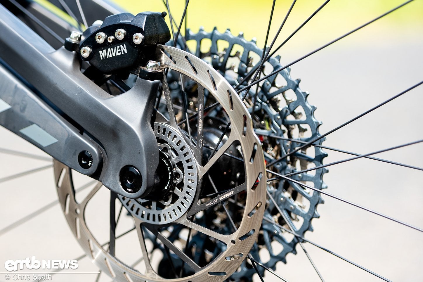

some pages above you wrote that the wheel sensor ring is supposed to work with 6-bolt discs only. Now rotwild came out with their new r.ex ultra and i discovered this:
aHR0cHM6Ly9mc3RhdGljMS5lbXRiLW5ld3MuZGUvdjMvMC83Ni83NjM5MS0xNHd3eGt6ODhnN2YtZm90b19jaHJpc19zcG...jpg
so i assume the sensor ring is compatible with centerlock as one would expect some capable designers to have covered in their layout decision?
As long as the distance between sensor ring and speed sensor is within specification. You can use whatever you can machine to fit. But I think the point Amflow support makes. Is centrelock may not be directly compatible with a 6-bolt configuration, without mechanical modifications.

How does rotwild get away without using this centerlock to 6-bolt adapter?

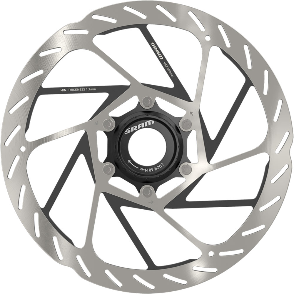

Still not convinced this thing is neccessary and even build into in the picture above especially since the brake disc they use looks to be this one. I think they just slap it between disc and lockring.
Read my reply carefully. I said you need to use 6-bolt rotor with an adapter. You're picturing Centerlock rotor, which is different.

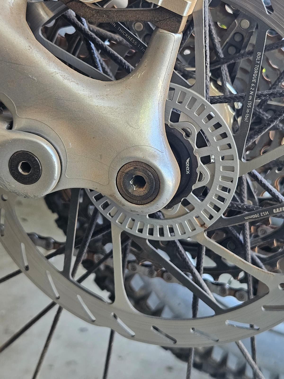

Same setup on my bike:

I would have swore you were right to, but he is correct. on a CL rotor the hub is inset a hair where the ring meets, so you cant tighten the CL nut down.
If you made a spacer or added a washer, double the thickness of the ring, it would work perfect. So it can be done but you will need to make a small spacer to go between the rotor and the ring. Or use a press and make the ring to have a little inset the size of the CL nut. Not going to be hard to make it work.
The centerlock disc picture i linked shows the brake disk rotwild uses in their new r.ex ultra. If you look closely, there arent any bolts coming through the 6-bolt holes of the sensor ring. Thus you CAN use the centerlock -> 6-bolt adapter, you just dont have to.
... you will need to make a small spacer to go between the rotor and the ring.

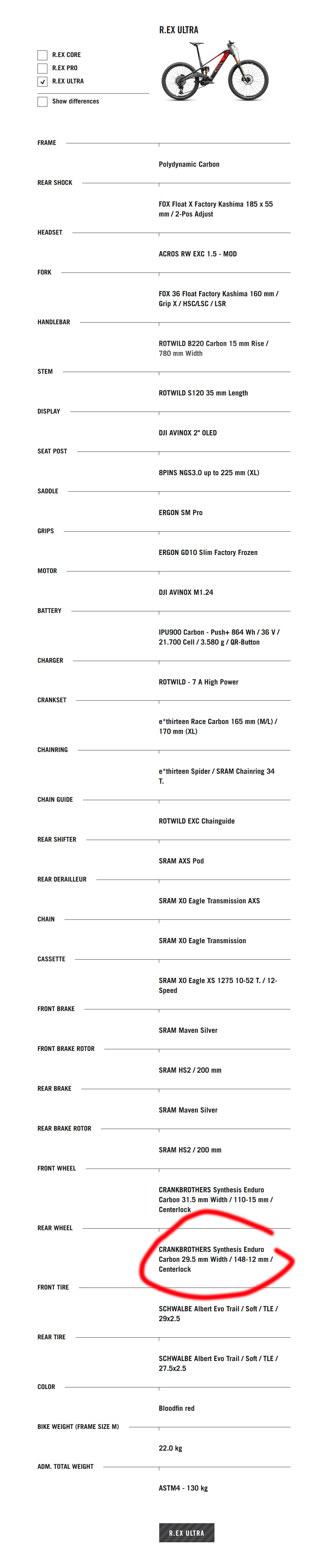

I think they made it work this way. Makes no sense to sell a centerlock hub bike with a 6-bolt adapter in this price category.
You have no idea what you're talking about, and I'm not going to argue with you :)
Take your bike to the shop and let professionals do it for you. You're being a keyboard warrior with zero understanding of how rotors are mounted.

Rotwild appears to use exactly same setup as I've been running on my bike for several months already.
As I'm trying to help the guy all I'm saying is that I'm running Centerlock hubs, with DJI speed sensor, and it works perfect. No need to re-engineer simple stuff, or try to reinvent things that have been invented prior.
The entire setup is super simple, and takes less than a minute for someone who installed even a basic rotor before.
they probably have a washer or shim under it. Its not right without it
HS2 CL 220 rotor I have in my hand, is reset back a little bit, so the ring so there factually is a gap you do not want.
They did not make a CL hub bike. It is a 6 bolt bike. I hate CL Canyon so I run both kinds, and I go through rotors in a few months due to very high amount of miles I ride. And im telling you there is a gap between the hub where the nut is supposed to contact it.
