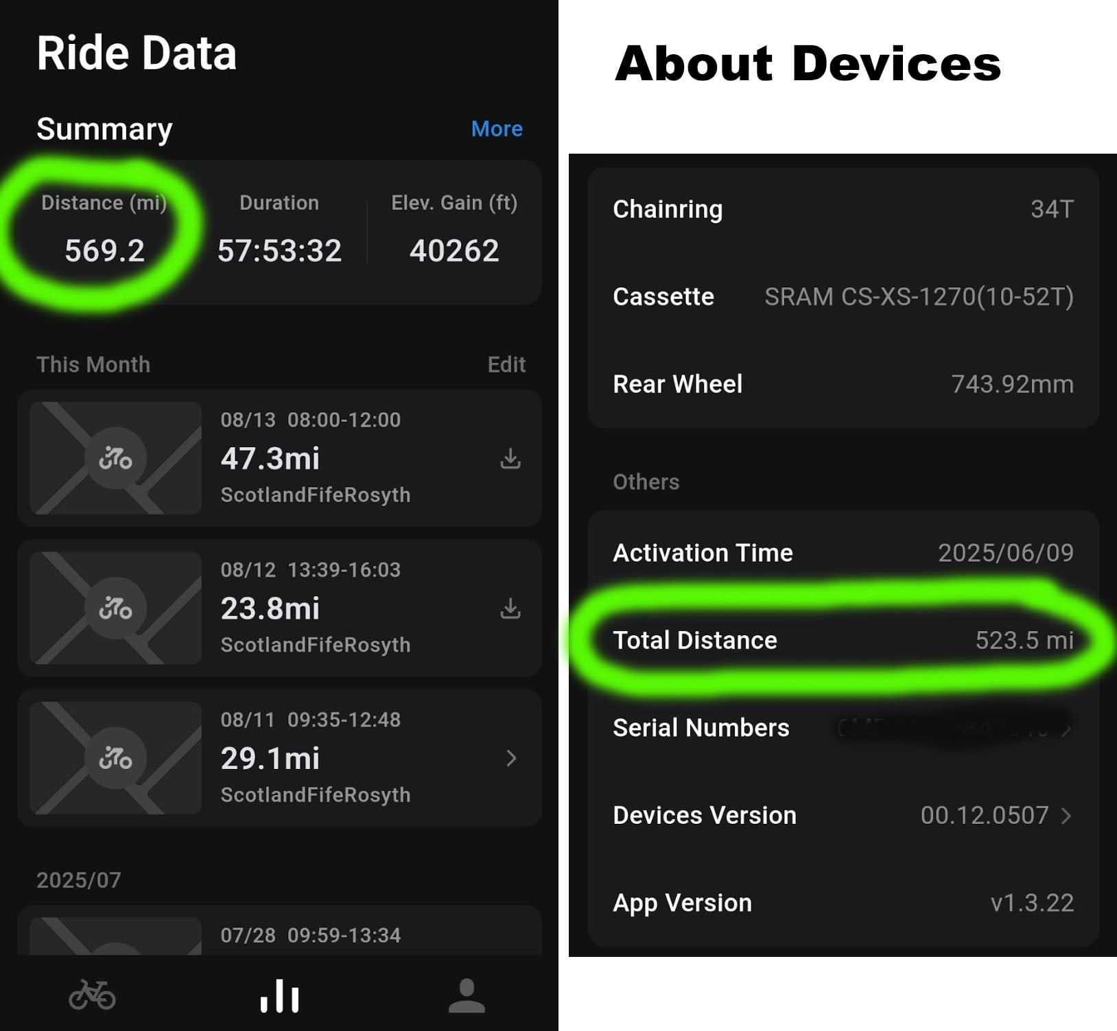

@Amflow Support: Was looking in the Avinox app and was confused by what I was seeing in Ride Data versus About Devices for Total Distance. Why is there a difference? View attachment 166313
Thank you for your inquiry.
Generally, the riding data shown in About Devices will be larger than the numbers in Ride data page.
To better understand your case, could you confirm if you’ve ever paired your account with another bike for riding, or if your current bike has had its motor replaced?

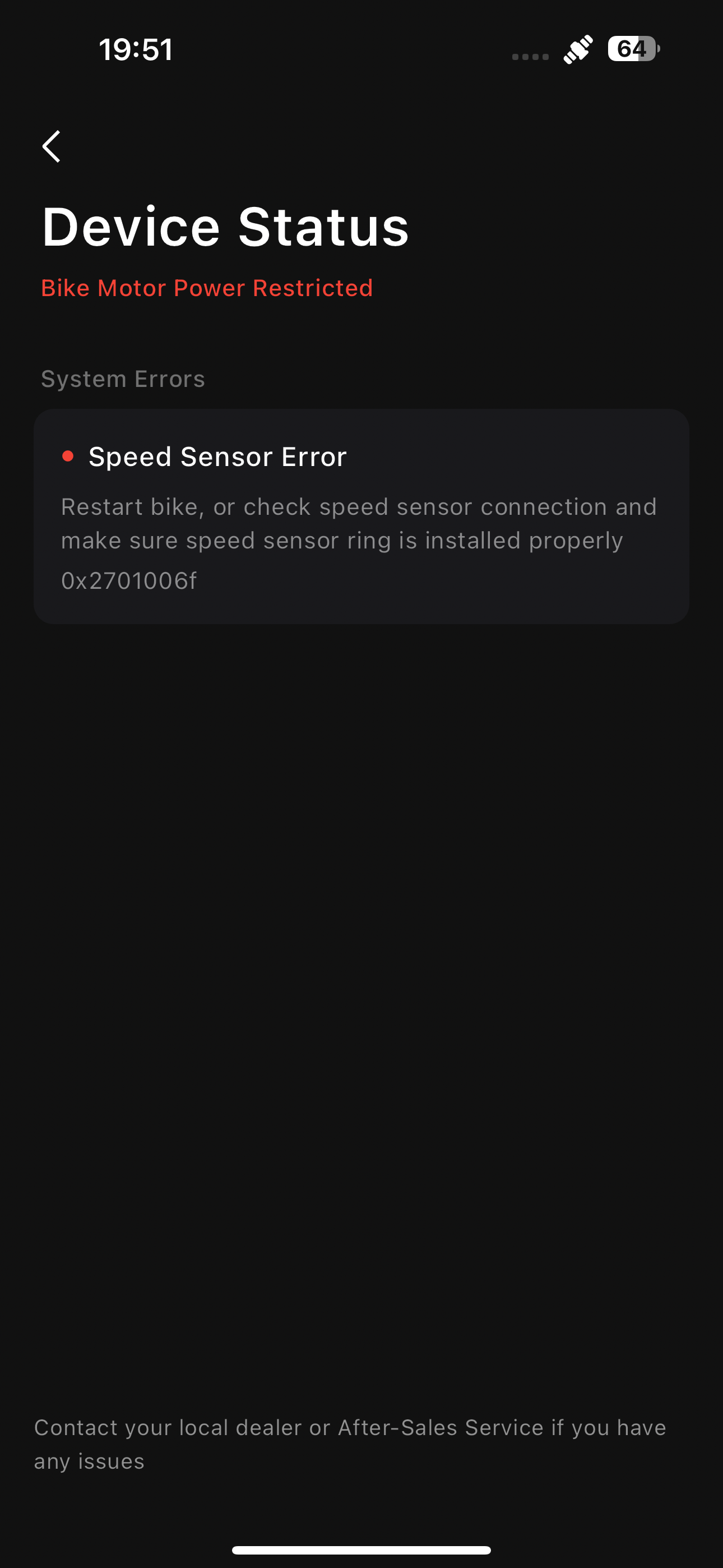

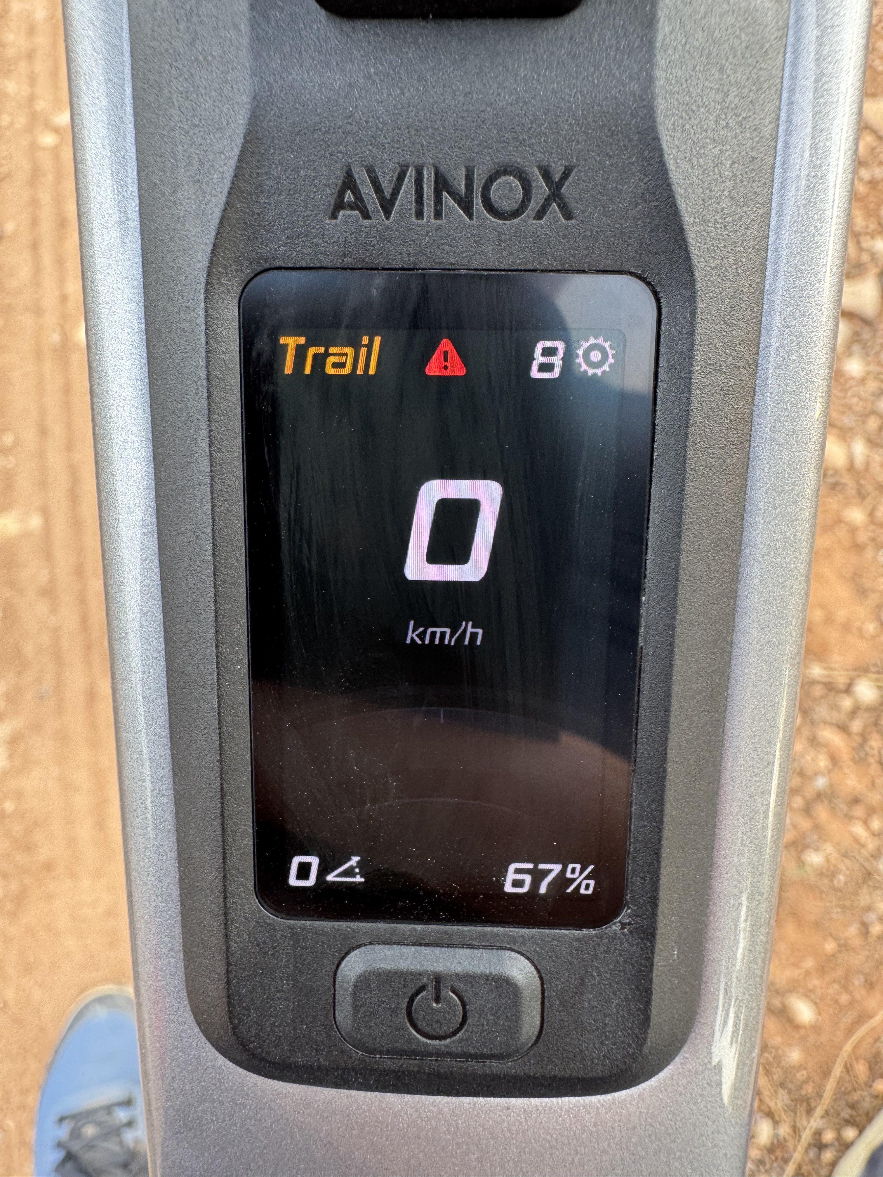

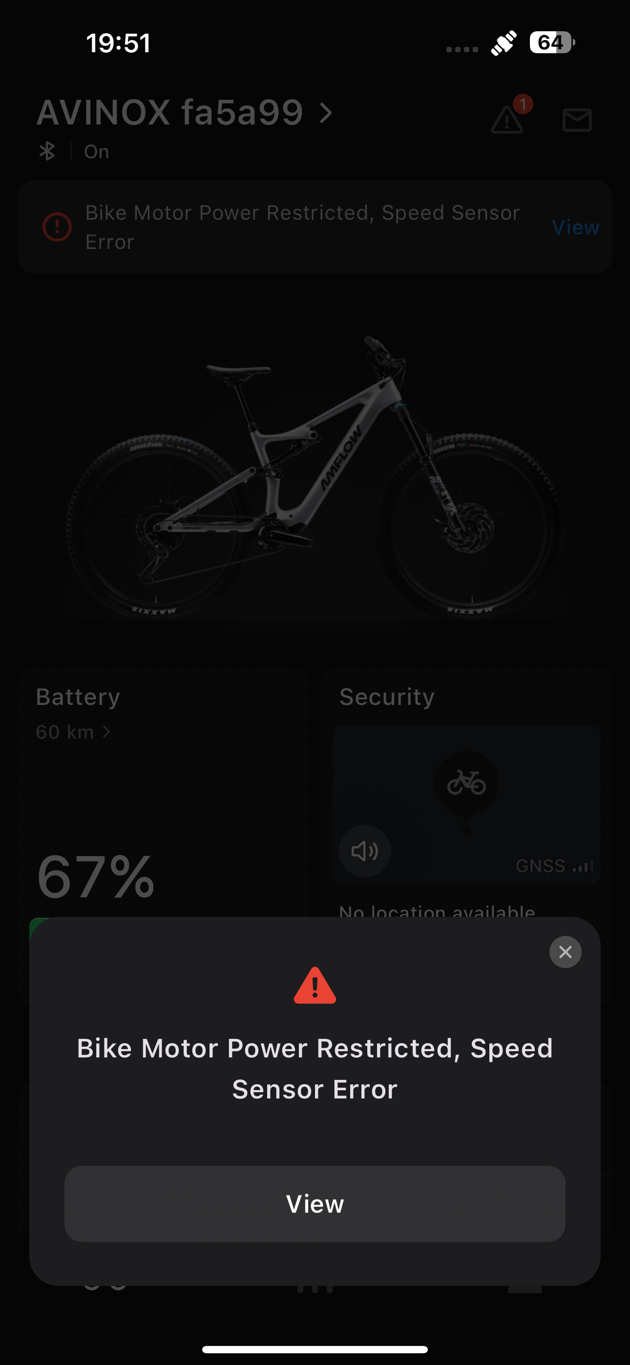

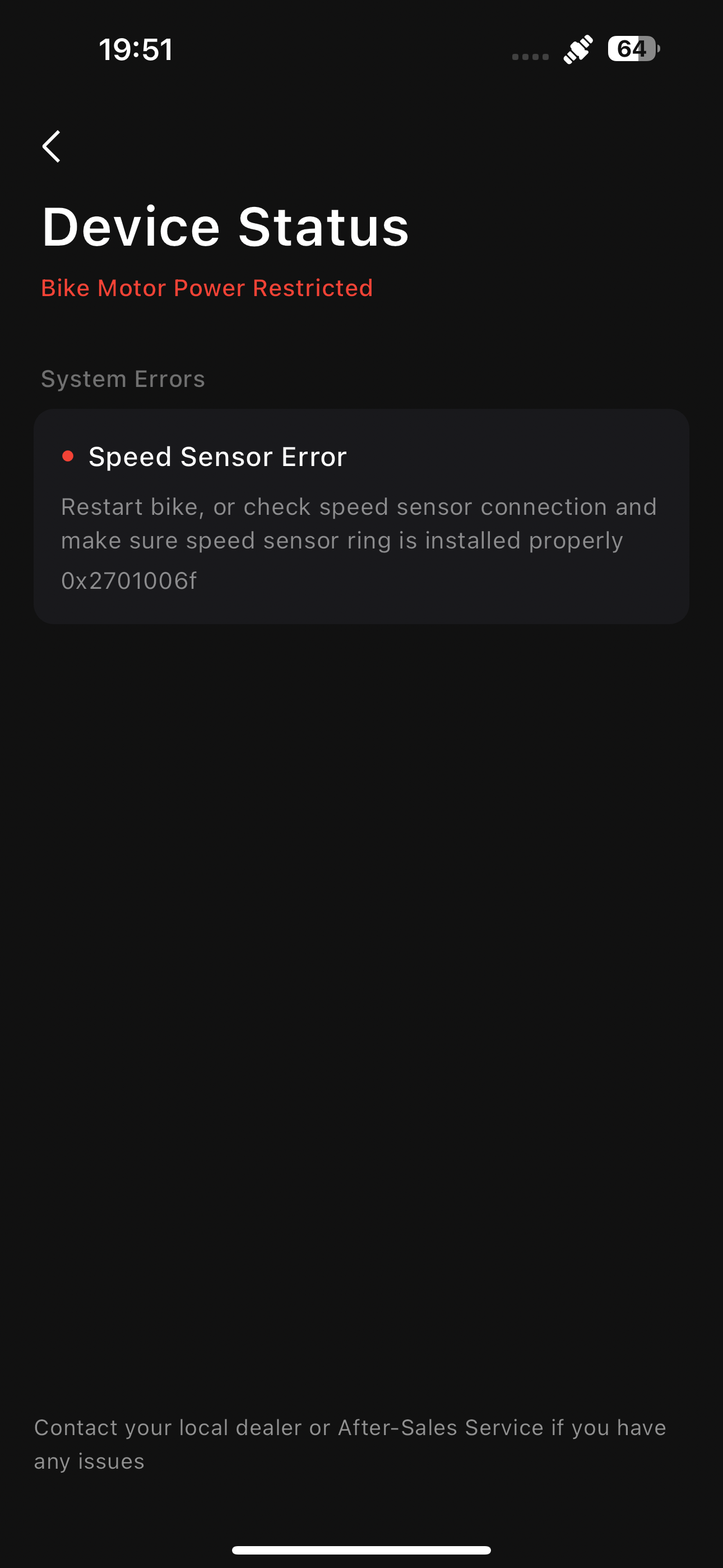

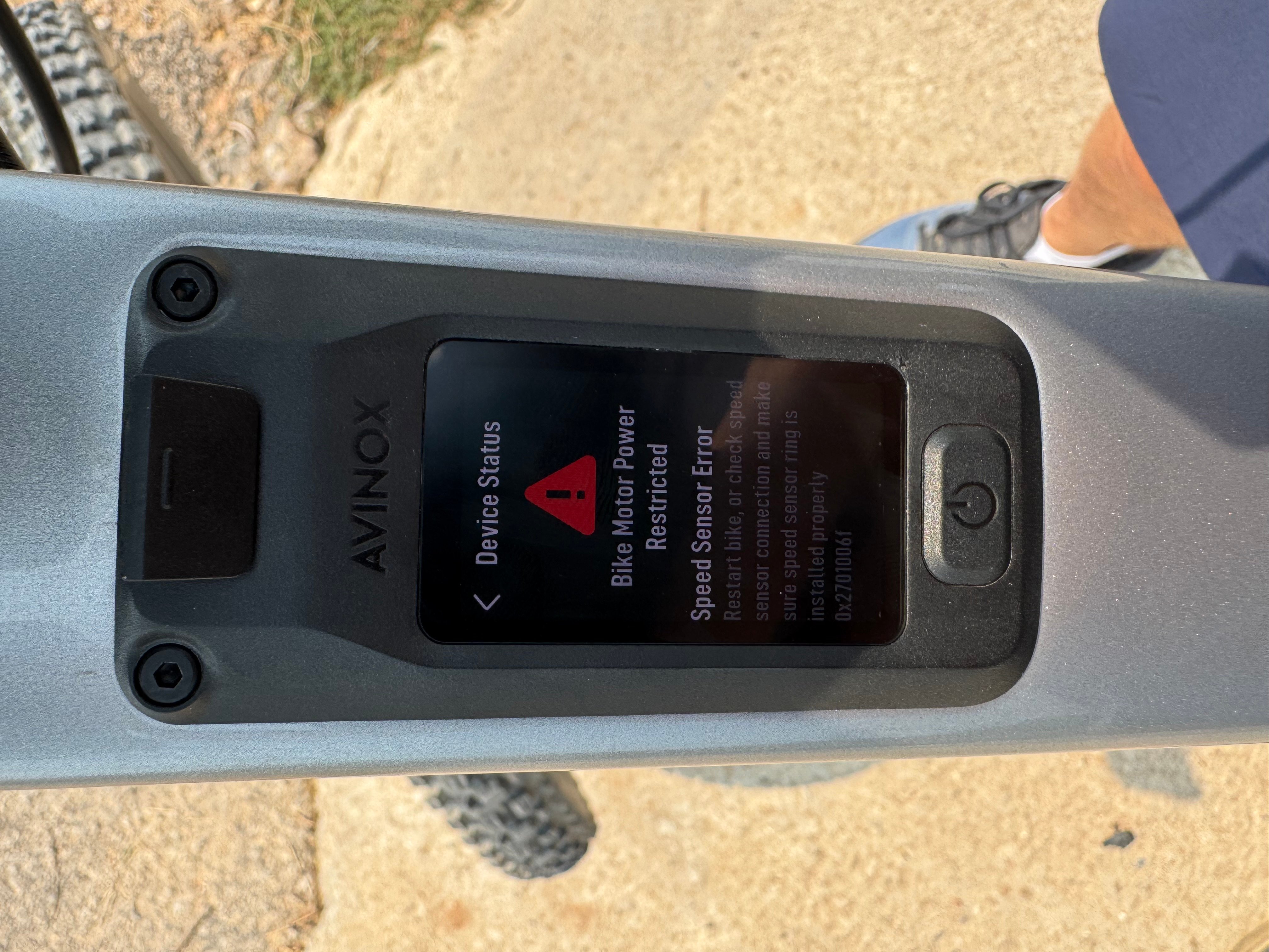

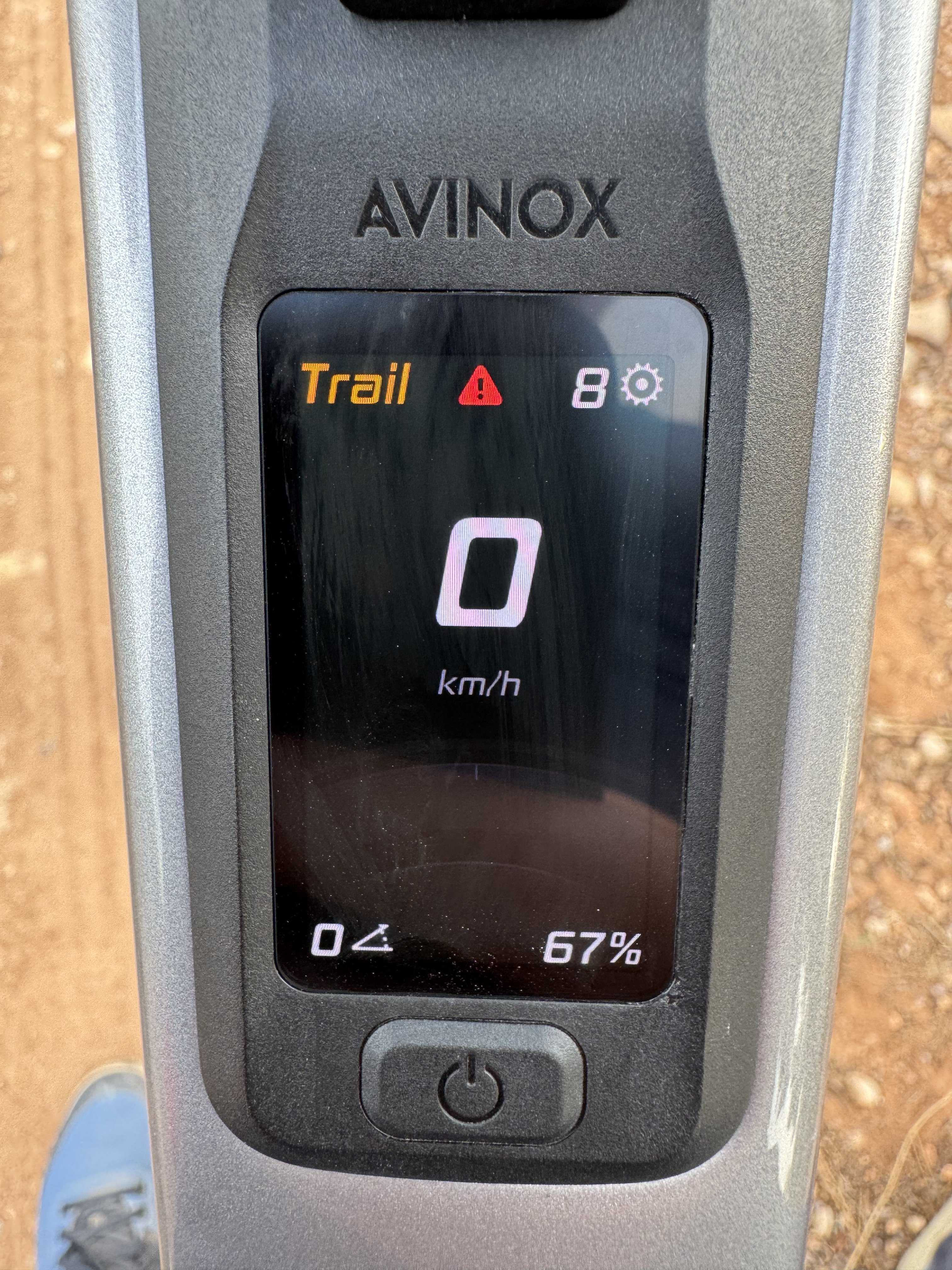

Dear DJI Support Team,
I am writing to report a recurring technical issue with my DJI Amflow PL Carbon e-bike, which I purchased on 21.07.2025.
The bike has been performing perfectly until yesterday. After riding for approximately 20 kilometers, I experienced a sudden and significant drop in motor power.
The following error messages appeared on the bike's display and in the mobile application:
  • On the bike's display: "Bike power motor restricted"
  • In the DJI app: "speed sensor error"
Additionally, the speed reading on the display started showing random, fluctuating numbers.
I have attempted to restart the bike, and while this temporarily resolves the issue, the problem returns shortly after I resume riding.
As part of my own troubleshooting, I have checked the physical components:
  • I have inspected the speed sensor and the magnet on the rear wheel spoke.
  • The sensor and magnet appear to be correctly aligned and at the proper distance.
  • I have also visually checked the cable for any signs of damage.
This appears to be a consistent technical fault with the bike's speed sensor or motor control system. As the bicycle is under warranty, I would appreciate your guidance on the next steps for a proper diagnosis and repair.
View attachment 166546 View attachment 166547 View attachment 166548 View attachment 166549
Sorry to hear about this issue.
To help narrow down the cause, please check the following:
  1. Confirm if the rear hub axle is loose — the standard torque level is 10 N·m.
  2. Verify whether the brake disc has been replaced.
  3. Confirm if the bike has been washed.
Additionally, please advise where the bike was purchased.
If it was from a dealer, a cross‑test at the dealer is recommended.

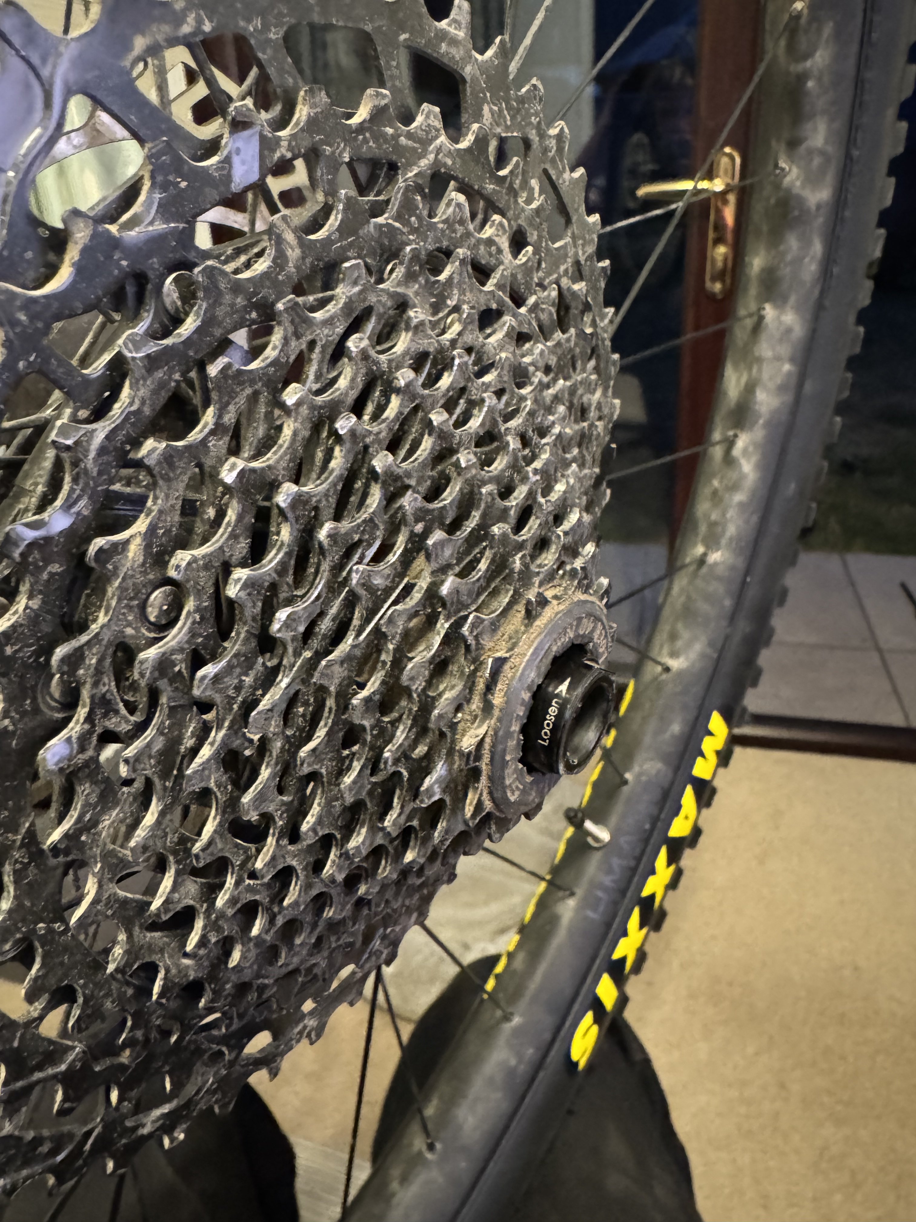

I'm flummoxed on this one.
I've just replaced my rear tyre, upon reinstalling the rear wheel, I cannot get the rear wheel to tighten without this cone loosening. This is because as you tighten, the hub axle spins one side, but this cone grips the dropout and stays stationary - thus loosening itself.
When the cone loosens, not only is there play in the wheel but the derailleur will shift the chain off the cassette. This is because the cone is widening the rear end of the bike.
What's odd is I've fixed a flat tyre a few times before and the rear wheel went in fine, I can't understand what's changed.
What do I need to do here to keep the cone tight whilst tightening the axle?
The black part is supposed to spin freely
The cassette lockring should not be loosening
did you replace the cassette or mess with it?
On the brake rotor side, there is normally a a flat on the cone to place a spanner, then you can tighten the end cap on that side, and lock that side in position. Then once that side is locked, you can tighten the drive side end cap, and nothing should come loose as you re-install the axle.

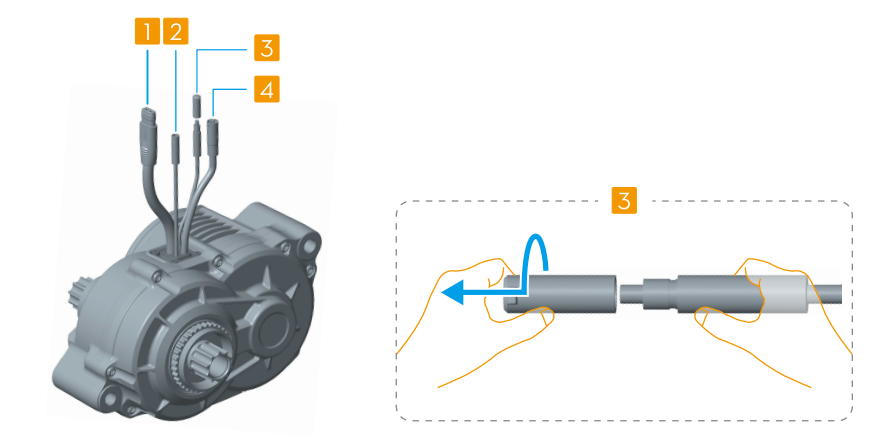

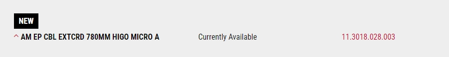

Hi! The cable we use for AXS derailleur is a SRAM power cable, internal part number: 11.3018.028.003. But we don't have a specific guidance for connecting to a di2 cable type. The cable is connected directly to the 3rd expansion port on the motor. View attachment 166194
Thanks for the quick response. I am almost complete with my Crestline build but am really stuck trying to power my Shimano wireless derailleur to the expansion port (Higo Micro A type). Do you think as Dji or Amflow that you could request Higo connectors to make a connector that Shimano Di2 system?
Amazing, thank you - I got it after some googling - I need to pull off the brake side end cap so I can get a hex in the axle to tighten the drive side.
Thanks!
