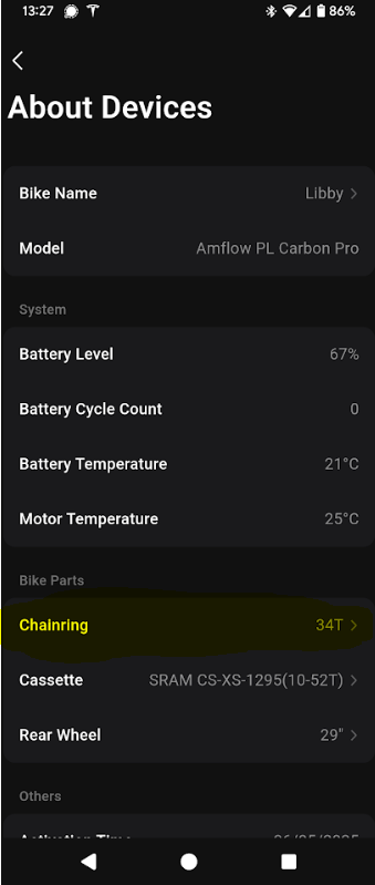

Our official transmission configuration consists of a 34T chainring, 120 links, positioned at location A. Should you opt to upgrade to a 36T chainring(while the rest of the transmission kit unchanged), it is recommended to add 2 chain links to compensate. Regarding modifications suggested by the Sram App, our team is currently engaged in discussions with Sram to explore possibilities.

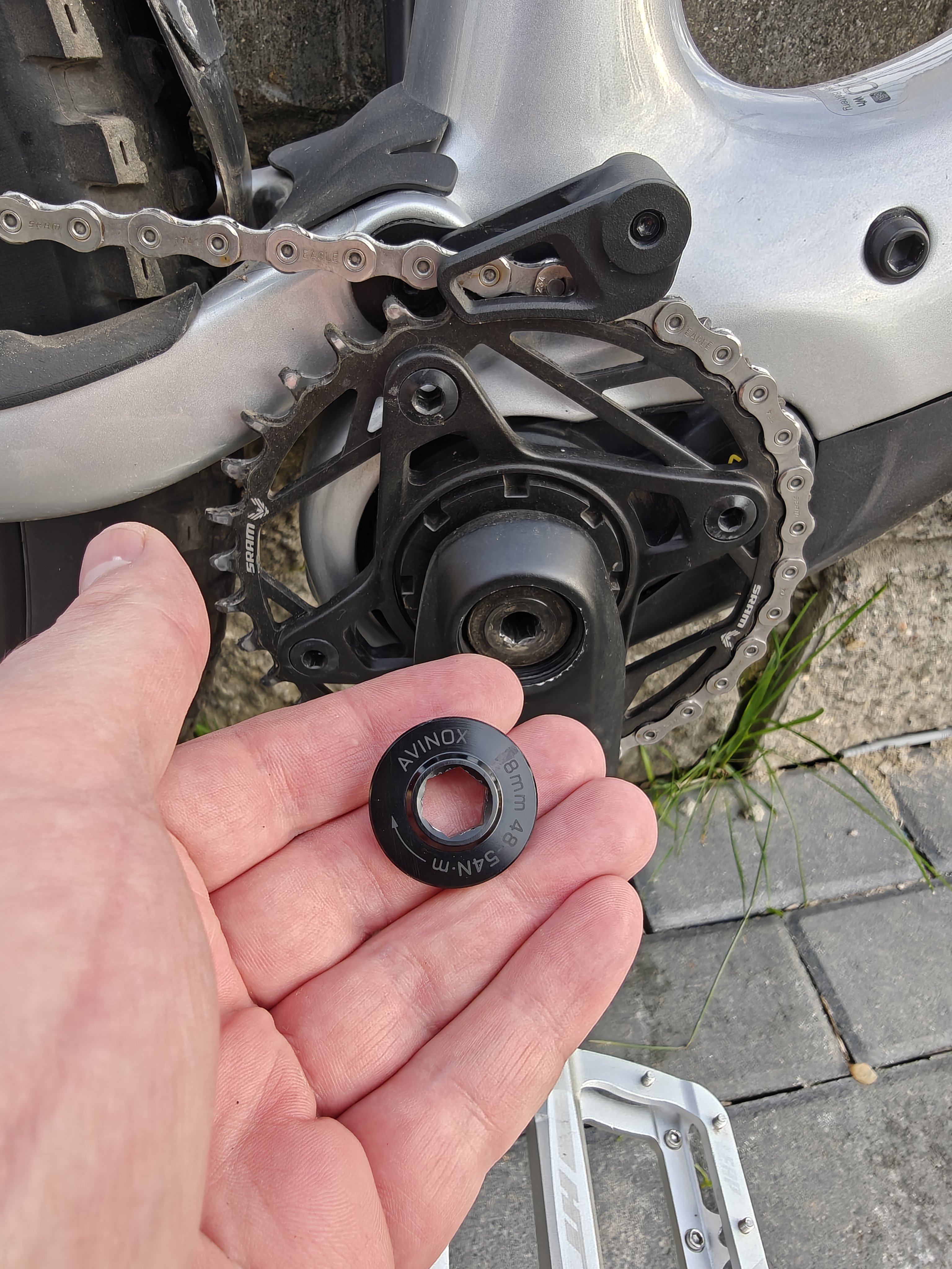

Today while driving on the pavement I heard my cover fall off and roll away..... If it had been dirt, I wouldn't have heard it and would have been without it!
We are so sorry to hear about this issue! For the crankset bolt cap, please get in touch with the store where you bought it or email us at [email protected]. We’re here to help you resolve this!

3. if I put a 36 tooth front chain ring, do I need to update something in the app or on the bike?

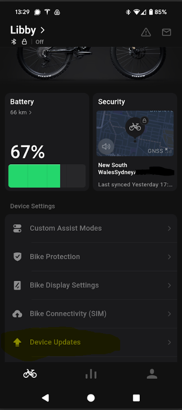

2. I'm so afraid of updating firmware and having the bike either connected or not to do the updates. Is there a place I can go to that explain in better detail the steps in order of how to do the updates?
Just select Device Updates on the App Home Page whilst Bluetooth connected to the bike. It will tell you if you need an update. Just select the upadte and keep the phone in Bluetooth range.
