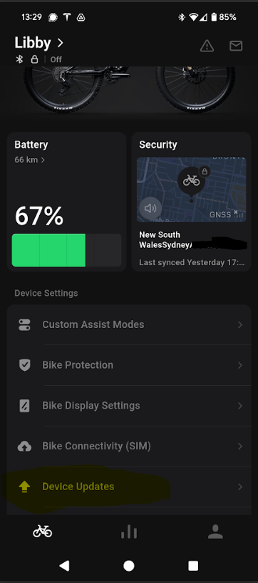

got my Amflow and I'm a bit electronically challenged when it comes to updating and sim card and such and have a couple of questions:
1. Is there a place I can go to that will explain in better detail which sim card to get and how it is activated and do I need a separate phone plan to get it to work.
2. I'm so afraid of updating firmware and having the bike either connected or not to do the updates. Is there a place I can go to that explain in better detail the steps in order of how to do the updates?

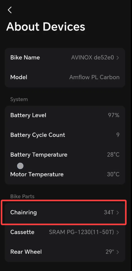

3. if I put a 36 tooth front chain ring, do I need to update something in the app or on the bike?

2. About the firmware update for your bike, you can easily complete the process via Bluetooth connection. Check out the "Avinox App" video at this link: Amflow PL - Product Videos - Amflow (United Kingdom) for some guidance.
3. When changing the chainring from 34T to 36T, remember to update the settings in the Avinox app per the attached image to get the best performance from your drive system.

I have 36/120 and B like the app says and it works god=)

On the Carbon Pro - with the X01 casette - is the 21T cog (gear 7) the right one to use as setup of the casette ?
This is from the SRAM calculator (SRAM | AXS) - but it might be wrong.
Sorry for the late reply.
You can select the corresponding cassette for your setup in the "Cassette" section under "About Devices" in the Avinox App. All the options listed are suitable for use.
