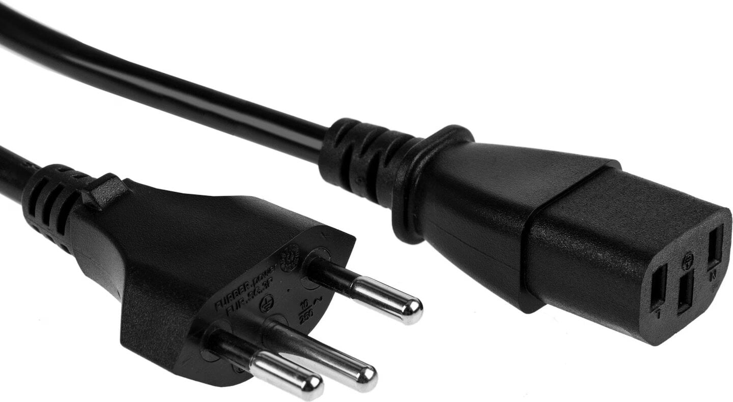

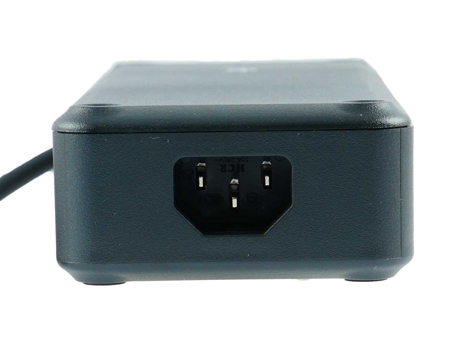

Amflow_Support Hello, it looks like the plug on the charger is an official pc plug? So can I replace the german cable with a swiss pc cable Like picture?
Look at the cable cross-section engraved on the sheath, and choose the equivalent or a larger cross-section, which will fit perfectly. 🍻
Hi there, thank you for your inquiry.
This is indeed an AC plug. We officially provide the Swiss AC cable mentioned in your picture, which is the European version of the AC cable.
We recommend using the official cable to ensure optimal performance and safety. If you need one, please feel free to contact us for purchasing options.
