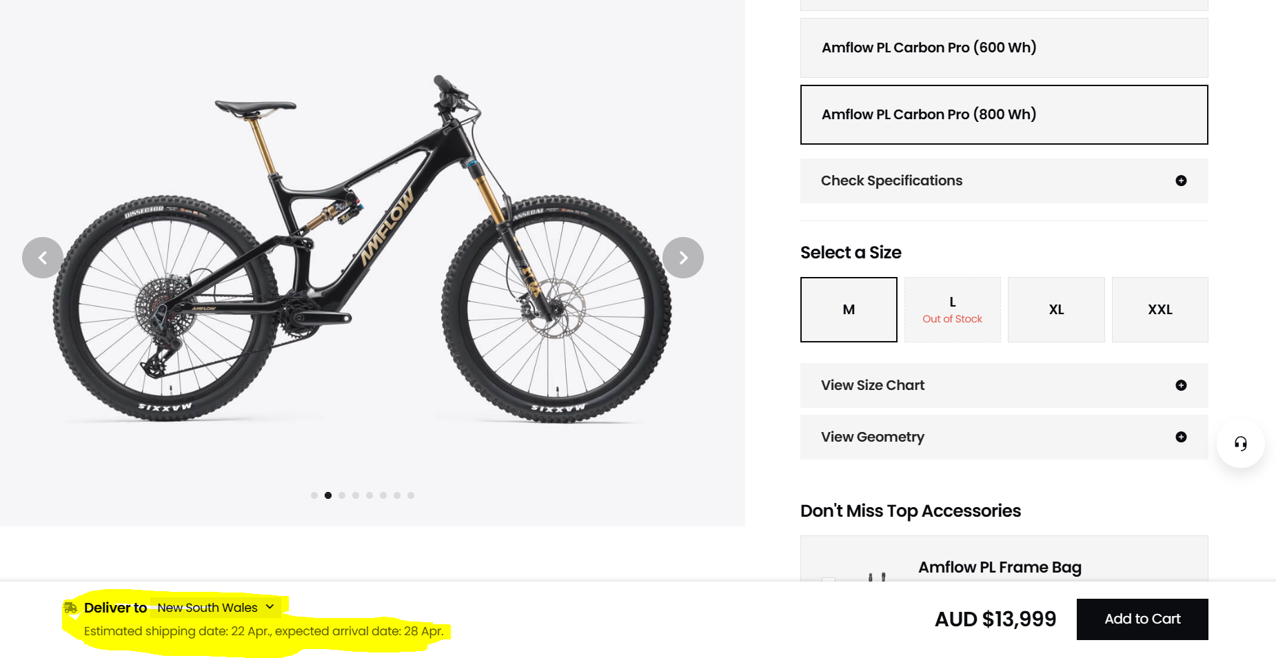

Amflow Customer Support have got back to me and told me that the bike will not be delivered until early May. How is that possible, when I ordered the bike 6 weeks ago, and if I order one today from your website, the site says it will be delivered on the 28th of April ?
I am extremely disappointed with your ordering process, when I was told it should be 6-8 weeks delivery.
It gives me very little confidence if there are issues in the future, when this is the service delivered, once you took my deposit.
Below is the order form from your website right now, showing an April 28th delivery.
Hi Customer,
Since the release of Amflow PL, it has gained considerable popularity among users. Amflow is very popular in AU market. Presently, Some models are out of stock, but we are actively working to replenish our inventory.
If you place the order from our official website today, you can expect to receive the bike on the 28th of April.
And for your current order, we recommend you can keep in touch with your dealer, thank you for your understanding.

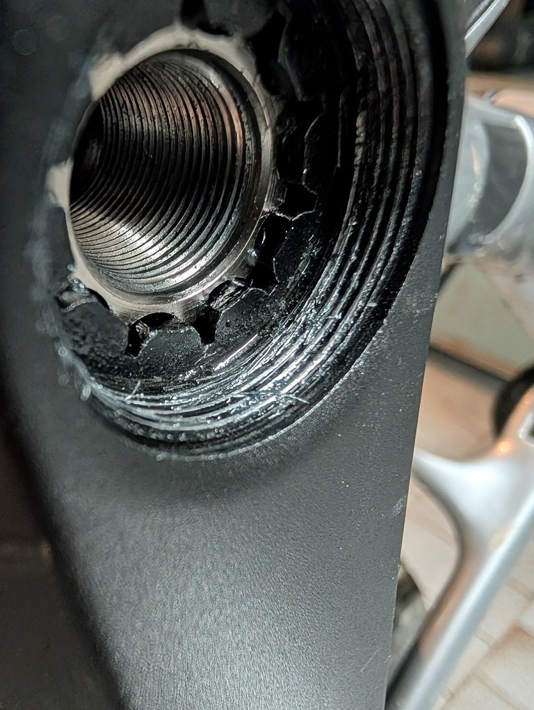

Thanks for replying to my post.
Can´t see how tightening the cranks could solve this problem, but cranks are tight on the shaft. In fact they were so tight, while trying to remove the non chainring side crank, the the threads stripped as shown in attached pictures. while trying to use the bolts from the crankside to get i off it stripped the threads too. A standard crank removal tool doesn´t fit the original Amflow cranks. Left crank is still on. this is getting funny now...:rolleyes:

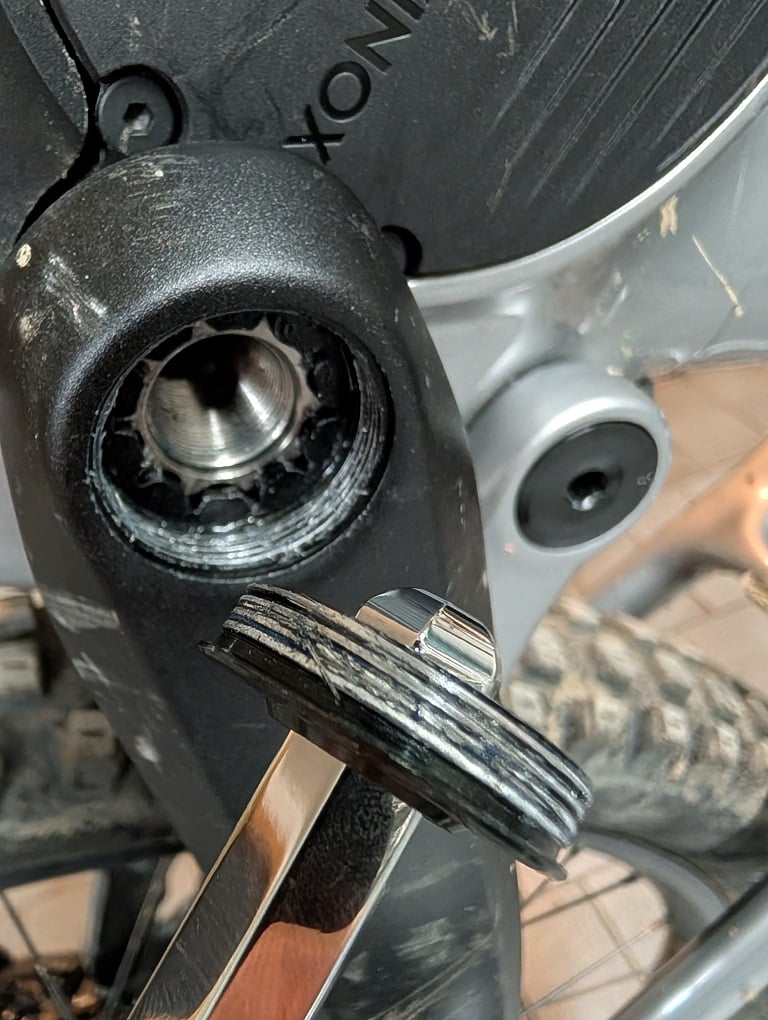

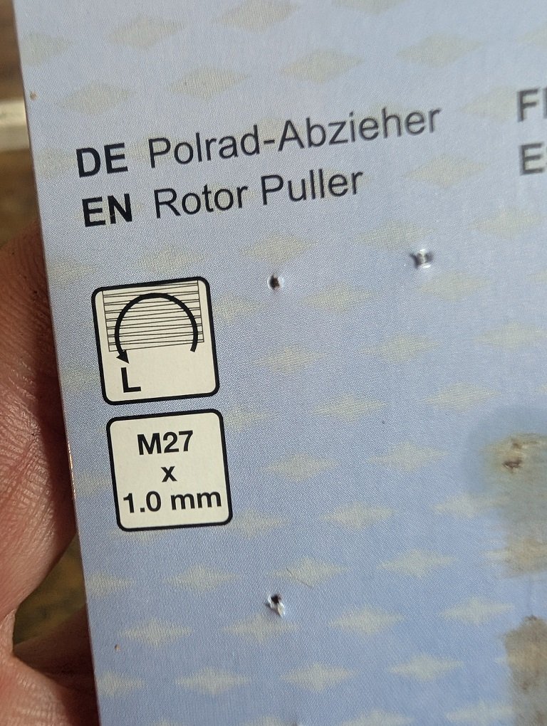

View attachment 156861 View attachment 156862

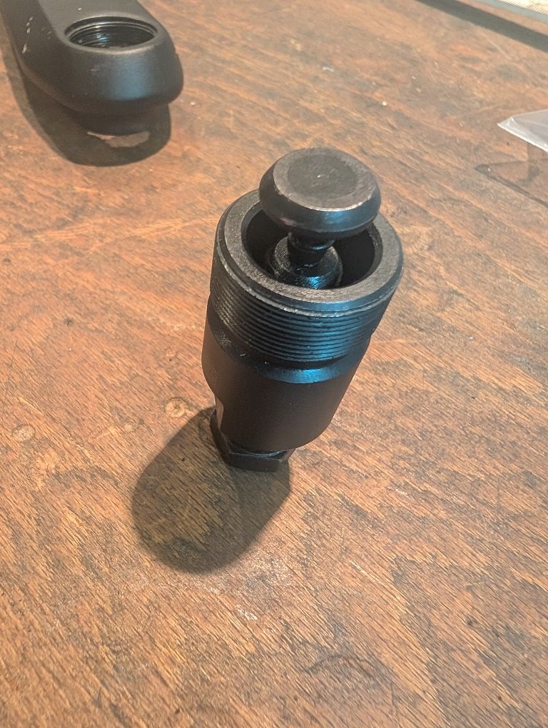

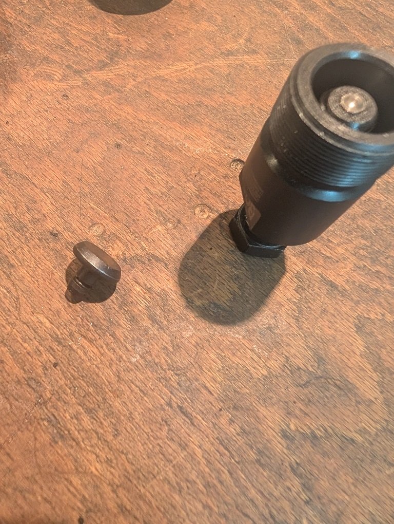

Crank is off. In Case someone else is running into this Problem. You need a Rotor Puller M27x1.0mm left-hand thread. The driver is not long enough to push on the Motorshaft, so you have to modify it like shown in the pics.

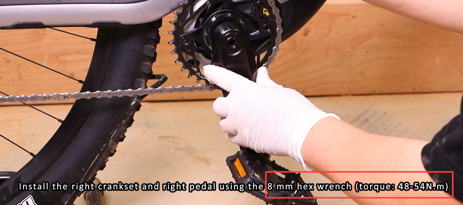

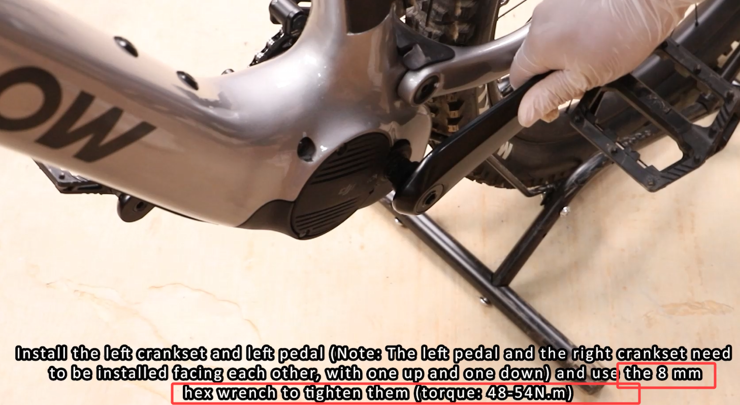

Thank you for bringing this to our attention and sharing the details with us. The cranks on our bikes use a self-extracting bolt system, which allows for both removal and installation using only an 8mm hex wrench. There is no need to remove the bolt separately from the crank. This should ensure a smoother process overall. We’d like to apologize for any confusion and inconvenience caused. Should you have any further questions or need additional guidance, please don't hesitate to reach out.
thanks for your reply. i think anyone knows how to remove cranks with a self extracting system. its straight forward. ....in my case the threads of the Mx27 Bolt stripped right off. compared to other self extracting systems its a bit flimsy.
Understood~About the crankset bolt issue you brought up, you can send over the details and photos to [email protected]. And our after-sales team will look into it remotely and see what we can do to help. Thank you for your cooperation!
