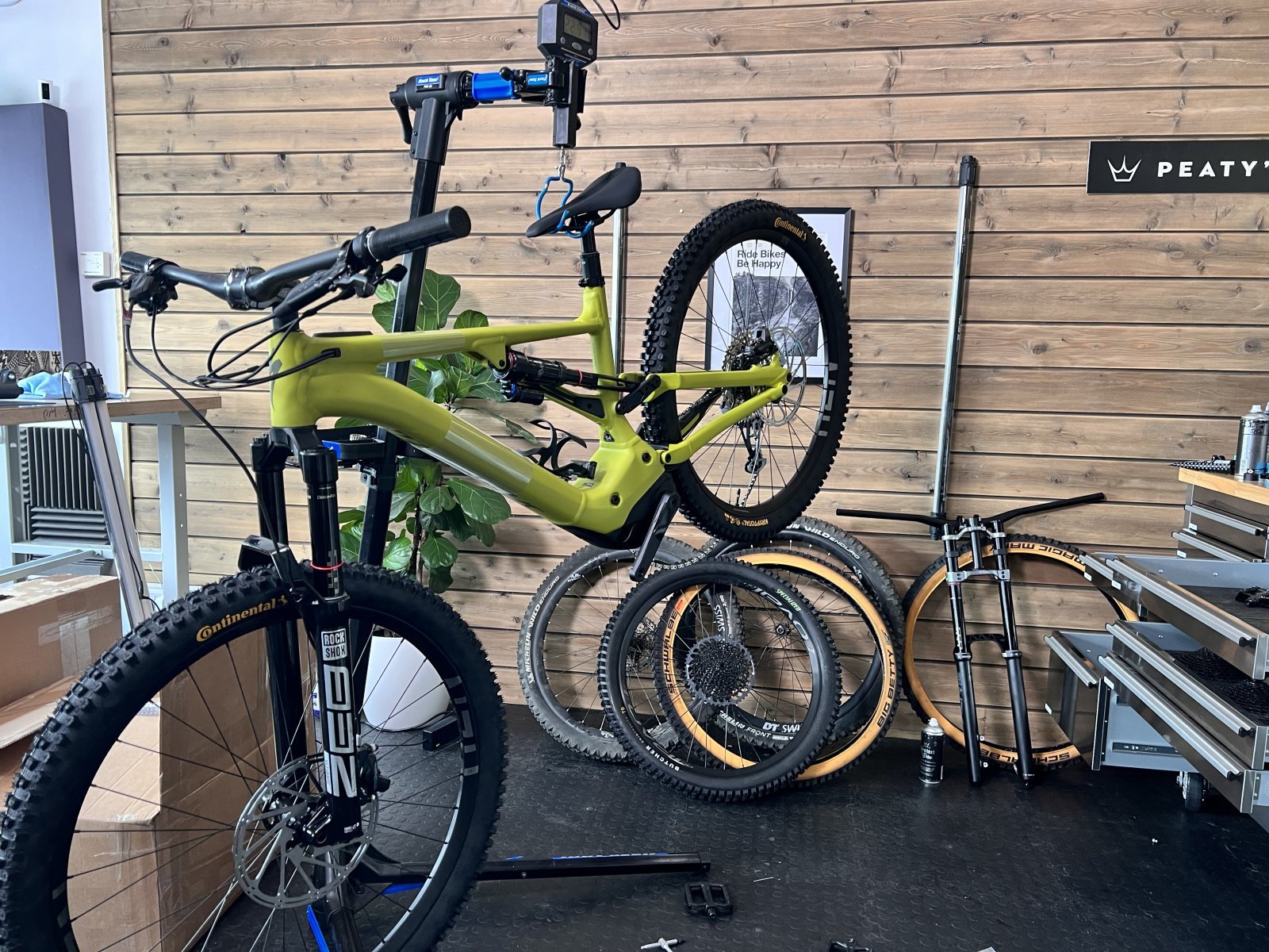

A Levo with a Cascade Components long shock kit and a 180mm fork?

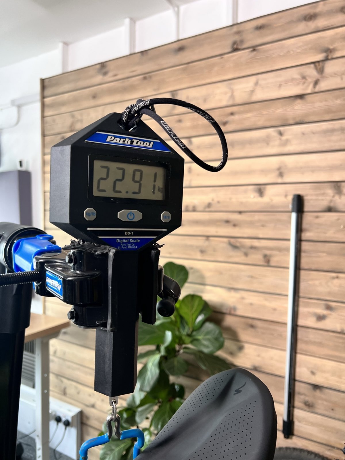

29er Kenevo and 22.91KG. Alloy wheels.
Easily possible for a 22KG Kenevo with carbon frame.

Even the alloy at that weight is quite tempting, but I don't think I can buy this as a frame only?
I see now 👍 my soon to be 29/29 medium shouldn’t be more then !

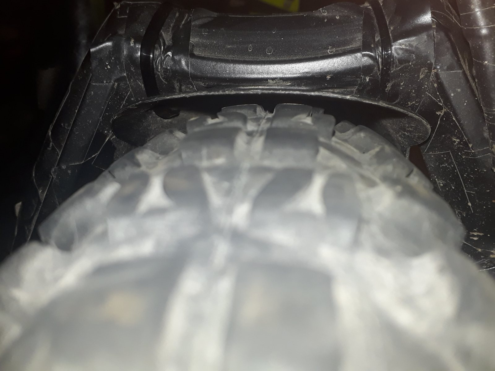

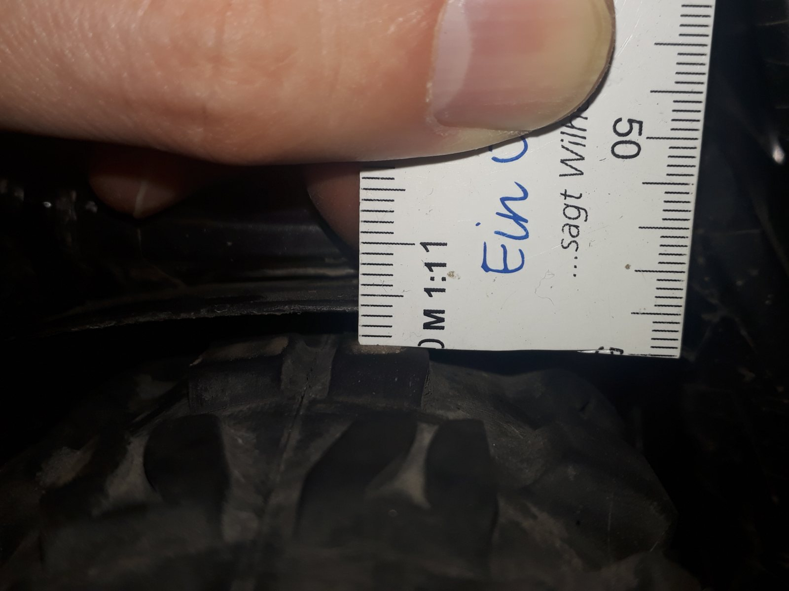

So I ordered a 29" front wheel and a used tire just to check the clearance on the default Marzocchi Z1 Bomber fork.
And... it's not much, I wouldn't want to ride like that.
The rim is a SunRingle Duroc 40 with 36mm inner width, the tire a used 29x2.5" Maxxis DHF with around 70% of the tread pattern left according to the seller. Tire pressure is just 1 Bar (~14.5 psi), a higher pressure would likely result in even less available space. Also, a narrower rim would likely cause the shape of the tire to be higher instead of wider.
Tire clearance seems to be around 3mm to the Marsh Guard and maybe 5-6mm to the fork.
That’s a bit tight , it’s not just there though . If you let the air out and full compress the fork you might find the crown will hit the tyre .

They are the only difference , the axle is lower on the 29” lowers so the crown hitting the tyre isn’t an issue !
Let's hope you won't have any mud or pebble stones that stick to your tires. 🫣
