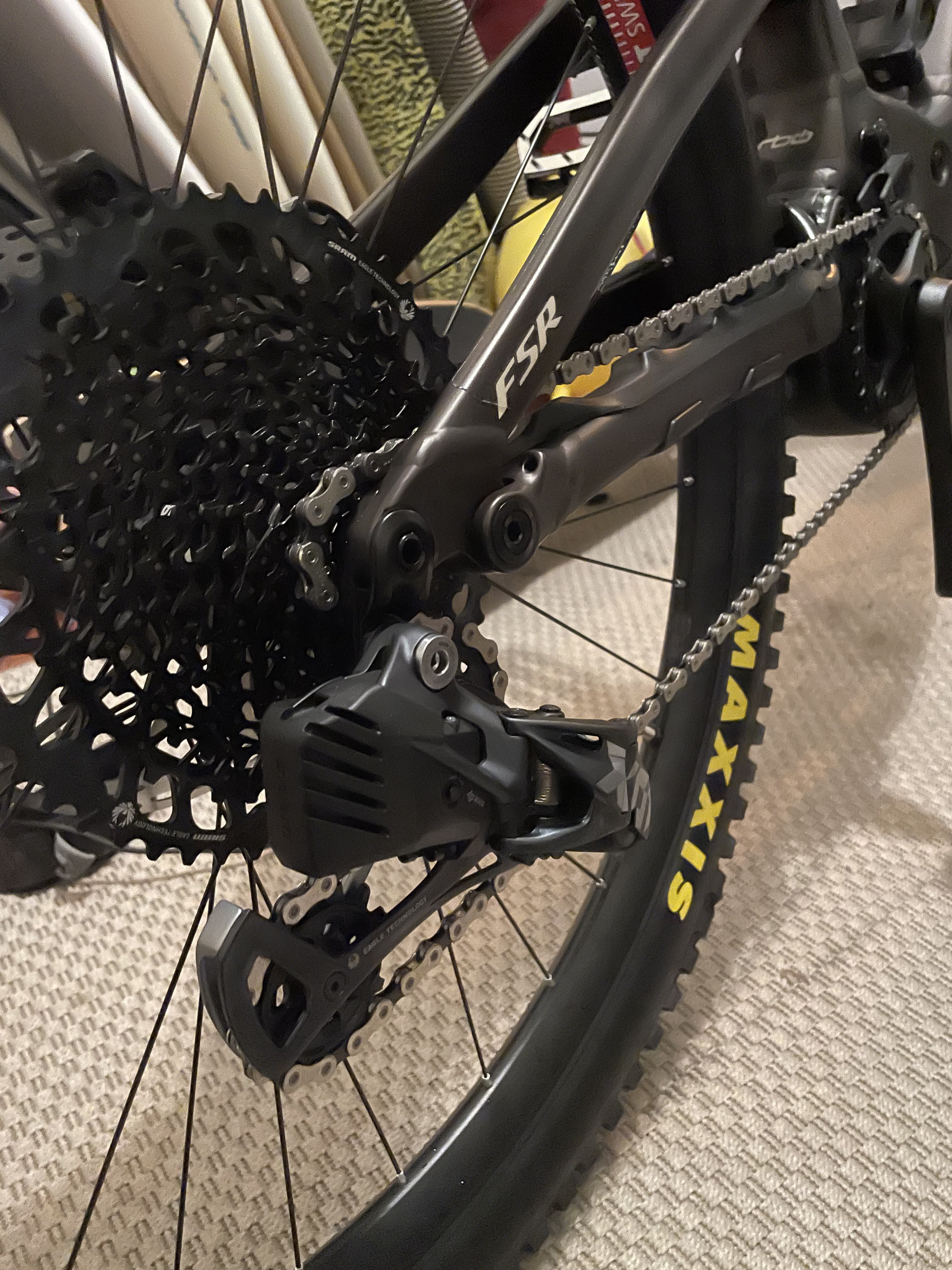

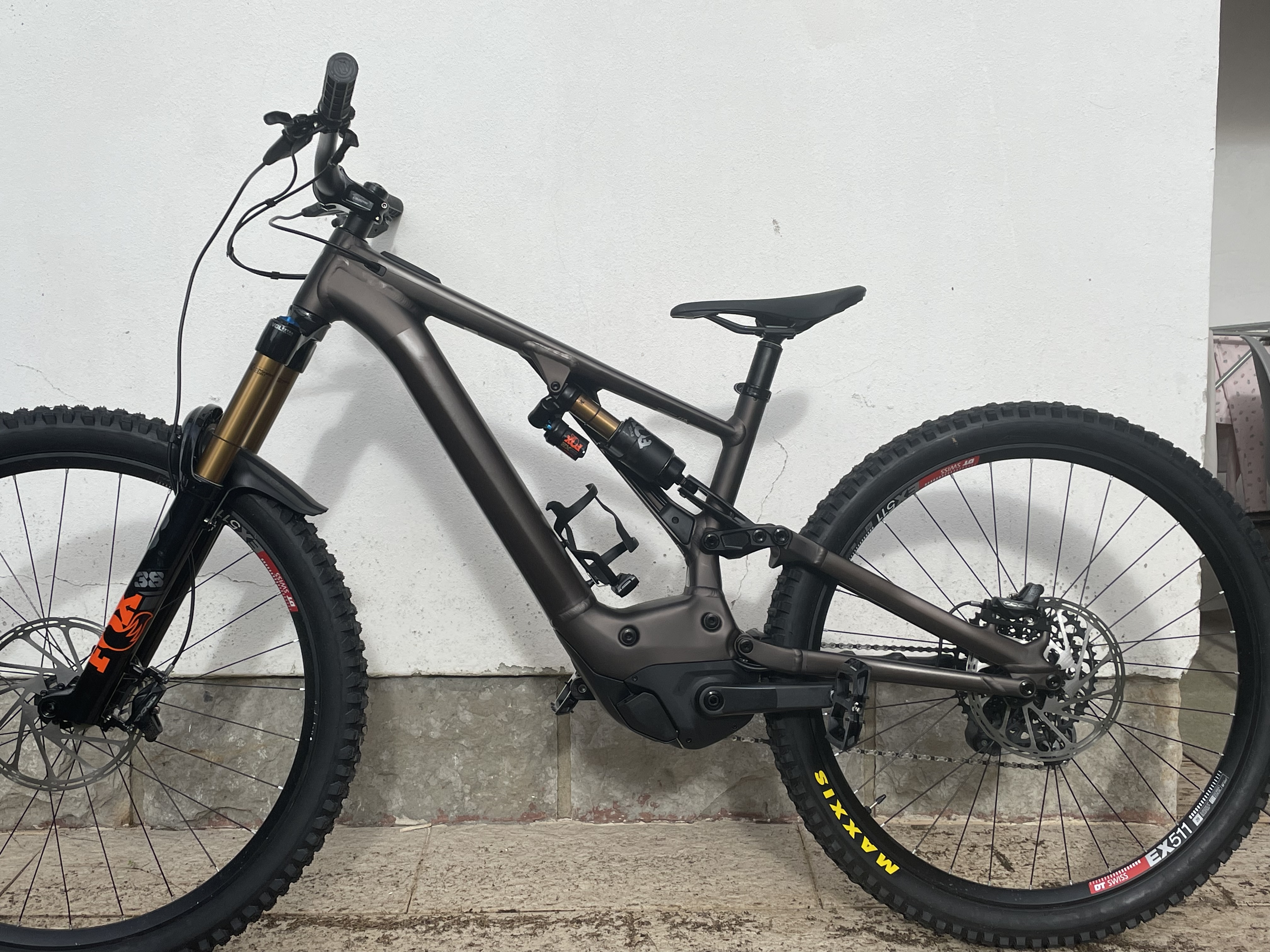

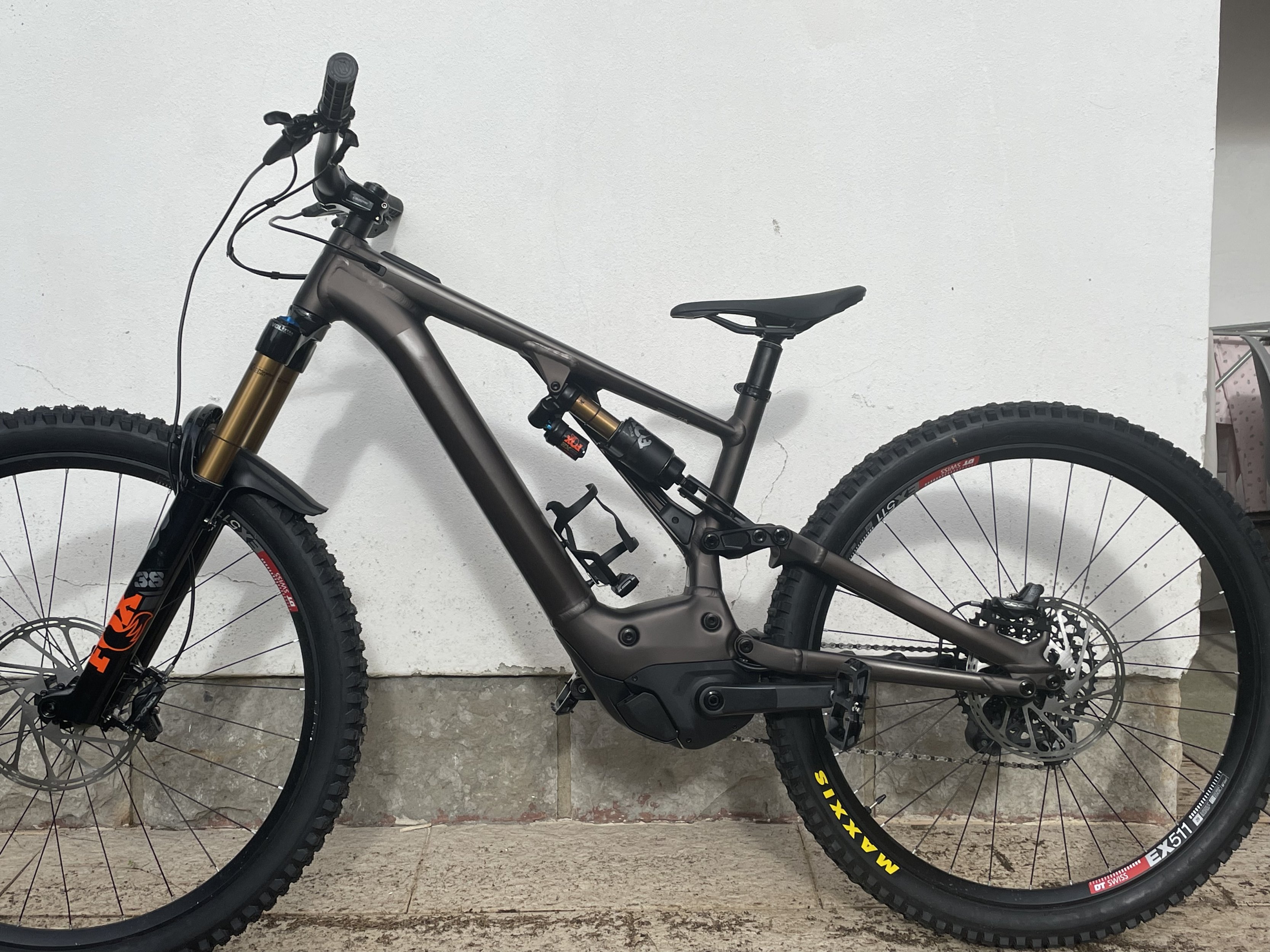

Just finished the build and tried it today. It has been raining a lot this past weeks in Portugal, and the trails are muddy and tricky. Couldn’t have a better bike for those conditions, really happy with it. Two things that still couldn’t make a proper opinion of - went for the air shock, and I’ve been riding coil for the last 3 years, which felt a bit strange, and went for same 50mm stem as the original. Also felt strange. Probably try a little shorter
Thanks again for all the inputs.
Joao Jervell

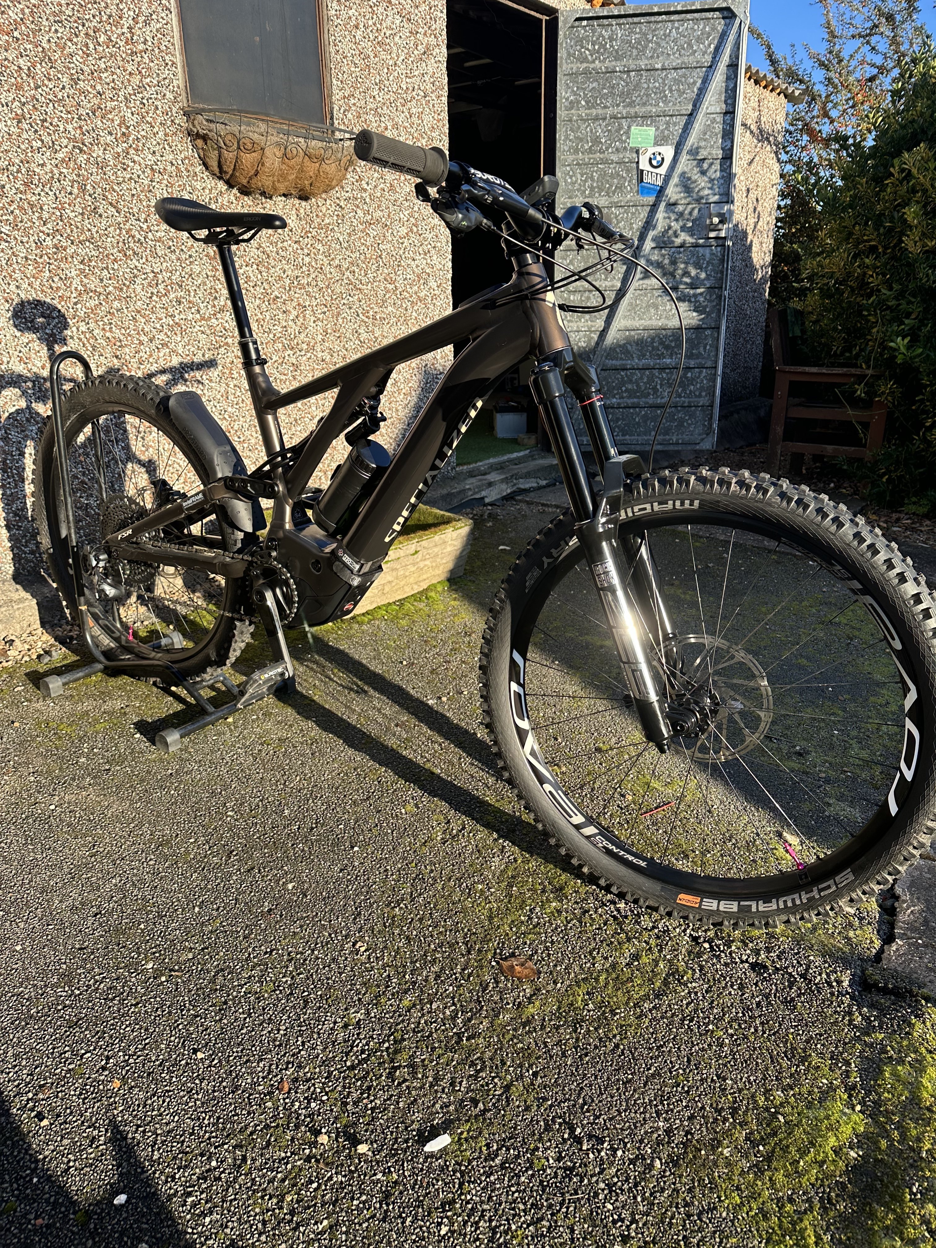

Hello Rob and Jooles I have a quick question for you guys please see below:

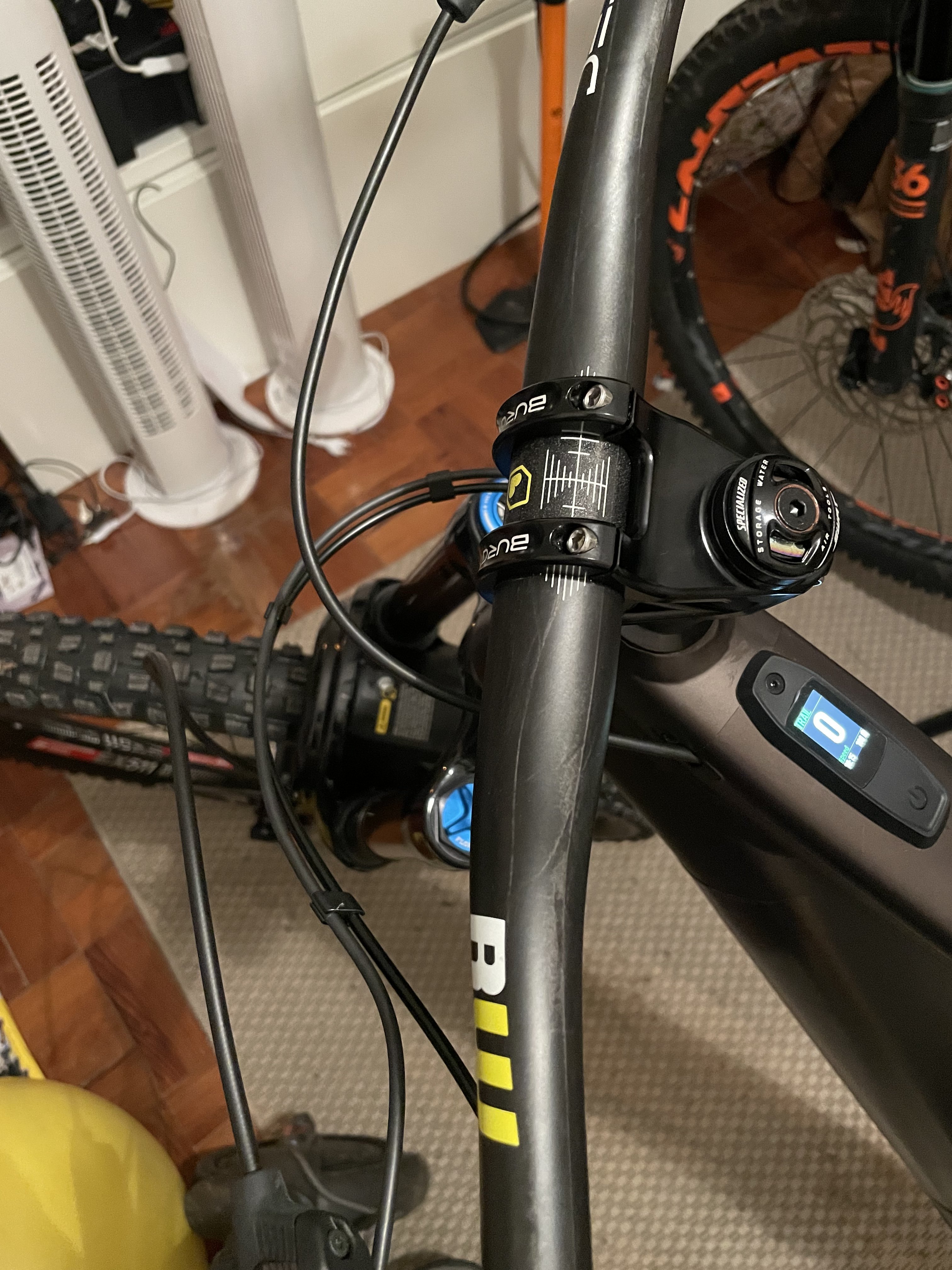

I have fitted a single offset bushing into the EXT Storia top shock mount with the bushing rotated to position the 8 mm hole inward. My Flip chip is in the High position. The steering/handling feels a little squirrely and floppy, not as stable as before with the Boxxer 27.5 set up.
Is this is what the full 29'er Front and Rear set up it is supposed to feel like? I have a 50 MM stem and OneUp Bar.
See Photos Attached:
Where did you purchase the off-set bushing for your EXT Storia?

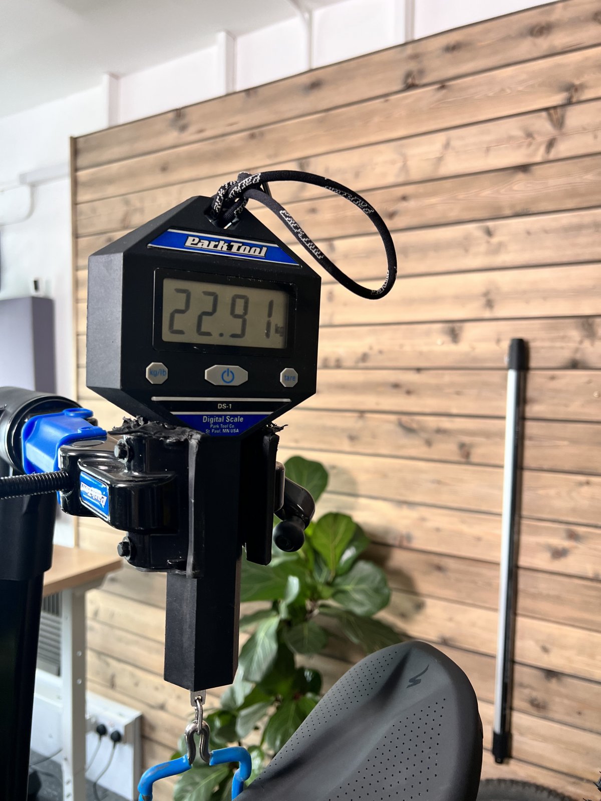

just built. Surprised at the weight!
180mm Front / Rear Zeb ultimate 29er Kenevo
