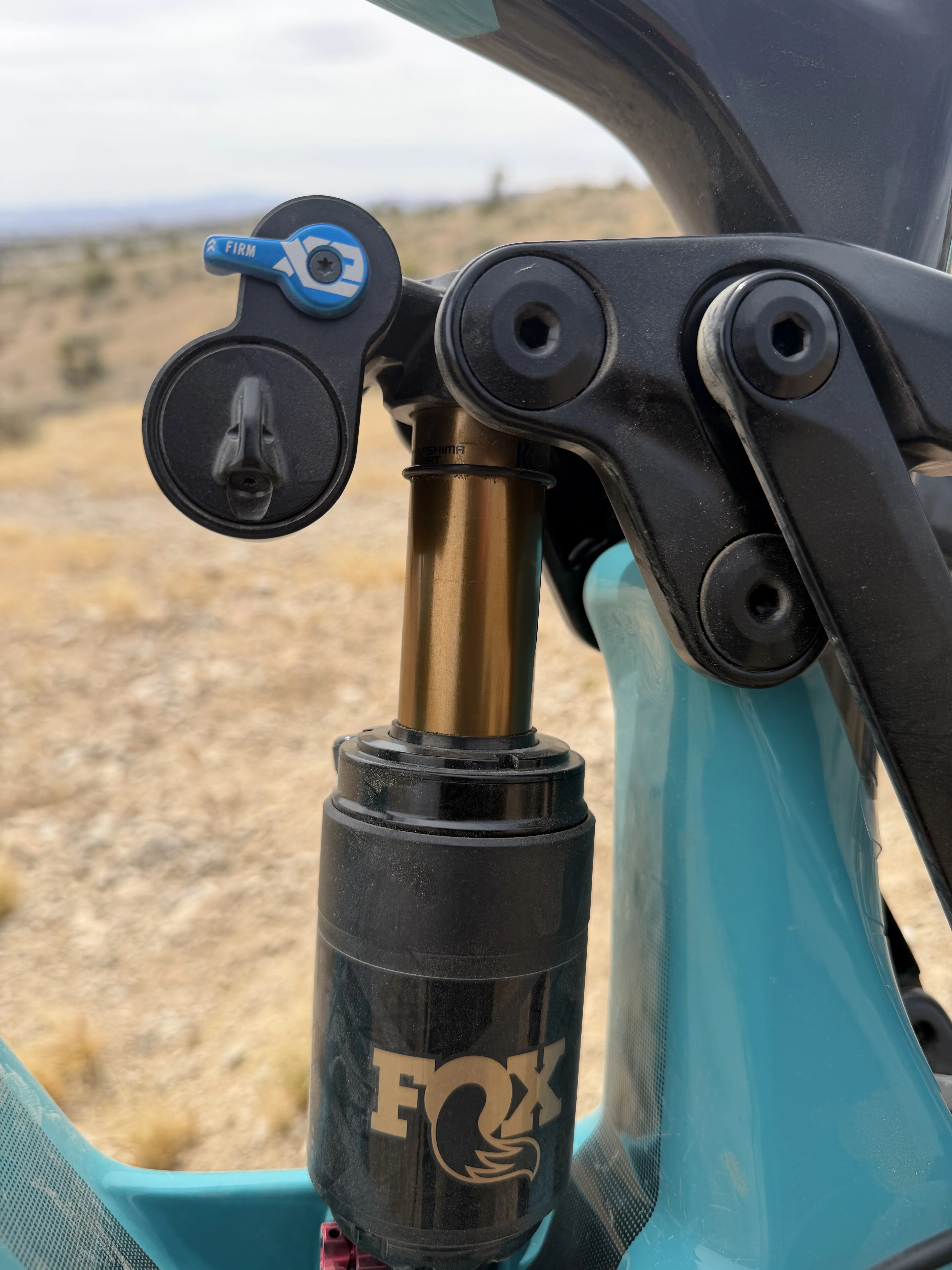

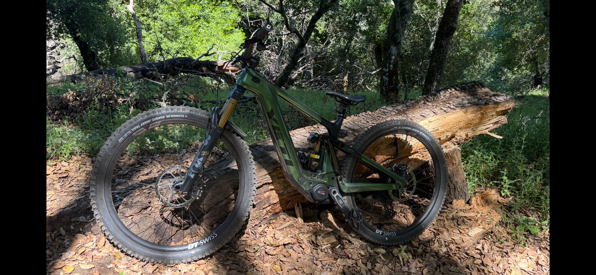

Continuing to try and get this bike fit for my riding style and needs. Had a few questions for you all. What is considered full stroke on the Fox shock? Did I actually use it all up or no? See pic.
One behavior I’ve noticed is the bike feels very light on the front end and the steering seems to be twitchy. It feels tall and wide on the front end. I’ve moved my seat forward to try and get over the front end more but that didn’t do anything. This bike has the same length from center of crown to center of seat post as my Levo but it has a stem that’s about 1/2” longer than the Levo. Bars are the same width but I’m not sure about the bends. Would the longer stem cause this feeling on the steering? I would have thought I’d need a longer stem to get me over the front of the bike to make it feel more planted but I’m afraid to go any longer on it.

Try same stem. There is a text o. The shock n the most top. Shortly before it there should be maximum. If you use a podium you need to set it up real good for riding.
Don*t go longer on stem, try to ride a little more over the front and get you pressure in the tire correct. I weight 90 kg and I ride with 1.6 in the dry and I. Wet till 1.45 bar.
I’ll try a shorter stem and see how it goes. I weigh 77 kg and was running about 1.5 bar in the dry. Tires felt good, front end just felt “high” even when standing and peddling.
Ok hm the yetis are already real low. First try stem is my guess

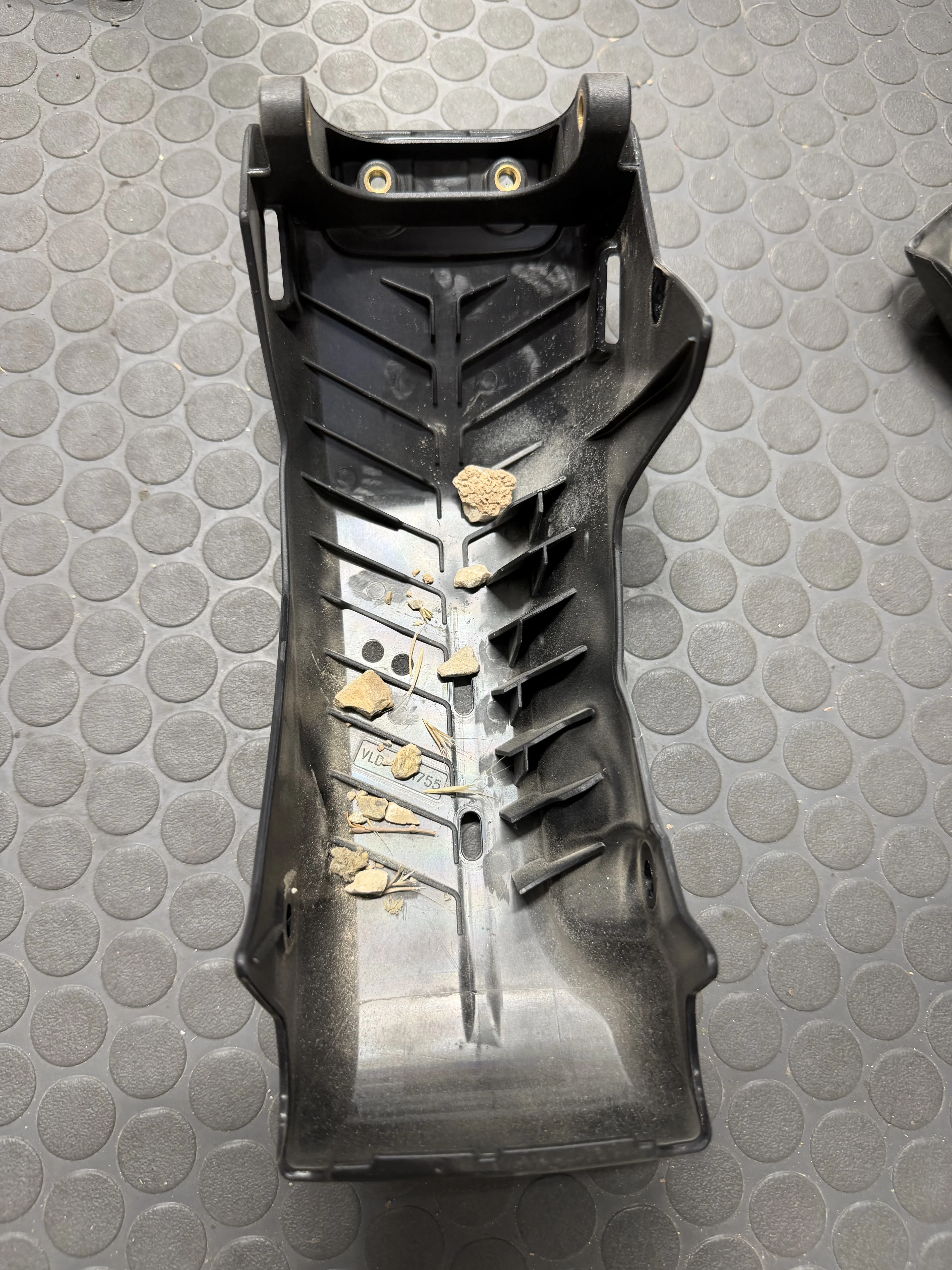

Went on a pretty decent length ride today and mid ride I swore I was hearing some rattling coming from the engine area. After the ride I went and took the skid plate off and it had several rocks that somehow accumulated during the ride. These things were so big I have no idea how they got in there. I’ve got some of that foam I’m going to put on the inside of the skid plate but I’m baffled on where they got in.

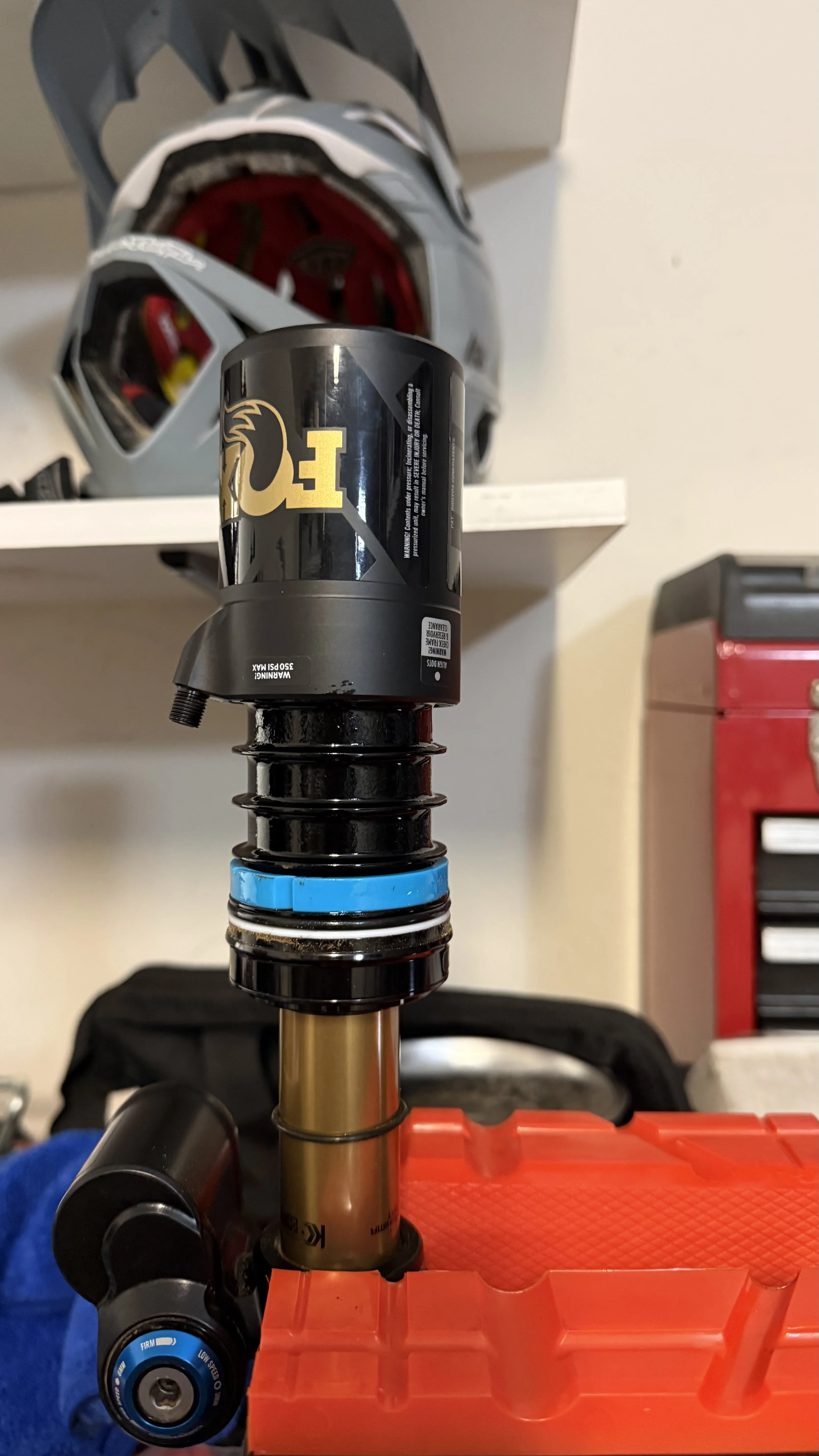

My medium T3 had 1 blue as pictured. I ended up with 2 blues and up the pressure another 5psi from Yeti’s recommendation. Felt great, but I love tinkering and ended up with a Push coil and a 550lb spri
My medium T3 had 1 blue as pictured. I ended up with 2 blues and up the pressure another 5psi from Yeti’s recommendation. Felt great, but I love tinkering and ended up with a Push coil and a 550lb spring.
I've opened and I've found the same configuration. I removed the spacer to have full stroke.
My weight is nearly 100 kg and pressure of the shock is 226 psi.
Thanks
Thanks
Removed the spacer to have full stroke? The spacers don’t limit stroke length. Or are you saying that because of the pressures you run the spacer was making it hard to use the full stroke?
I can*t imagine that. Probably false set up. Don*t saying it’s easy but I think it is that
Exactly the second. Due to pressure it's hard to use full stroke.
Without spacers the situation improved but not completely.
I will try to change shock position (35%).

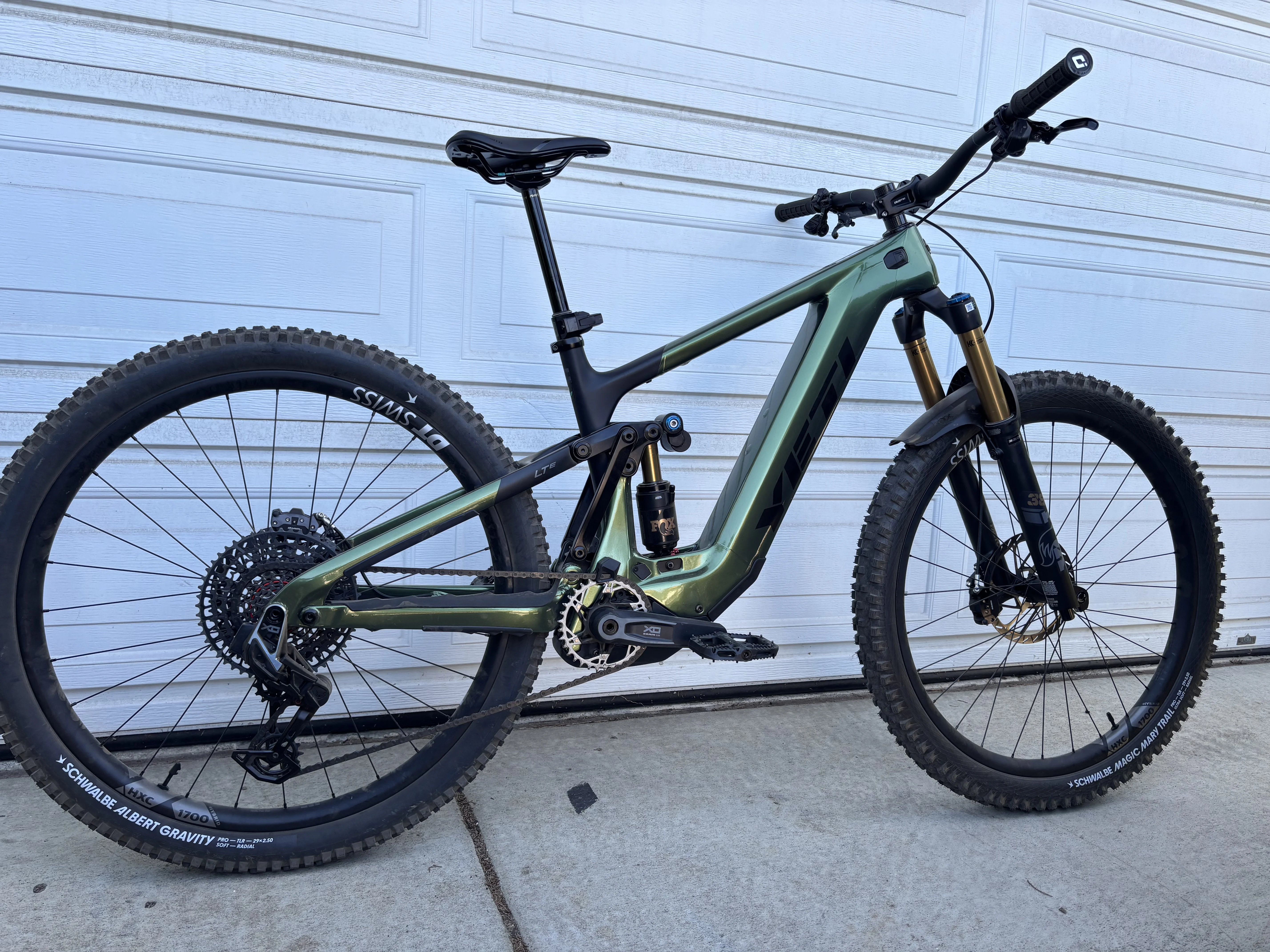

That color is awesome. What's the RideWrap option to change colors?
Oh gosh, I’m sorry. I used the ridewrap name generically. I bought some bulk product off eBay from the seller “Instawraps”. The actual material is their printable product using 3M ControlTac, typically used for graphic signage. I’ve wrapped a few bikes and gravitate to using 3M car vinyl, either 1080 or 2080. Both are very friendly to use.

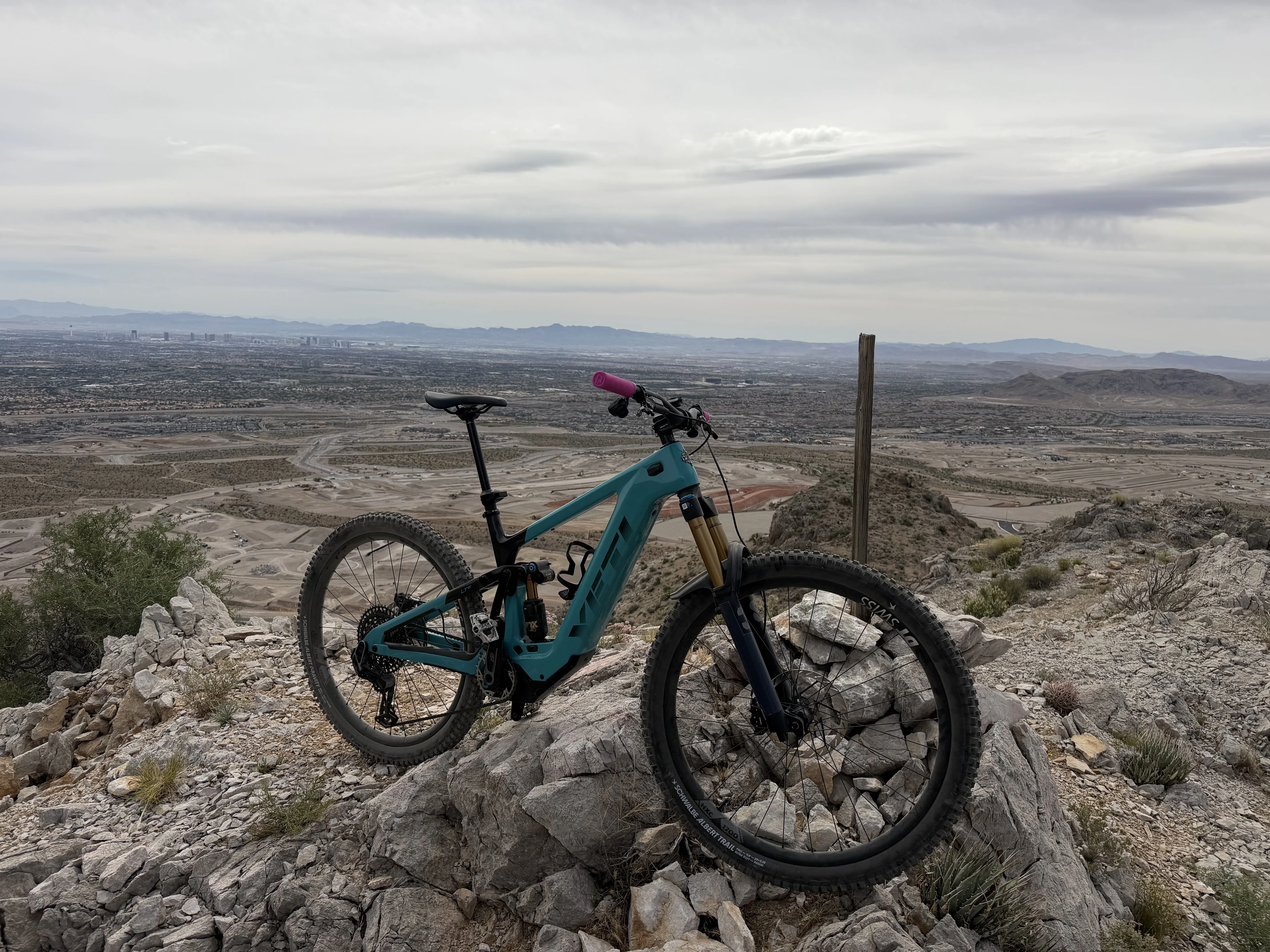

Gratuitous photo of my pride and joy overlooking the Vegas valley.
