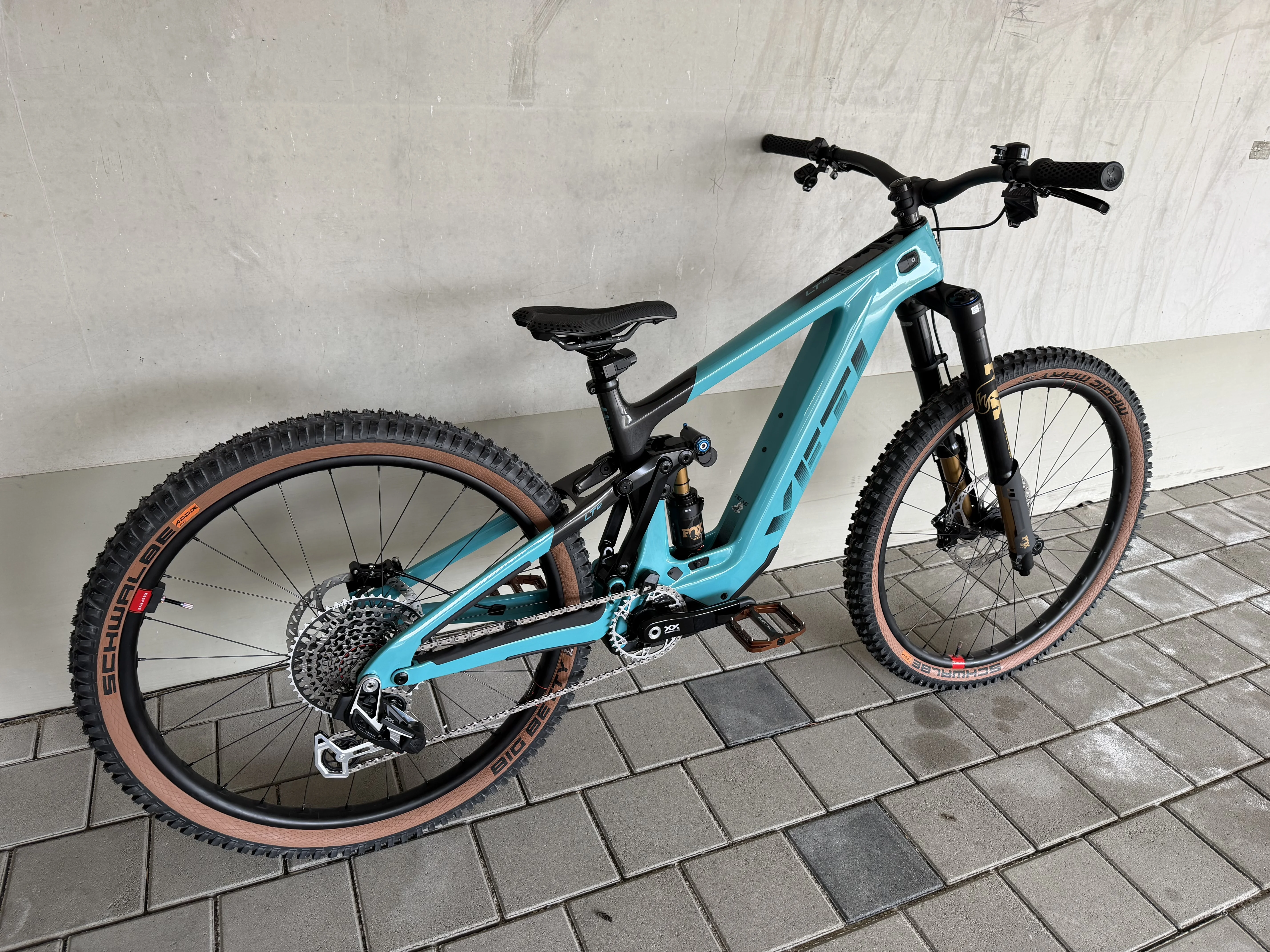

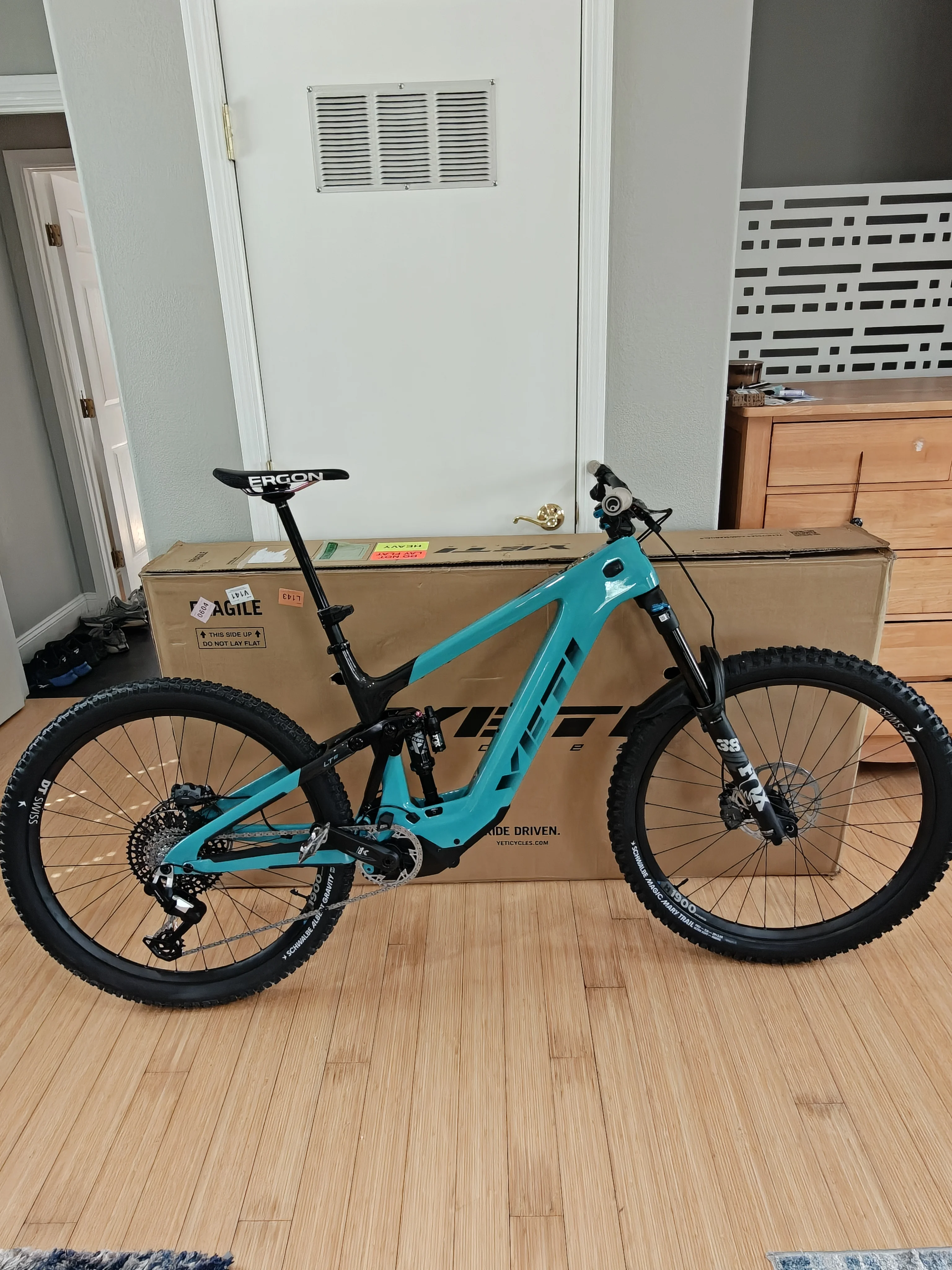

Finally ready. Delivery of brake hose took more time than expected. Now ready and will take her out for a ride. 👍
I’ve never replaced an entire brake line before so I’m uneducated on that aspect. Did your LBS not have spools of it in stock? Or is there a special type of hose you needed?
I’m picturing brake line like derailleur housing.
I am the LBS myself, a hired wrencher will never get his hands on my bike, just purchased it as it is sold, picked it up and complety disasambled and reasambled it.
Besides of that the Trickstuff Maxima has its own braking hose. Of course it is possible to use not a original one but i am not a fan of having high quality stuff with non original parts.

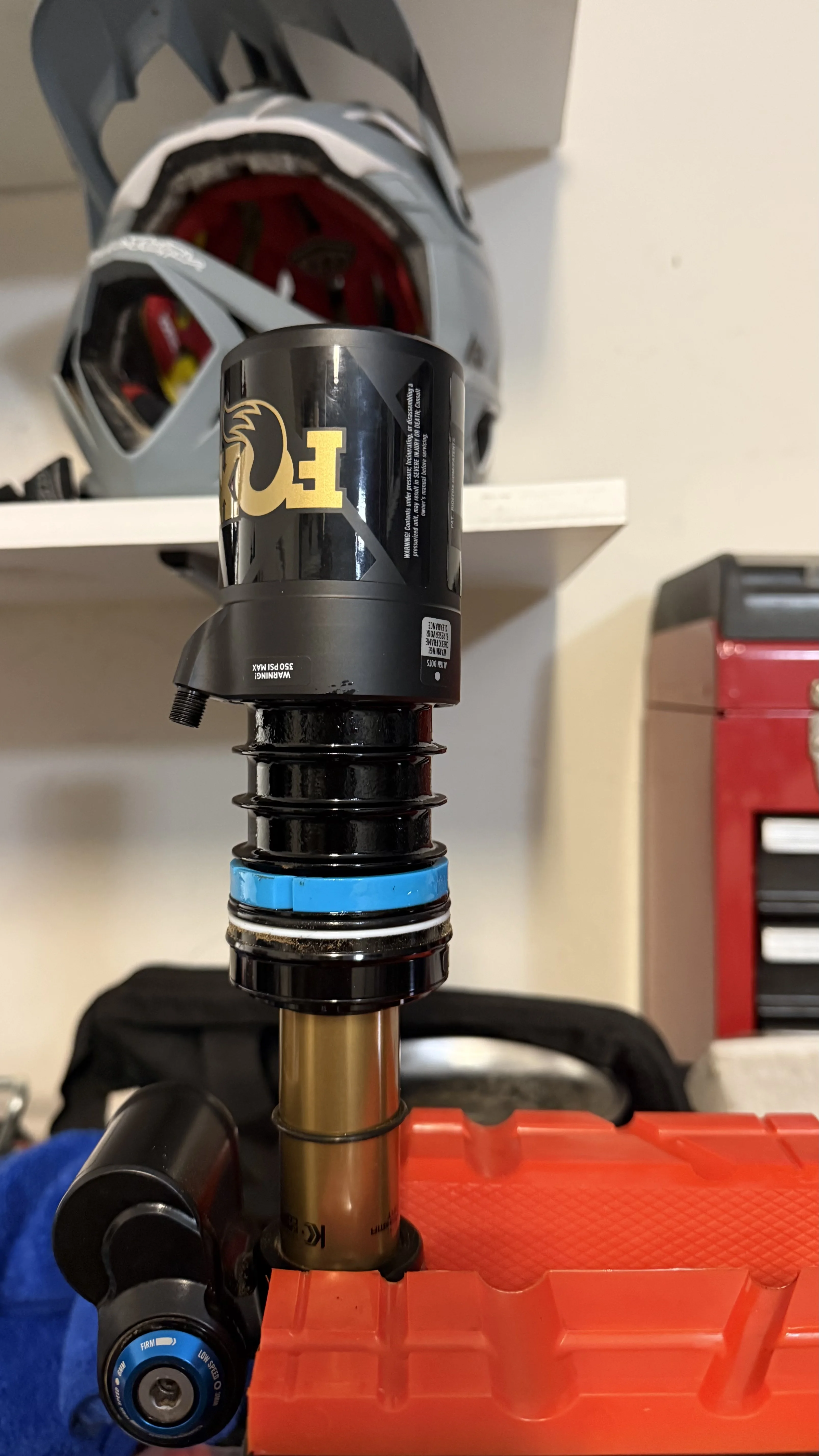

Do you know how many spacers are inside our Float X2 shock as per default (factory setting) ?
None?, One?, Two?
Just to know instead of opening the shock.
My bike model is T3 size L.
Thanks.
None?, One?, Two?
Thanks.
My medium T3 had 1 blue as pictured. I ended up with 2 blues and up the pressure another 5psi from Yeti’s recommendation. Felt great, but I love tinkering and ended up with a Push coil and a 550lb spring.
