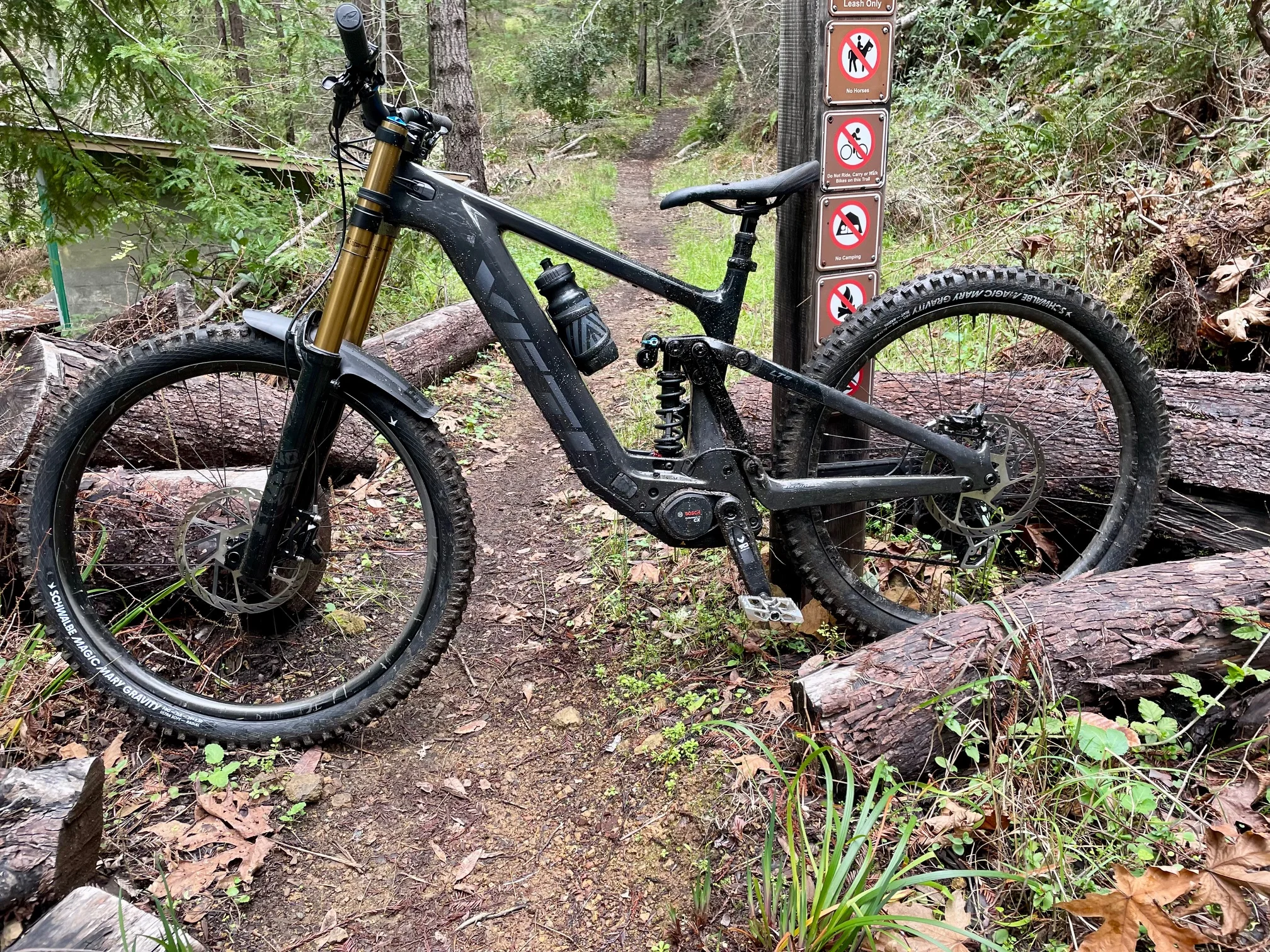

First ride today, and I'm really happy with how it rides. It's incredibly damp/muted over chunk- so much so that it reminds me of riding a trail moto downhill. Awesome for tech, steeps and features; would seriously dumb down lower angle, flowy trails however.
My concerns about weight have vanished- I think that if the bike is sized appropriately for your body and you can generate good leverage from the reach and stack, you can move the bike around just fine even with the extra 20lbs over a pedal bike.
The small rear wheel feels fine, and may well be contributing to the great maneuverability I'm feeling. I'll do some back to back testing with a 29" wheel to see how I like each.
One big takeway is that the Magic Mary rear tire has insane amounts of braking grip, which is really confidence inspiring on steep, wet ruts. Really surprised by how controlled the rear end was in those situations. I have the 29" Albert on two other bikes, and the 27.5" MM blows the Albert away for braking in the wet and loose.
Curious about the riding locale of this pic, which has a lot do with each of us both being in the Bay Area and that trail behind the bike does look inviting, if not off limits based on the signage.

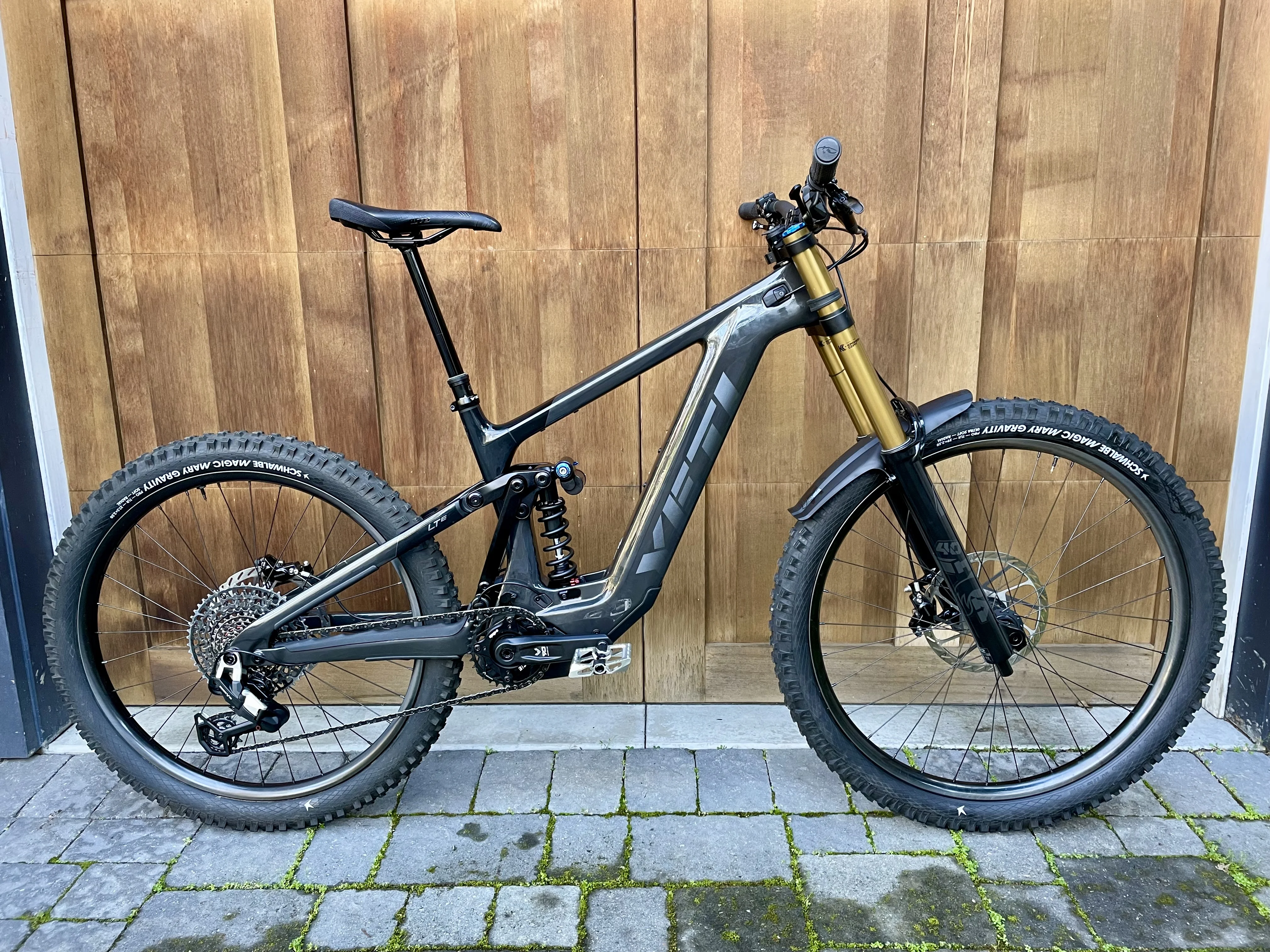

Finished the build last night- I call it the DHe. Fox 40 @190mm, DHX2, Ochain, WAO Union mullet wheelset, Oneup 210mm dropper. The only original components are the derailleur, shifter, cranks and bar. Head angle is 63.7 degrees.
Did you get a weight?
My Norco with 49/coil/DH casing/cushcore landed just under 55lbs (with mallets)

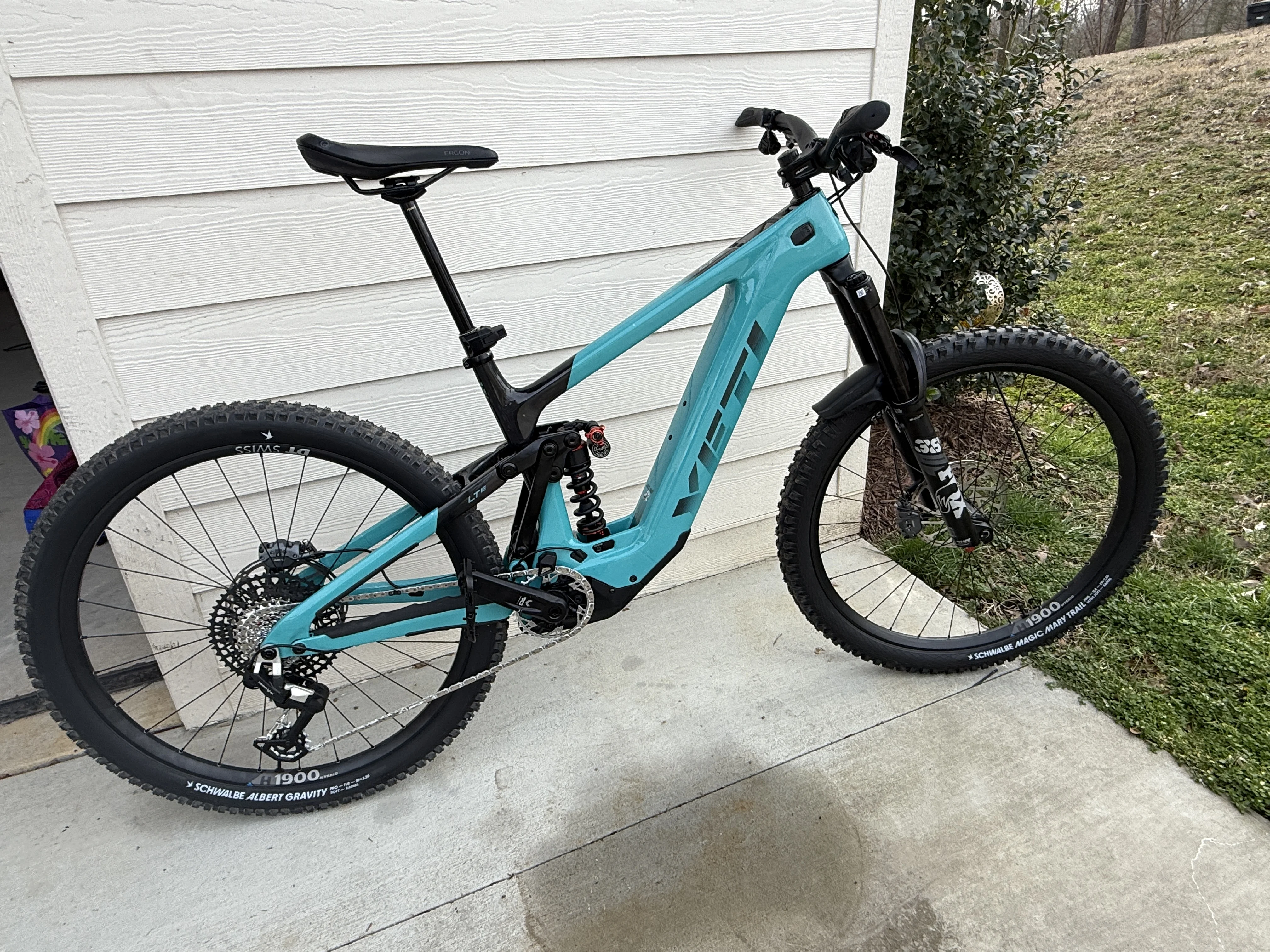

Finally got my ride setup finished and am excited to share - mainly for the custom tune tips at the bottom because I had difficulty finding suggestions across multiple forums.
I got the C2 Model because I dont like carbon wheels and electronic shifting. Also am a coil fanboy so I planned to replace front / rear suspension.
Upgrades
  • Oneup Carbon V2 bar
  • Smashpot V2 (60lb) HBO 4
  • MRP Lift V2 (blue) C-3 & R-7
  • DVO Jade X Prime WP with custom tune w/ 550lb spring
  • Ergon SMC E-Mountain seat
  • Outdoor Lighting EVO & Portal
  • Ridewrap
  • Marque Ergo grips (better than Ergon stuff & cheaper)
  • Oneup Wave pedals
Weight 56lbs minus the lights
NOTE: I did not ride the OEM suspension beforehand so I dont have any before / after insights.
For those that looking for custom tuning tips. Here is what I gave tuner and it is perfect for me & my riding style:
Rider Weight fully Kitted: 220lbs (100kg) age 48yrs
Ride lots of techy trails with rocks & roots - SE TN / N GA & NC. Dont do big jumps or drops, but do enjoy some pop off small trail features.
I want confident traction with feedback from terrain is present but not jarring
Initial stroke: supple off the top, small chatter disappears without harshness.
Midstroke is supportive: Doesn’t wallow or dive when pushing into corners or compressions.
End stroke has controlled ramp. It firms up predictably without sudden spike.
Rebound is predictable: Slower for stability on descents, returns energy smoothly without a “kick.”
DVO Jade X Prime with WP Cone valve custom tune shim stack:
Mid valve Rebound
1 x 11-0.10
2 x 16-0.10
1x 15-0.15
11 x 1.00
Mid Vavle compression
2x22-0.10
1 x 13-0.10
1 x 21-0.15
1x 20-0.15
1 x 18-0.15
1 x 16-0.15
1 x 14-0.15
1 x 12-0.15
11 x 1.00
Base valve compression
Cone valve
HSC - open
LSC - 2 in
LSR - 13 out
Bladder 160
Oil 2.5wt

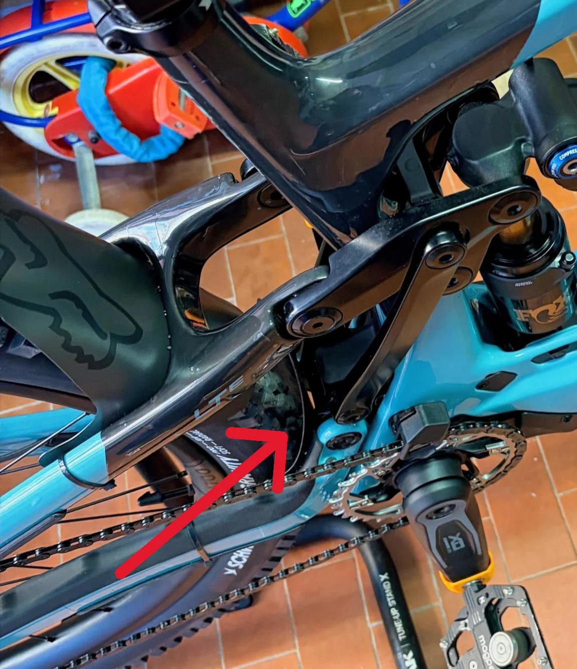

A lot of talk recently online (FB) about significant amounts of dirt ingressing the motor compartment from the opening above the main pivot attach point. I talked to Yeti support about it and they said they're aware of the situation and that some employees are experimenting with Gorilla Tape and moto foam. No formal "fix" in the works from Yeti however. So I MacGyver'd this and it works really well.

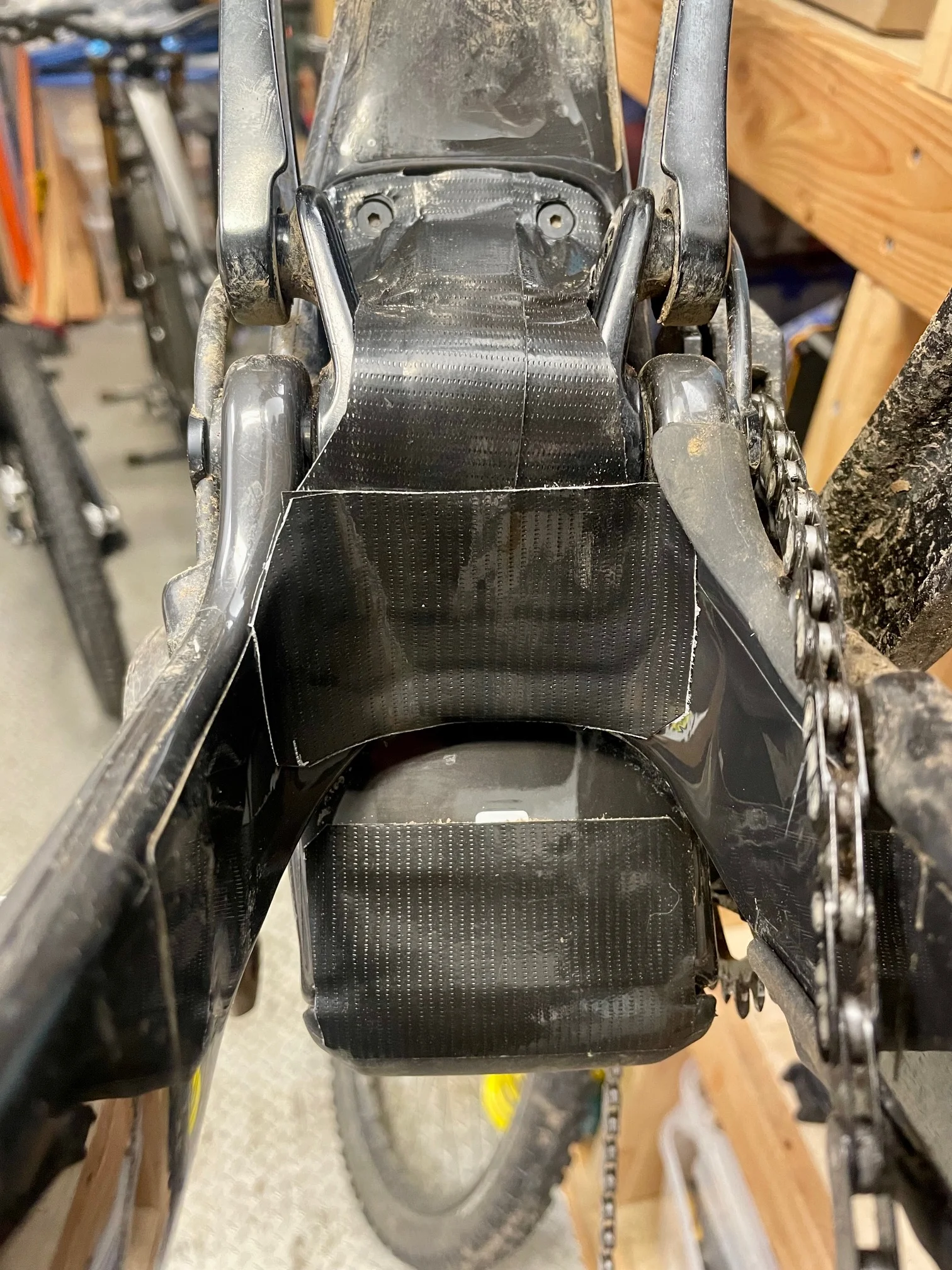

I just placed my order for a Turquoise LTe T3. In anticipation of the bike getting here, I’m putting together a list of upgrades. Other than Cushcore and my preferred grips, what would you guys recommend for this bike? I see some people have got some foam and duct tape to fill the voids around the engine. What else should be on my radar? Does it needs STFU chain guide?

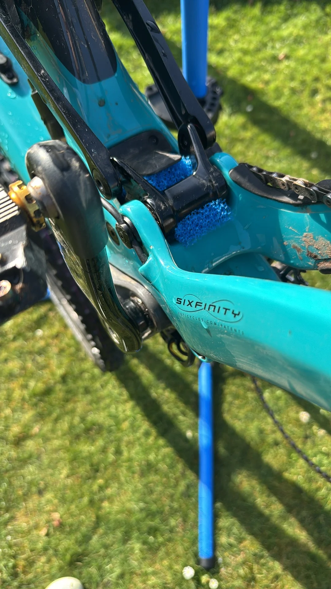

I would hold off on any anti- chain damping / kickback device until after you've had about a month on the bike, as this would allow to ascertain any improvement when you add these devices. Chain growth nearly stops at the switchpoint - so no kickback at that point. Also, shock choice is open since you have a wide choice or L/Rs - coil should be thoughtful consideration. What about 29 vs. MX? - swapping wheels would be a priority for me, as I see either working quite well for this bike.
In the picture the way I protect the link from mud and debris. Simply a mud guard that I've cut a little to have the chain free to move. In this way also the frame is protected.
I've done the same system on my old 160E.
You only need the foam trick (aquarium foam for the filters or moto foam)
Change the tires to what you prefere and your good to go. As next step i will try the 35% progression settings.
I feel the yeti handlebar is quiete stiff, will test out a one up against it.
I use motoX foam to fill the gaps, stops all the mud and Debri getting down the gaps.
Just ordered the foam! Thanks to everybody for the tips. Apart from that 1 pic by @DaveGo do you have any other suggestions where and how to put the foam? I am not sure what will prevent it from falling out.
Would you also fill the gaps on the motor cover/vent holes with the foam? I assume that let's the cool air through but not the grime. (?)
Just cut it slightly larger and push in down into the gaps. It could fall out but mine haven’t yet. As for the motor guard, I personally wouldn’t cover those, as they are most likely there for cooling. 👍
