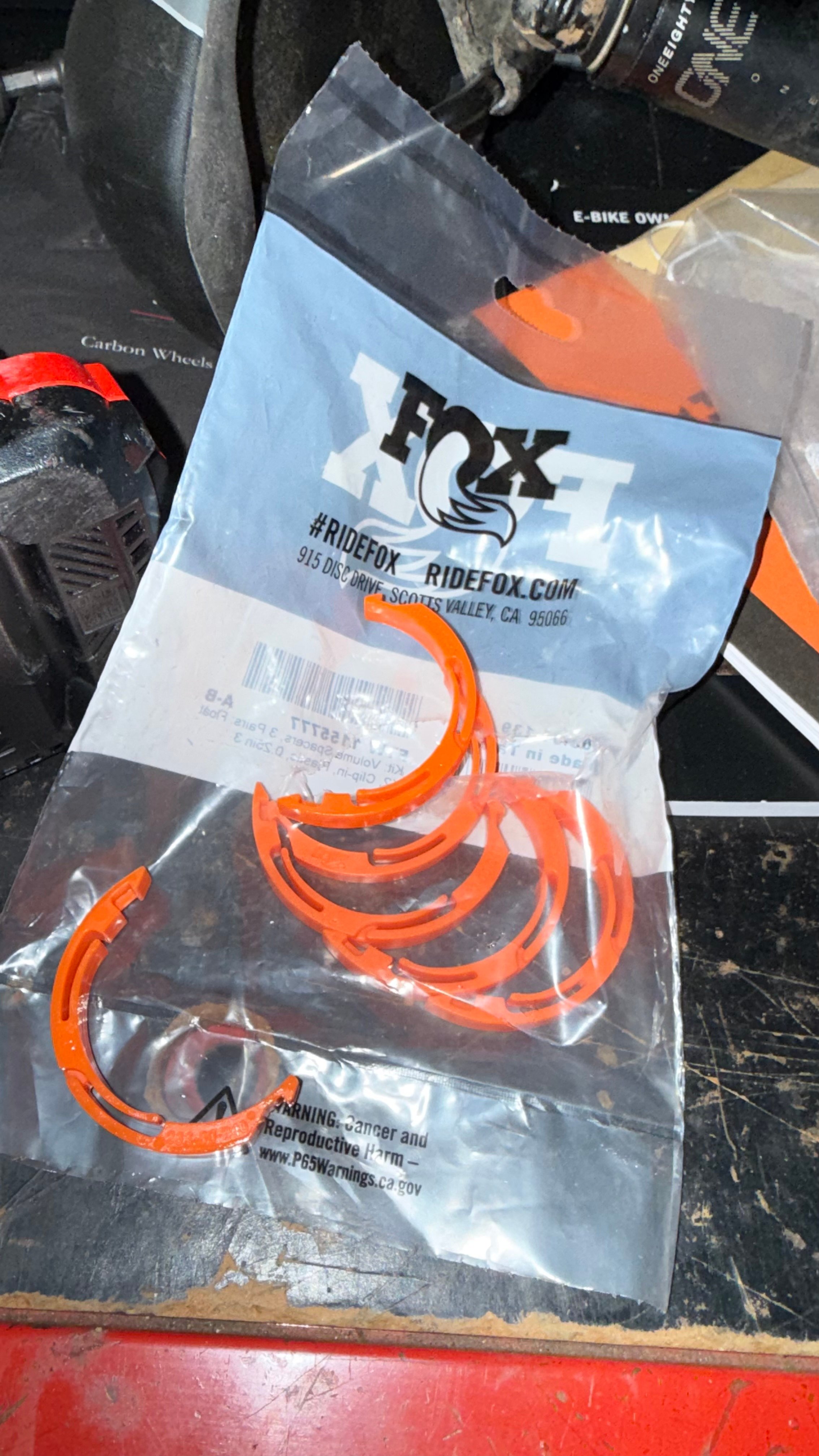

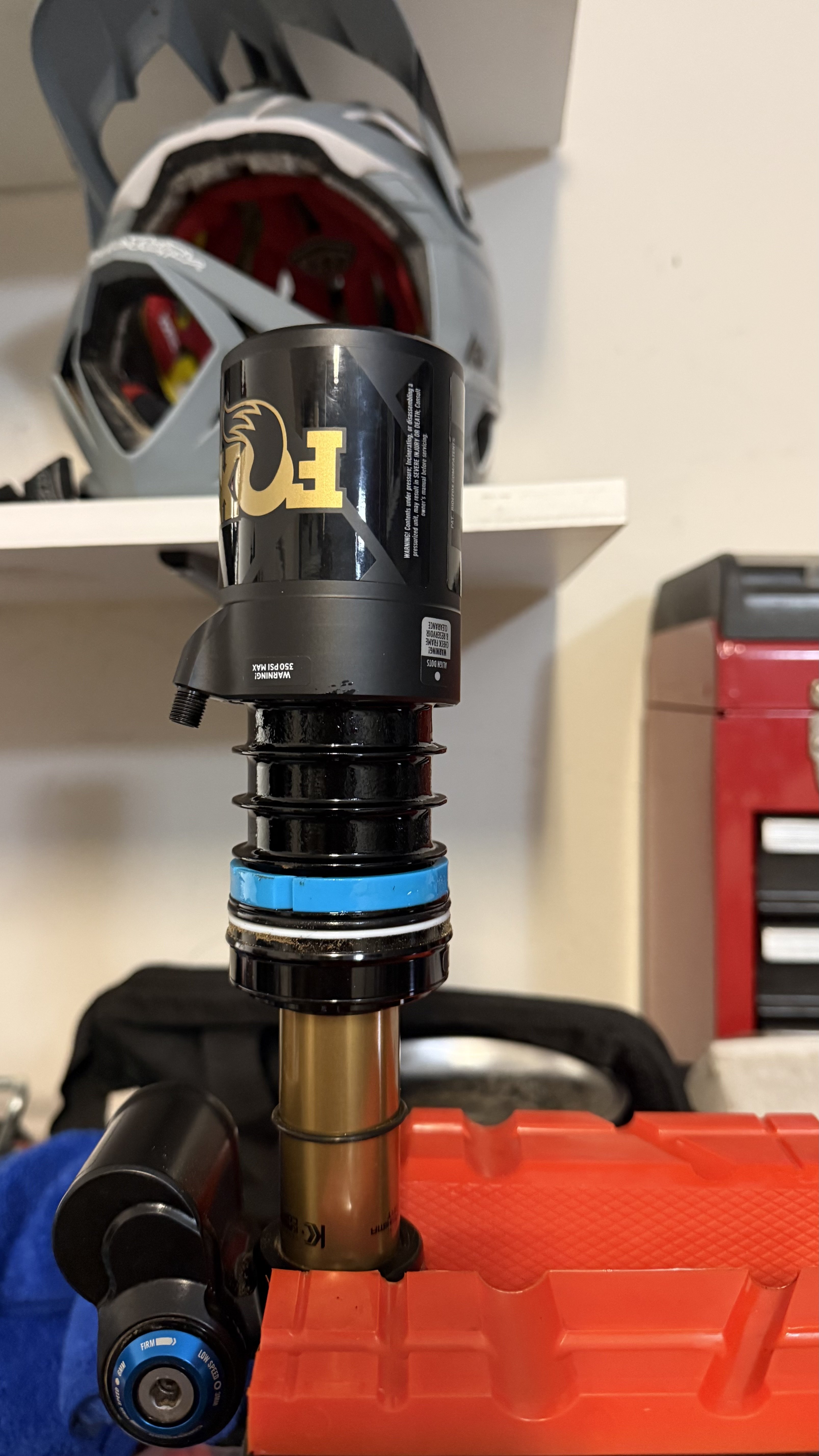

After many rides, this bike is so nice and quiet uphill and downhill. I’ve noticed on my local trails I’m using up a lot of travel almost every DH. I YouTubed how to replace volume spacers, come to find out it’s just like the old float X2. For a medium sized frame stock is 1 blue volume spacers. Unfortunately the diameter for a 2026 Float X2 is slightly larger than the previous X2 shock. Ordered up some more volume spacers.
Even in the progressive position you will still blow through the travel I have found. I've added an additional blue 1cc token and will probably add one more.

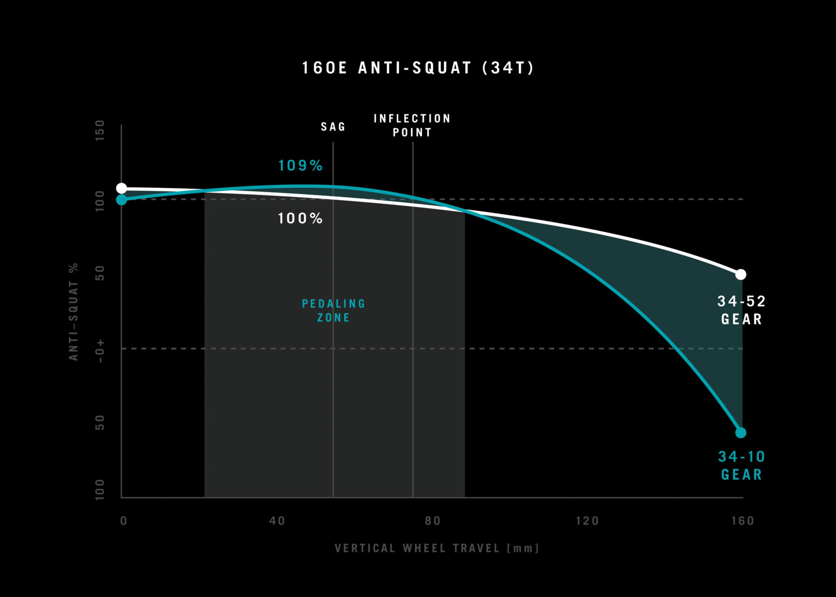

Agree. For me, the published kinematic graphs for AS, AR, and L/R seem to be about the very best incarnation of what an inherent Horst Link design has to offer.
But the downside of Sixfinity, that you may have unintentionally drew out, is that Yeti is in no hurry to license its design, so you are stuck with the bikes they offer or off-the-table frames they won’t directly sell. OTOH, endearing Yeti fans would see this as an upside.
Whereas I-Track is wholly in the business of doing the opposite in only licensing their design. In fact, years ago, iTrack Suspension was productizing their own bike to sell, with a position-adjustable idler to allow you to tune your own anti-squat curves. They clearly gave in on this model in favor of just licensing the tech. And the dude captured a pretty wide patent here because putting an idler on any articulating part of the rear suspension encroaches pretty much on the patent, which became all the more valuable since the growing popularity of HP idler bikes. The counter to the wide interpretation is that bikes having iTrack can behave quite differently because of the differing ways of implementation. In this way, these companies should do well to publish their kinematic graphs or if you can throw a leg over one, all the better.

Perhaps you meant anti-squat instead of anti-rise? While technically kickback is only a function of chain growth, with idler-less multi-bar bikes with standard derailleur transmissions you will always have chain growth with AS and so as you say, kickback will be there.
Also, will you use the Ochain version that allows for easy external adjustment? I ask if you can indulge me by running the bike for awhile with the float disabled and get comfortable with bike first before embarking on taming any kickback. The reason I'm interested is that if AS kinematics of the Yeti are to be believed:
Then, I'm finding it hard to understand how much kickback accumulation there is in the first place, especially after the switch point where AS goes full negative and basically the chain stops growing. It may be that kickback is felt less when just pedaling over small chunder less than while dropping into big bigger hits near approach -100% AS (i.e. zero kickback). I'm also curious after all is said and done, what Ochain setting you will settle into and how that compares to the Spire and Hightower.
