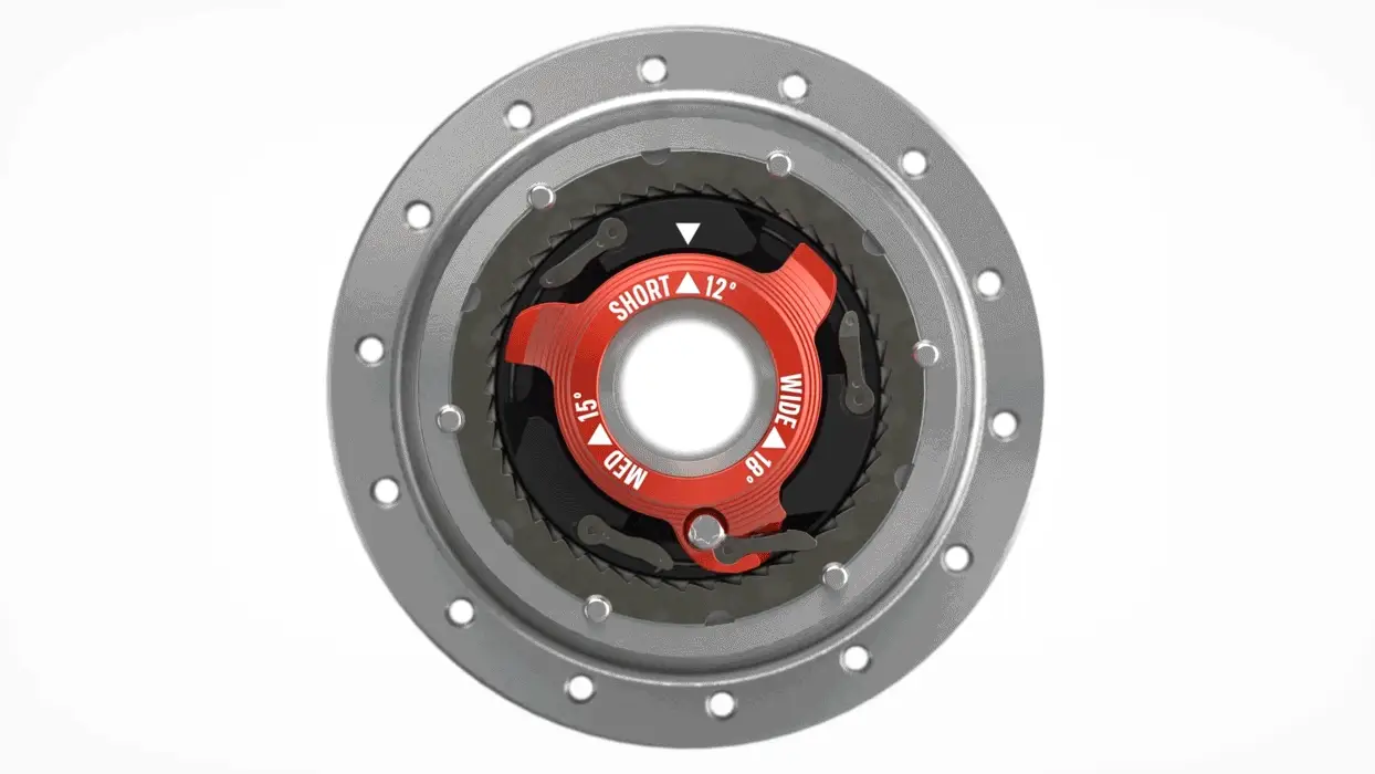

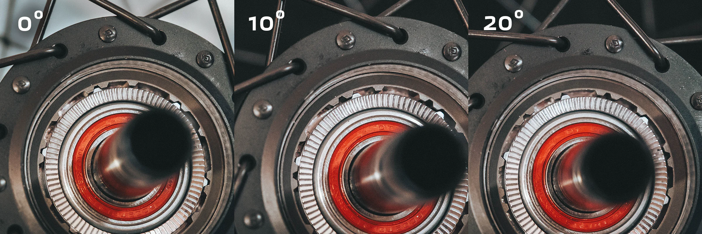

For those interested in the differences between the sidekick and deg freedom:
DT Swiss deg freedom:
The deg freedom is just space in the ratchet as seen in the pic. You can decide which spacing you want with 20 degree being the biggest gap for engagement. The downside to this system is your engagement within that space could be anywhere. When you pedal it could be instant, or 5 degrees to engage, or 20 degrees, etc. so same for how the kickback would work. Sometimes you may get the full 20 degrees available for the cassette to kickback, sometimes it won’t be any room on the forward movement of the cassette.
E13 sidekick:
The sidekick moves from the middle of whichever setting. So if you’re at 18 degrees, it will always be 18 degrees when you start to pedal. Same for kickback, the cassette will always have 18 degrees either forward or backward to move before engagement. As soon as you’re off the pedal it goes back to that middle area. There is also only 1 paw engaged until that free play is up and then the others engage. So this also makes for less drag and faster with less resistance. Just an added benefit.
So the Dt Swiss could be considered comparable to a very low engagement hub if you pick the higher anti kickback settings.
The sidekick is totally different in how it works and is not really comparable to just a low engagement hub. Is the difference between the two even noticeable, not too sure. I went with the sidekick after finding this out though. Makes more sense to me if you are going after eliminating pedal kickback. Others may go Dt Swiss just for the bomb proof reputation.

Did you notice a big improvement in coasting speed with the sidekick? Like lack of drag, or is that overhyped in their marketing?
I definitely notice more drag when switching to i9 hydra 2 hub vs my previous hub.
For me the noticeable different in drag between the sidekick and Hydra 1 was on the stand, not on the trail. Biggest difference on the trial is the e13 is nearly silent.
Damn I should have went Dt Swiss 😂😂
I got my reserve wheels with the sidekick hubs now. Just got to set them up. Was going to wait for my crestline frame, but I may just go ahead and set it up and give them a go. I do like the idea of a silent hub though after the extremely loud hydra 2s
The problem I have with all these anti-kickback hubs is at the core they are nothing more then low engagement hubs (usually with adjustability). I've been running the ethirteen sidekick but just swapped them out for a standard low engagement hub. At the end of the day I didn't like having that hub take-up on more technical trails, It was more important to have a quick reacting pedal stroke without the take up.
On my e-bike I have the Sidekick set at maximum movement because I can’t feel the take-up at all. The motor spins up to engage the hub faster than my feet apparently.
On my regular bike I set the Sidekick to minimum since the take-up is super obvious.
I have mine set on minimum (12) and can really feel the take up on slow technical climbs (avinox motor). I do have my settings dialed way back (power and tq) to give a more natural pedal feel to the bike.
this does not align w/ my understanding of the DEG-DF. IIUC, b/c of the drag of the star ratchet teeth against each other, the spoke-side half of the star ratchet (the part which has "freedom" in a DF hub) will always "reset" backwards, to the position shown in your photos. once reset, it would have the full range of 10 or 20 degrees of rotation. with 90t DEG, the 2+/-2 tooth engagement is pretty small, so you effectively get "just" the degrees of freedom.
so my understanding agrees with @John_likes_bikes, that DEG-DF and Sidekick are practically the same.
the bigger issue imo, as I posted about previously, is that a hub-based solution multiplies the degrees of hub-freedom by the gear ratio. causing an enormous degree of crank rotation in larger climb-cogs, where I personally want the tightest engagement.
a crank-based spider has fixed degrees of crank rotation regardless of cog. and it also deadens chain whip.
also, Sidekick in particular adds substantial unsprung mass compared to a DT 240 or 350 hub. this is why I am waiting for the Rimpact eMTB chain damper for my 240 DEG rear hub...
Yeah the dt Swiss df hub 'resets' by the drag of the freehub. So you get the degrees of freedom set in the hub 0,10or 20 degrees, plus the random float in the ratchet teeth.
I have a df hub set at 10degree, its decent, makes things feel a bit smoother/calmer.
I wouldn't swap out a perfectly good working rear hub for one, but if you need a new rear hub anyway then you may as well get a dt Swiss df hub.
