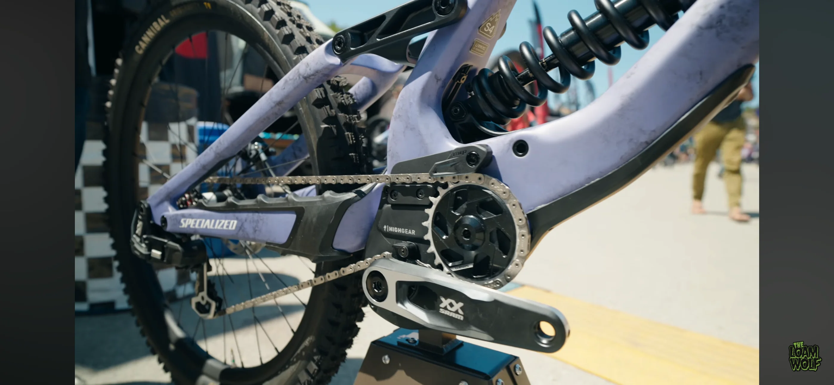

You guys see the new specialized demo and their anti-kickback setup? Pretty interesting.
