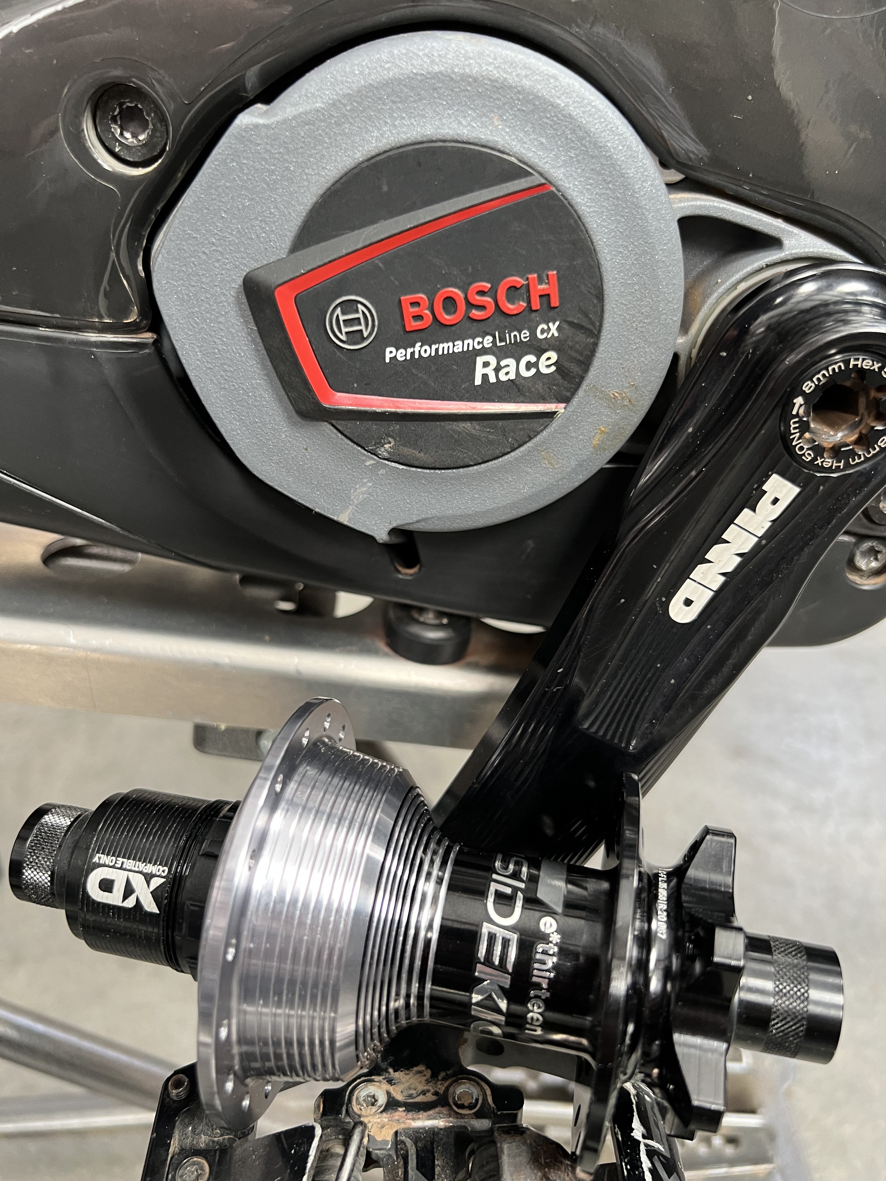

Just put a sidekick hub on my Amflow. Overall I’m impressed, it does what it says on the tin.

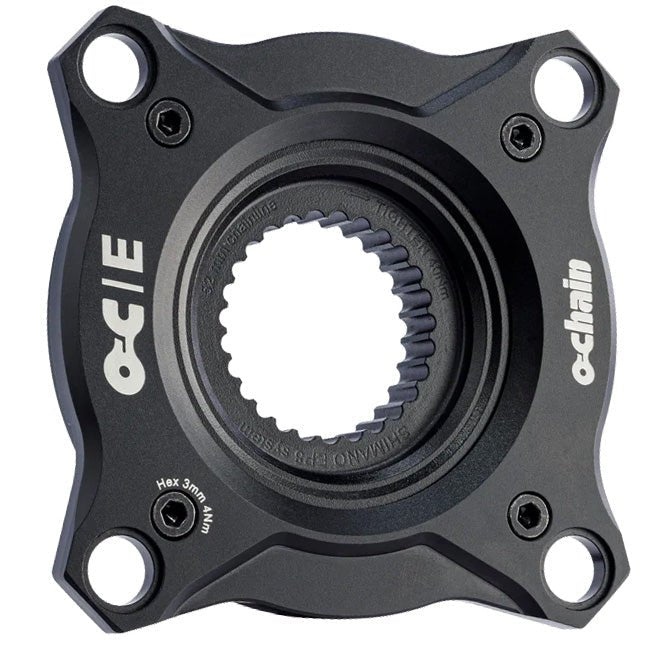

I've been using an ochain since prior to the sidekick release so that's where my brain went first but I got a sidekick for my next DJI bike. If the sidekick is reliable it's definitely a better option than ochain. More degrees of float, interchangeable with any bike (with like hub spacing) and easier to set up/adjust.
I'm not aware of an Ochain spider, which is motor-specific, for DJI. But using a SideKick or Tairin S1/Shogun is fair game on a DJI bike.

I have an e13 Sidekick on my Amflow, it definitely works very well.
Just put one on my Yeti 160e, they’re really good! Advantage over o-chain and similar is that it’s easier to move from bike to bike.

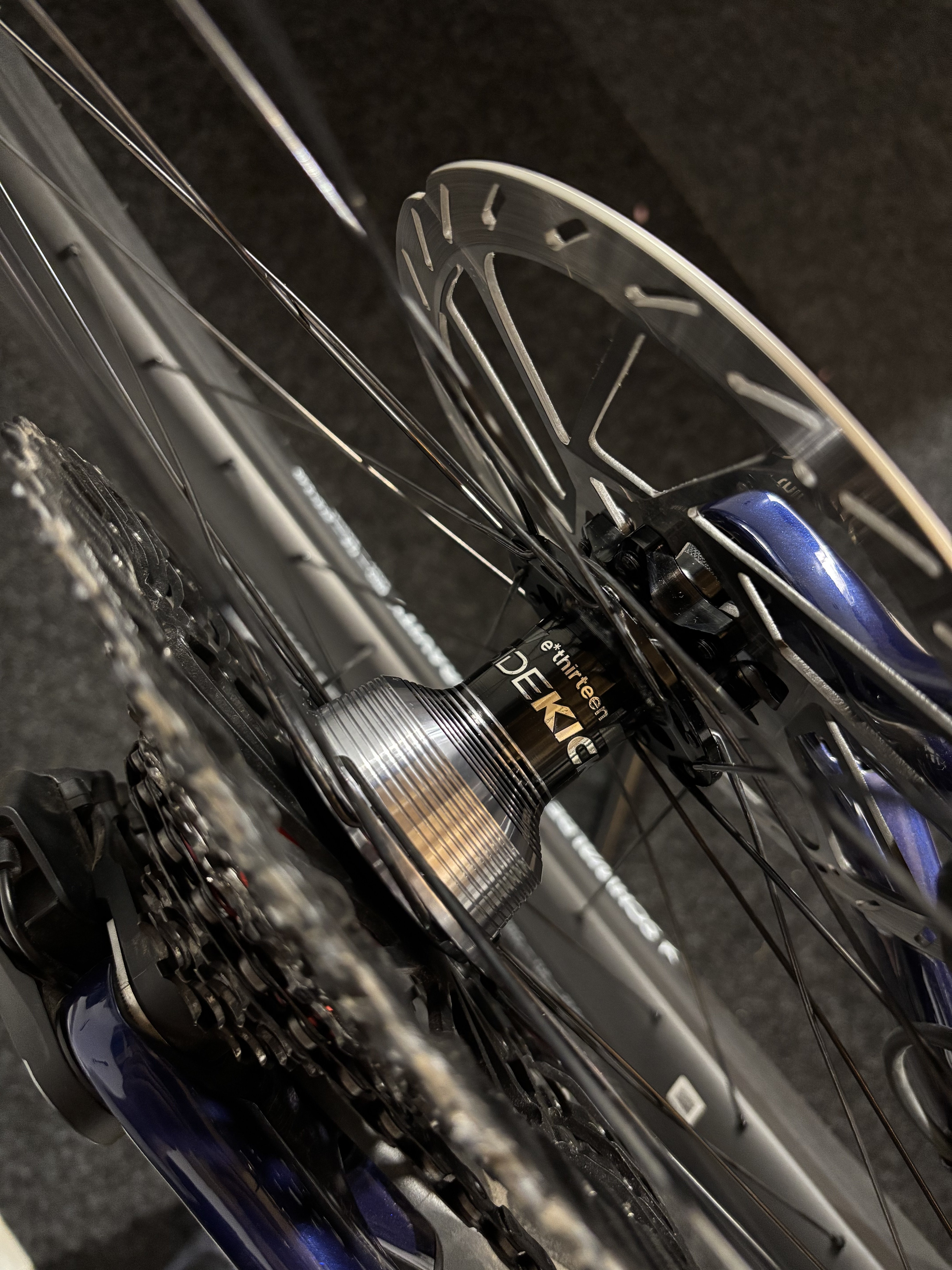

So, I ended up ordering an E13 sidekick hub for my Levo 4 (Specialized 3.1 motor), report will follow in next posting here.

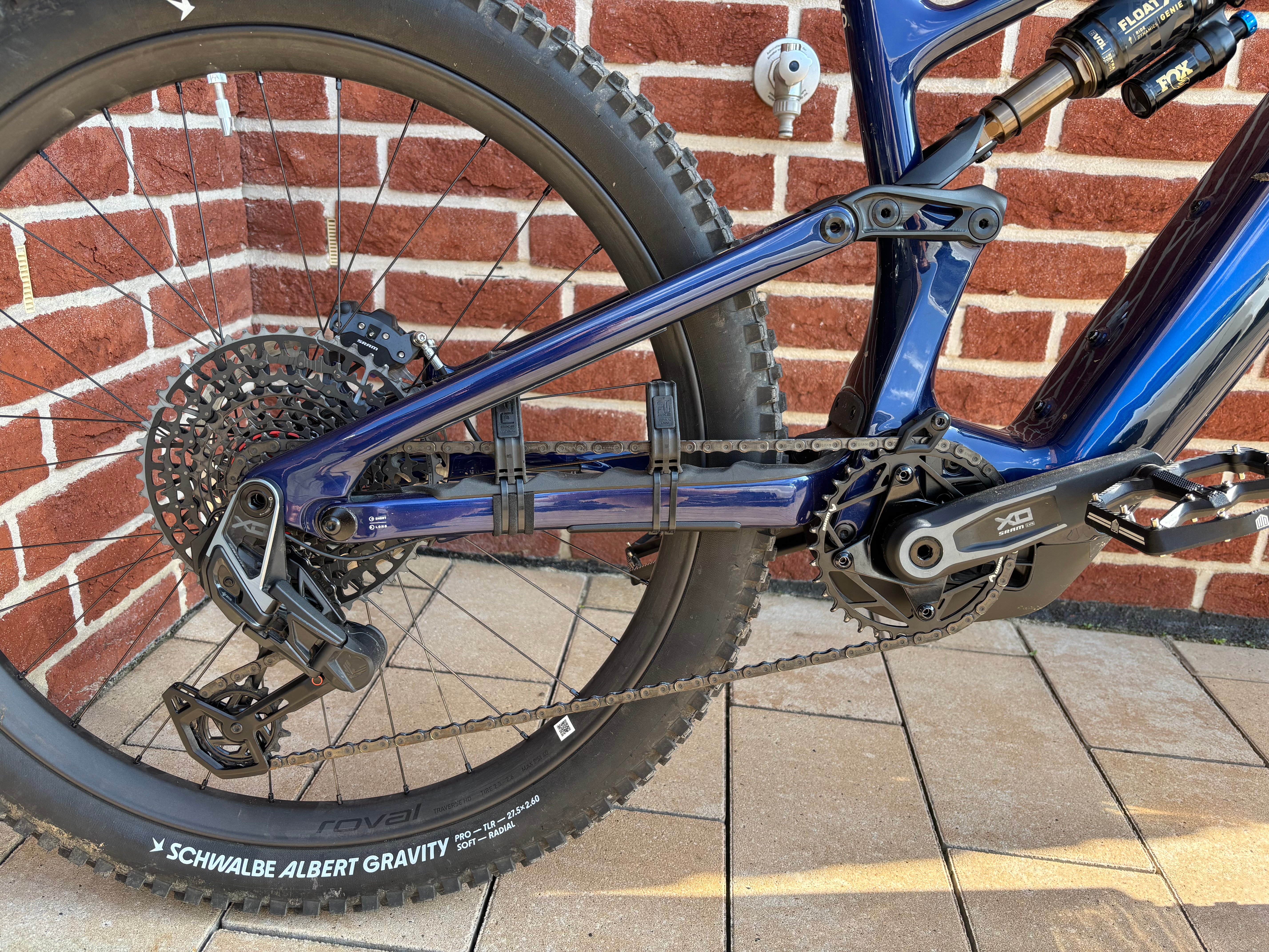

My Experience with the e*thirteen Sidekick Hub
After reading several reports – including some in this thread – about using an O-Chain or an e*thirteen Sidekick hub to reduce rattling noises from e-bike motors, I decided to try it on my Levo 4 with the Specialized 3.1 motor. This motor also tends to rattle when the chain is pulled slightly backwards, for example due to pedal kickback or when the chain flutters on rough terrain. It’s less pronounced than on EP8 or Bosch Gen4 motors, but it’s still noticeable – especially if you are used to a very quiet bike or are sensitive to noise.
My primary motivation was therefore to reduce motor rattle rather than to eliminate pedal kickback, although that side effect is welcome.
I built up a wheel with the Sidekick hub and replaced the stock DT 350. On the drive side, slightly shorter spokes were required. Wheel building and setup went as smoothly as with any other hub.
I started with the 18° engagement setting. Even with a simple test – dropping the rear of the bike to the ground – it was immediately quieter because the hub eliminated the chain tension that normally causes the freewheel mechanism in the motor to engage.
Out on the trail, I got used to the 18° setting within a few minutes; after about five minutes I didn’t notice the difference in engagement at all.
The rattling noises were clearly reduced: on smooth and moderately rough sections they disappeared completely. On very rough terrain there was still some noise from the chain slapping around. That chain slap occasionally pulled the chainring backwards and caused some residual freewheel rattle from the motor.
I also noticed that, due to the Sidekick hub reducing pedal kickback, the chain now moves around more freely on rough trails – which makes sense.

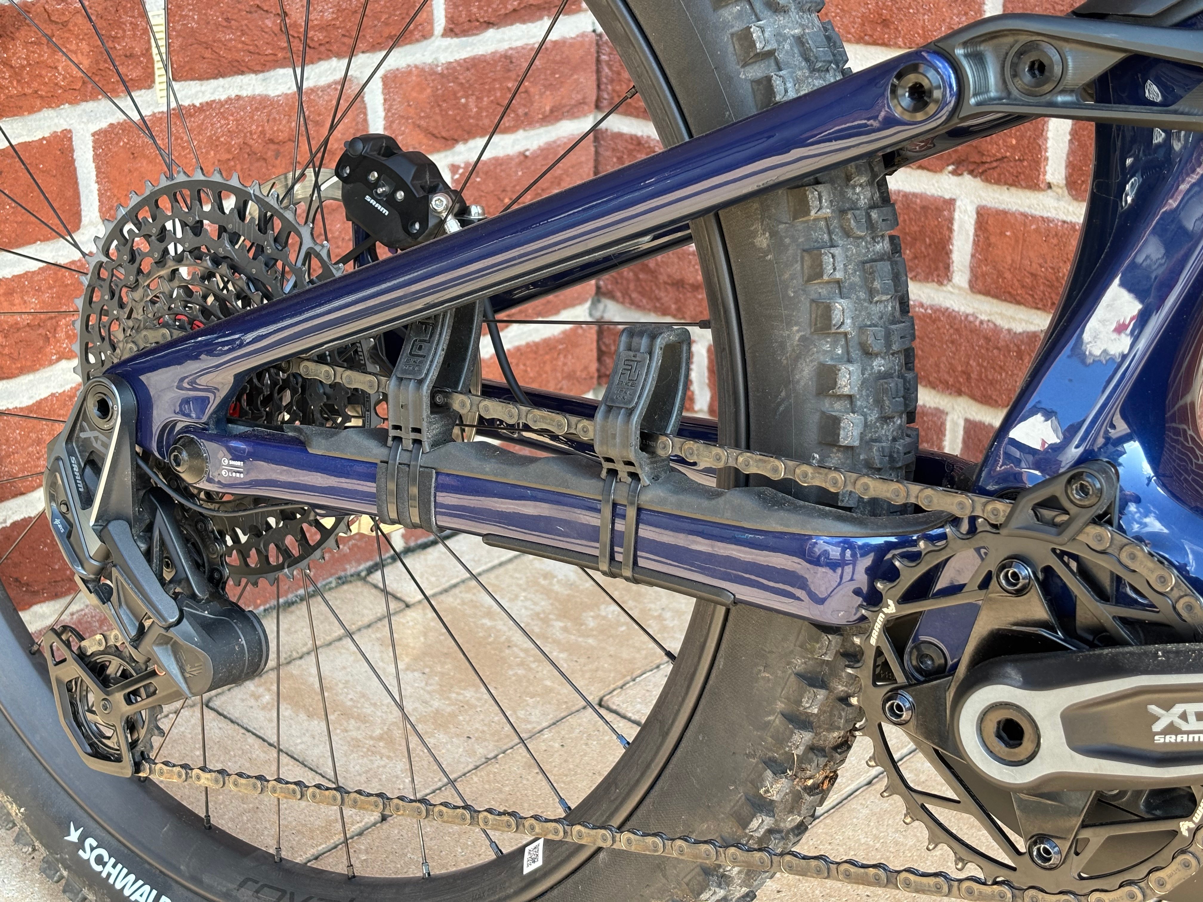

While the Sidekick hub was a noticeable improvement, the ride was still not quiet enough for my taste.
As an additional step, I installed an STFU chain damping system to reduce chain slap – a much cheaper upgrade, luckily.
With both modifications, the overall noise level is now where I wanted it: my new Levo 4 is now almost as quiet as my previous bike, which is exactly what I was aiming for, although there is of course a weight disadvantage with the hub and the chain guide looks relatively unsightly.
I may experiment with different Sidekick settings later, but for now this combination works really well for me.

At any rate, Ochain seems to suggest that they only have 1 chainline/offset for the bosch systems, which seems to be 52mm. The product detail page, has the following statement:
  • Ochain | And Bosch is compatible with Bosch gen5 BDU38. S pacers are included in the box to match the original chainline just for the Ochain | And Bosch
My assumption is that they are achieving the delta between the 52mm and 55mm chainlines, through a spacer behind the spider. Does anyone have any confirmation on that?
Edit: I think I found the answer to my question within the user manual, which is difficult to find. Dang italian engineers and their organizational habits. Ochain | SRAM
Bumping this thread for a question. I have a current gen SC Bullit and I'm considering an Ochain. I have an ochain on my gen 6 nomad and it's sublime.
FWIW the ochain website changed when SRAM took over but there was/is a Bosch 55mm chainline specific E model out there. Maybe now they cut down on a SKU and just use a spacer to get to 55mm?
Is there an update on the use of this hub?
Yes, it works as advertised. Except it doesn’t take all the motor backlash rattle away. It does however reduce the rattle.
I have now swapped this hub/rim set over to my new Crestline RS181 DJI powered emtb.
The E13 SideKick works great for reducing VPP suspension platform peddle kickback.
