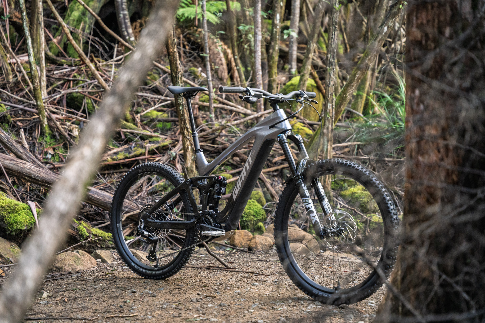

2026 Giant Reign E+ Megathread

Firstly, dji is a first gen system with first gen problems. Speed sensors, controllers and motors have all had issues. The motor also develops a rattle after miles have been done on it. They all get this issue. I'm sure dji will be good in the next Gen. That's if dji doesn't get completely banned from Western countries which has started to happen (china etc etc). The myth os a nice looking bike. Very expensive mind. The front end is extremely high and takes a very committed rider to make the most of it. Plus seat post insertion is terrible. Had the seat up my ass on step descents. Put me right off off it. Current Gen reign was good, enjoyed mine. Put over 3000 miles on it. But, it was a heavy beast. A plow more than a playful bike. Everything seeing on the new one address that. Time will tell. I have a demo lined up once the bike arrives. See how it feels and how good this new battery tech is.
The problem with this new Reign E+ is that it is in a no man's land : trying to be an SL type bike in a full fat frame.
No matter how efficient the new 48V system is, the 560WH will be a very hard sell with such packaging.
Just give it the 840wh/100NM and a lot of people will get over the down tube just like Bosch 800wh bikes.
I struggle to understand how Giant went from selling thousands of full fat Trance E+ or Reign E+ to suddently trying to force 400WH/560WH carbon only eMTBs when the majority of the demand is still in the full fat segment. They will struggle to do repeat sales on their existing pool of owners/fanbase.
I'll wait on the official release notes to forge my final opinion on this bike, but this is a huge let down for me from what I can see.

Bike shop have confirmed its a 560Wh only it does come as standard with a 280Wh range extender bike is 24kg with it fitted, no dates as yet on extra batteries or a larger battery which means its probably not the bike for me

24kgs isn't that great is it? That's not a huge amount lighter than the existing bike with a big battery and I'm guessing that's for the top of the range model with the horrible carbon stem/bar thing. I suppose it depends on whether this new 48v system is a big jump forwards in terms of efficiency. If the 840wh total of the new bike offers no significant gains over the existing 800wh battery then the weight savings of the carbon frame seems to have been squandered for no real advantage. That five year motor and battery warranty is potentially a big deal though.

I've just weighed my existing bike for some sort of comparison. It's a Reign E+1, size XL with a coil shock, Schwalbe Shredda radials and includes mudguards front and rear, Sendhit hand guards, an Exposure light, empty water bottle etc (so not stripped down at all) and with the 625wh battery in (I do have an 800wh battery as well but don't often use it).
Weight is 27.8kgs! No wonder it feels like a plough! 🙄
Obviously I could shed quite a bit off that if I wanted to but it's interesting to compare real world weight with the projected weight of the new bike.
