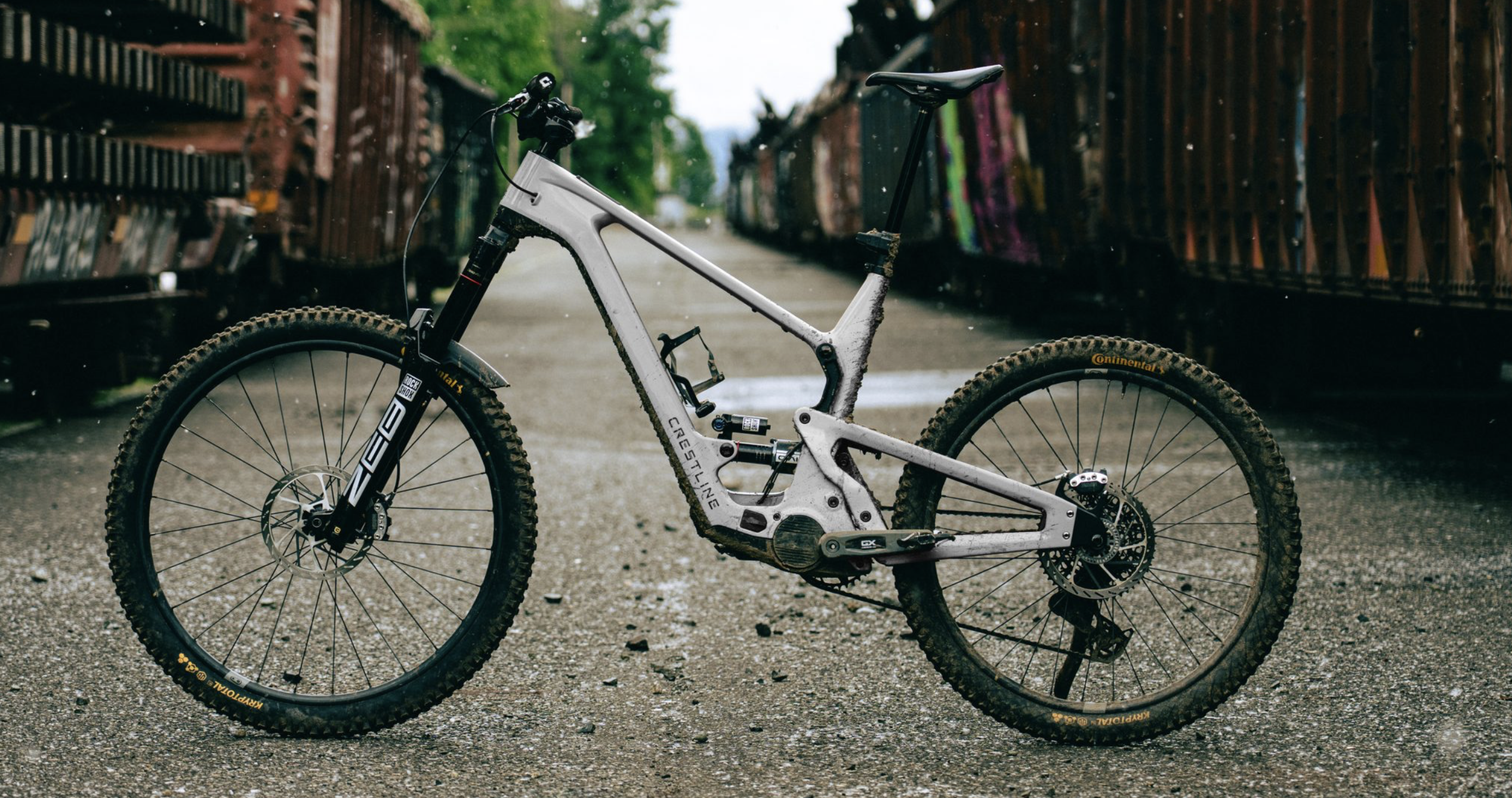

Crestline Spectre
1000w motor, 800wh battery, 180 travel front and rear, removable battery, fast charging, slim looks, 22.8 KG

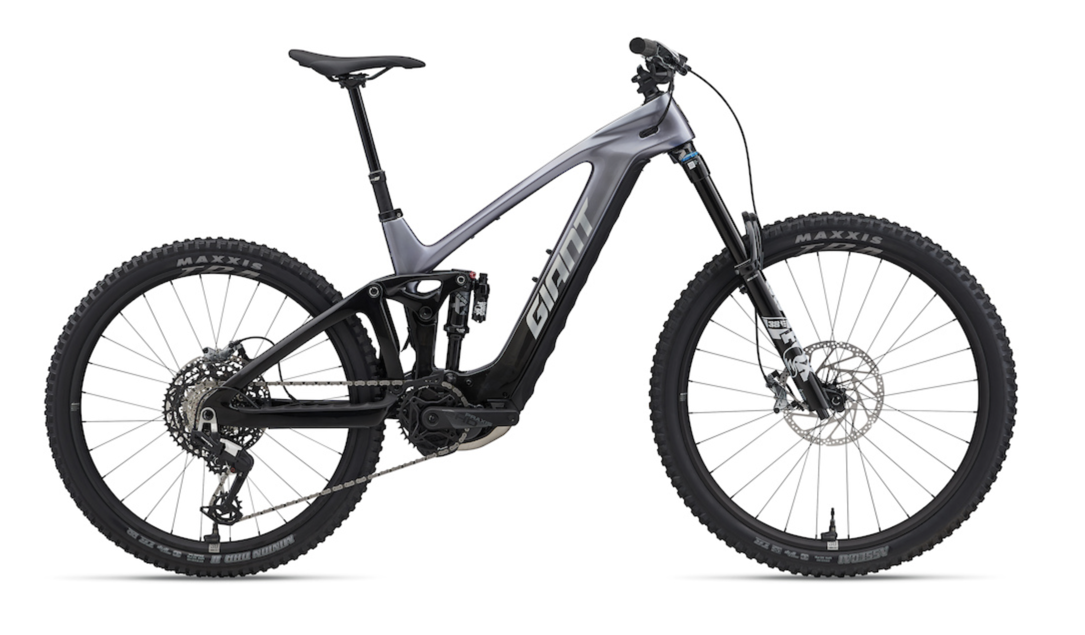

Giant Reign
800w motor, 560wh removable battery, 22.6 KG

I guess my point is that you are not really compromising bike weight on the latest systems by having a bigger battery and more powerful motor. In fact, run a 600wh battery and make it lighter than the new Giant, with more powerful motor and the other benefits of the DJI system.

Crestline Spectre
Giant Reign

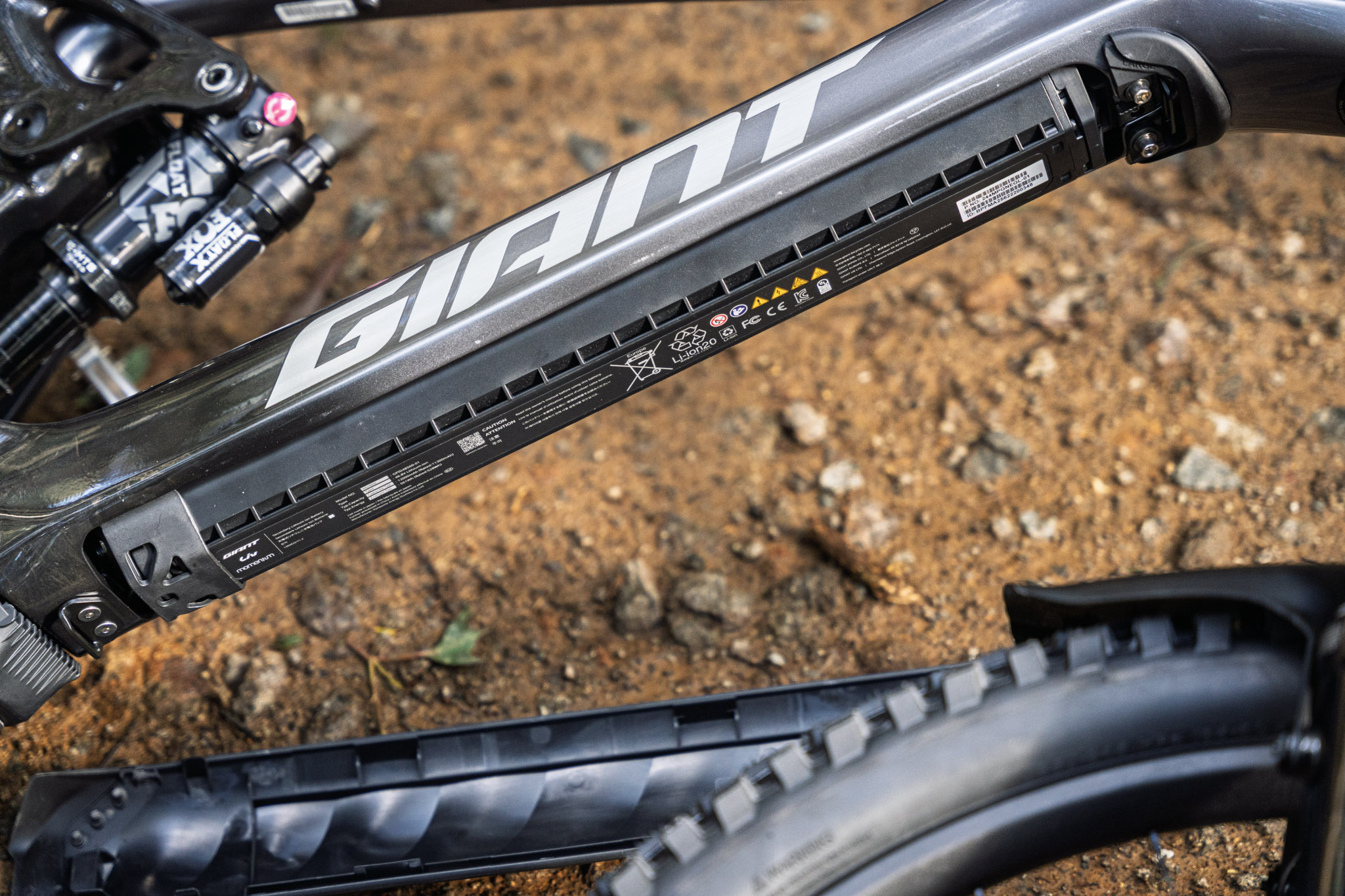

The 560Wh seems to go all the way up that tube, unlike the Levo4 600Wh battery (announced but still unavailable) that looks much lower in the frame.
I bet the 560 is hollow in the upper part of the housing you see here. That's how I would get rid of the extra hardware like on the Specialized 600Wh pack and also reduce cost of manufacturing for different housings etc...edit: also with that a better structural rigidity is maintained for the whole system.
