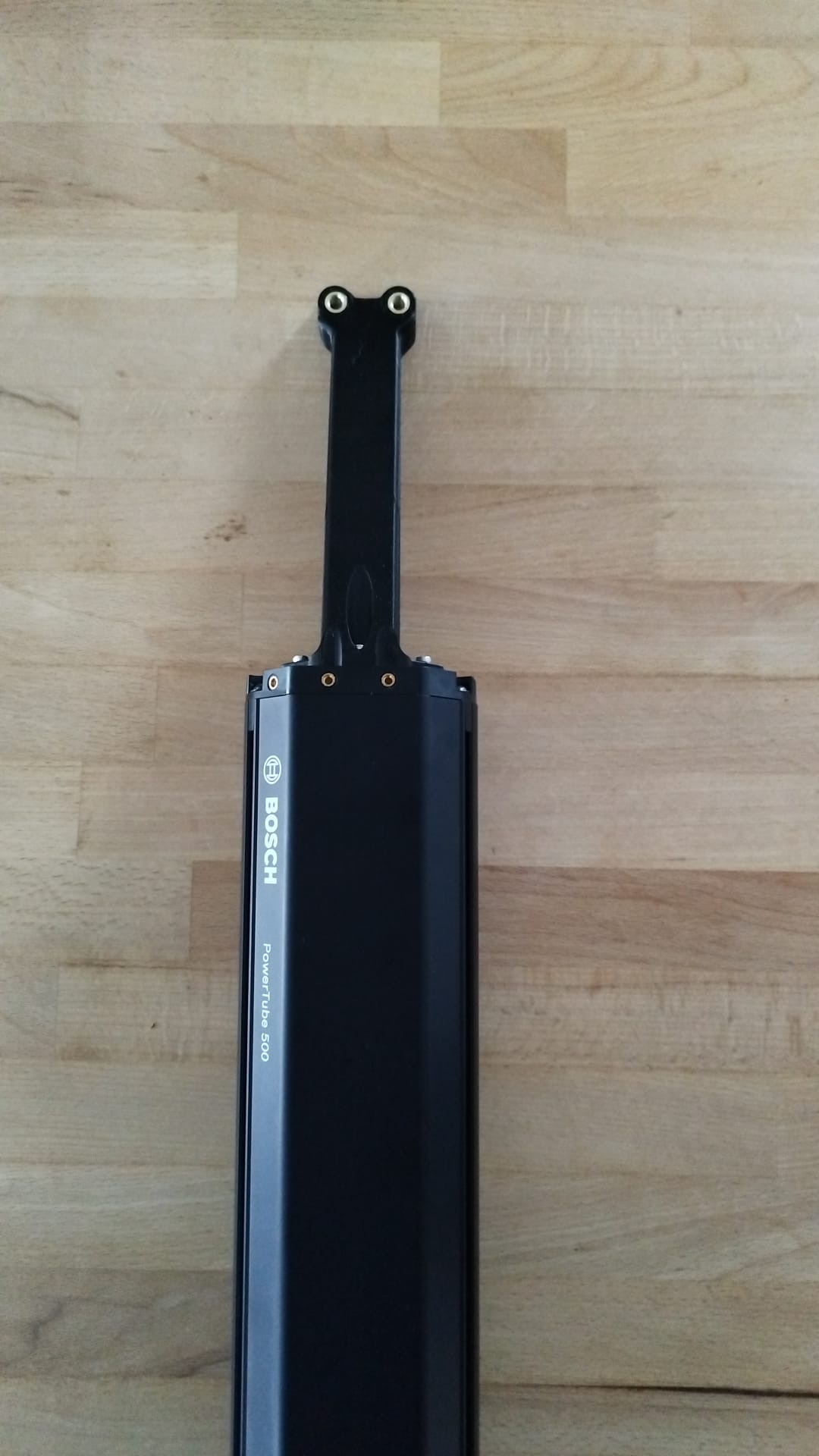

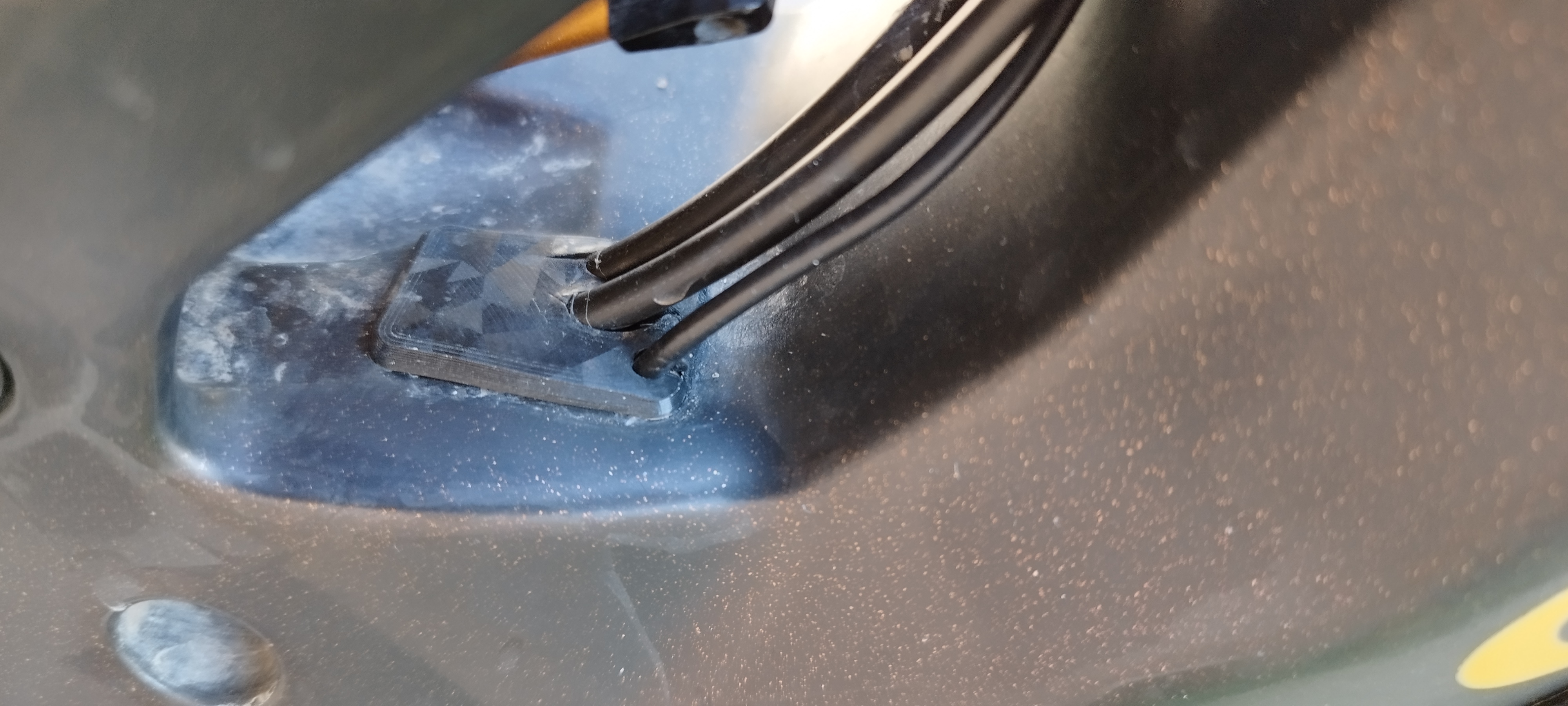

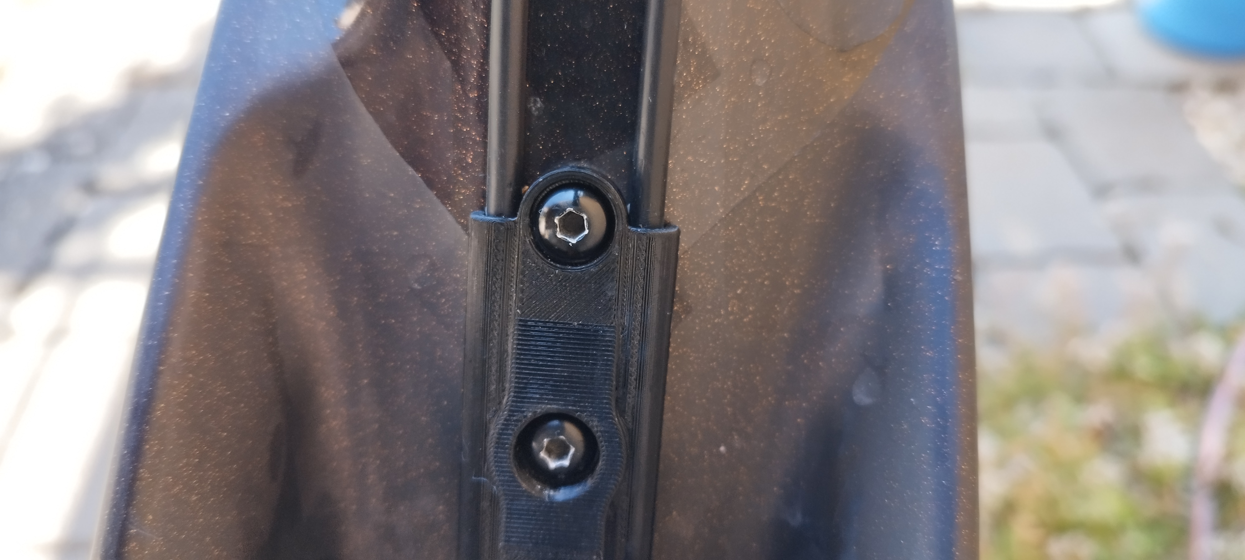

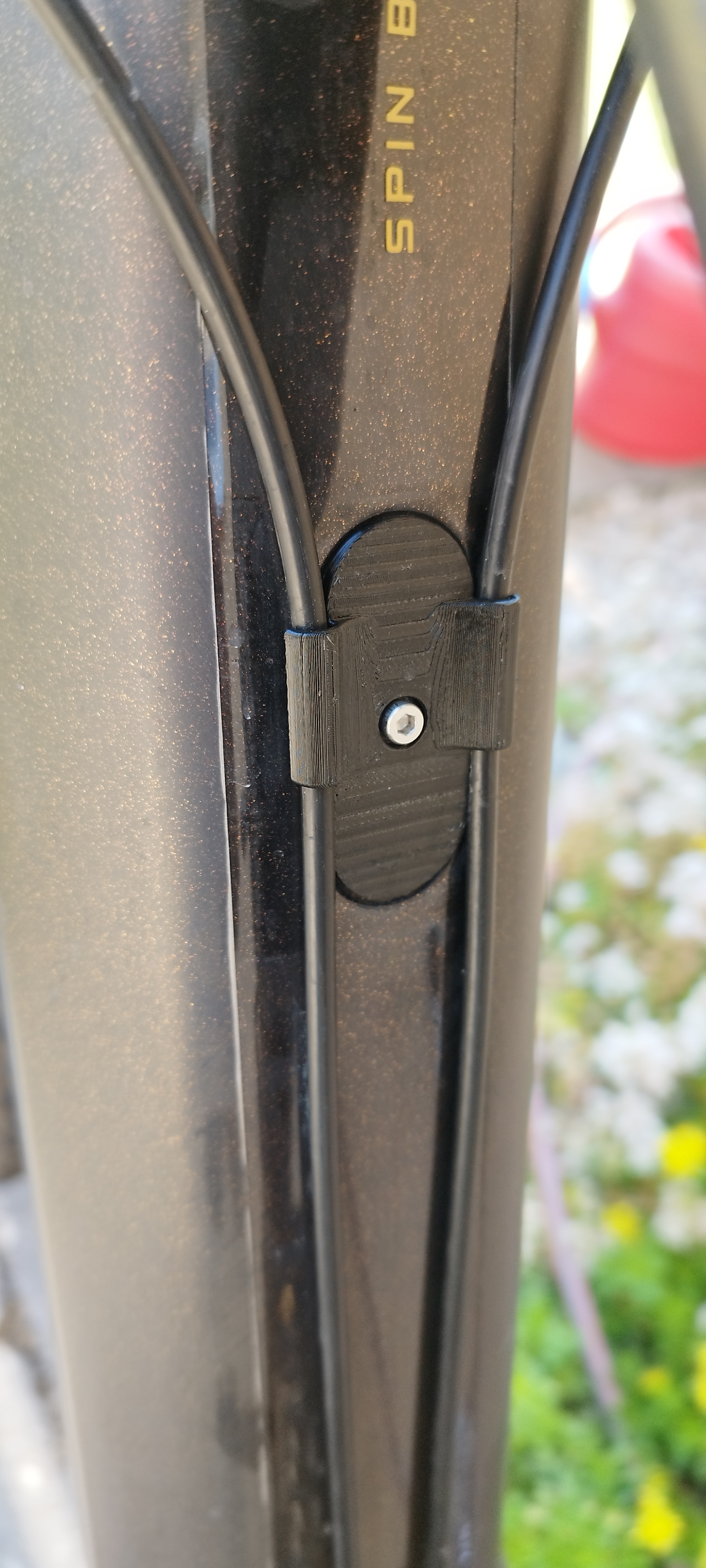

Adapter 500 Akku 3D Print Weight is now approx. 22kg and the cables for gears and seat post are now also outside 😊 and the Öhlins fork is only 🤩

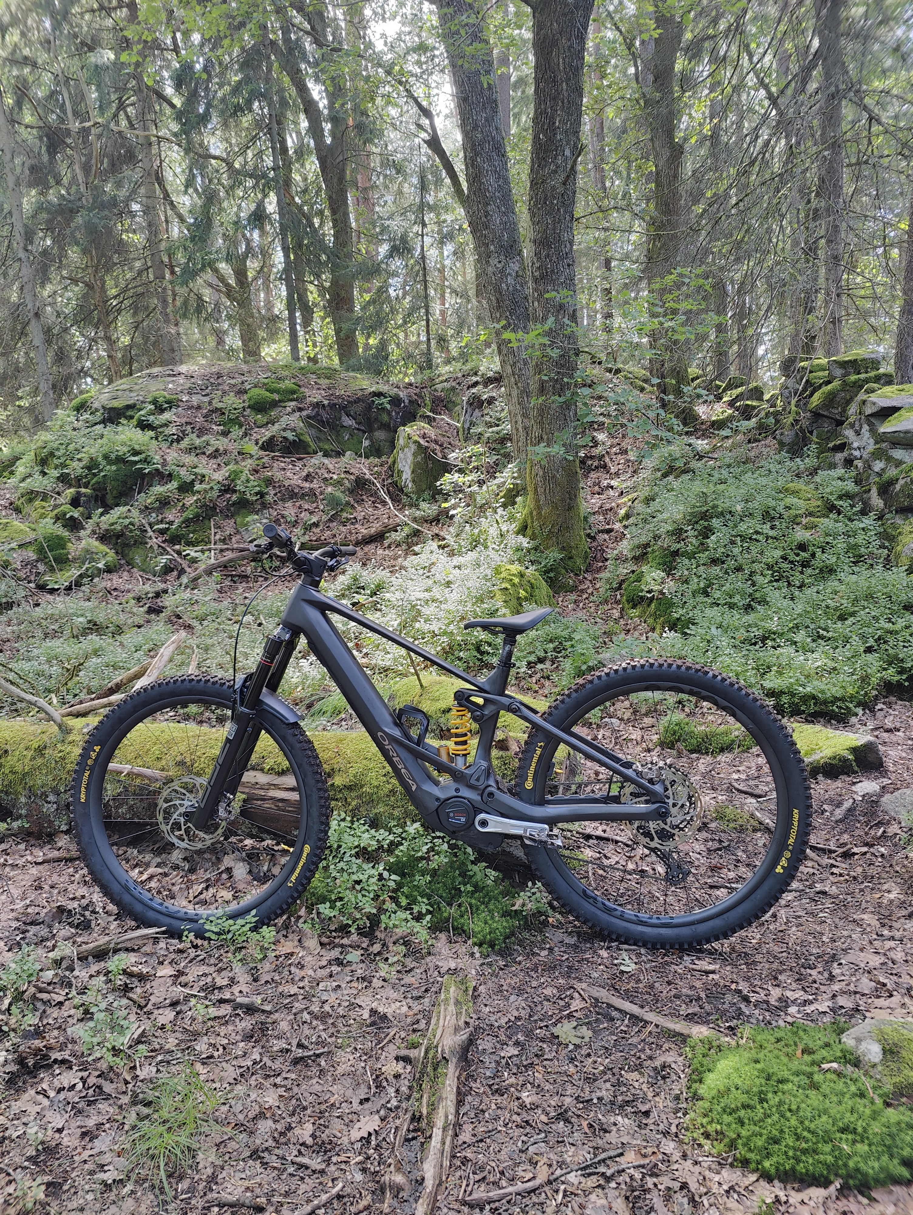

It’s an M20.
Brakes: Hayes Dominion T4
Fork: Zeb Base
Shock: Manitou Mara Pro
Dropper: OneUp V3 210
Wheels: Triad 30mm F / Sector 28mm R
Hubs: DT 240 DEG w/ CX Ray Spokes
Drivetrain: XT shifter & Mech / X01 Cassette & Chain
Looks very neat!
Did you buy the 3D file or do you wanna share or sell it for private use?

I'd also be interested in buying the parts or files. Looks like the second photo is another custom mount using the water bottle mount? I use a fidlock bottle so need to work sometime out for that but I defo want to do this next time I need to change an outer.

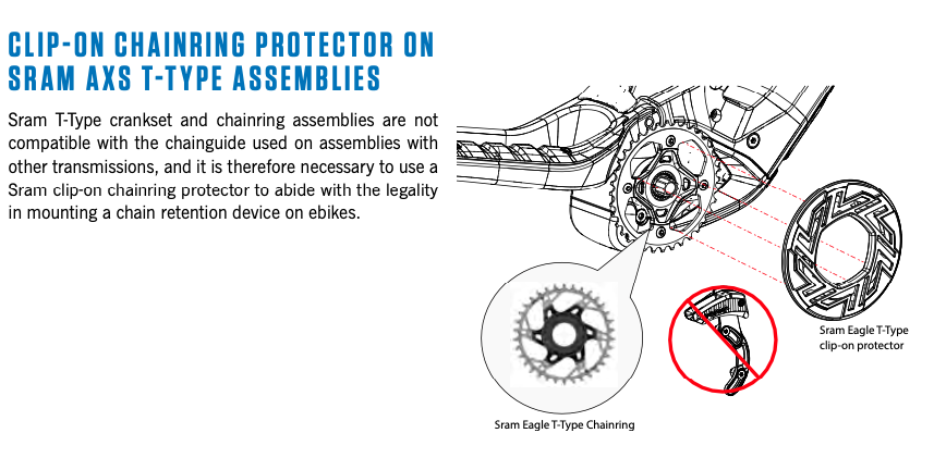

Is anyone else riding a Wild with the XX transmission? The bike comes with the plastic SRAM Aero-guard, which I believe is supposed to double as a chain guide. Unfortunately, the Aero-guard is pretty flimsy, and I’ve already managed to break the weak snap-in mechanism it uses to attach to the chainring. That aero-guard is not really designed for any harder riding. Has anyone here used a proper chain guide or the SRAM bashguard to keep the chain in place?

You got a picture of what you mean by the aero guide? Mine came with a chain device? and that works fine?
My M11 came with one too. Was thinking of removing mine as I don’t see what purpose it serves
Found this from the manual:
But it's such a stupid piece of plastic. It's the lowest point of the bike, hanging a bit lower than the motor's plastic cover so it's the first part to hit any obstacle, and it can't really take any hits without getting damaged or dislocated. And it of course looks rather cheap as well.
Good info, thanks. Not worried about dropping a chain, more worried about bashing mine, so it is coming off the bike.
