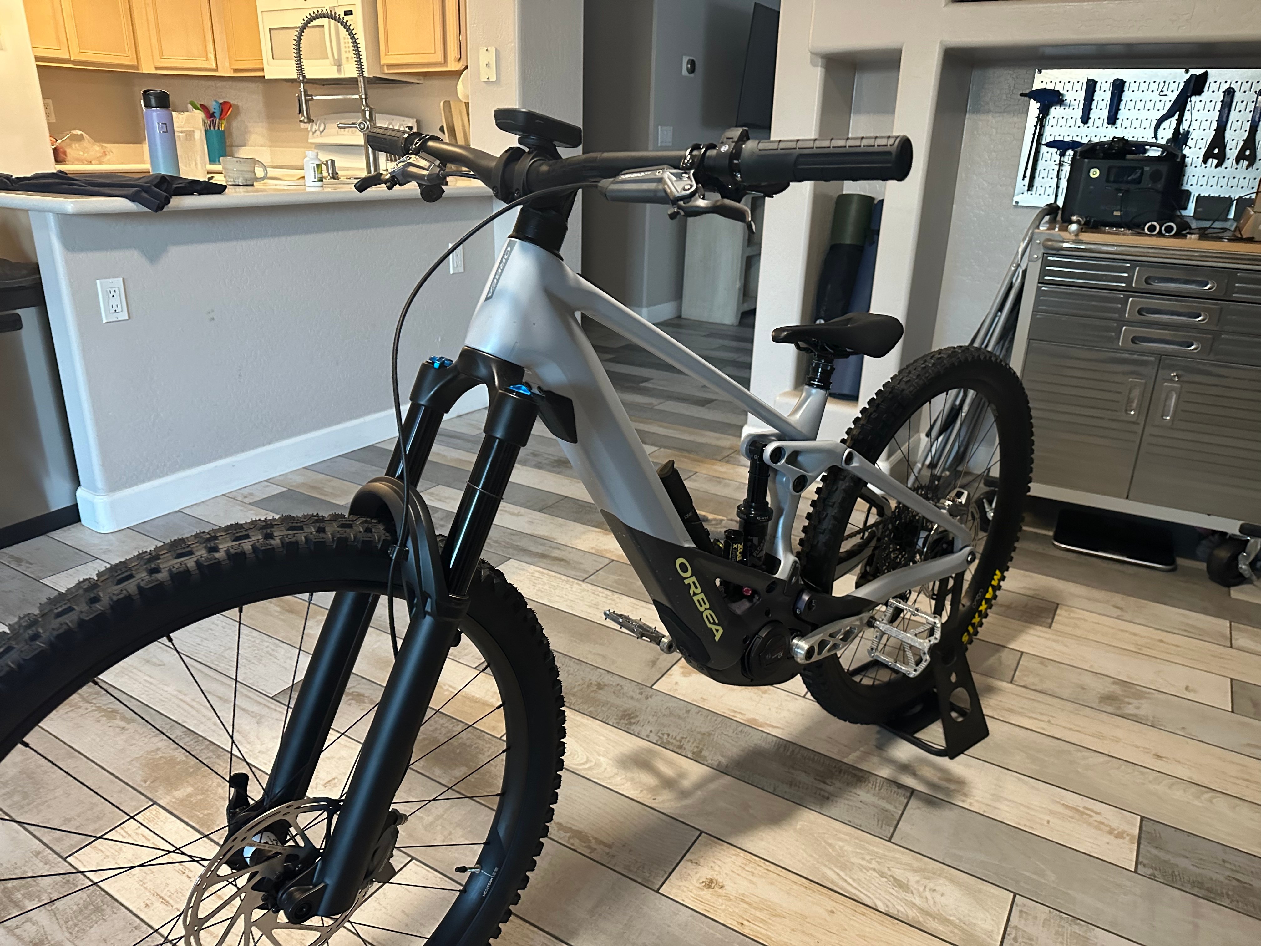

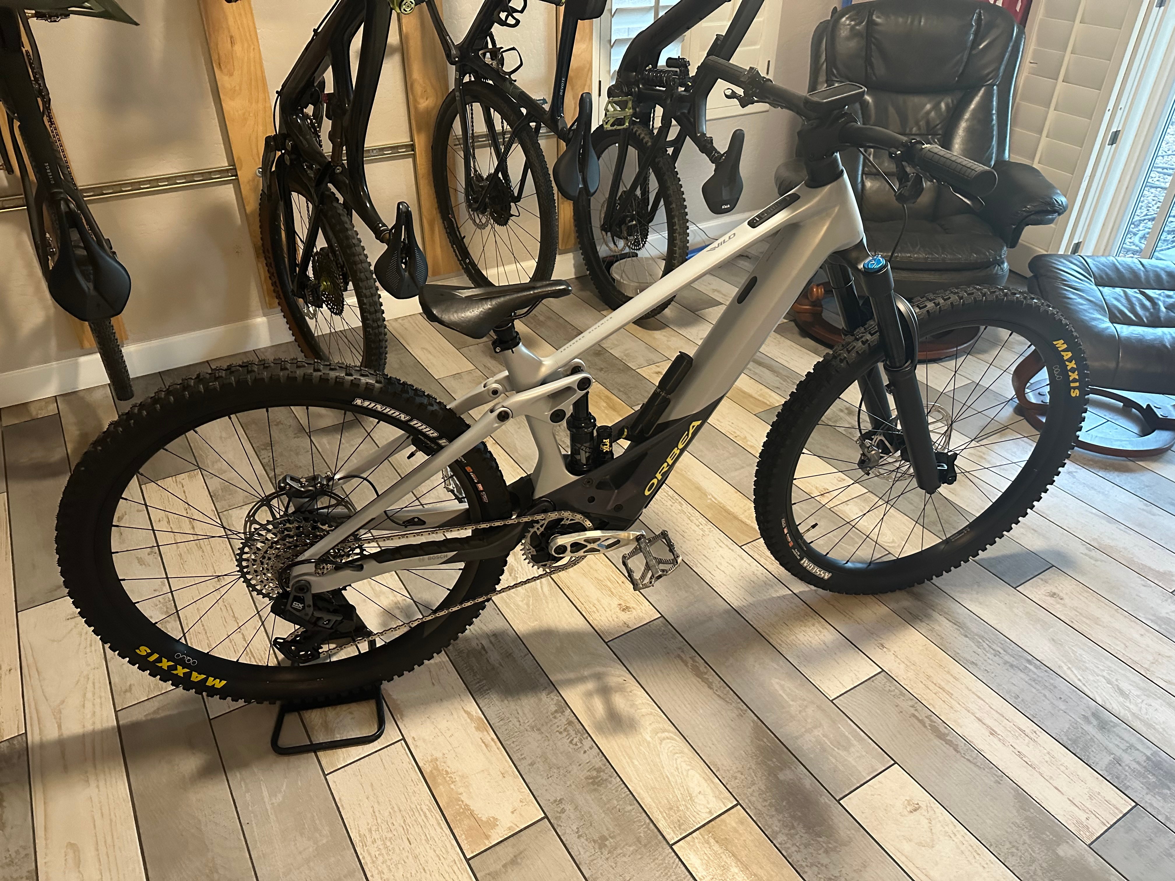

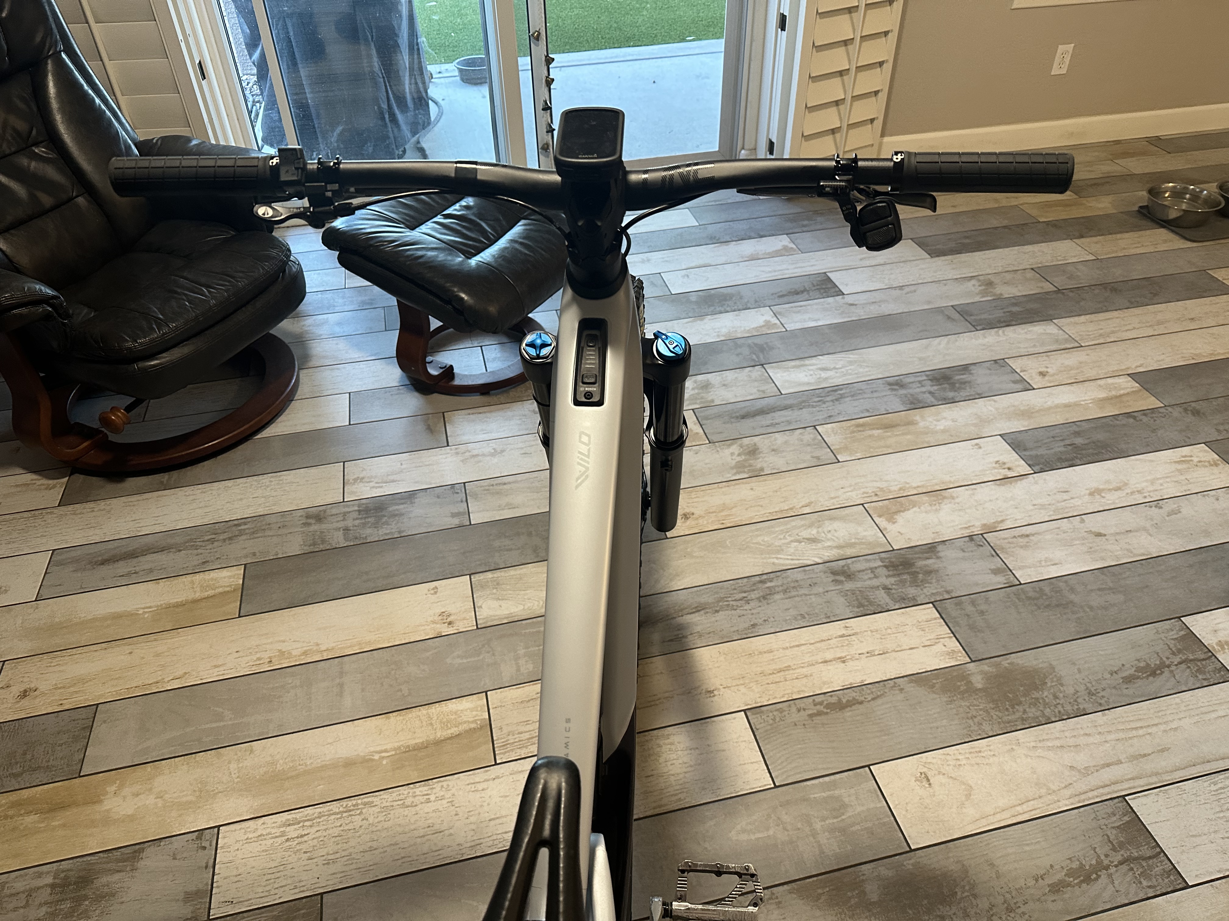

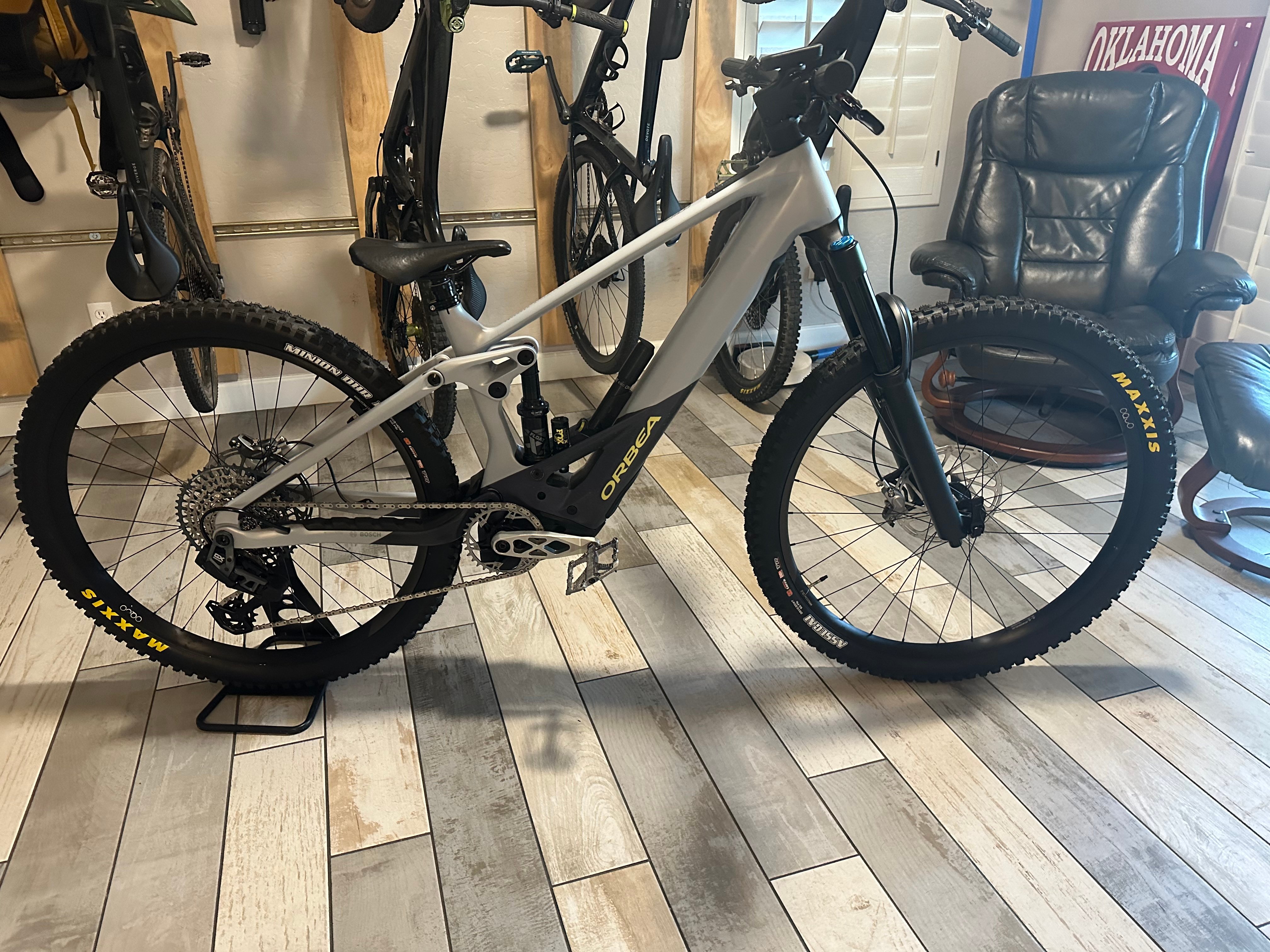

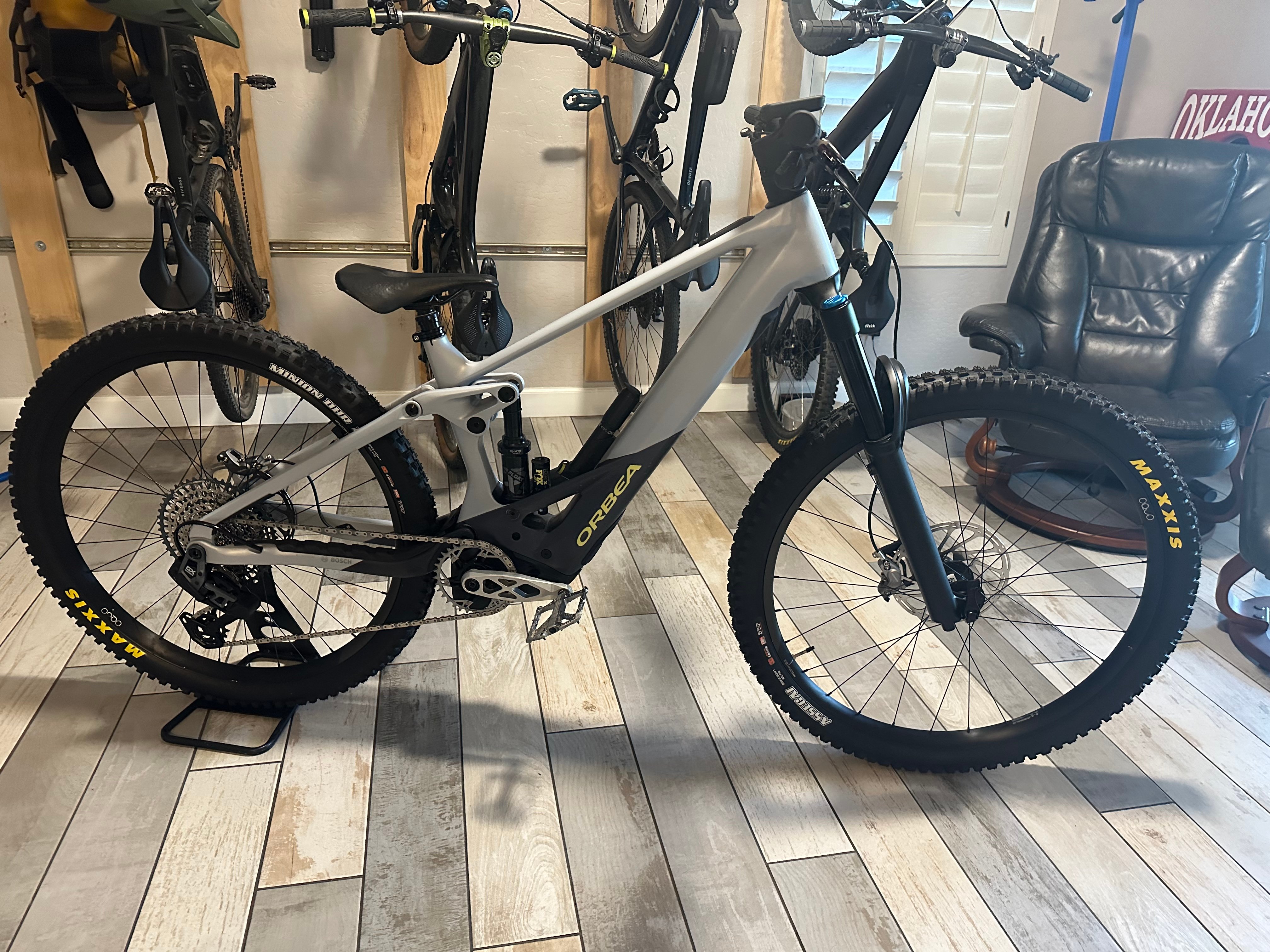

My new Wild M11 AXS is here and ready to ride with a few mods. One Up handlebars, One Up V3 210 mm dropper, SDG dropper post lever, 5Dev cranks 155 mm, Deity Bladerunner pedals, Specialized Power Expert saddle and full Ride Wrap. Next week new Nobl TR 38 wheels with Sapim Race spokes will be going on and I will be adding the low speed compression adjustment to the Fox Float X. I think that’ll be it for now. Gonna see how I like the brakes, but those may get swapped as well.
2E714707-E772-46EF-A30C-0152EBC34D0C.jpeg 2E782D31-9739-4E23-8DE5-FE7C99E82C79.jpeg 61621BD0-870B-4A86-BC0A-DC4CB7FE1EAB.jpeg 86691327-15D4-42DB-A146-4C7EB4BEF885.jpeg 120C7A5B-360F-40D0-B711-9D9B3367EDC6.jpeg 41D0779E-BA58-4832-BE41-42557DE6F7AD.jpeg
I did this on my brandnew M10. But I have to say that the adjuster does not affect the compression rate. Same with my Rise H10.
I‘m sure these dampers have got a special Orbea tune or a special base valve. This prevents the adjuster to work.
View attachment 145664 View attachment 145665 View attachment 145666 View attachment 145667 View attachment 145668 View attachment 145669
Nice! That dropper is slammed, I need to do the same. Congrats, such a good bike

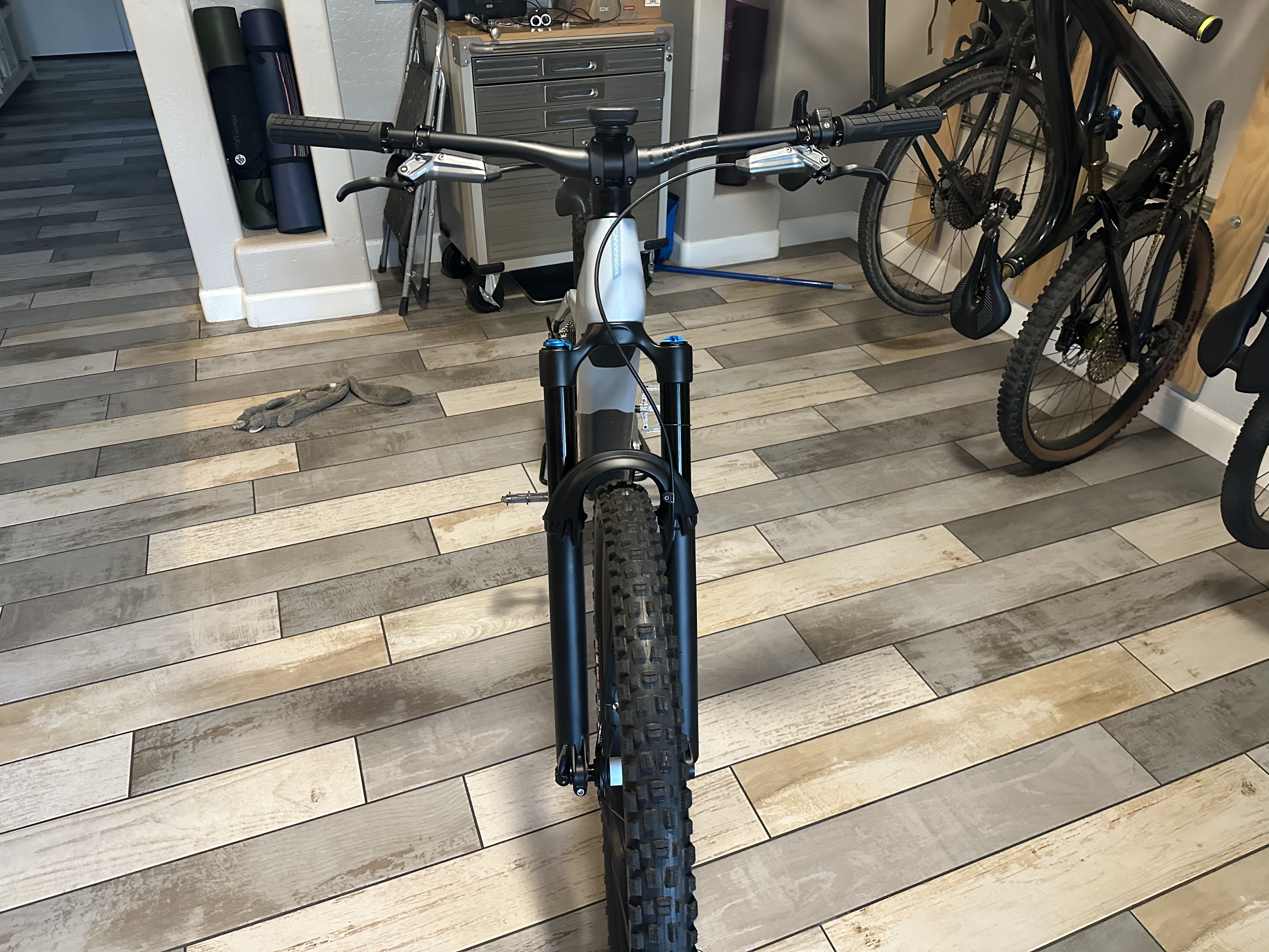

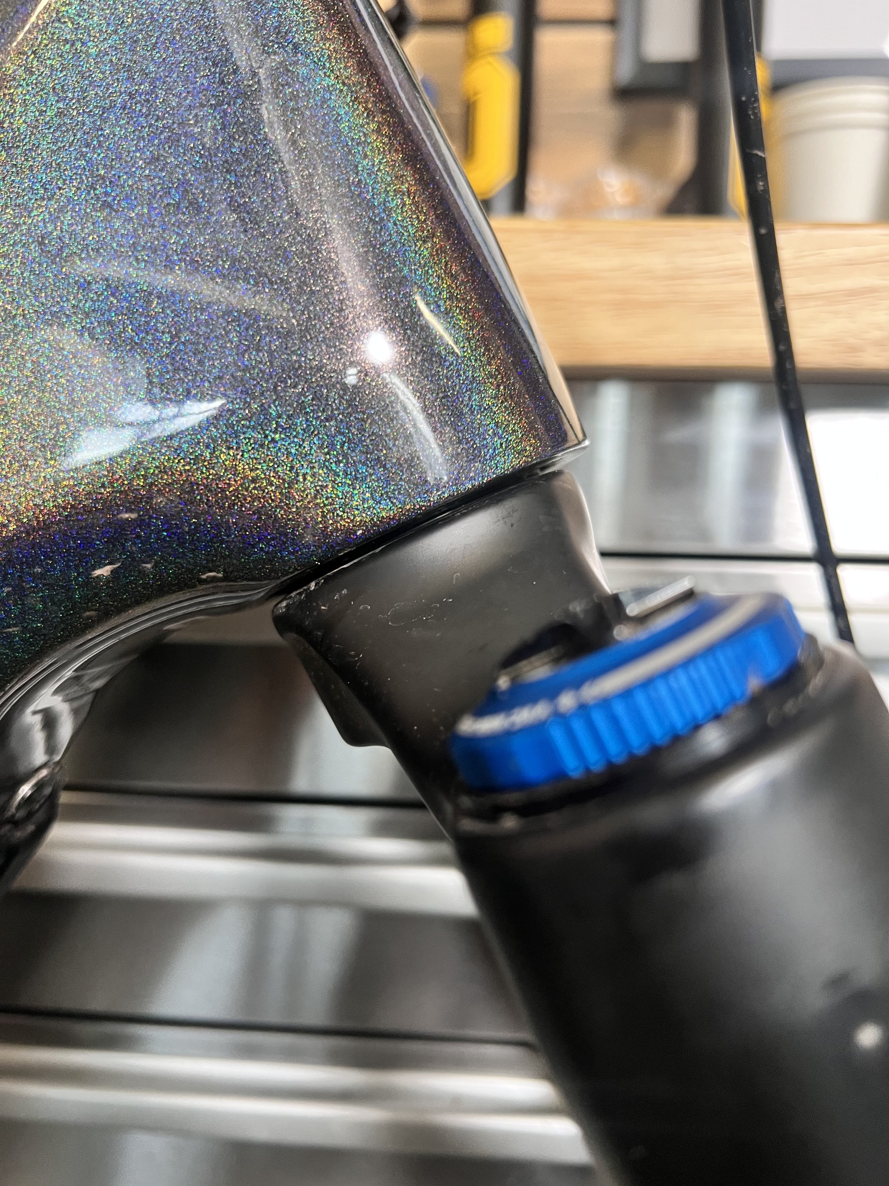

For those that have swapped out the original stem and spacers using the Orbea Headset Adaptor Universal Adaptor, what did you do to prevent the fork from hitting the frame with no more spin block protection? How does this affect the cables if the handlebar turns past 90 degree, does it pull the cables to a point of potential damage?
I ride an XL so cant help on the first question as the fork misses the downtube on a XL.
For the cables, I just made sure they weren't super tight and had a little excess in the Headtube/Downtube incase of the bars turning, I've had a few crashes were the bars have spun round and not had a problem with cables being pulled out.
Thanks for the reply

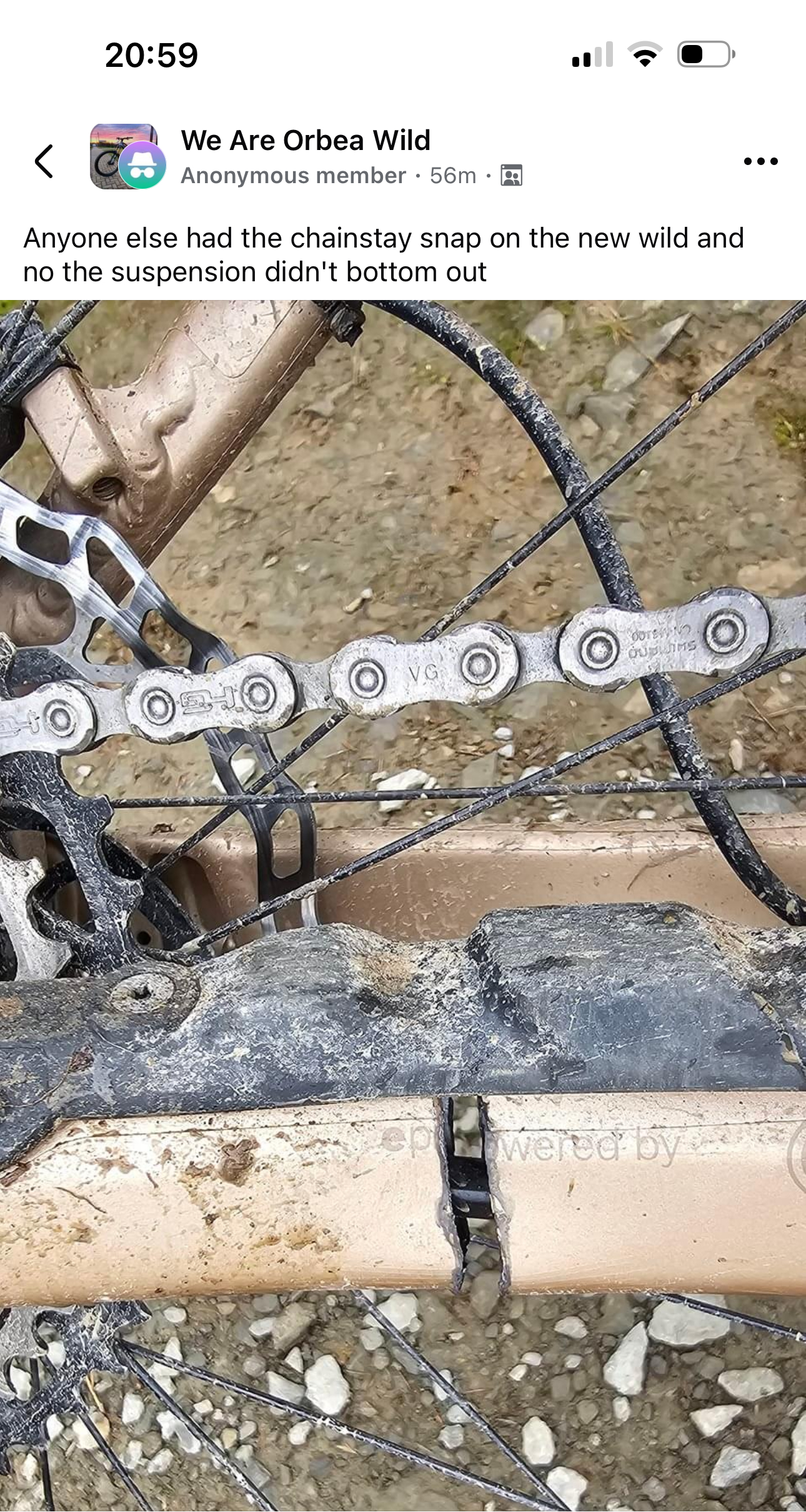

Thought we’d seen the last of the frame issues with this new gen, but the following are happening on Alu Wild new gen frames.
Alignment issue with rear triangle, causing shock to wear on one side - requires frame replacement.
Rear Chainstay and triangle cracking/Failing.
This is happened on the new gen, 3 people on the “we are Orbea wild” FB have reported this failure with pictures.
Really wanted to get one of these, but not in Carbon. Looks like Carbon is the way to go if you really want a wild, stay away from the Alu ones, Orbea have a manufacturing issue with their Alu frames and have learnt sweet FA from the last gen.
We pay upwards of £6k for these bikes and we deserve a lot better ffs and shouldn’t accept this as a norm.
